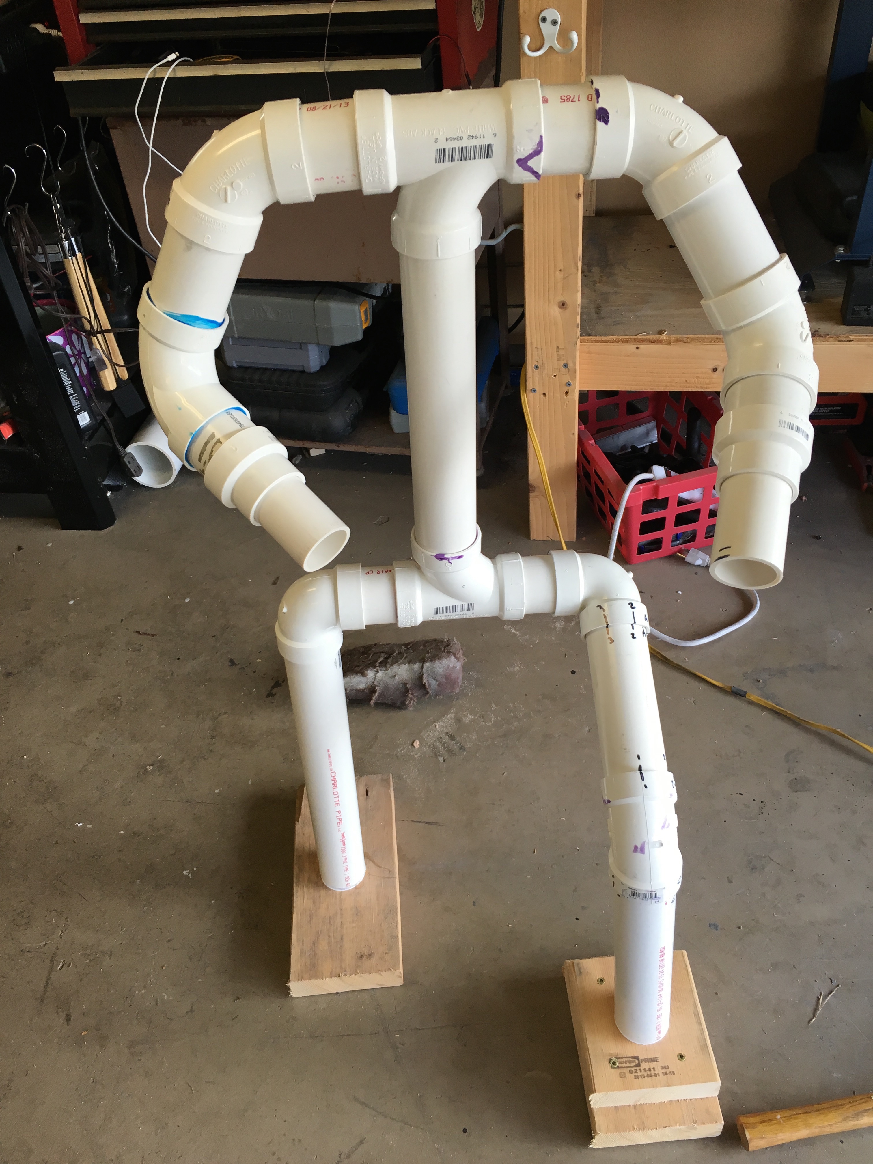

So the whole build is with 2" pvc pipes and pieces. The only parts that are not, are for the forearms. I tapered them down to 1 1/2" to allow the arm gloves to slide on easier. To stand it up, I drilled it into some spare 2x6 pieces I had laying around. I went with one knee bent look to give the legs more life like feel to it. I bought all the pvc pipes from Lowes.

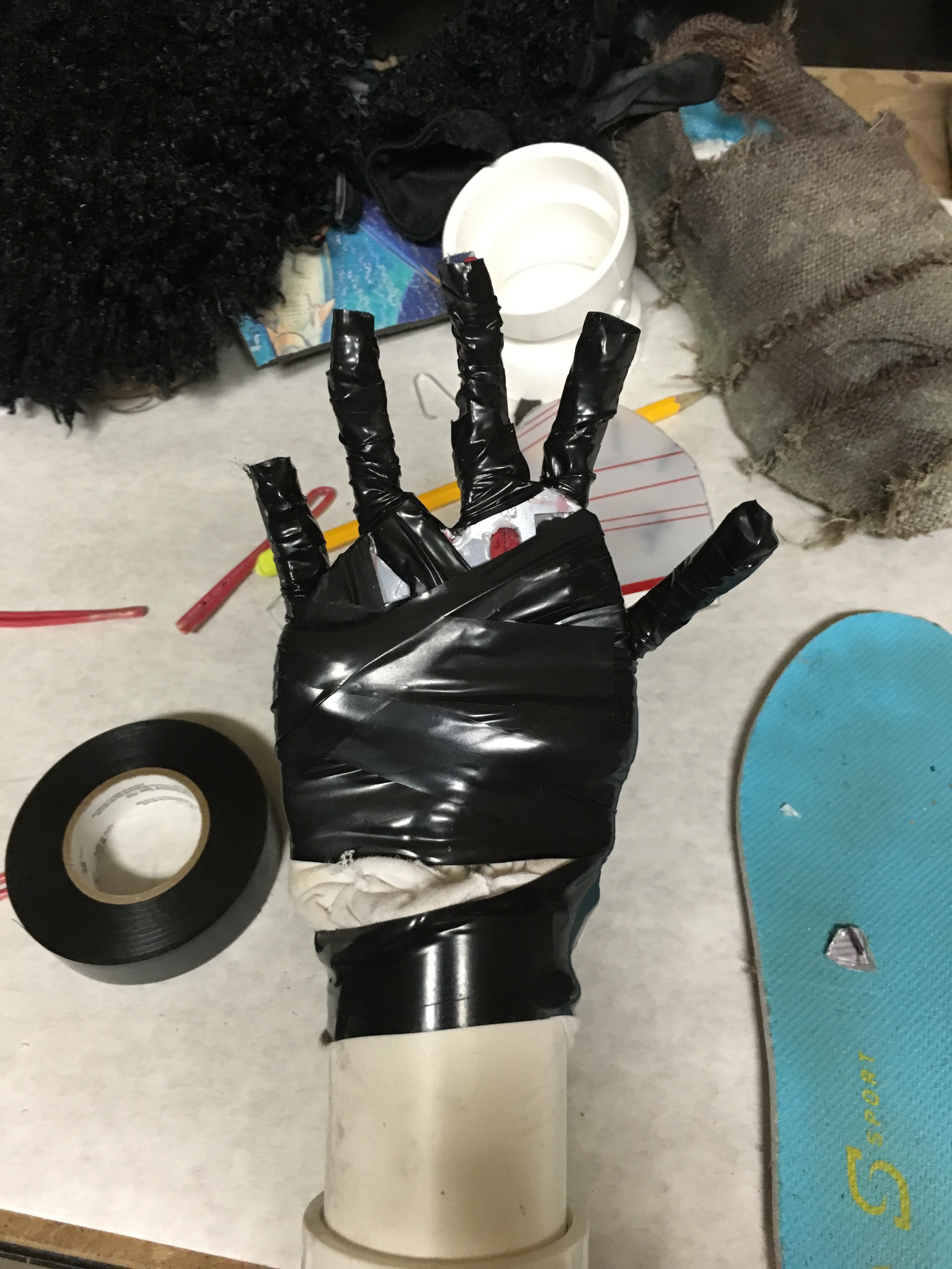

For the hands I cut up some scrap plexiglass, using the sole of a my daughters shoe. No real reason, just seemed to make sense. I drilled 2 holes in it and inserted bent pieces of #12 commercial electrical wire to use as fingers. Then I used black electrical tape to thicken them up a bit and help hold them in place. (FYI< it works really well. I can position the fingers. It helps the mannequin to look good)

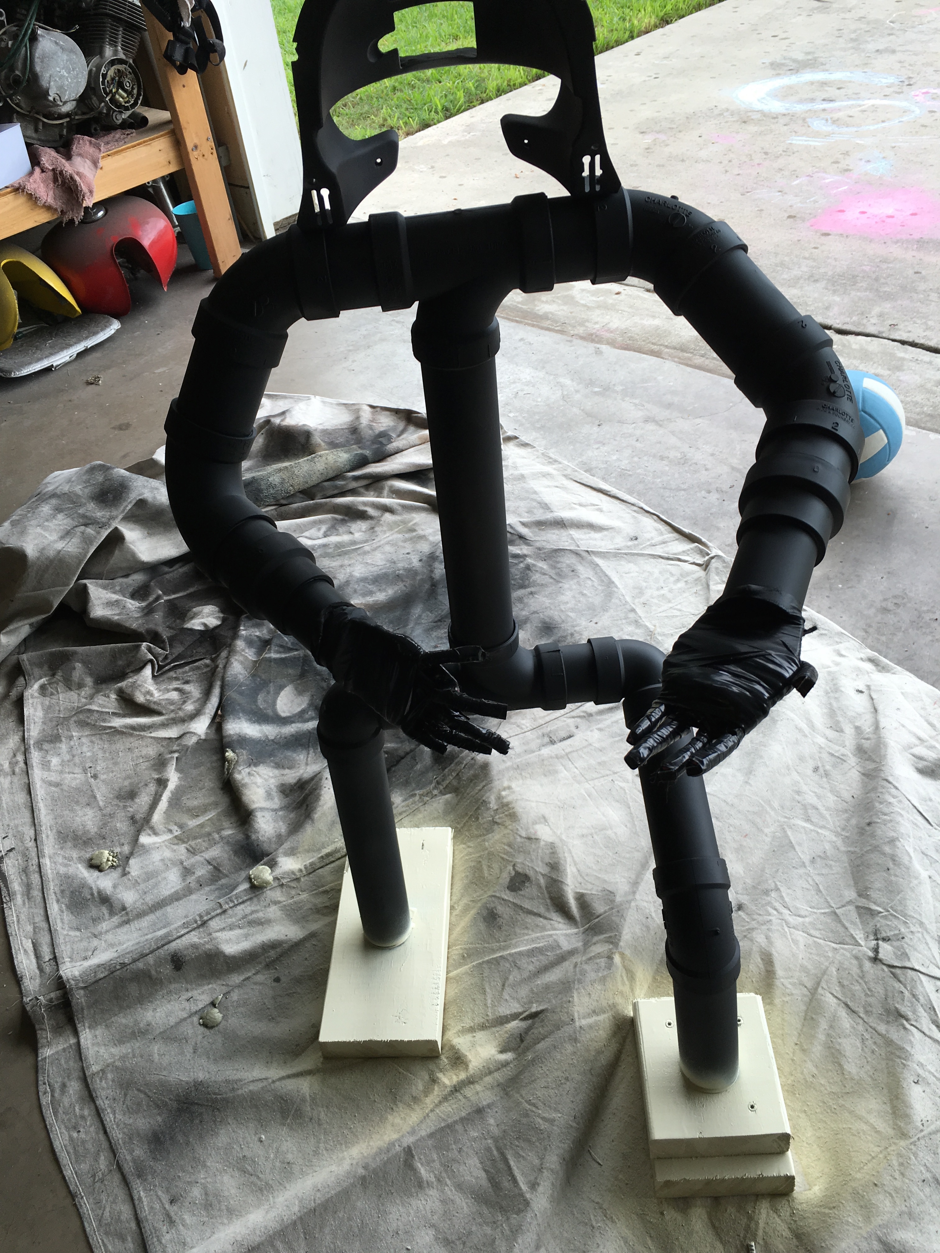

I drilled slots into the wrists on the pvc and inserted the plexiglass. Worked out really well. After that I painted the whole thing black. The base plates I painted almond to giver it more a sand looking feel to it. Once I create the foundation plate it will sit on, it will help with the look.
For the back of the head, I used the back plate piece from a cheap force awakens stormtrooper mask I bought from the disney store. I bought it for the speaker and voice change mic. I was hoping to integrate it into my ANH stormtrooper mask. Hasn't worked out so well. That's another story/project.

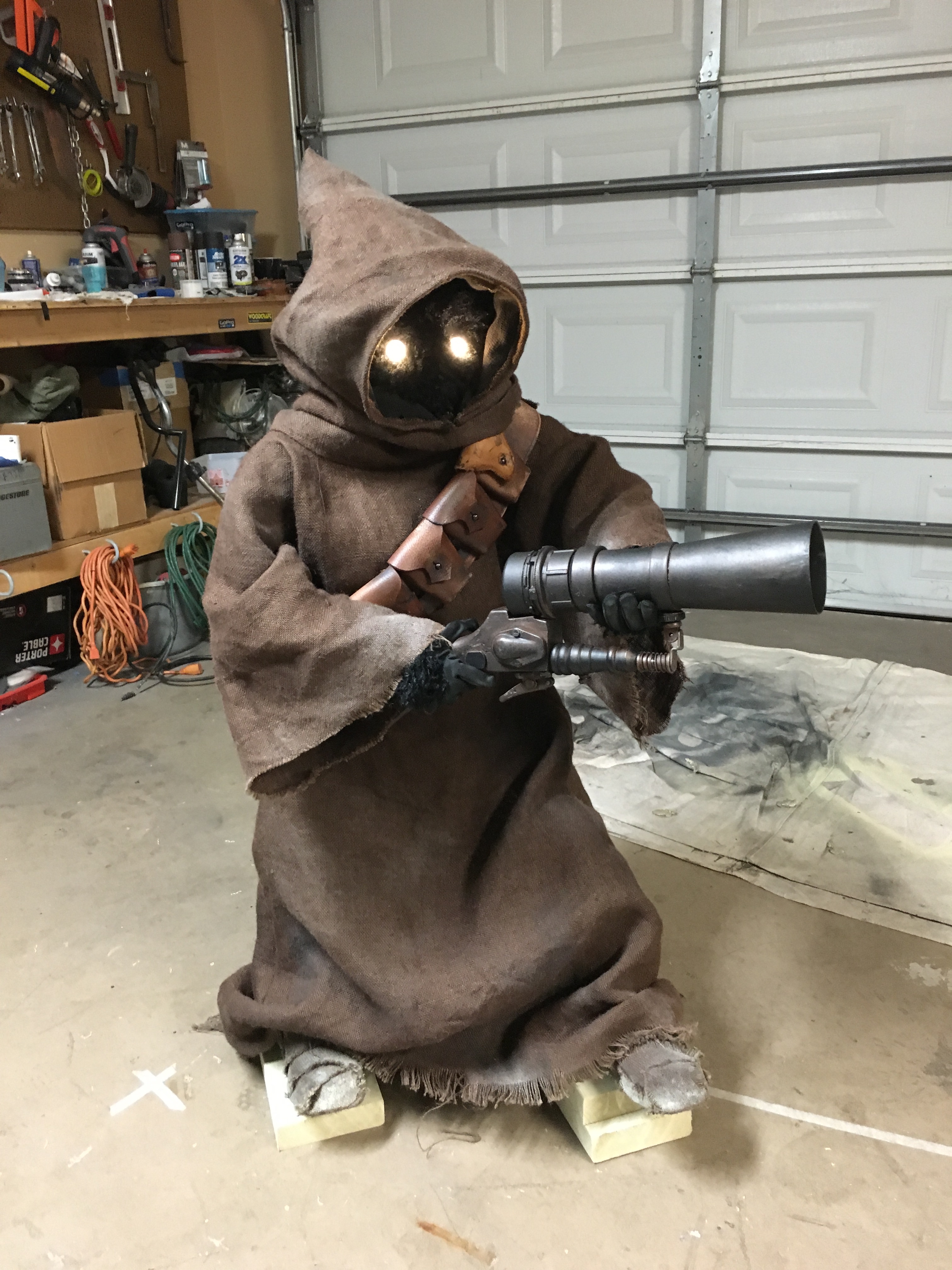

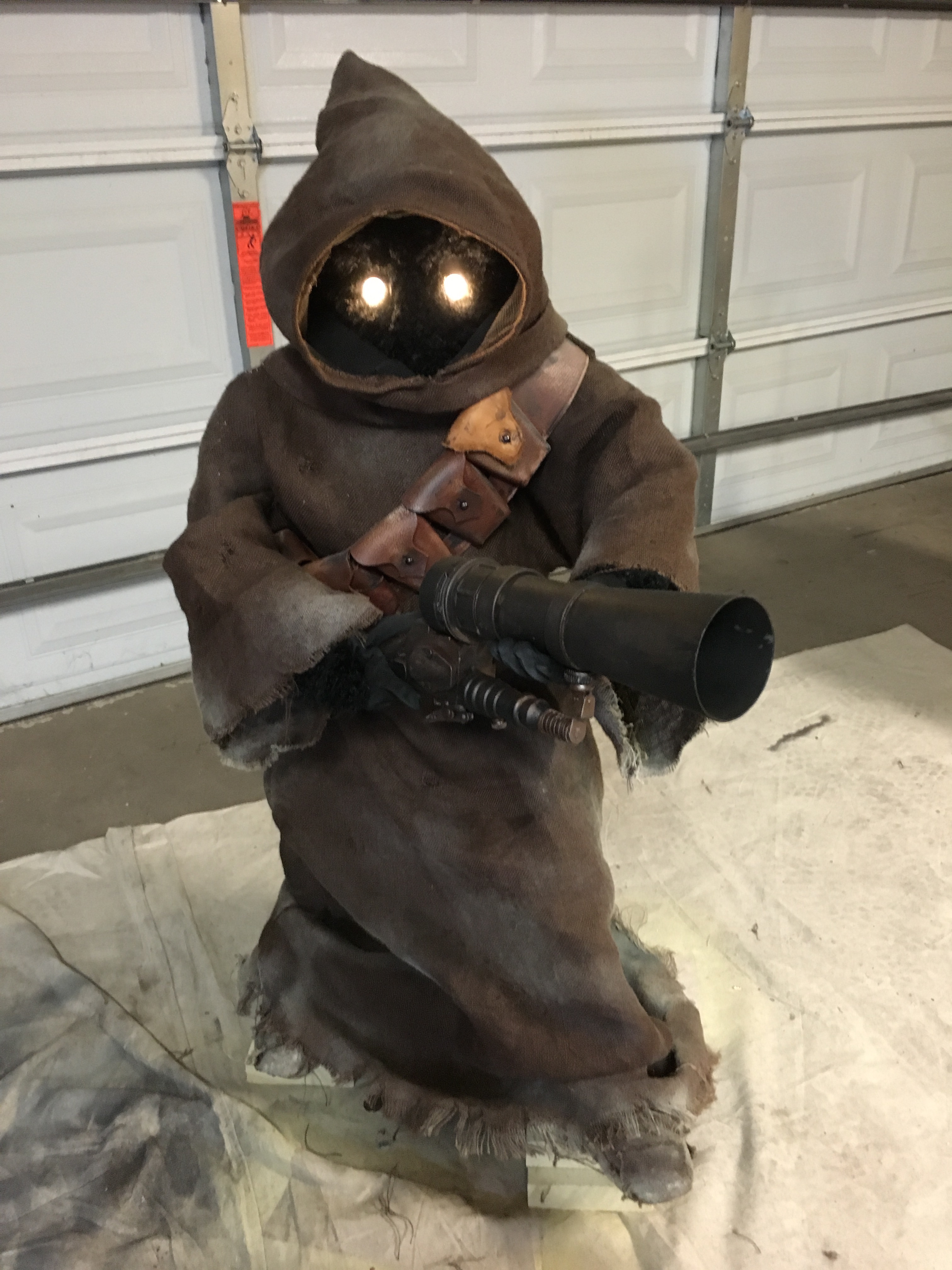

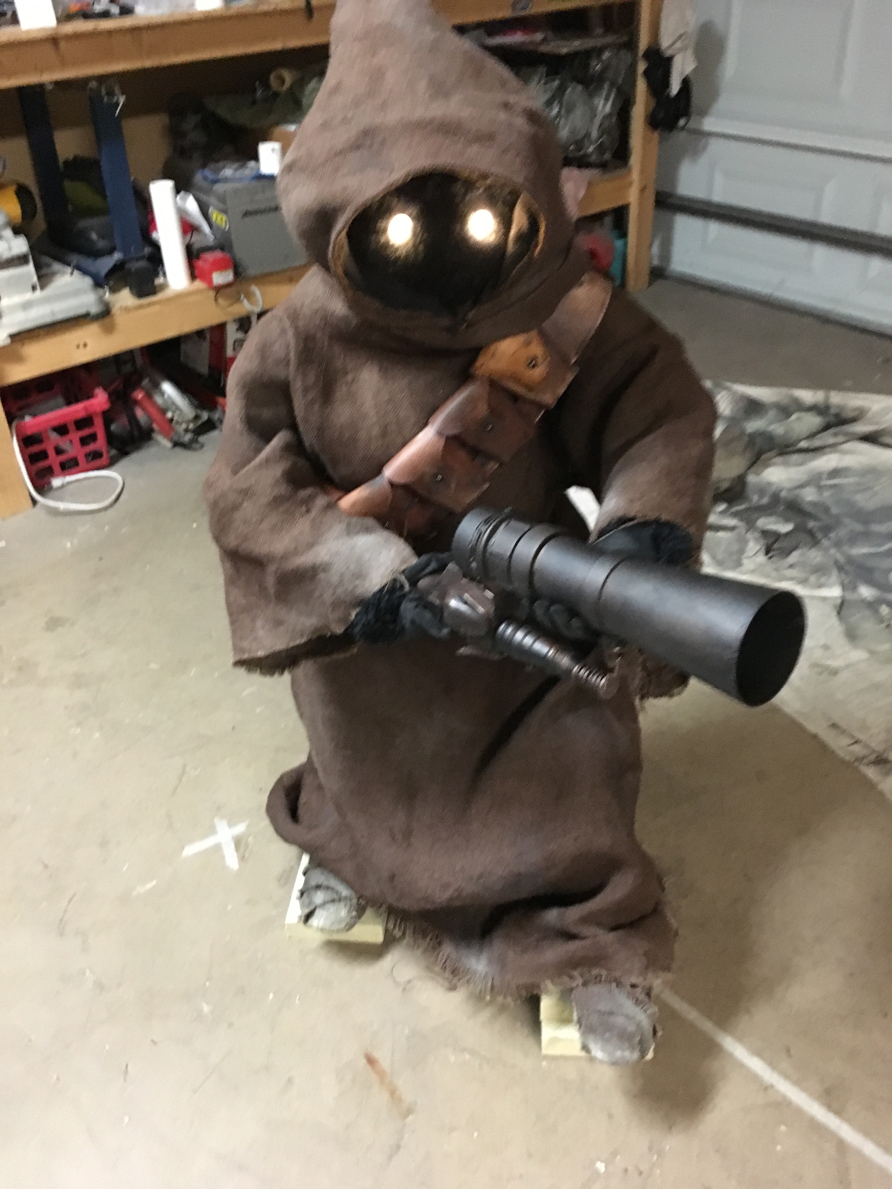

I then used an old sheet that I taped and rolled up around the body to give the jawa a little bit of body. Anyway, here is the Jawa on the mannequin. Hope you like it. I built this costume. Down to the blaster. I still need to fix it up so that it looks like he is standing on the Tatooine desert. More images coming later.
