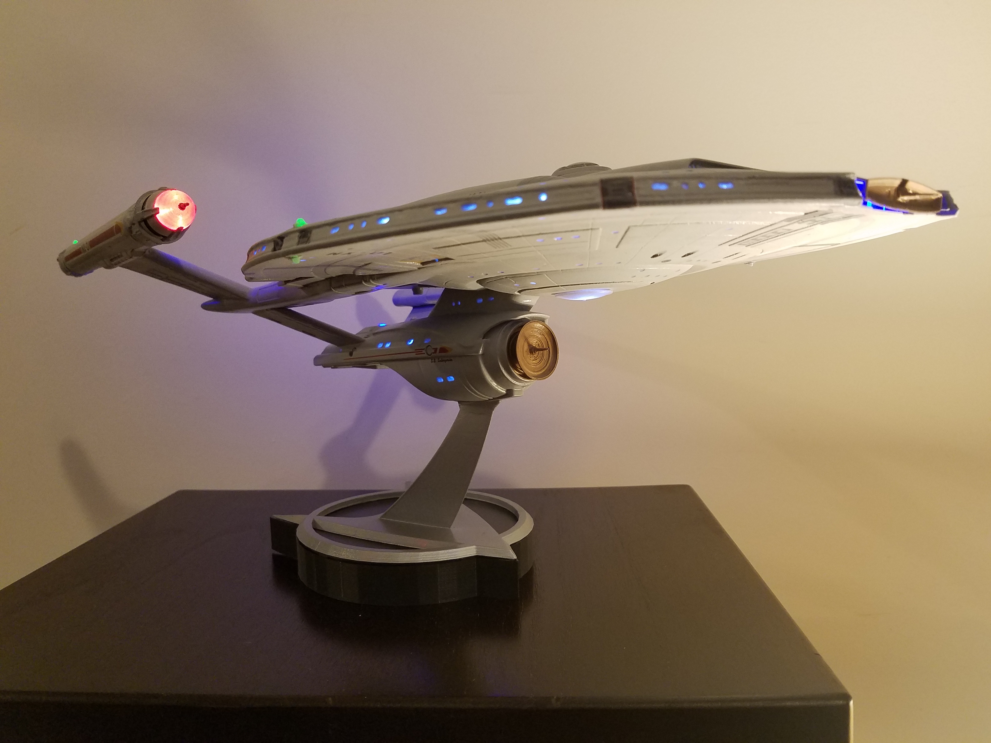

I also use Sharpies a lot in lieu of paint - metallic Sharpies look pretty good, and the regular ones can be used to color transparent things like LEDs, and they dry quick, too - I guess I'm impatient, so I look for things that work fast. I used them on my 3D printed NX-01 Enterprise for the bussards and other parts (I wanted more of a TOS look, hence the orange tint to the bussards). I used the liquid paper and metallic Sharpies in making this too:

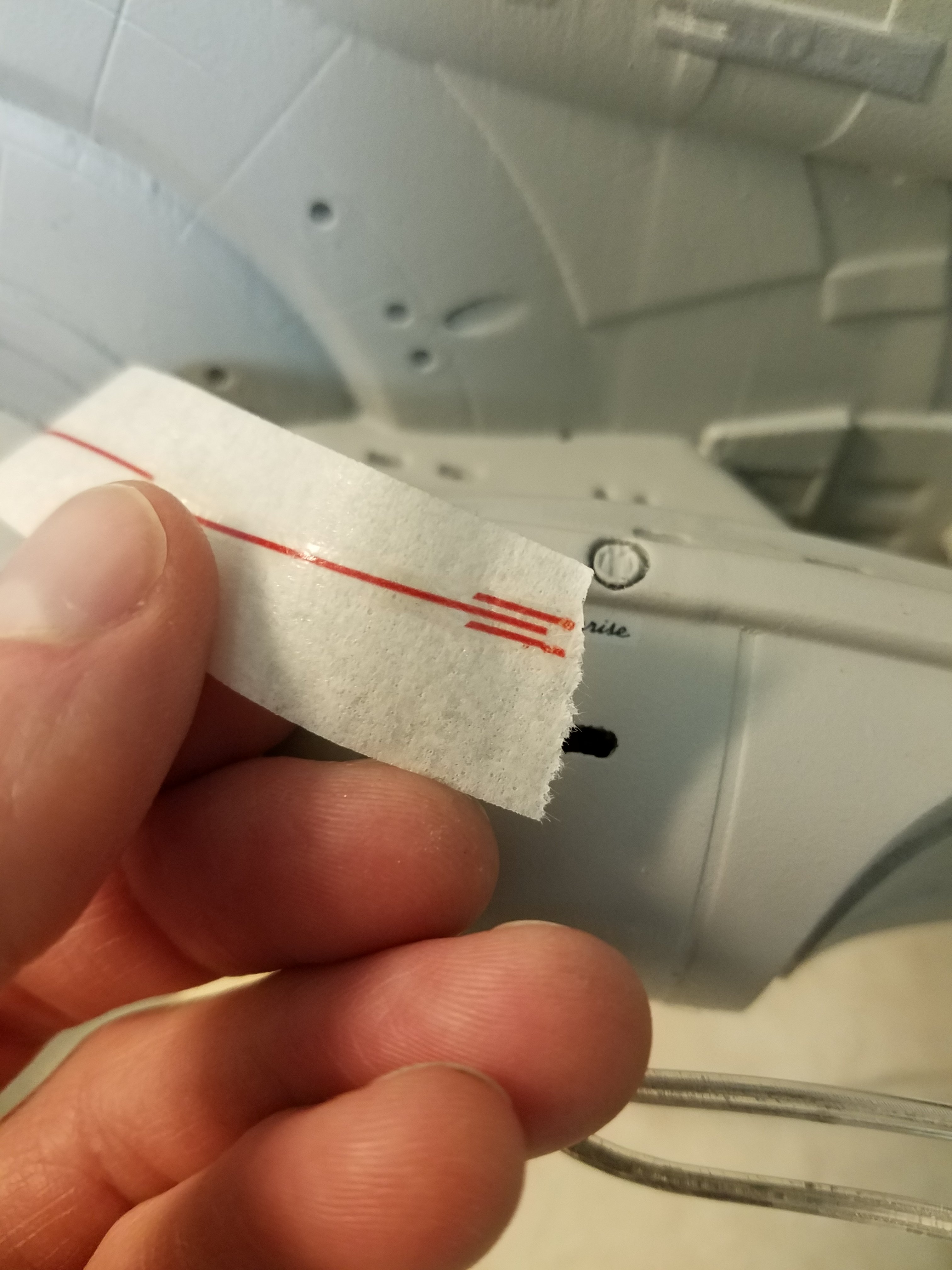

I also found out (by accident) that masking tape can ne used to take off decals (at least the inkjet printed waterslide decals that I made):

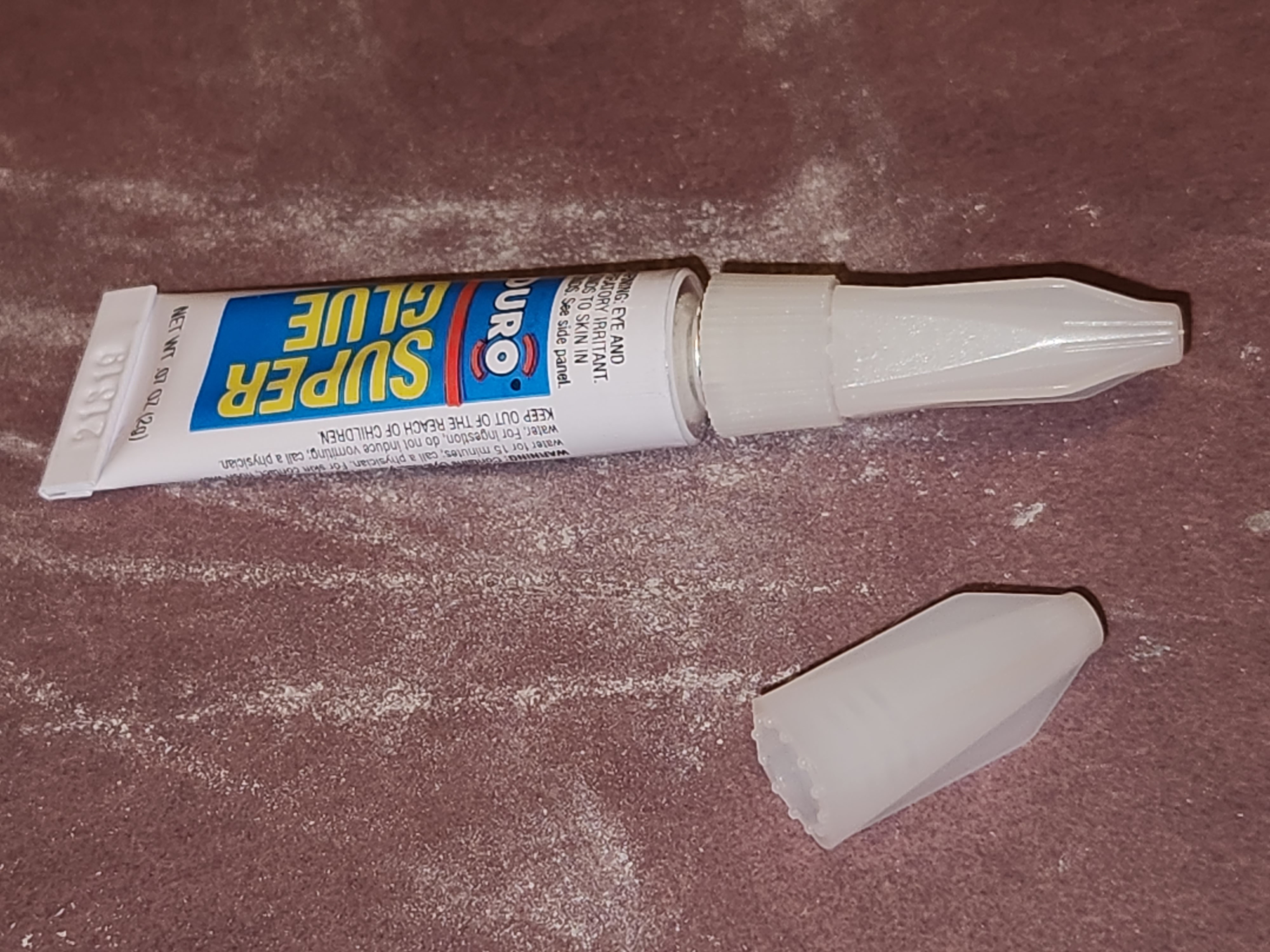

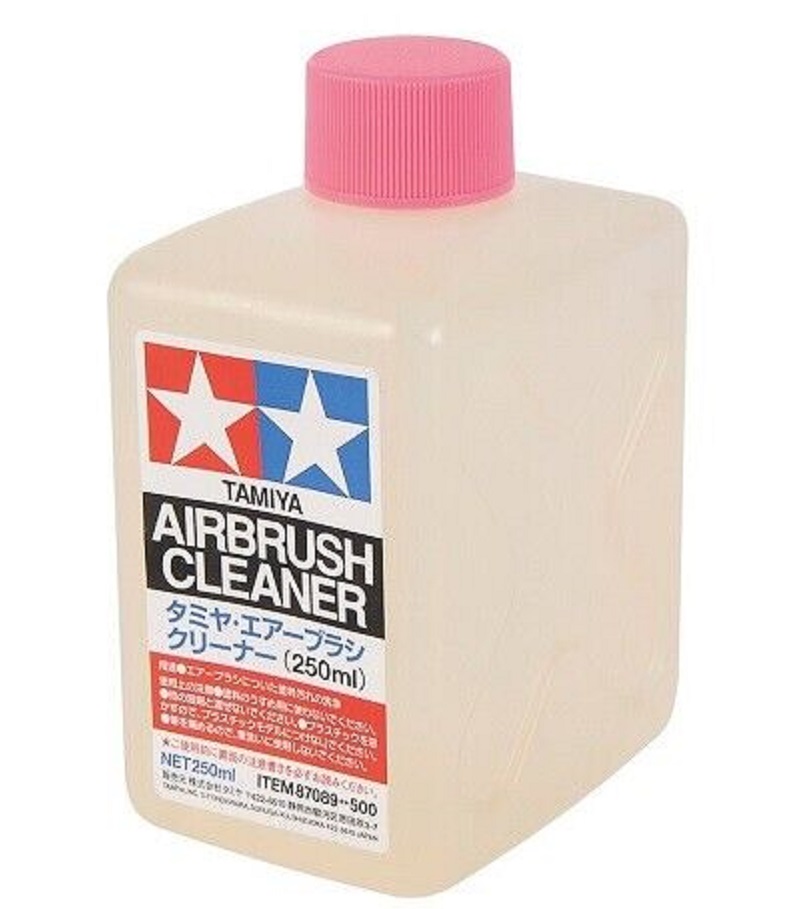

^^^ So, the cleaner acts like cement !...., how reliable is it when holding plastic together in the long run ?
You will not be able to tell the difference. In MY opinion, the Cleaner works better. Probably because it's 1/6th the price.

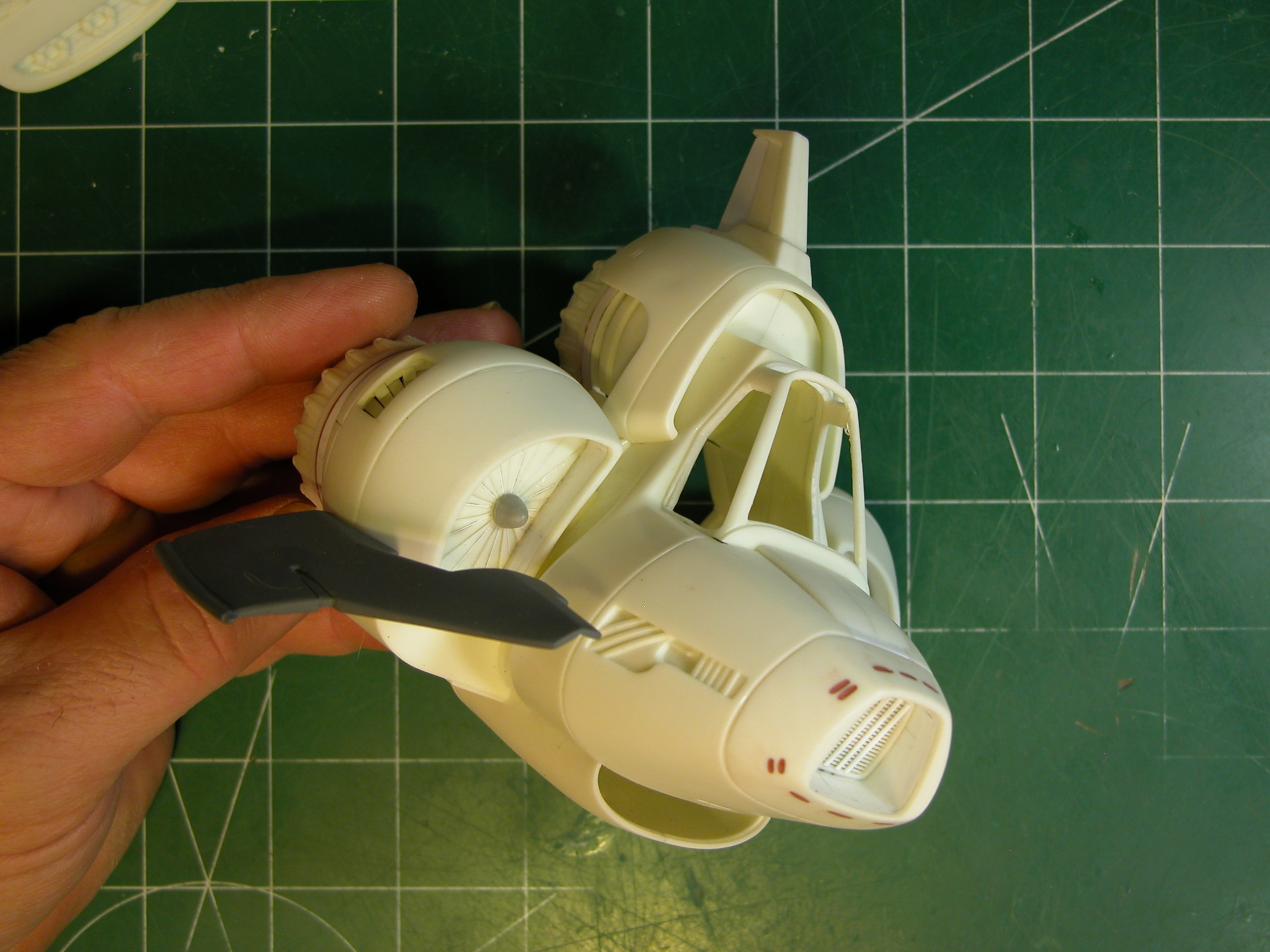

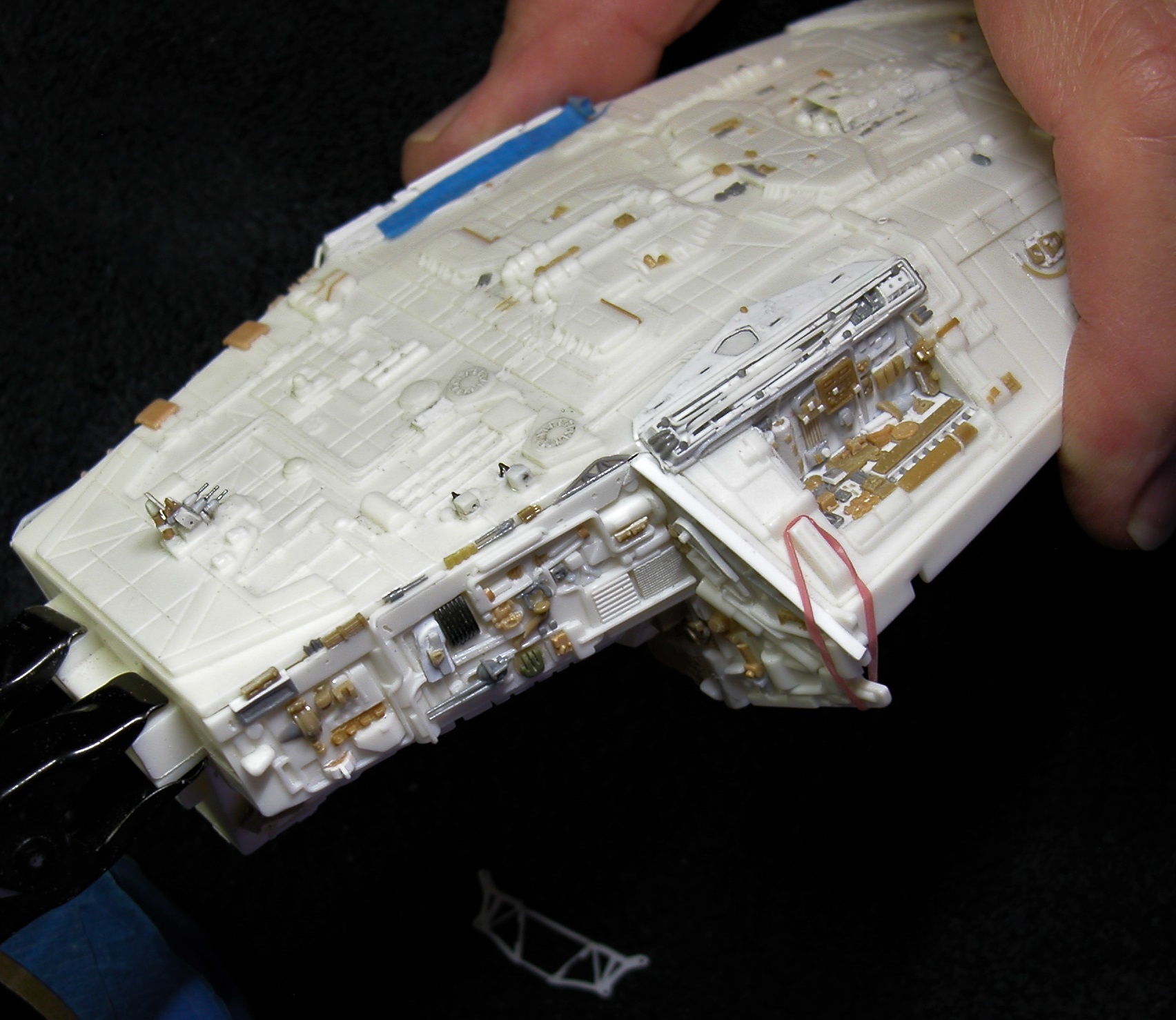

Here are a couple of examples of things that are Airbrush Cleaner-ed together.
I haven't used the actual Extra Thin for a long time.
Rob.
Rob.
Well, the cement is worh it ONCE for the applicator's convenience features, after that it's the thinner and a pipette or syringe all the way.

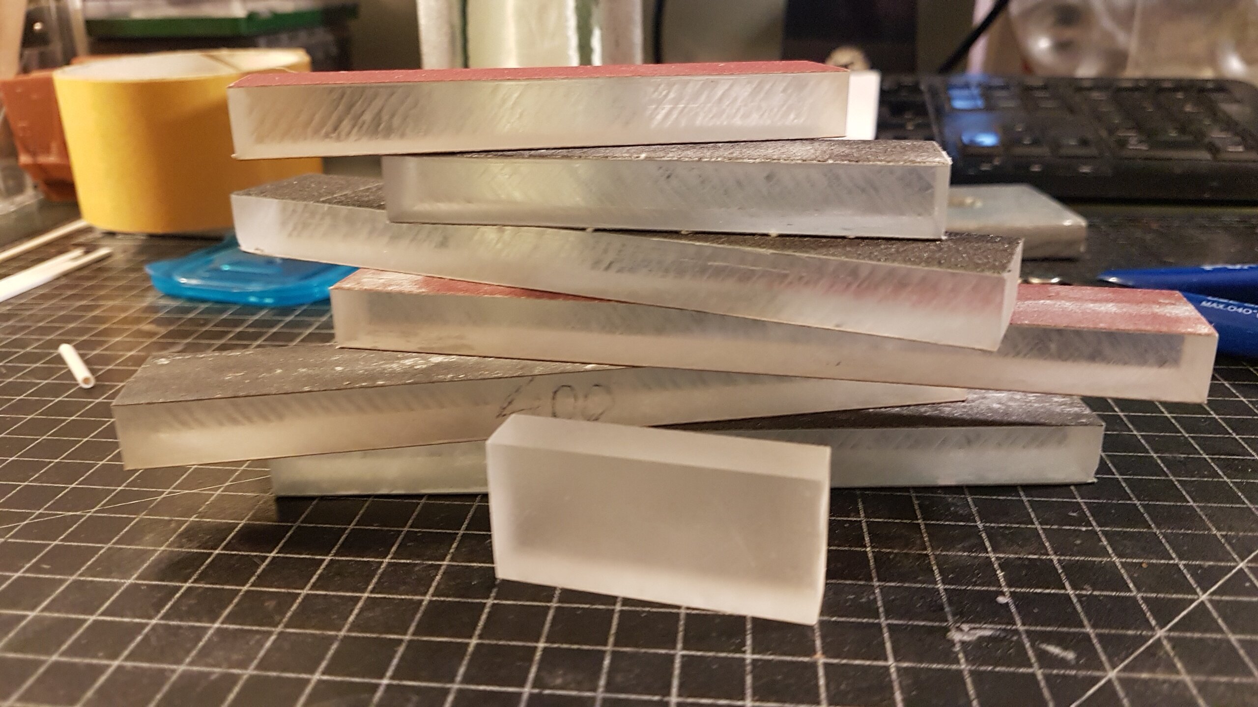

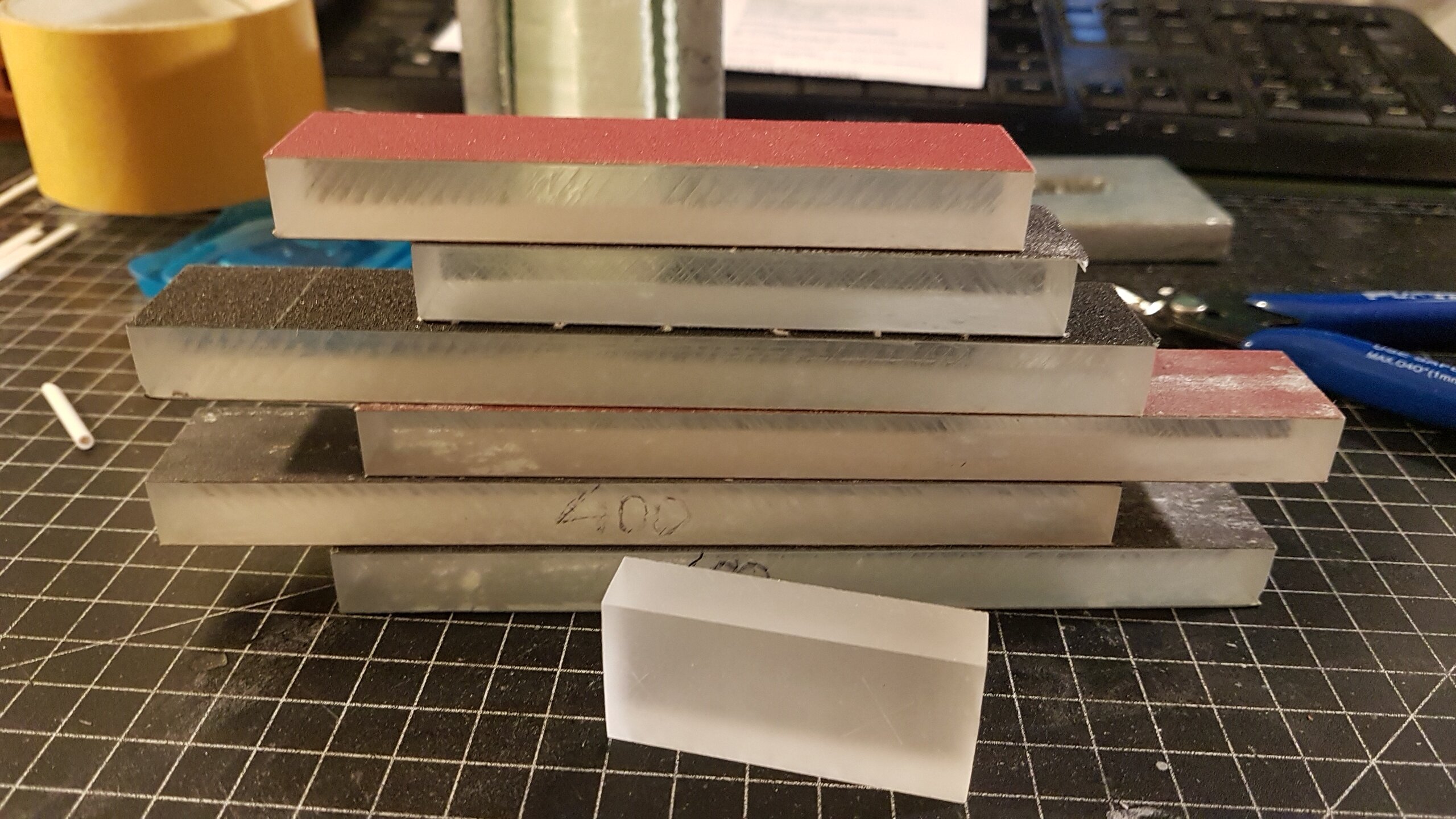

selfmade absolute non bending sanding sticks made from:
acrylic glass leftovers (1 meter 2 €) double-sided adhesive tape and sandpaper with different grains
