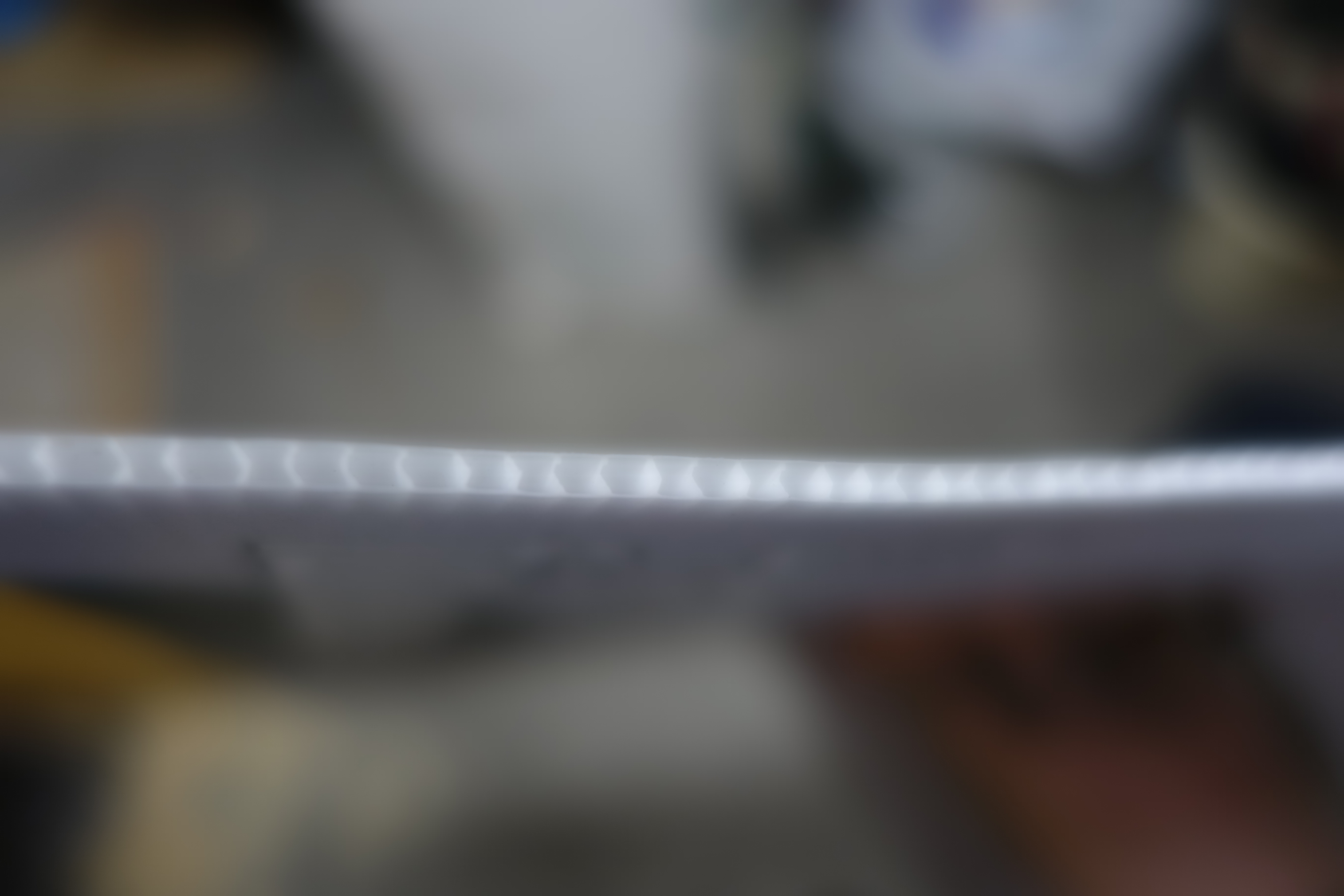

Whenever it is election time, there are tons of posters hung out, almost all of them are printed on a type of styrene that has the same ribbed inner structure with an inner and outer wall (like cardboard). Of course I wait till after the elections are over to go harvesting, but these are great both for a styrene substitute and excellent for making boxes for pouring silicone moulds. The latter because you can just cut one wall where you need a corner, bend it and so on. I will add a picture this evening when I get home.

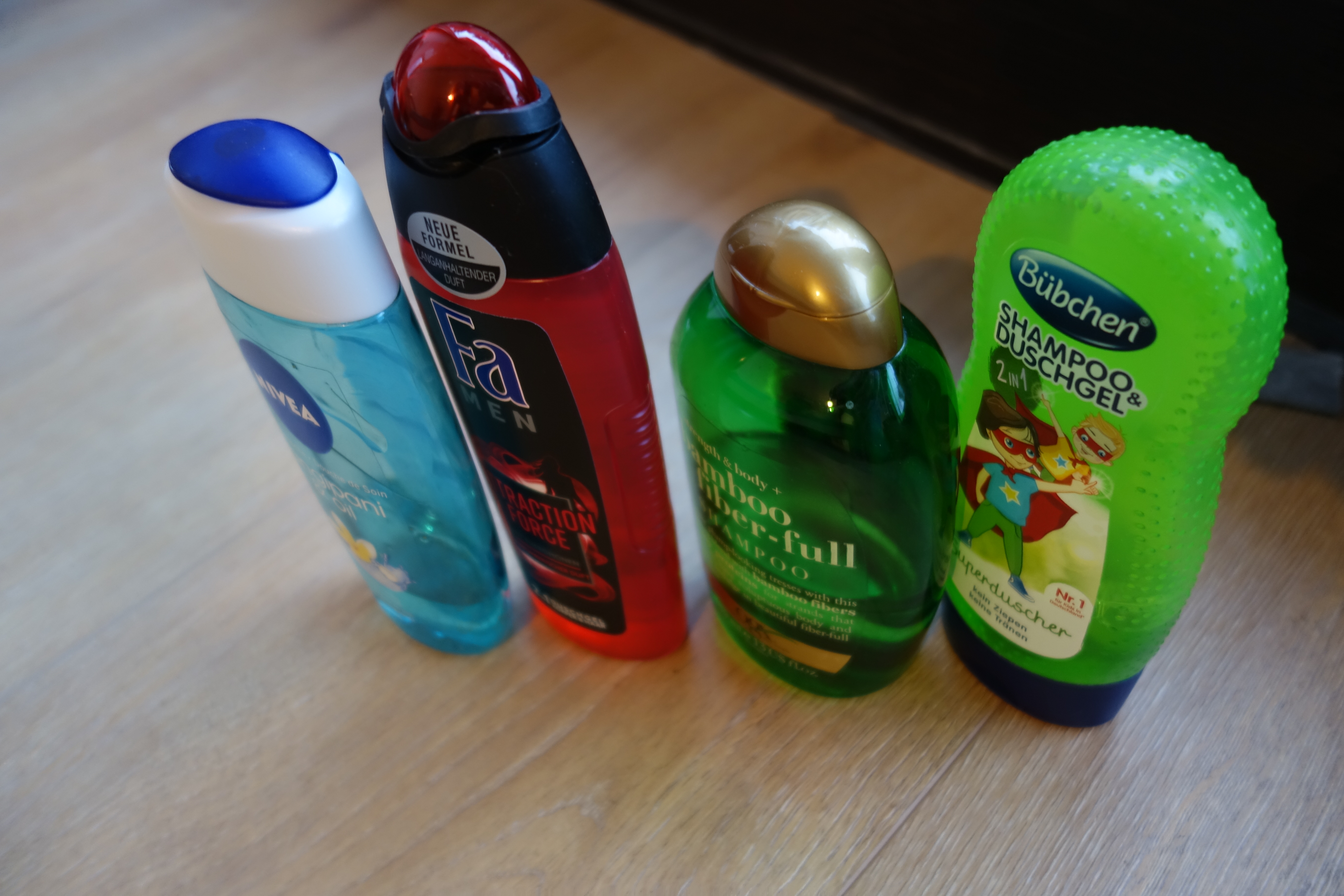

I also use shampoo bottles (or any kind of plastic bottle really) that have a colored transparent plastic to use for lighting. It is much cheaper than the sheets of colored transparent that you buy at hobby shops.
