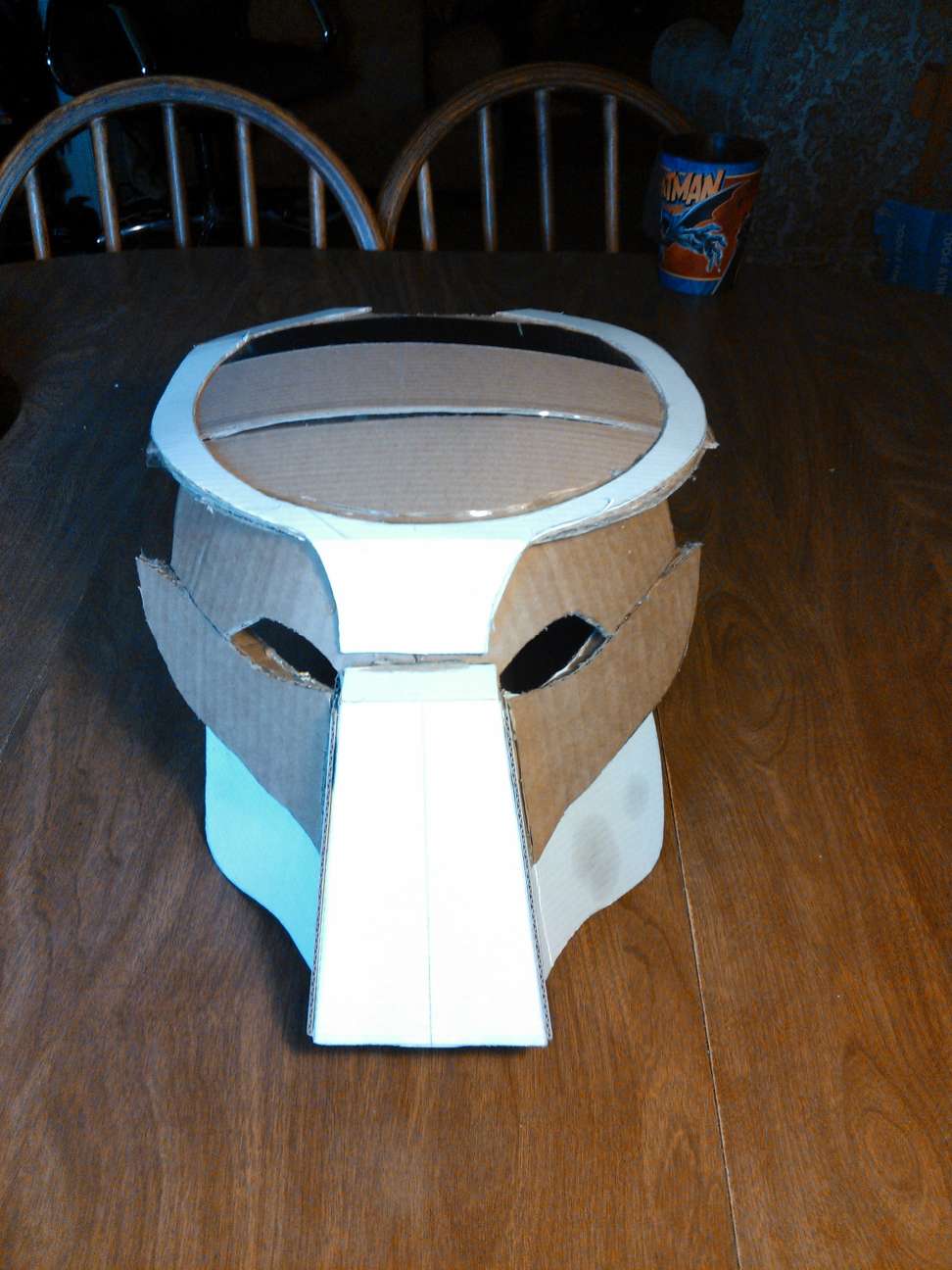

I am using cardboard. How would I do the dome? My past works with the dome always turned out it me just putting lots of creases un it. But I won't it to look legit
Are you putting resin over the cardboard? If so you can always put bondo or body filler over the entire mask and sand it to smooth it out and you won't see the crease lines. Check out NeXXt's Wolf bio build, use that as a guide as to what you can achieve using paper or cardboard.
This is whatI've made so far
Why don't you use a piece of craft foam over the cardboard slits or creases in the dome part?  It will add a smooth shell ontop of the lines.  It's what I did for my little girl's bio.  If you go to the thread you can see the cuts in the bio frame I made and then the finished smoothed out dome after I heated and molded a thinner craft foam over the cut pieces.  There are a bunch of tutorials on YouTube but here's the link I used to get the concept.  She heats the foam with a heatgun and molds it over a ball, but you can just do what I did and heat it over a stove and smooth it over your bio dome. http://www.youtube.com/watch?v=hj-WC35cxgs
Here's the link to my little ones build so you can see the steps of her bio.  http://www.thehunterslair.com/topic/30932-kaylas-mini-build-photoshoot-up-last-page/?hl=%2Bkayla%26%2339%3Bs+%2Bmini+%2Bbuild
You have a great start on it.... Keep up the great work!

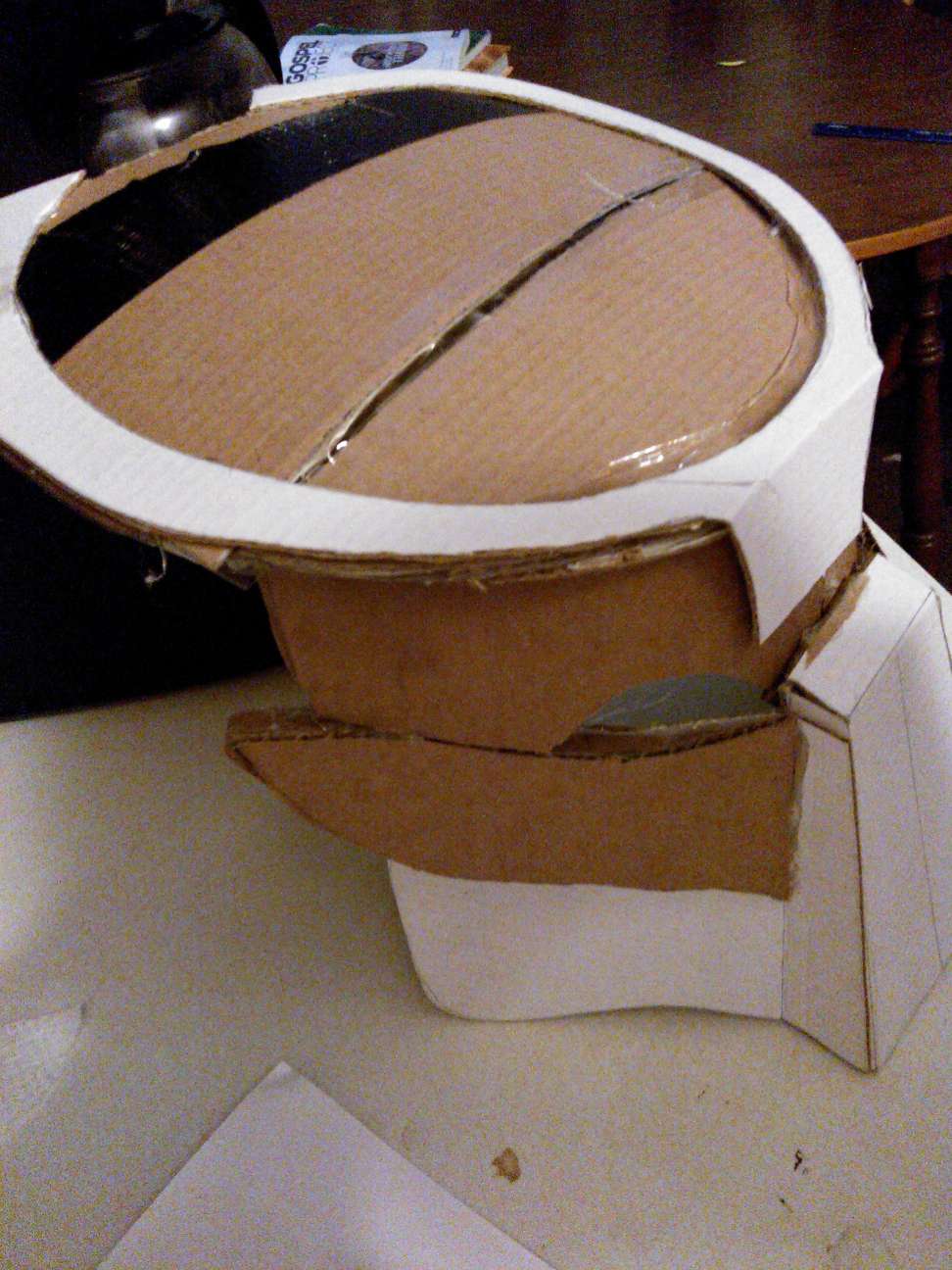

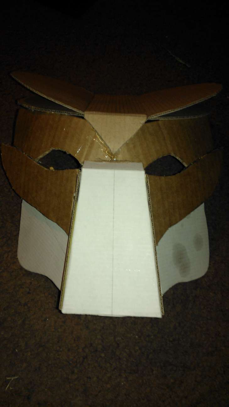

So I traced a plate and cut it out. I then cut I in 3 tiles. I used a table and gave them a curve. I hot glued them which left me with it raised. Then I used the same plate, cut out the rim and there we go. Not the best work, but it's as good as I can do now.
