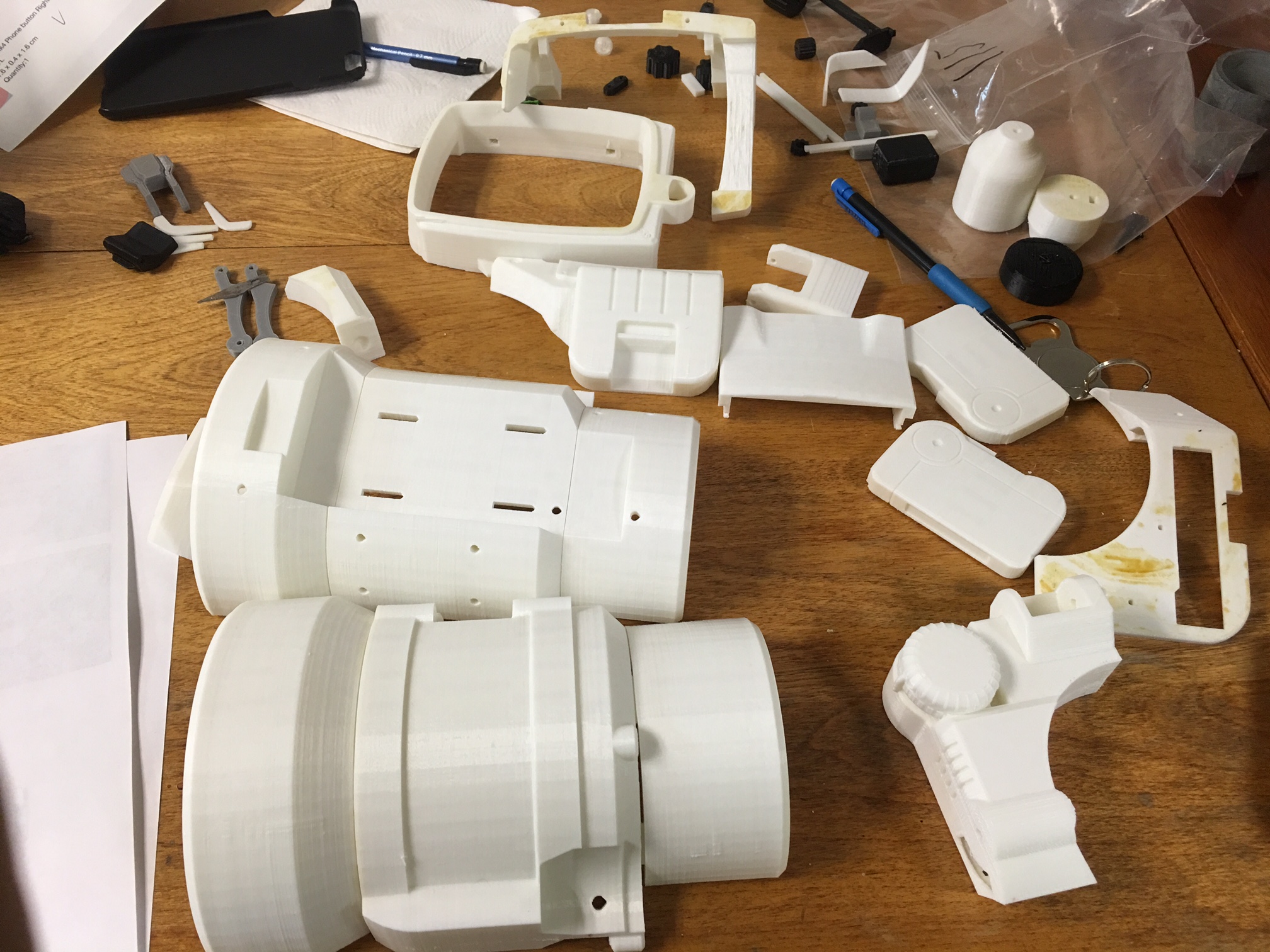

So here's the kit as it was out of the box with the main bodies test fitted together, nothing glued.

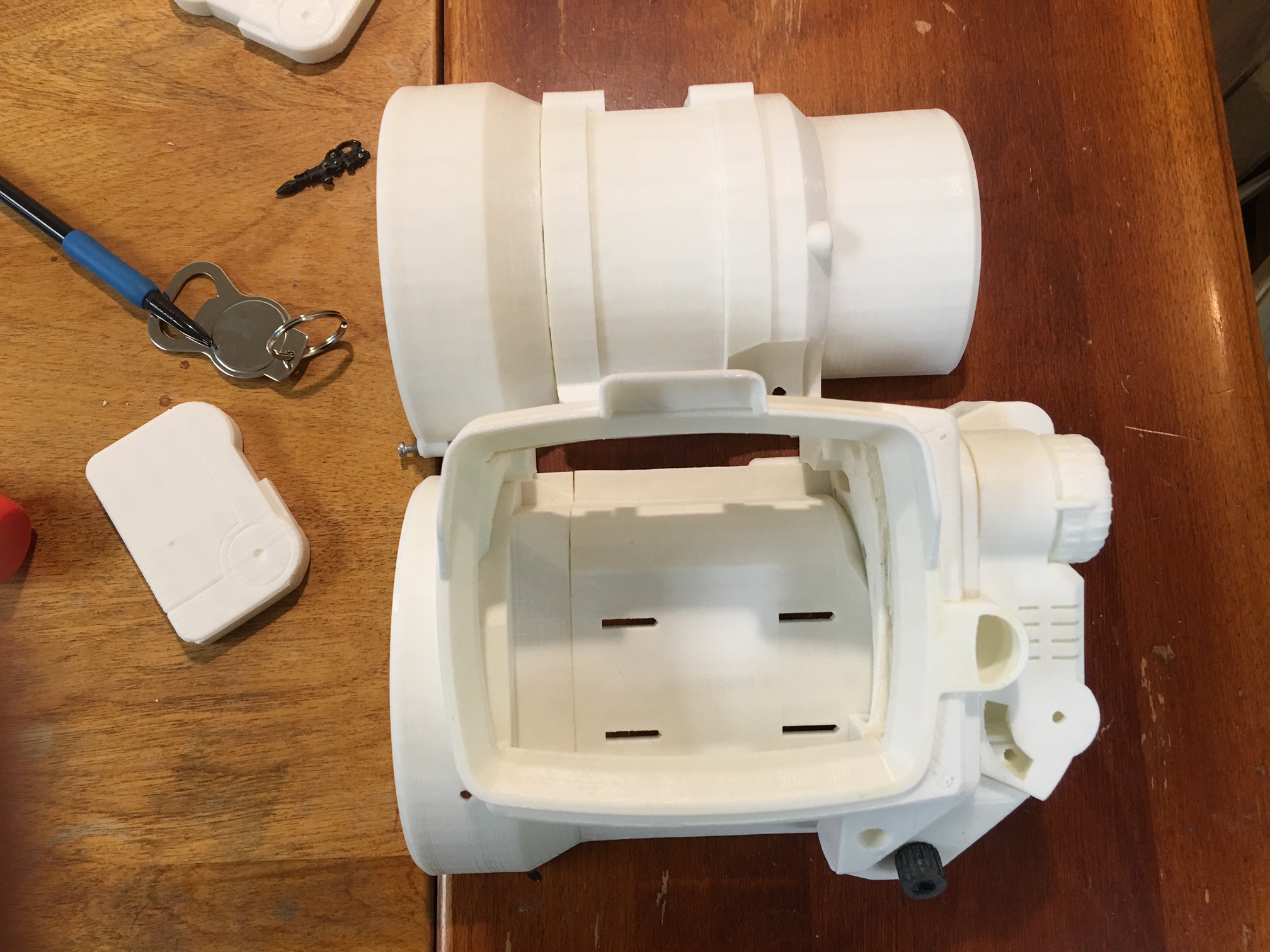

Started gluing things together here.
I saw some separation between layers only after sanding it down a lot and using filler primer to get the 3d print lines out and apoxie sculpt to fill in the gaps, I got worried as they seemed to line up with the hinges and I didn't want the stress of wearing it in the crowds of dragoncon to break and fall off my wrist. So I fiberglass resined it to hold together. This explains the greenish color

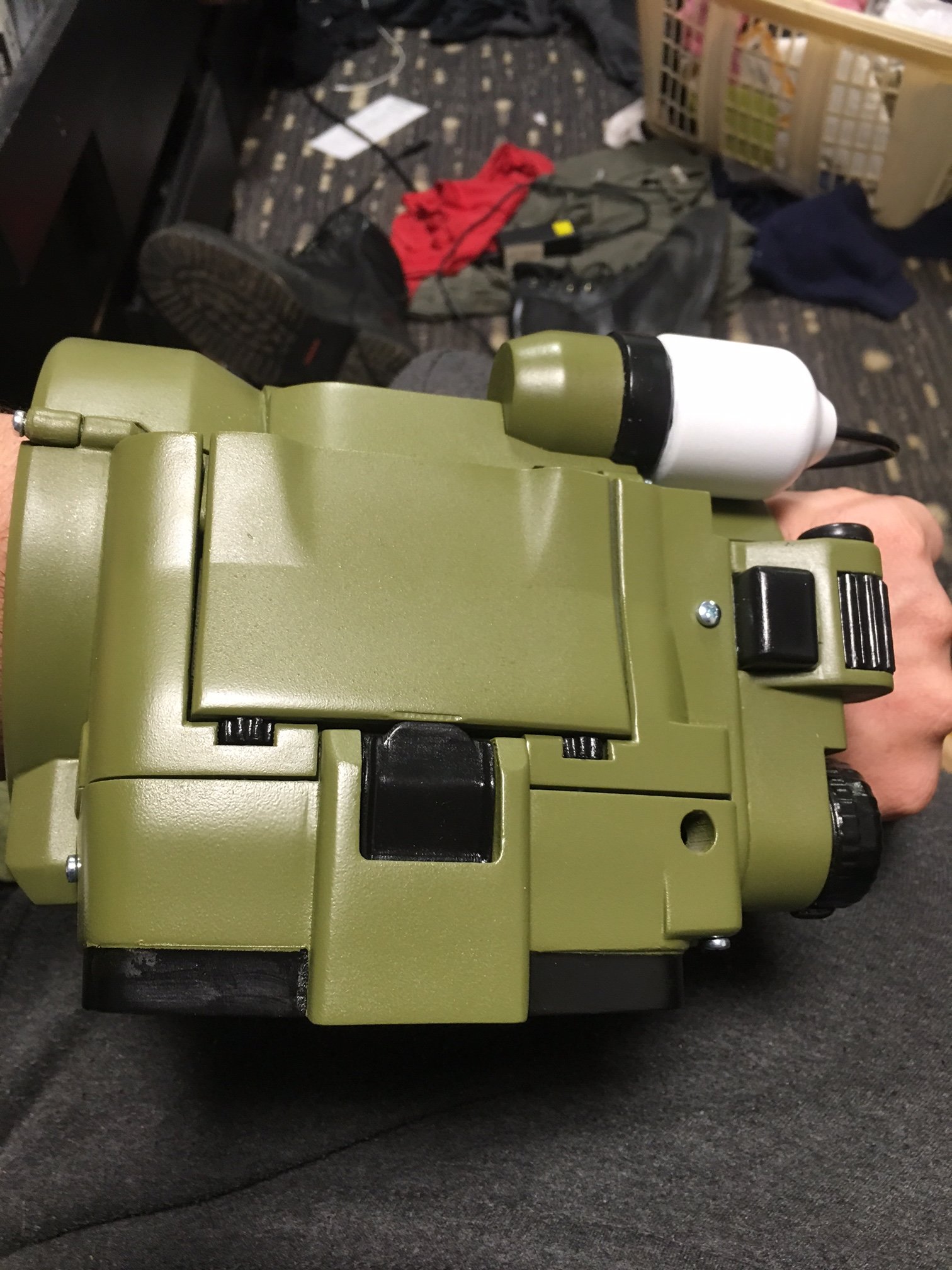

So after getting the surface to where I wanted it, it was time for paint. I went with Montana Gold Reed green for a base to work off of. I also blacked out some areas with a normal gloss black, added some silver to a few places and added real hardware to make it pop.

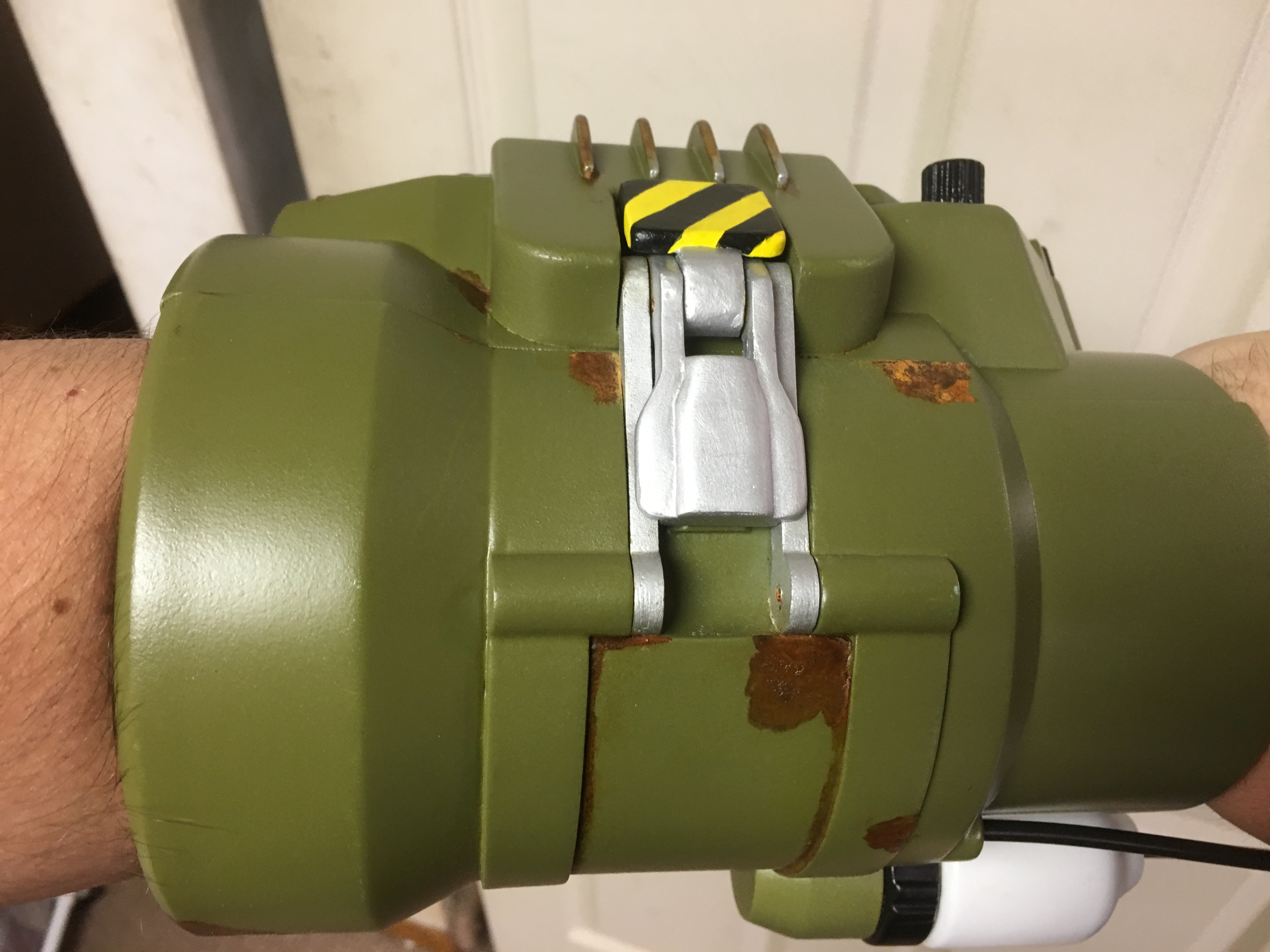

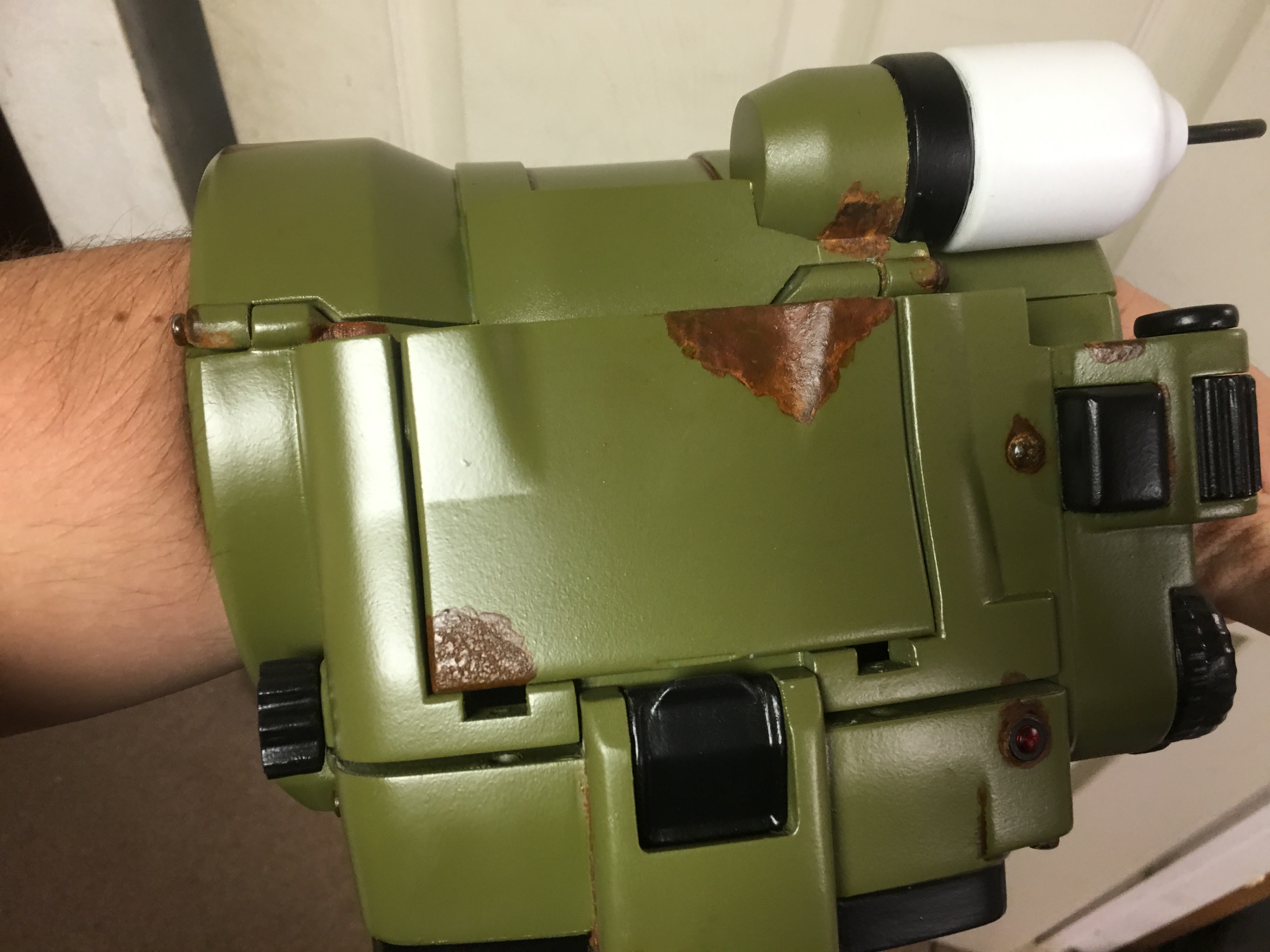

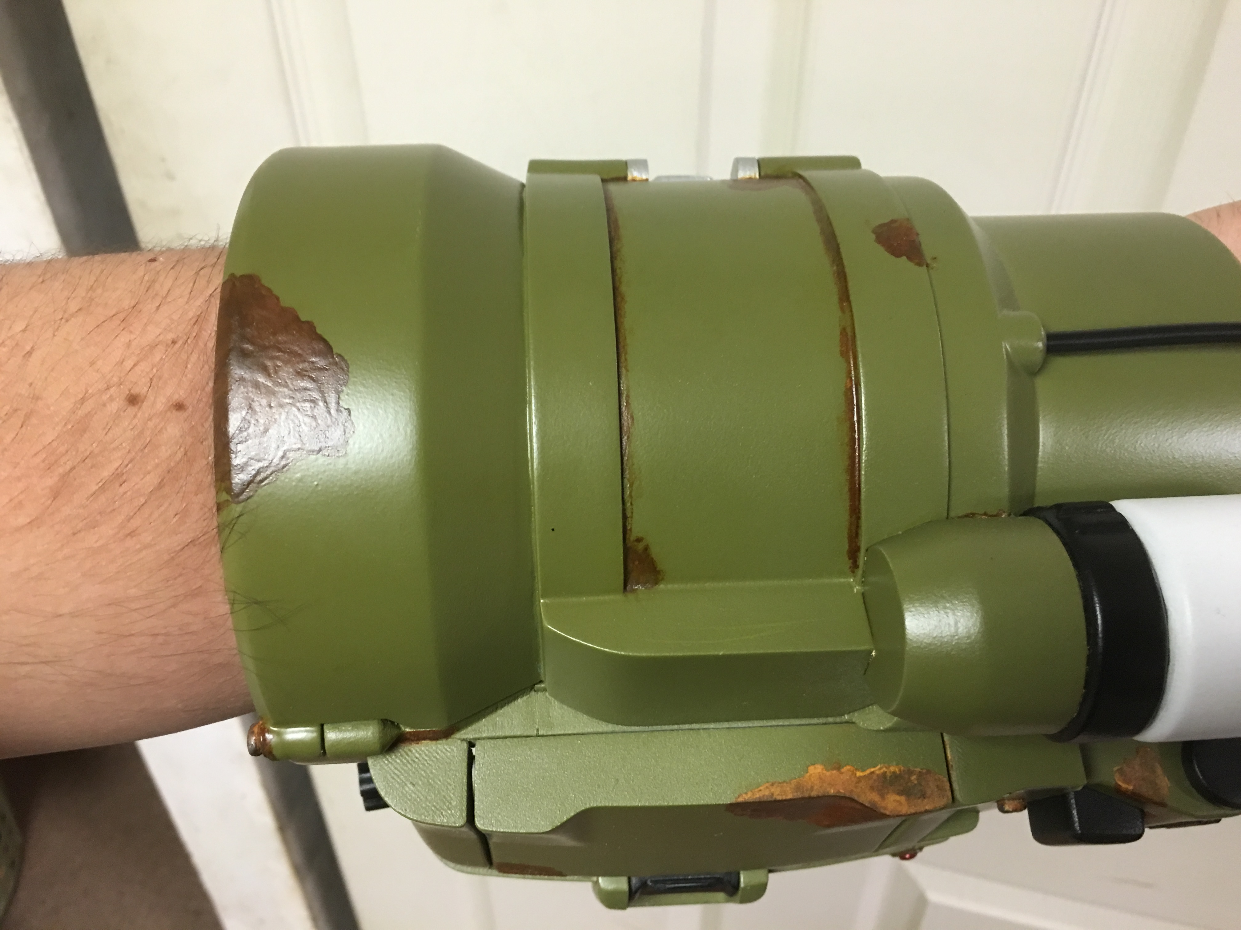

Now I am waiting on some LED lenses because I hate the 3d printed ones that came with the kit and some paint from Sculpt Nouveau for a rust effect that should work great for making this pip boy look like it was out in the wasteland. As soon as I get those in I will post more.
