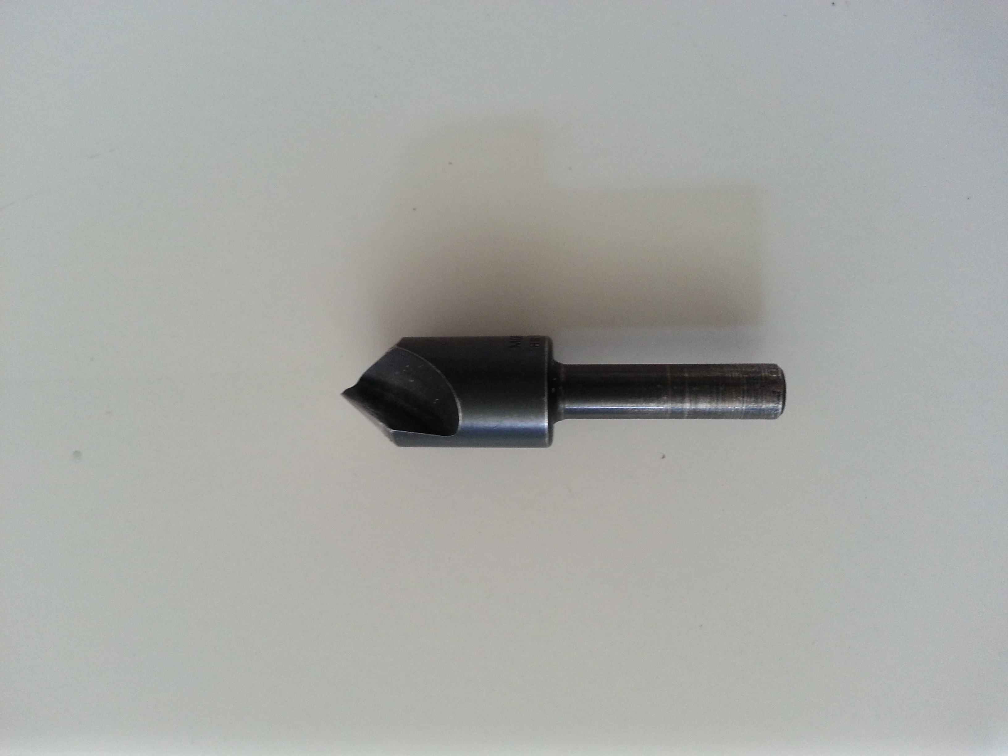

This is a normal type of count sink used for tapering holes for flat head screws.
As you can see it's much to big to go through the top access hole in your nozzle.

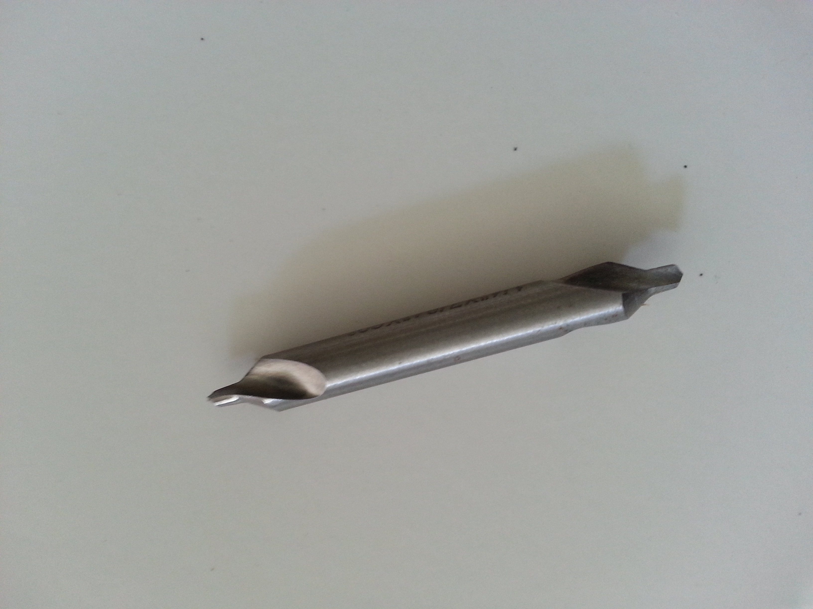

Here's a little trick I use.
I don't know the technical name of this little gem but it's used with a lathe's tail piece to make
a centering hole when a piece is to long and needs to be supported on both ends.
It works quite well as a counter sink.

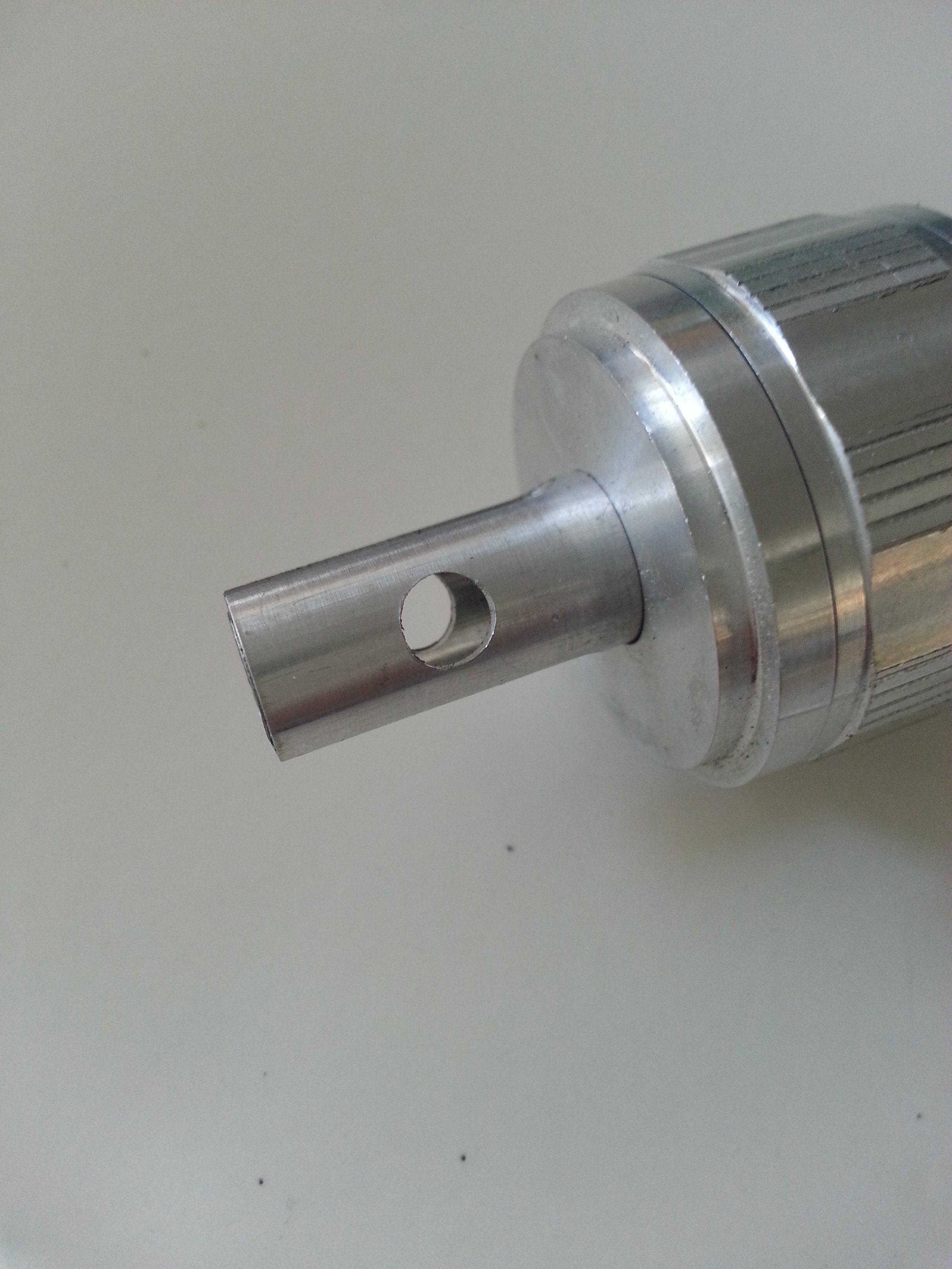

You may have to slightly enlarge the outer screw hole on your nozzle to get to the bottom screw hole.
I would recommend turning it by hand a little bit at a time until you get the results you want. Do not
use this in a drill cause you run the risk of going all the way through and ruining your nozzle.
Hope this helps....
That's a center drill. That's what I use on the lathe for opening centers, both for starting a drill operation and for opening a divot for use with a live or dead center in the tailstock. I prefer to call it the Center Divot Thingy 3000, because marketing. We have all kinds of those things, and countersinks too, but I was hoping to figure something out that didn't involve opening the outside hole.*

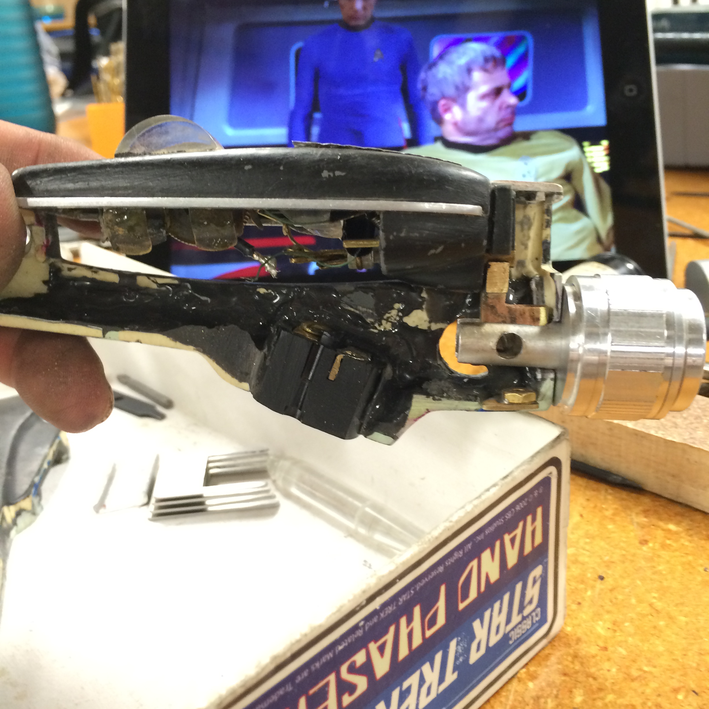

Ugh! Bad day at black rock. I had the entire receiver mechanism perfect, and then when I went to drill the hole for the wire that connects to the return spring, the shop bit I was using was dull, and the pressure (and the heat) actually twisted the damn thing out of alignment! Plus there's a broken bit in there now. So after nailing it, I have to nail it again...
I'm back to the shop tomorrow (Sunday) to do it all over again, and I'll probably post the whole thing on Monday. Meanwhile, here's a couple of shots of tonight's near miss...

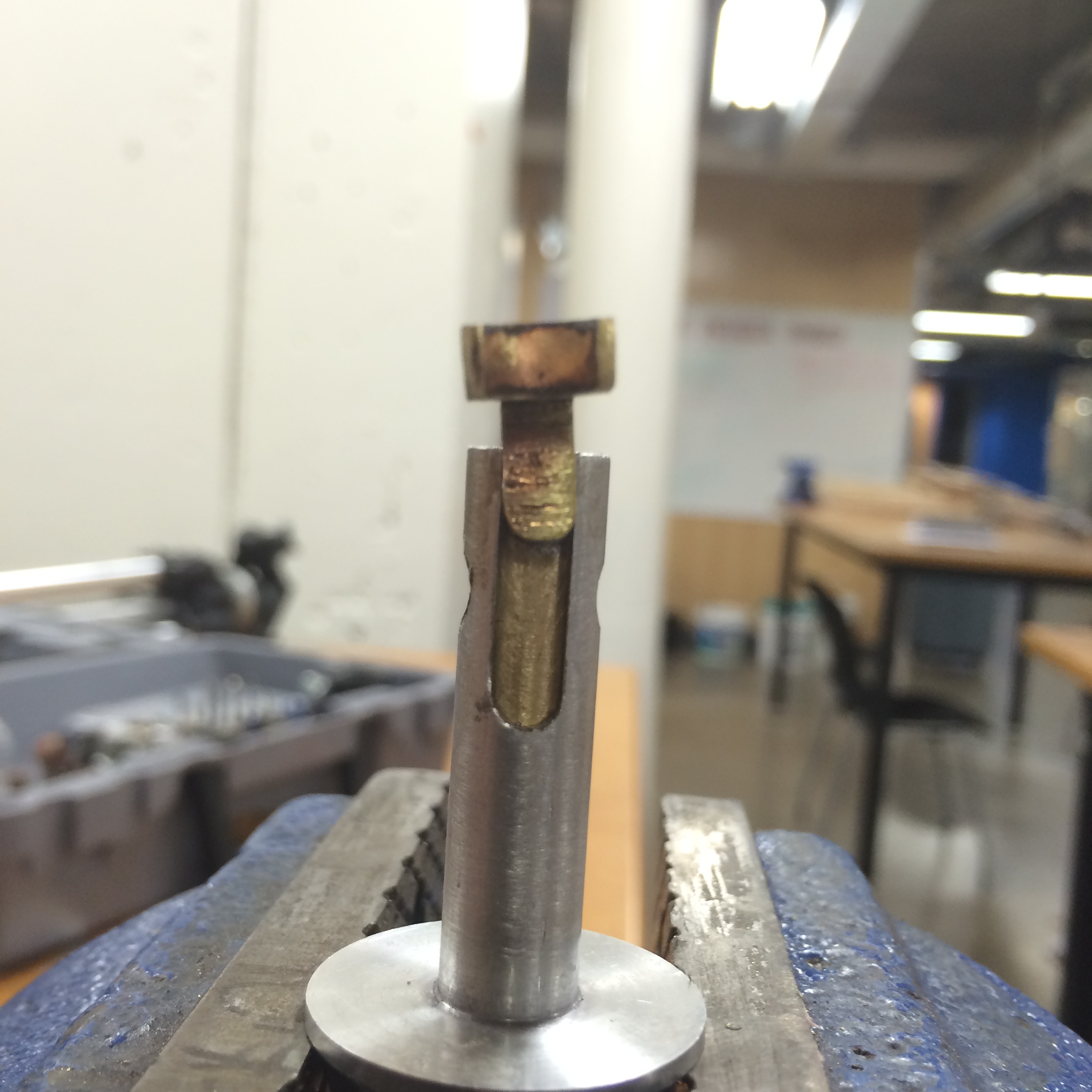

I have to create a jig to solder together the brass slide, since all my hilariously inept attempts at creative clamping have just been... well, hilarious. Well, hilarious now. (Yes, as usual, I'll post all about them, once I'm over the trauma. :p ) That's my next step. I've said it before -- this piece gets 3D-printed if I ever make another hero (let alone six!).

Steve basically has it when it comes to the brass rod and the return spring. The front latch part is shaped differently, but that's what Todd figured out in his diagrams. So mechanically, Steve has it nailed -- it's just the shape of the front thing he needs to fix.
