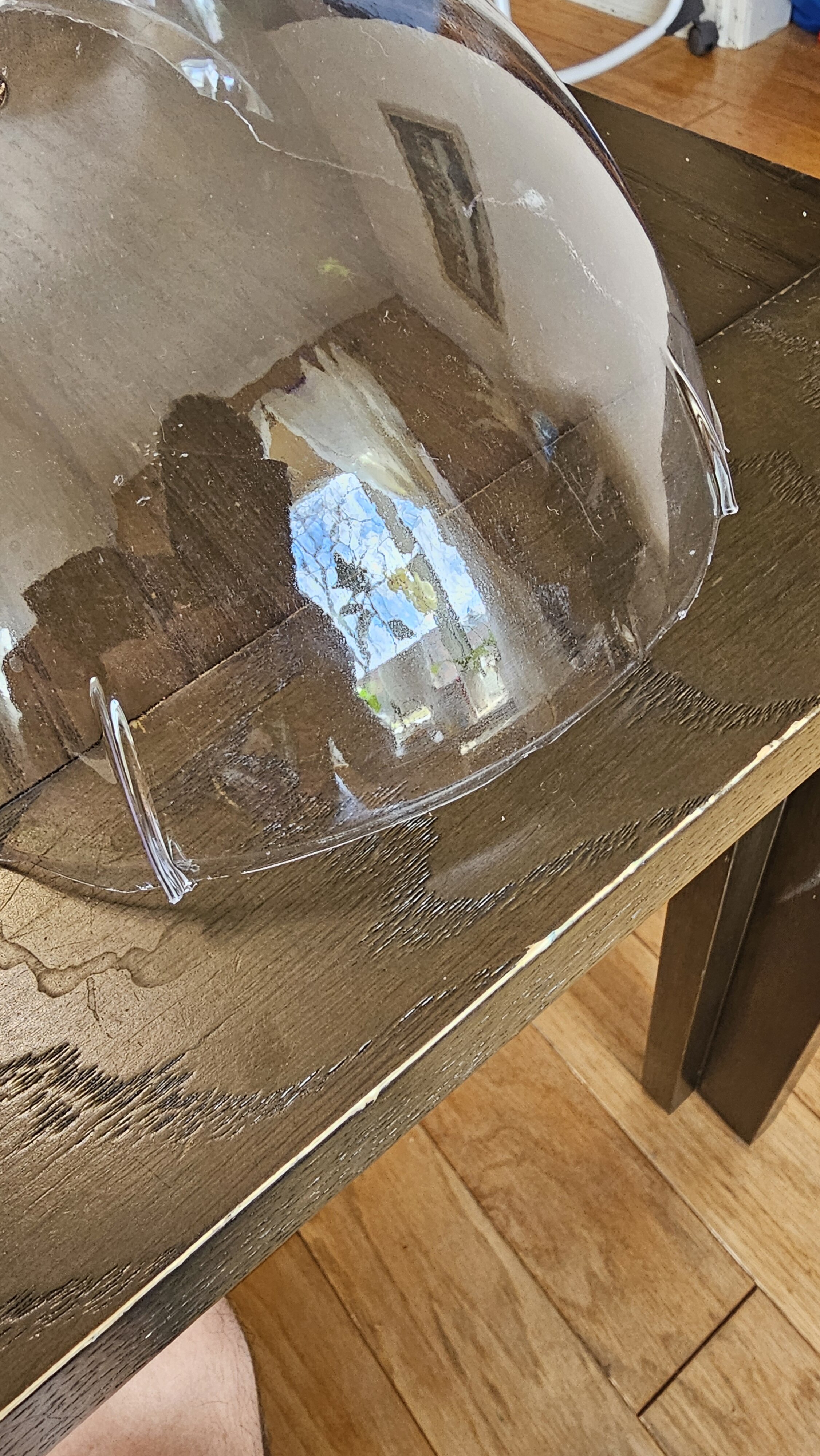

Hi guys. I'm trying to finish the visor for my son's Daft Punk helmet. I was 90% successful after vacuforming the 0.03 PETG sheet which I prepped for 3 minutes at 350F in the oven. I noticed the top part of the visor developed some folding, what would be the reason for this? And what can I do to improve it? Thanks

Elevate your mould higher by a few inches could help as well.

Hi guys. I'm trying to finish the visor for my son's Daft Punk helmet. I was 90% successful after vacuforming the 0.03 PETG sheet which I prepped for 3 minutes at 350F in the oven. I noticed the top part of the visor developed some folding, what would be the reason for this? And what can I do to improve it? Thanks View attachment 1874501View attachment 1874502
When prepping PetG, its more of a feel for me.
Wait til it starts to bow down, THEN QUICKLY place over the puck/buck and hit the vaccuum.
Also, 0.03 inches, less than a mm is very thin maybe too thin. It is very delicate and could fold on itself just transfering it to the vaccuum.
I have used 0.125 or 0.06 inch thickness.
