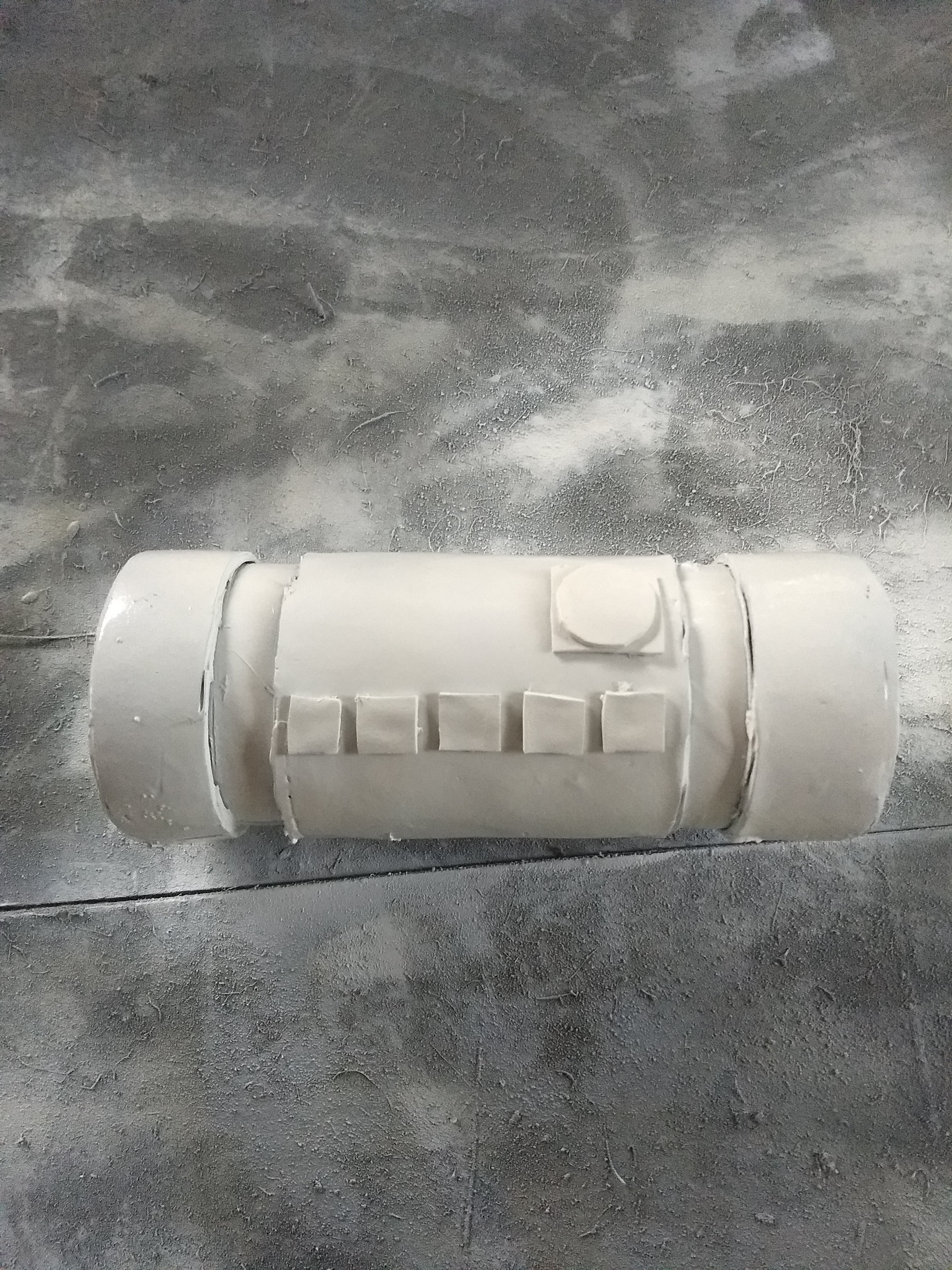

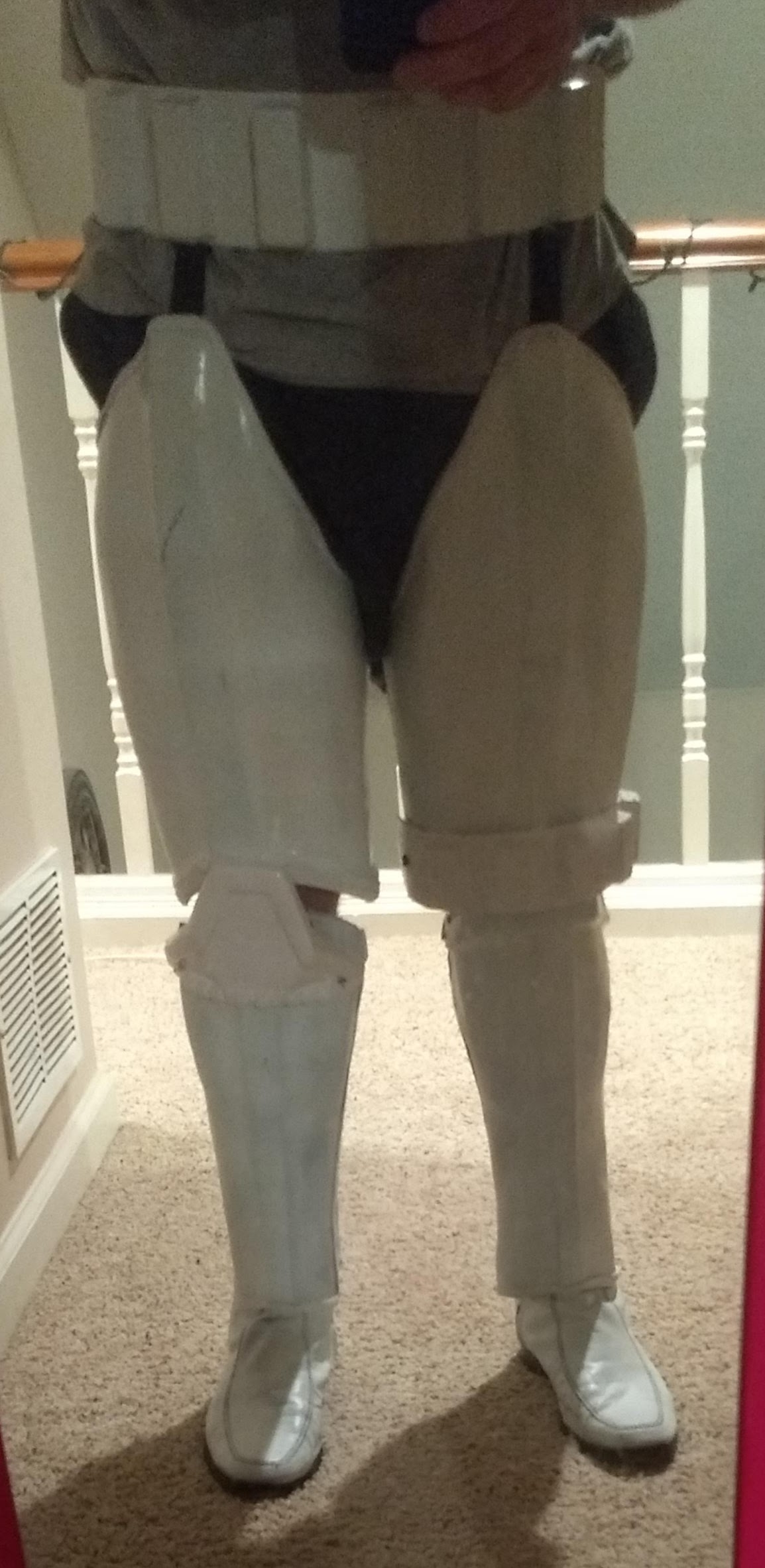

So all armor pieces are done! I haven't put the full armor on yet but here is a pic of the legs as well as the thermal detonator I am finishing up.
I got the pep files from Blaxymth and he is several inches taller than me so I did quite a bit of adjusting on the lengths and widths, especially on the thighs and calves. I had to cut them in half then add elastic to widen them so they would fit me. It ain't real pretty but gets the job done.
I cut up simple white craft foam sheets into strips and glued them to the edges to give a nice finish, prevent any sharper points catch my bodysuit and most importantly prevent the armor biting and pinching me.
