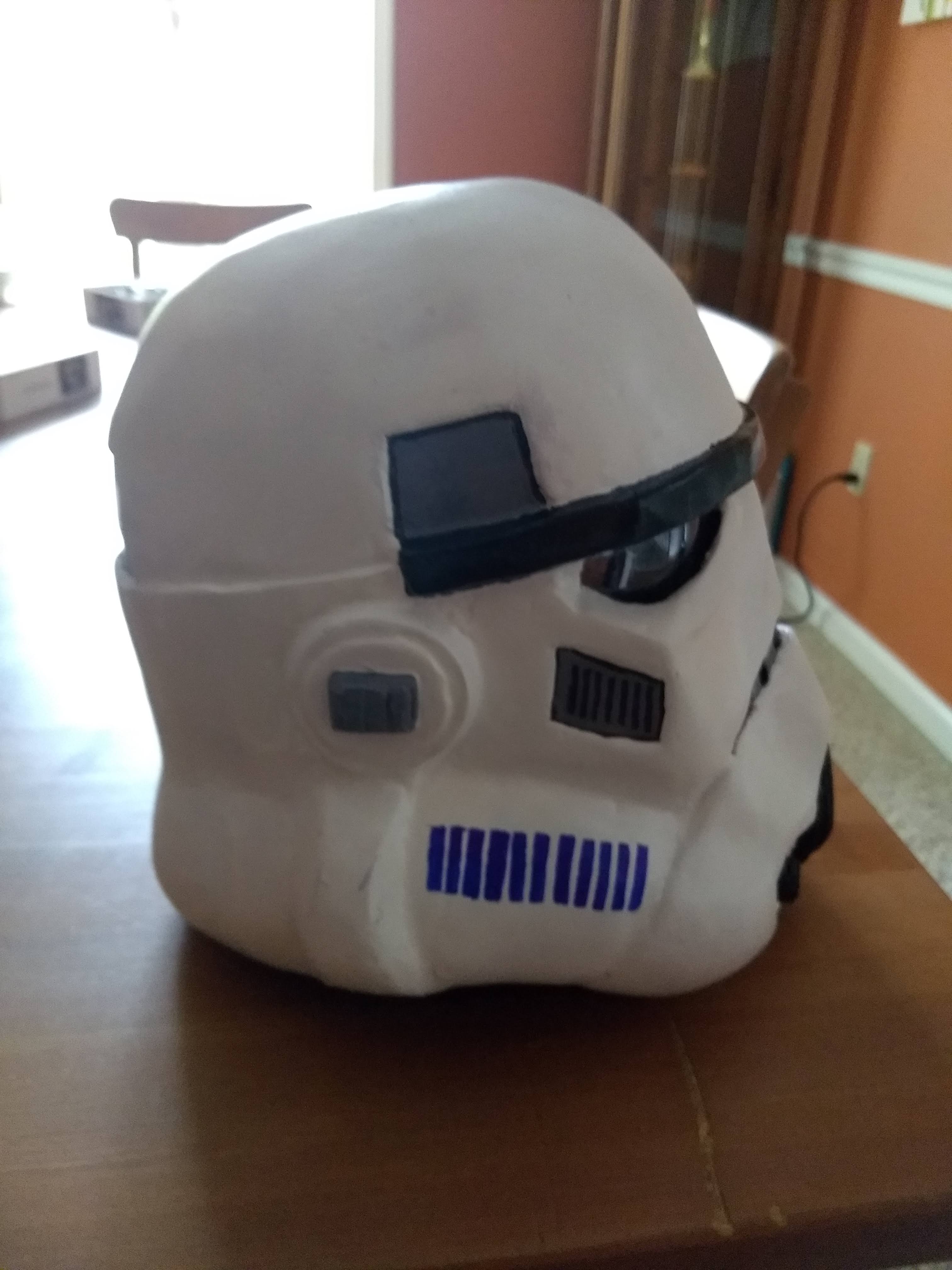

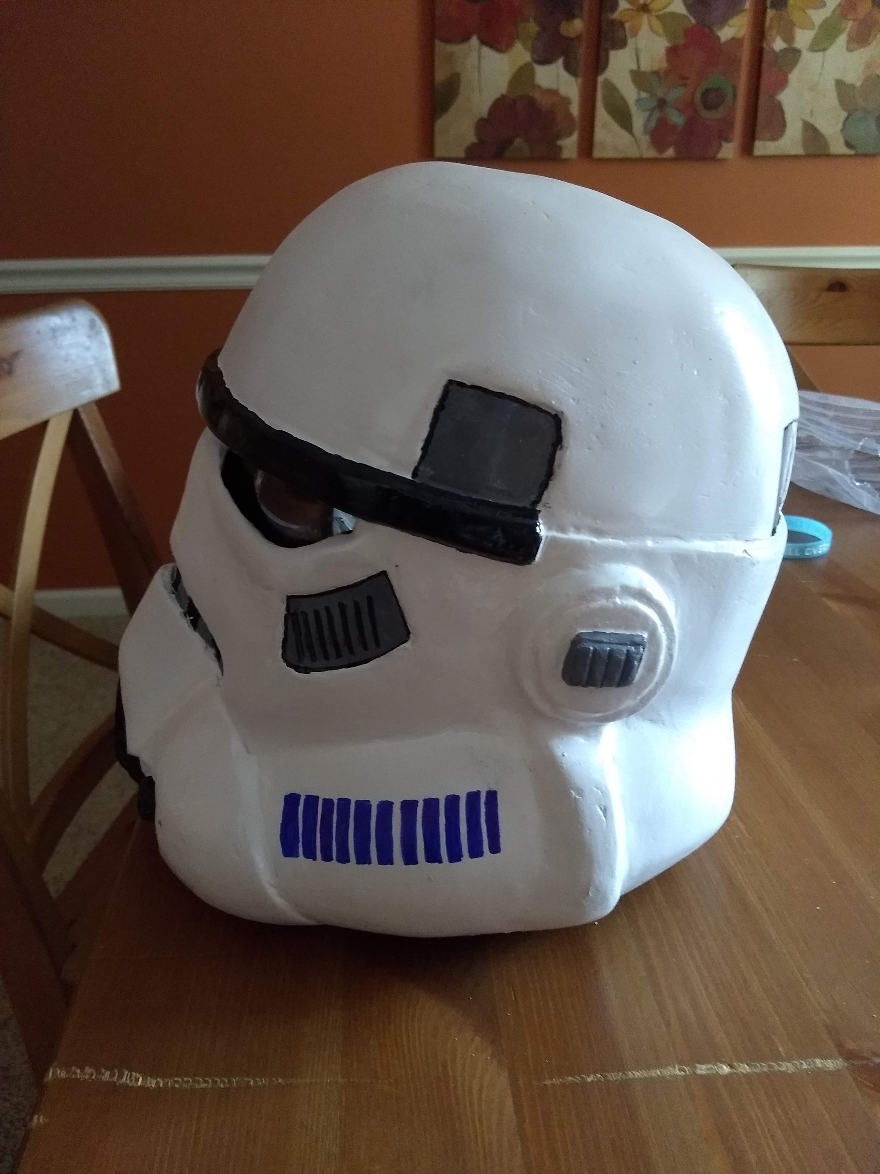

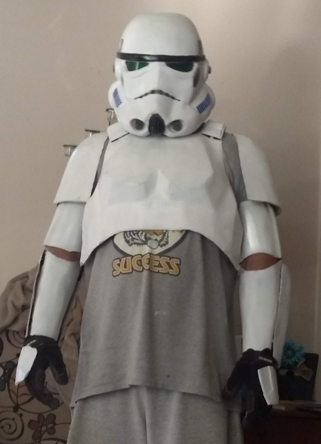

exterior of helmet is finished! I am working on getting the inside of it to fit more comfortably
I am going to refit the lenses so they are green tinted but it is wearable and not to brag, but I think pretty darn good!
Now I am going to fully focus on the upper body armor.

Hello everyone.
I have the hand plates pepped and ready to paint but I am wondering what type of gloves are suggested to use with them?
My plan is to glue black elastic on either side of the hand plate then just slide my hand through that to keep the plate on.
I used some black gloves from the local hardware store. Lightweight, with vinyl on the palms and fingers.
I use elastic to hold the hand plates on. One piece around the wrist and another piece around my two middle fingers. The handplate is held securely and can't go anywhere.

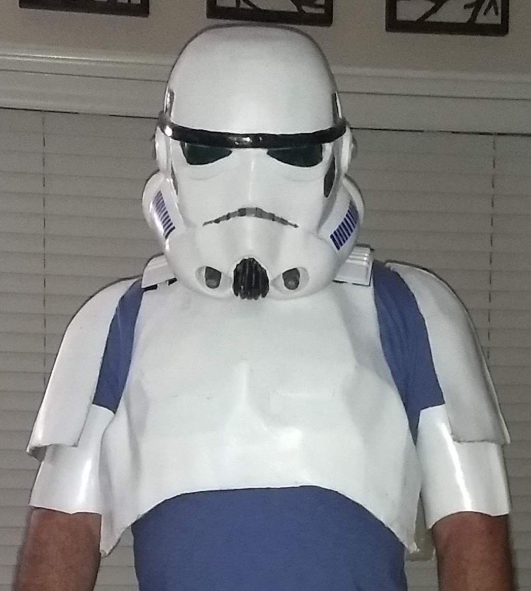

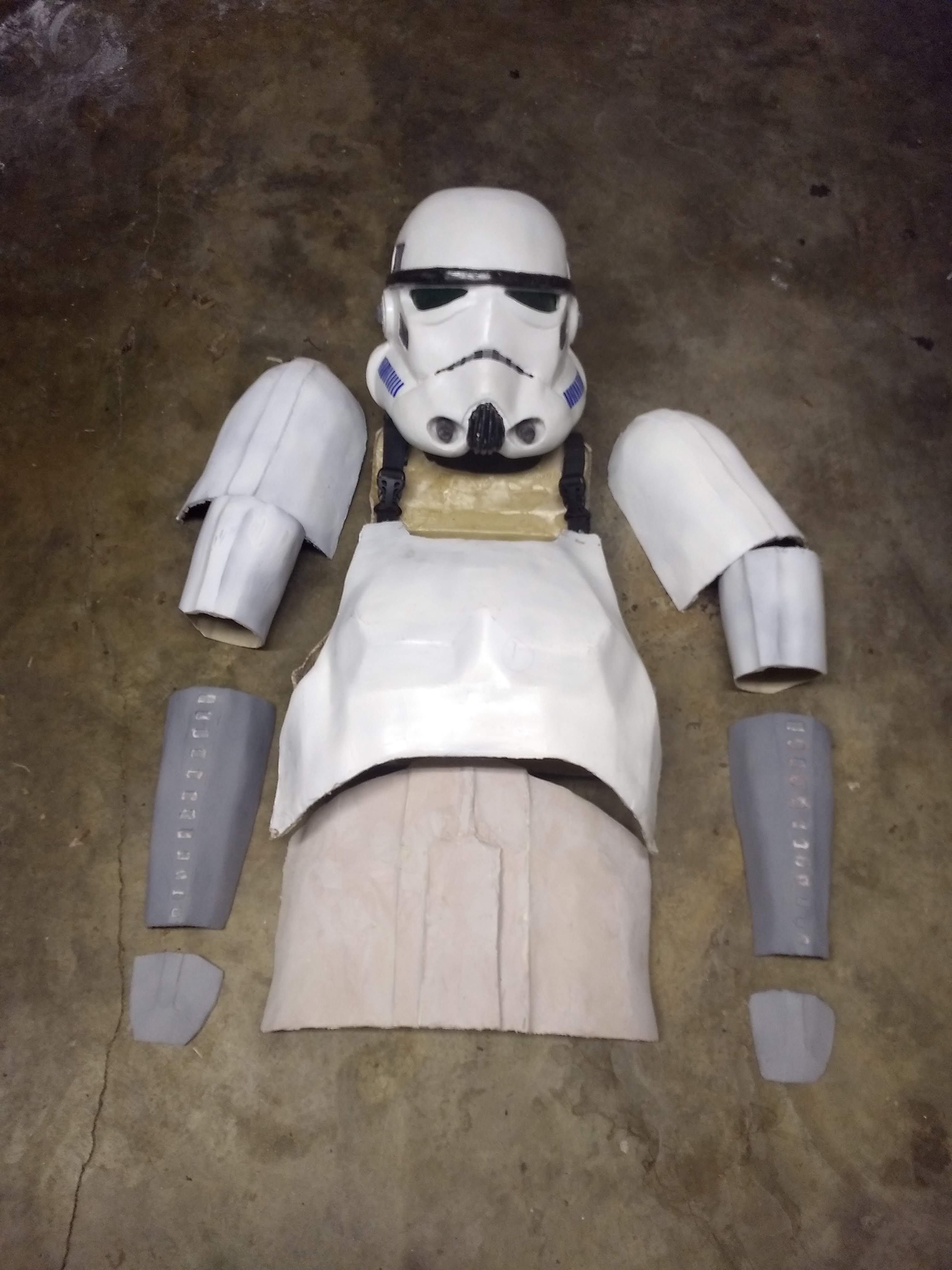

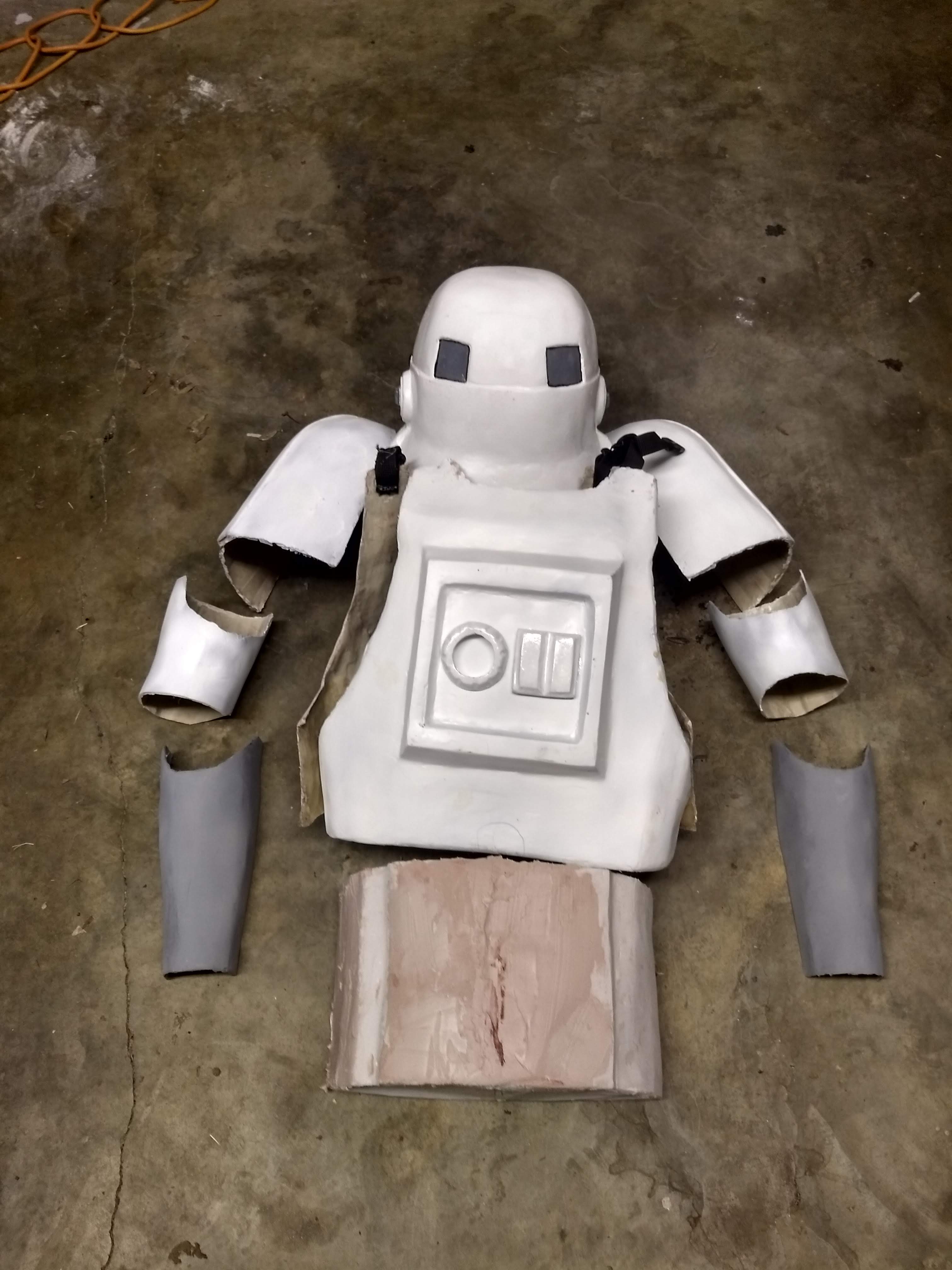

I set a goal to have the entire upper body of my stormtrooper done by Aug 31st and I am finishing the sanding on the lower ab/cod pieces.
So they may not all be painted, but should be by the end of the weekend.

Any suggestions on what to do about the edges of the pieces of armor like the cod, shoulders and biceps? I sanded and painted but they are still pretty ugly.
I know for the chest and back plates Blaxmyth use white trim. Is this a possibility to improve the edges on the other pieces?
I bought some door edge trim from AliExpress for a few dollars. It has a glue strip inside, with a ribbon tape which pulls away from the glue and allows the trim to stick to the edge of a door. Might be worth a shot?

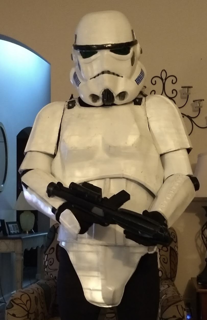

latest progress.
Realizing this thing is going to be challenging to put on and wear!
In the Star Wars world, stormtroopers must have never taken their armor off once they got it on.

Ah, yes... Armour bite, not being able to sit down easily, limited range of arm movement... Fibreglass armour does have a few drawbacks, but it looks and sounds so solid! :cool:
