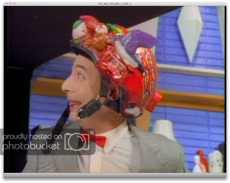

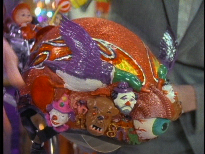

I may have just made a break through on the ducks!!!
Look at the ducks in the pics below and compare the wing of the duck on the left side of the helmet with the wing on the right side. See the difference? It seems obvious to me that the wing on pee wee's right (bottom pic) is facing the wrong way!!!
We are seeing the top of the wing instead of the underside of the wing!!!
So the original duck is the one on Pee Wee's left (top pic) and the one on Pee Wee's right is a mirror image replica of ONLY THE BODY of the duck with a molded copy of the wing from the other duck stuck to it (not mirrored, but flipped around so that the angle of the wing is correct). Or they just reused the wing that they removed from the other duck (wall ducks have two wings even though they are one-sided but on pee wee's helmet there is only one wing per duck - which means there is one unused wing that could be used for the mirrored replica). Hope you understand what I'm saying. Just look at the pics below and you'll see what I'm talking about if you study the wings closely (just look for the ridge of the bird's "arm". It's only on one of the wings)
I think that this confirms that it's a wall duck as lostcasket suggested.
Otherwise they wouldn't have had to do that weird thing with the wing.
So now the question is: How did they replicate the body?
Obviously they must have either made it from scratch or they did something dodgy like flip a silicone mold inside out and made a resin copy in a similar way to what I posted earlier. The body doesn't have much detail, so that MIGHT work. Who knows. But at least now we know how they did the wing.
As for following the curve of the helmet, do you think it's possible that they just cut the heads off at the ring of the neck, glued them to the helmet separately from the bodies and then filled in the cracks?
Additionally, they could have even cut or belt sanded a curve into the duck parts before sticking them to the helmet to ensure a snug fit or instead of cutting/sanding they could have just filled all the cracks. Something to think about.
EDIT:
Just looked at these other pics and they look a little different because they are better quality images. Now I'm starting to wonder if I had it right or not.
The "ridge" on one wing looks more prominent than the ridge on the other wing, so it's hard to say. This could just be a result of the mold or it could be the lighting or the quality/sharpness differences in the images. Or it could be that my theory is right about just flipping a wing around. So I guess now the question is, what do the BACKS of the wall duck wings look like (the side of the wings that face the wall).
Please study these pics (the ones above and the ones below) and let me know what you guys think.​
I'm going to start looking for 'whole' plastic or rubber ducks like Nick suggested. Because now I'm back to being confused lol.
I've been searching non-stop but I haven't had any luck finding a 'whole' duck so far. But I have found evidence that at least ONE company made 'mirror image' wall ducks albeit slightly different in size to one another.
But so far, the wall ducks that lostcasket posted are the closest match I've seen. Let's keep looking. :)
Notice how the outer wing has detail on the backside which is similar to what the detail would be on the other side of the same wing. This brings us back to the possibility that they replicated and used the same wing for both ducks by simply flipping the wing around and sticking it onto a hand sculpted 'mirror image' of the body. I don't know what the point of this would be other than to save time and energy on sculpting and detailing a wing by hand and to improve accuracy of the dimensions.
Just a theory.
Also, note how the head is a complete head and the legs/feet are complete too.
One could potentially replicate the head, leg and wing via mold and attach the parts to the hand sculpted 'mirror image' body. If the heads are detached and glued to the helmet separate from the bodies to help match the curve (as mentioned in one of my other recent replies), then this could work too. I know this is a strange approach, and I know that this is a different duck from the one on the helmet. But I'm assuming that most wall ducks are made roughly the same in the fact that the outer wing and the head would need to be complete since they both stuck out from the wall slightly. So both halves of the head, the wing and the feet could be duplicated easily via mold, affixed to the body or the helmet, and then touched up to hide the cracks. This way of doing it isn't very conventional, but it could work.
So really, the only thing that would need to be hand sculpted is the body and tail. Again, just a theory about how they might have done it. Most people would probably just sculpt the whole 'mirror image' duck by hand. But this theory could explain why one wing looks slightly different from the other in the pics.

The other duck might e just had its wing sticking out at a different angle and the prop builder just cut it off and reattached it at an angle similar to the other.
The construction methods in all the props seem to focus primarily on Assembling and building and very little molding and casting. I saw a cool Wayne White documentary this summer and covered a lot of his work on the pee wee playhouse puppet and set construction. Very primitive stuff by a crew with very little experience.
