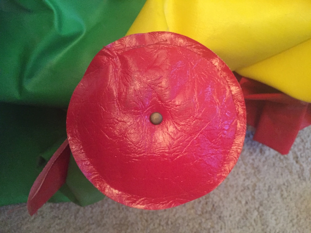

DB, could you tell me the size and construction method of the big buttons on the front of your clown's vinyl suit? I assume they are just two pieces of vinyl sewn together with a little bit of stuffing between. Also, would it be possible to make a tracing of one of your clown's gloves? Even placing one on a copy machine would probably work.

I'll take some photos of the clown buttons and post shortly.

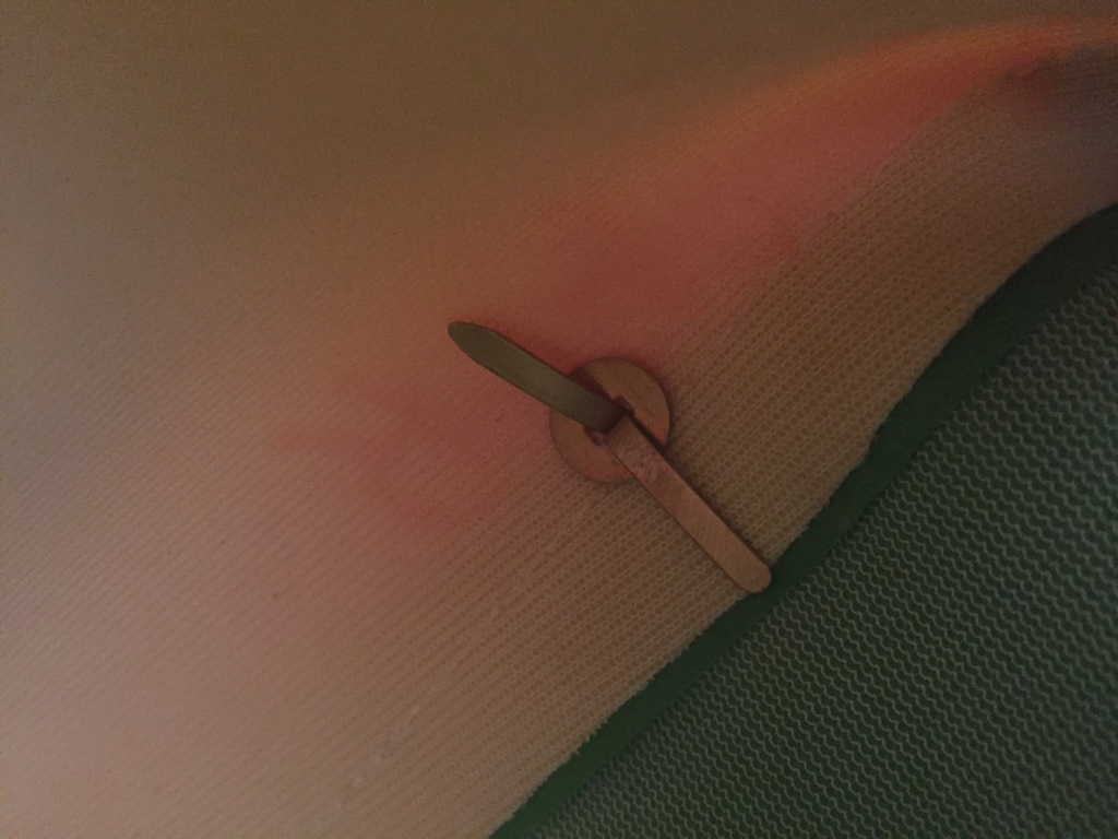

The buttons on mine are 5.25" diameter vinyl circles stitched together. Doesn't really feel like there is stuffing between them. Held onto the suit with metal brads.

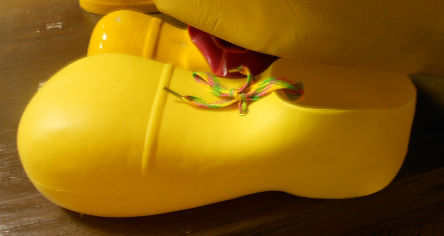

I tore apart my clown tonight. At least on my clown, the feet are identical. The plywood soles are identical and the parts nest well.
I think on mine the plywood might be the same, and they fit the same. There is something slightly shaped differently that suggests left and right. I think mine also have left/right notations written on the bottoms.
I think that I may understand the feet. The vacuum form is the same for both. The sole has simply been turned over for the opposite foot. The vacuum form just conforms to the different curvature, making it appear to be the other foot.

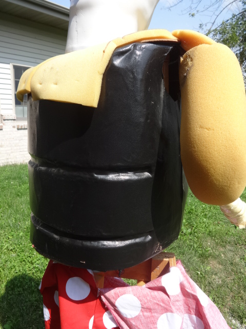

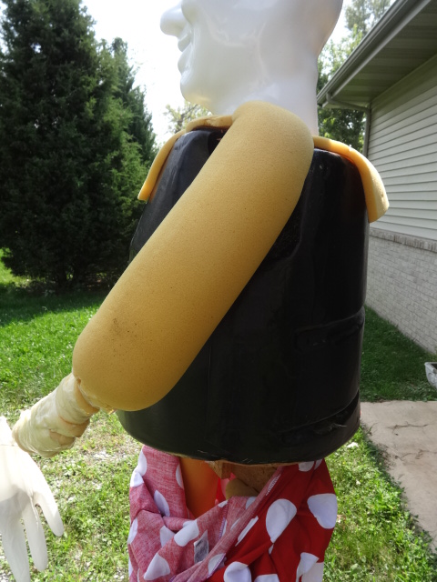

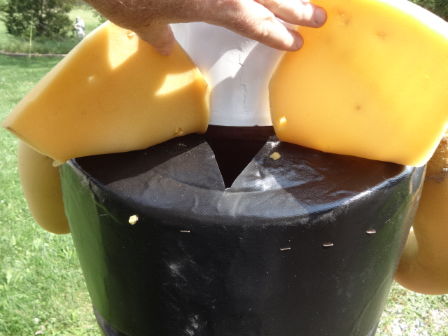

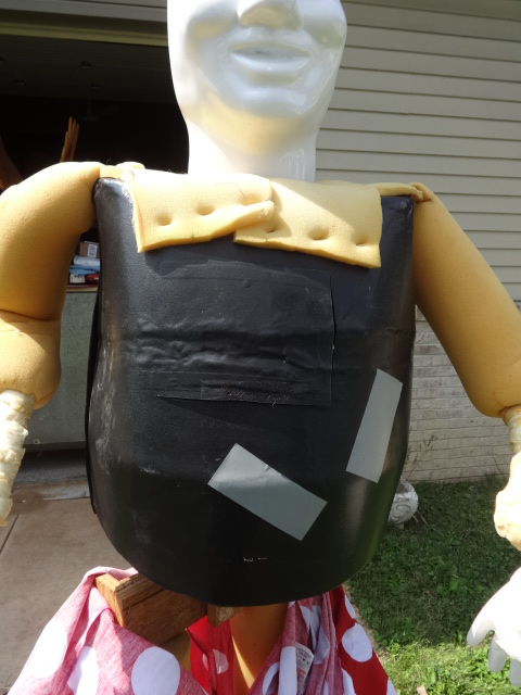

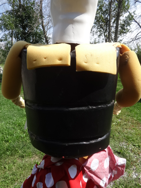

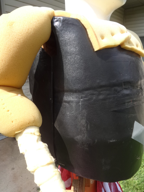

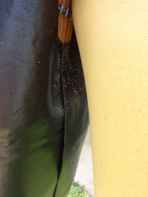

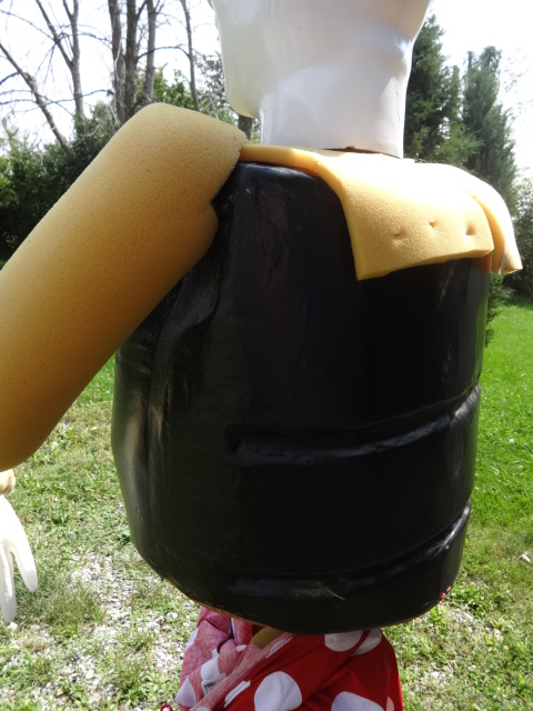

If someone could post a pic of their clown's plastic torso shell, it would be greatly appreciated. My clown's torso is too badly damaged to tell what it should look like. Also, are the back and front halves identical?
the front and back are not the same, the back is round and vertically straight, slightly hour-glassed to form the waist, the front is protruding out more to form the belly, (at least at the bottom), hope this helps, your idea of using a rubber trash can and cutting it apart and making it fit, seems like it would work .
DSC00545.JPG DSC00541.JPG DSC00546.JPG DSC00542.JPG DSC00543.JPG DSC00544.JPG DSC00547.JPG DSC00548.JPG
Yep mine basically looks the same as that, just with white plastic. I haven't decided if I'll do one for my movie clown .. I think I'll just add padding to the front and skip the plastic torso (atleast in the Oddities video, you can see there is no plastic in the back).
