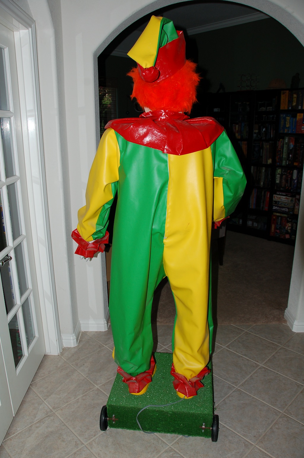

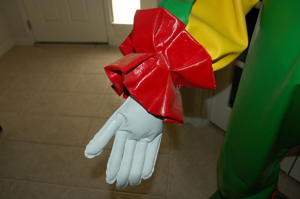

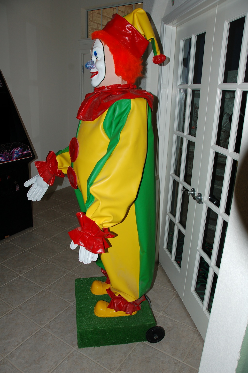

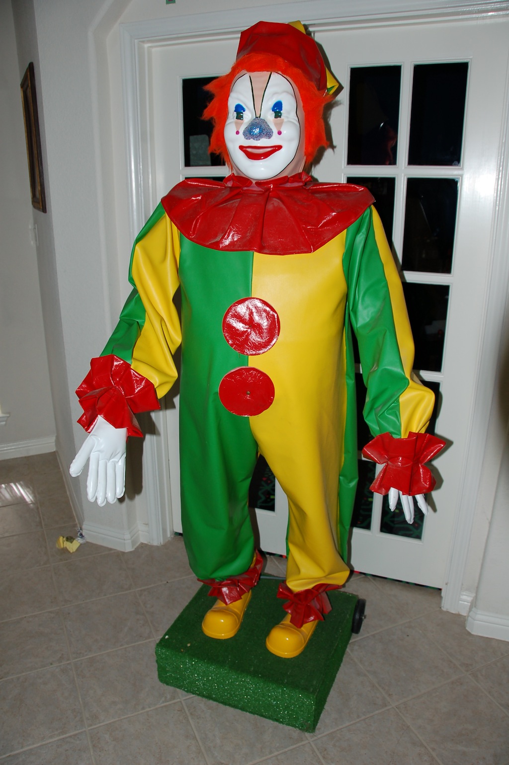

Here are some reference photos of my clown and his outfit (in future posts I'll attach photos of the various sections as I'm disassembling him). Luckily mine is in almost new condition - I feel fortunate after seeing photos of so many trashed clowns!

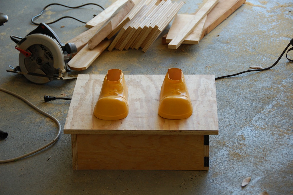

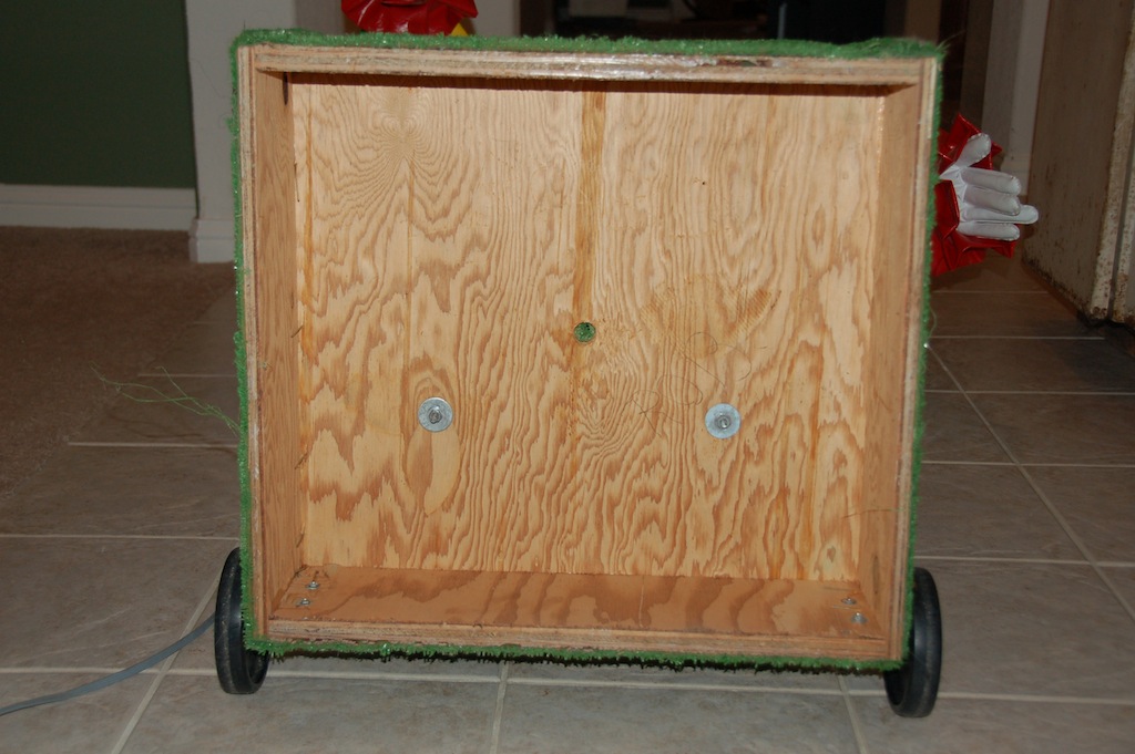

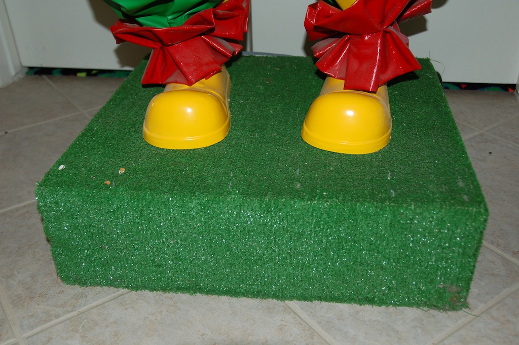

Here are some photos of my old base, and the new one I'm constructing (with the older style platform). The name 'ROB' was scribbled under the base of my clown - the only identifying mark on the whole clown besides the motor brand! It looks like there was a plaque or sign attached to the corner of the base at some point. This must have been common - you can see it in the movie (shot of the clown from above after his bike is stolen, front right corner), and in some other clown photos on the web.
Dimensions of the top platform I'm making are 21x19. Bottom pieces are 17x6 and 17.5x6. All the plywood is 3/4" thick, although the platform and two of the sides on my original are actually only 1/2" thick (I adjusted dimensions to compensate). I did a couple versions with various dimensions and these seem to match the photos best. The height also matches my original clown, and gives about an inch of clearance for the wheels (the wheels are 5 inch diameter, 1 inch thick).
Indoor-outdoor carpet from the hardware store. It's a shade darker than my clown, but all of the local stores only have the one color. I'd like to see about finding some that's a little brighter green (it's bright under the clown's shoes too, so I don't think it's just sun fading).
Yes you should, it's one of the nicest I've seen, did you find it locally or on the web?
Dang, DB. That looks like it just rolled out of the factory. Even though this thing creeps me out, I wouldn't have passed up one in that nice of condition. Great find.
What year is your clown? It should be on the motor. I am just curious how many years these were made. Yours looks to be newer than most.
I got mine off eBay 3 - 4 years ago. Pretty tricky to find, since the search terms produce tons and tons of unrelated clown junk. I've got a bunch of complicated queries that I've checked every night since then, and I've never seen another one. I haven't told my wife yet, but I'll buy as many of these clowns as I can find ;)
I'll check the motor when I get the plastic torso off - the only sticker I can see with the torso on doesn't have a date. Not sure if mine is newer year-wise, or just well preserved (maybe only used indoors). It seems like there are mainly three different styles - original as in Big Adventure / Night of the Comet, new facepaint/suit with original base, and new facepaint/suit with rectangular base (like mine).

My original base is 6" tall (5.5" sides, 0.5" thick top piece). The top is 21x19x0.5, the left/right side pieces are 19x5.5x0.5, the front/back side pieces are 20x5.5x0.75. You can see the way they're assembled in the photos above - front/back are sandwiched between the left/right.
I kept the top on my new base the same 21x19, since the older clowns seemed to have the same amount of room around the feet. The wheels are 5" diameter, and you can see about an inch of clearance above the wheel in the photos with this style of base .. so I used 6" high sides instead of 5.5". I shrunk the dimensions of the side pieces so that there is 1" of overhang on all sides (I originally tried 2" but it was too much - 1" is just enough to cover the wheels, so is probably correct).

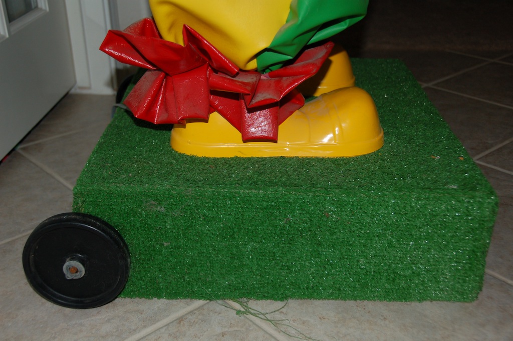

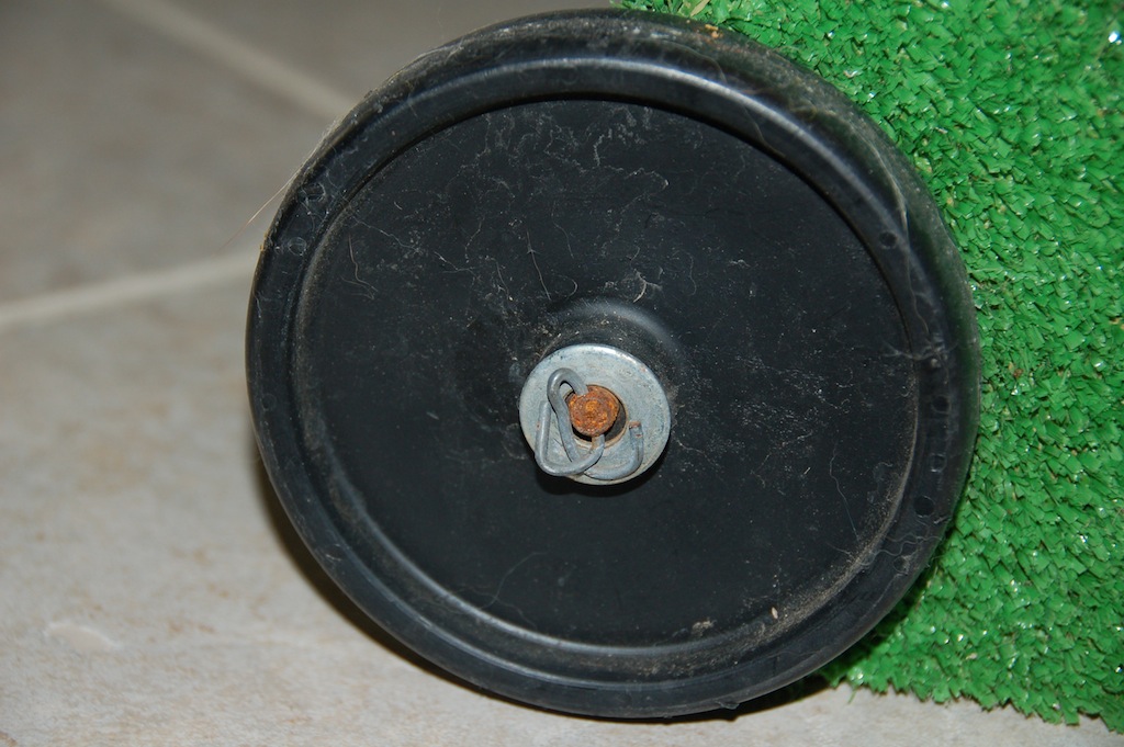

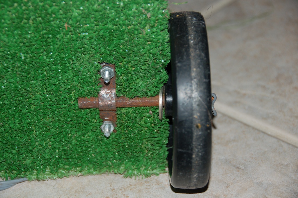

Still trying to find the same kind of wheels as the originals. In atleast Big Adventure and Night of the Comet, they're a shiny metal and rubber - similar to the below but more reflective:

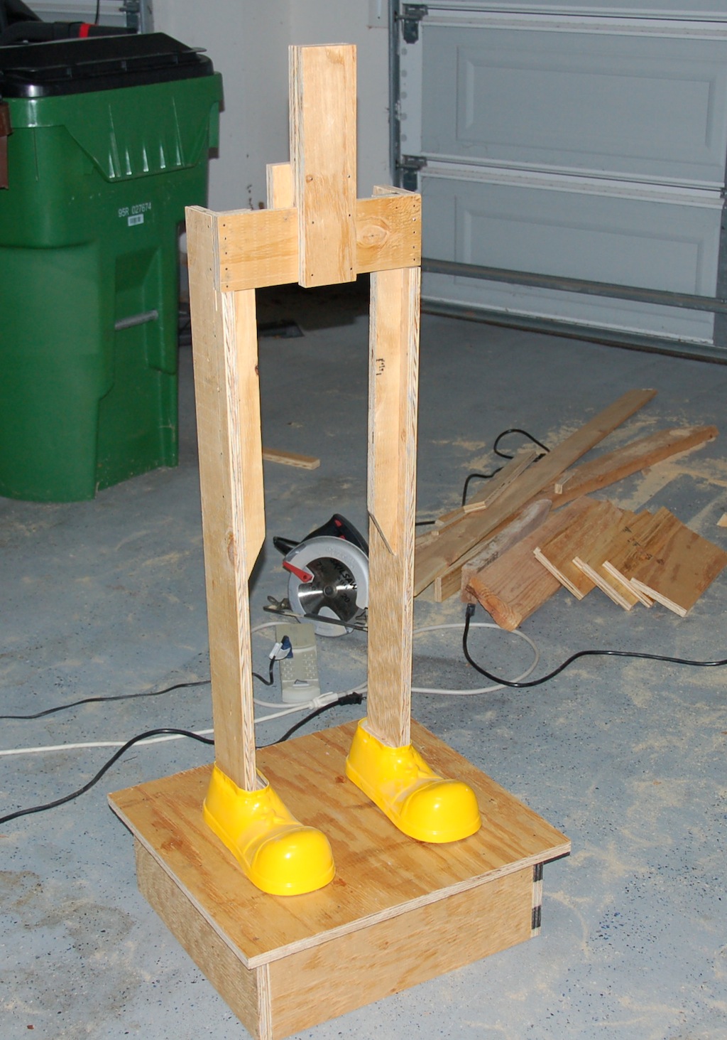

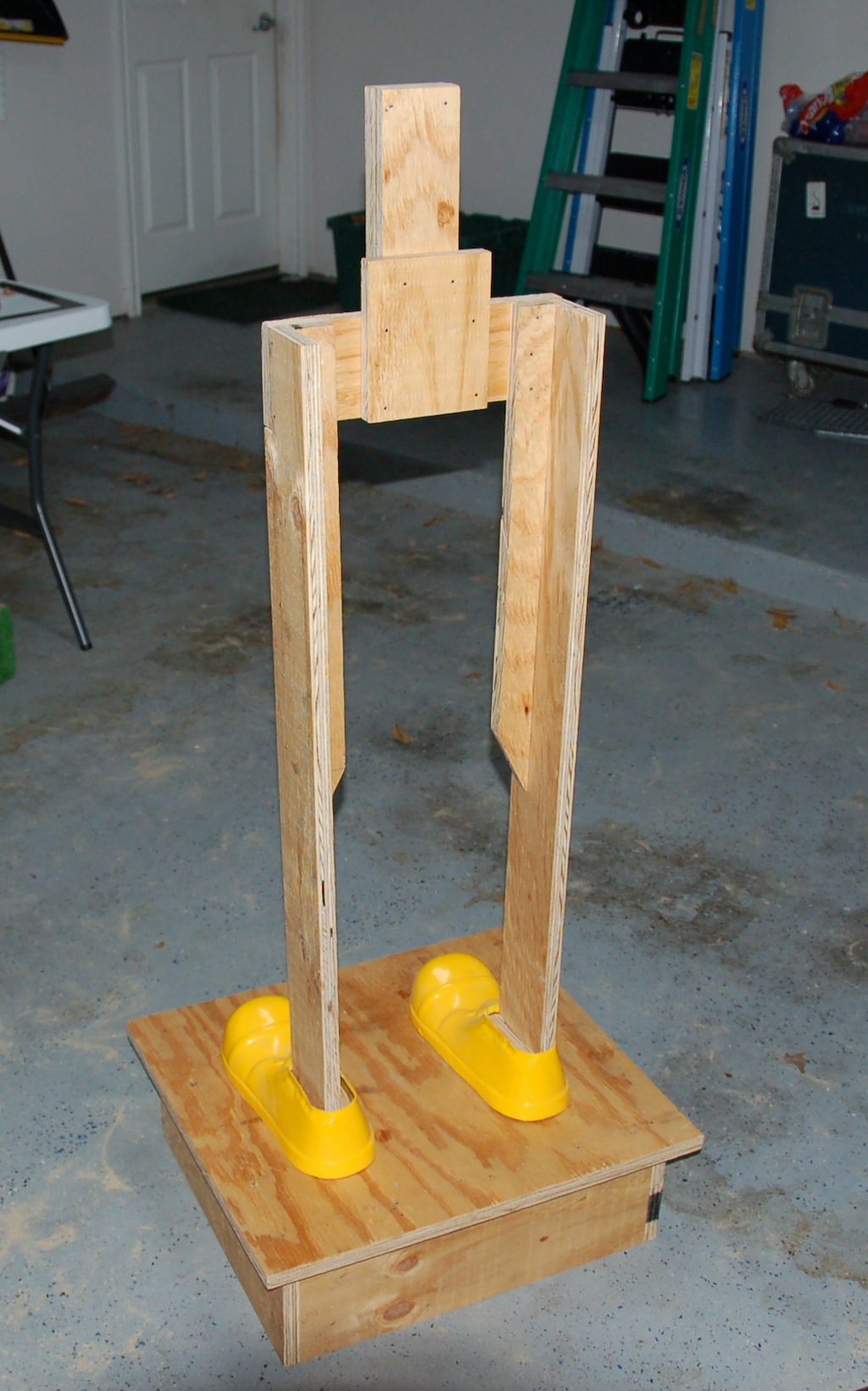

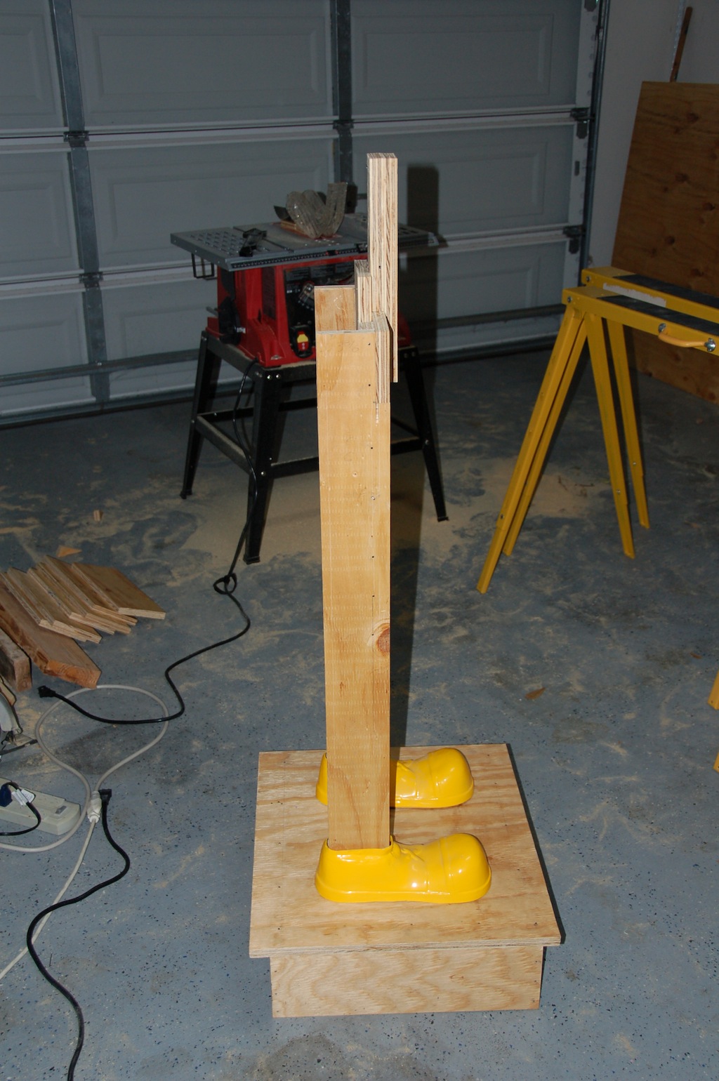

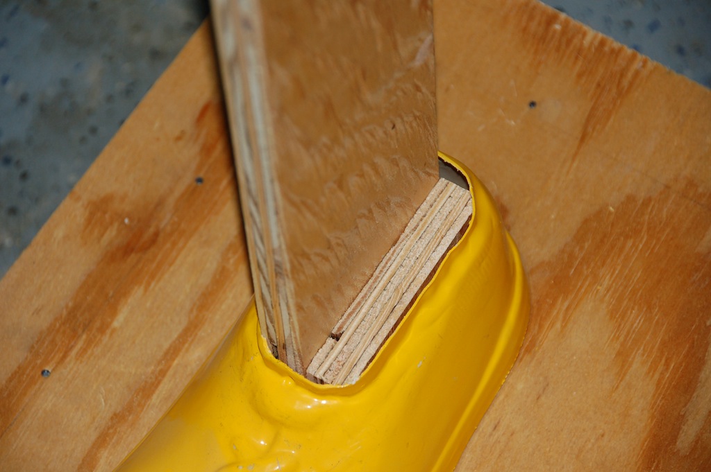

Here are some more construction photos. The lower half of the body is built to almost identical specs as my clown. I used nails instead of staples since I don't have a powered staple gun (the original is almost entirely held together with long staples).
Dimensions are below (all 0.75" thick plywood) ..
- Legs - 36" x 3.875", notches cut out at the top for the front cross piece (0.75" x 3.875")
- Feet - 2.375" x 3.875" (my original had two different sizes, so I split the difference) - these fit down inside the shoes and are what actually bolts the whole clown to the base
- Leg supports - 1.5" x 21", tapered at 18"
- Front cross piece - 3.825" x 12", goes in leg notches
- Back support piece - 5" x 6" (the longer dimension goes vertically)
- Spine front piece - 3" x 12", this is where the rods go that connect to the rotating upper half of the clown
- Spine back piece - 3" x 8"
Good work, DB! The construction of my clown is similar, but it is a little different. They seemed to have beefed up the "pelvic" region.
Good work, DB! The construction of my clown is similar, but it is a little different. They seemed to have beefed up the "pelvic" region on yours.
I may be jumping ahead, but, how tall are they?, I think they're 6', is that including the base or not?, awesome so far by the way.
I'd have to measure at home tonight, but I suspect they are about 6' tall (or maybe a hair over) with the hat off and standing on the base.

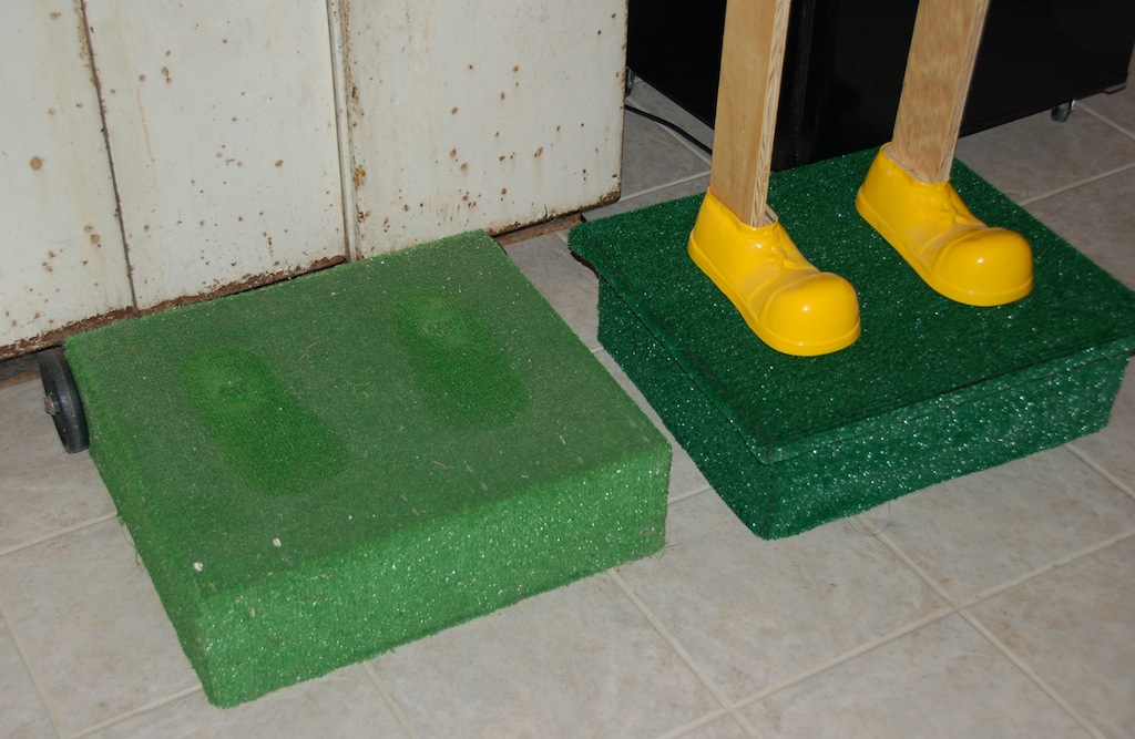

My wife is helping put the grass on the base. I would like to find a brighter green at some point, but all the hardware stores here have just the one color option. I'm going to see if some of the real carpet stores have more options.
I'm glad the guys at Rex gave you some information atleast. I haven't had that rude of a phone call in awhile, especially after only getting one question out. They struck me as every other place that just wants to take your money and move on.

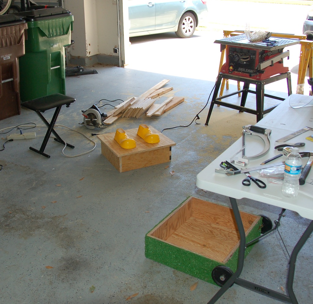

I knew the typical Home Depot / Lowe's grass carpet was too dark, but I figured we could lightly staple it on as a test run and see how much material is needed. The top is done first, folded under the lip, and sides are wrapped in one long strip. Ignoring the color, I think it looks good .. I'm still very happy with the dimensions of this new base.
Tomorrow I'm going to order a handful of samples from Georgia Carpet and some other big names. Hopefully it won't take too long to find a match for the original carpet ..
Looks good! I would not have imagined it being that much darker though. I thought that was one of those items that never changed. There is some artificial turf on eBay that seems to match a little better.
DB, can you show how the clown is bolted down underneath the shoes? My base is not original, and the mounting appears non-standard.
