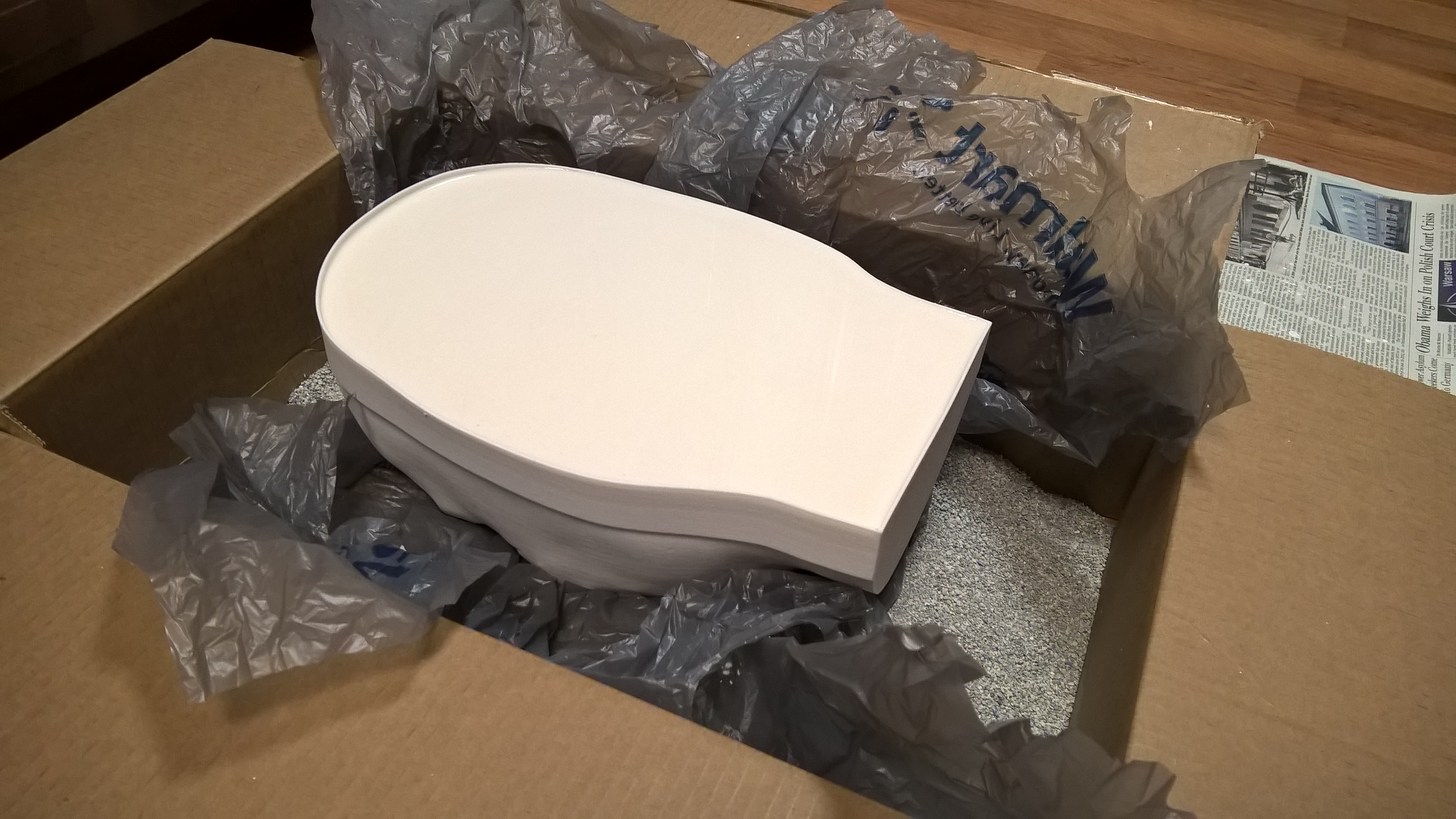

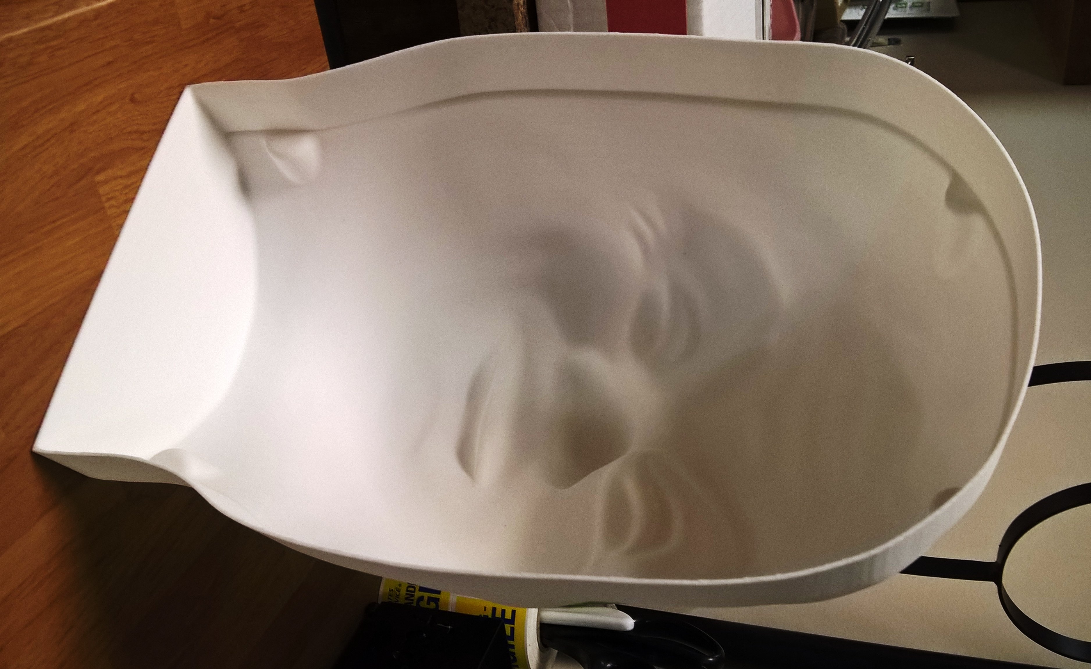

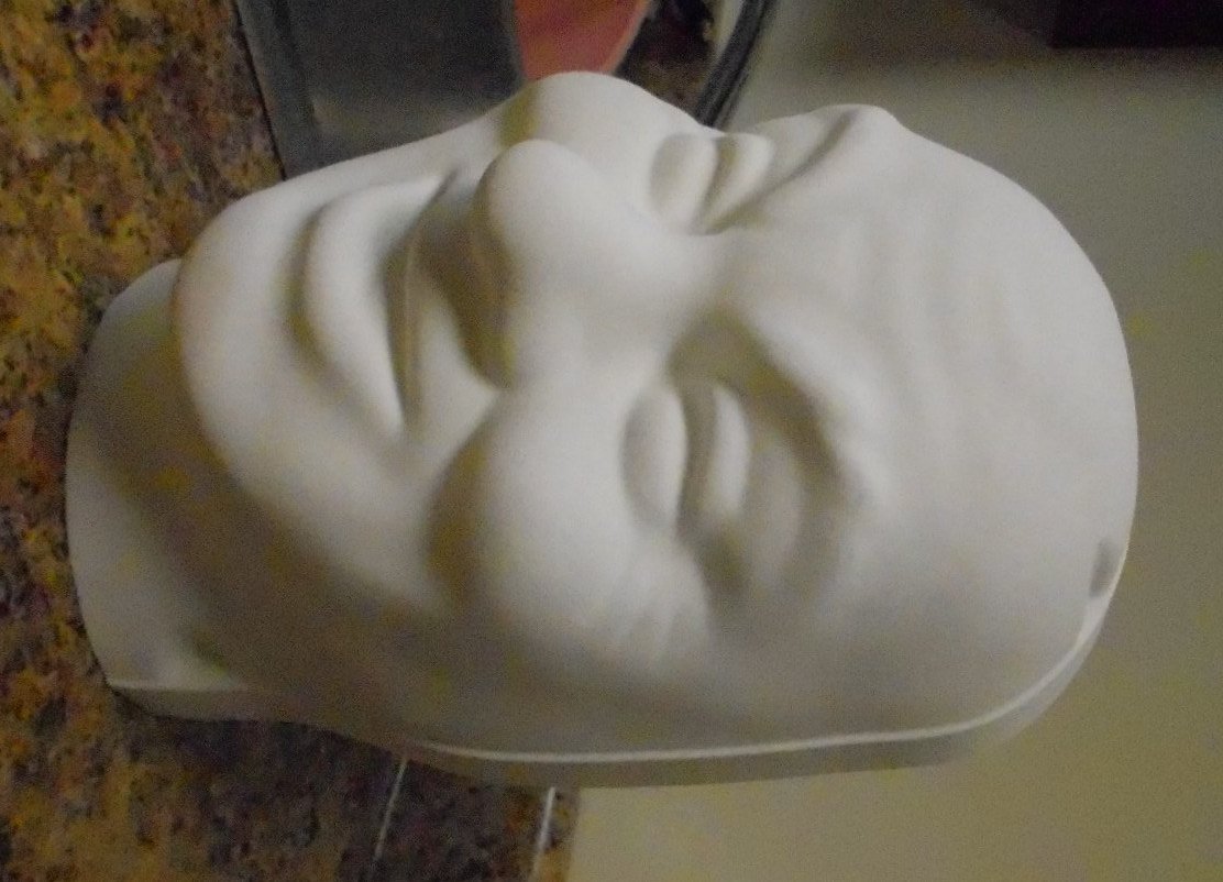

The plastic is not as porous as I thought. I filled it with water to determine how much plaster I will need. Not a single leak! I was impressed. Looks like it will take around 12 lbs of plaster. Can't wait to make the buck.
Do you have a photo of the inside of the head? How heavy is it? And how much did it cost roughly to print?
It looks good, I was expecting more jagged lines from the printing layers.

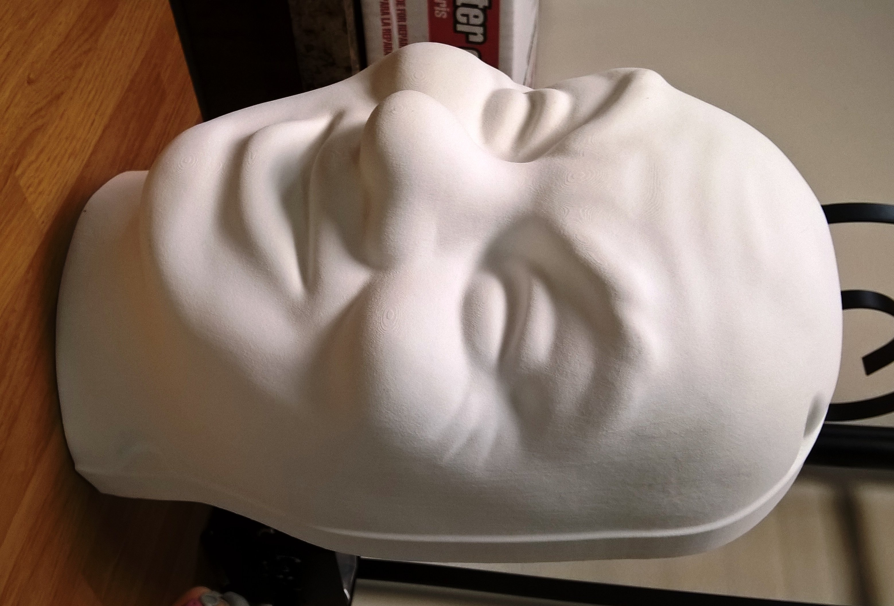

It is a little tough to get a good pic of the inside. I tried my best though. It almost acts like a light box. The mold weighs 6.1 ounces. It cost around $140 to print from Shapeways. Most printers aren't even big enough to print something that size. I attached a better pic of the outside. If you zoom in you can see some of the print layers, but they are pretty fine.

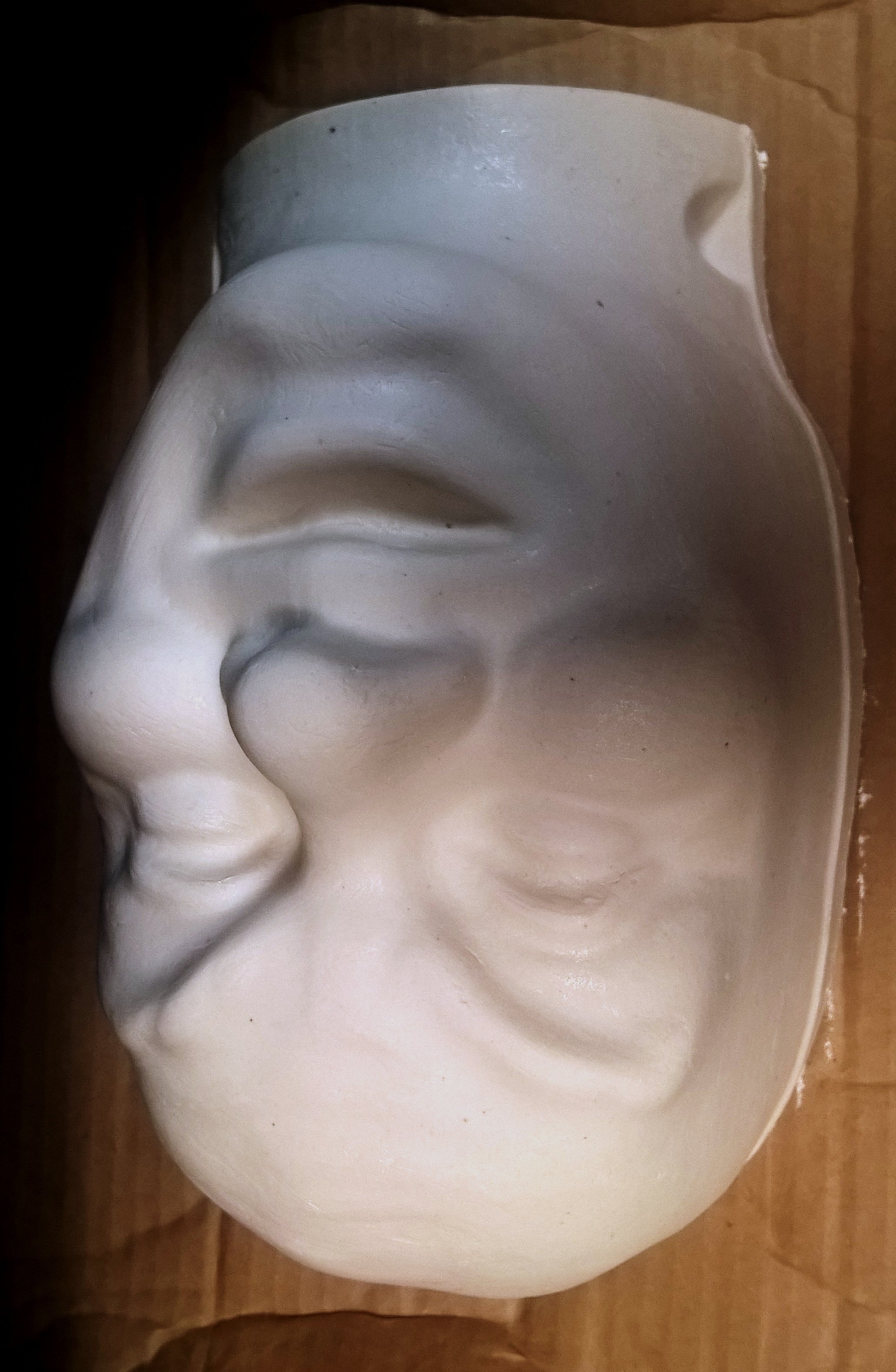

Poured some plaster tonight. It could have been a little thicker, but it should setup nonetheless. I used cold water to give myself some more working time. And yes, the mold is sitting in kitty litter (new I should add). I didn't have any sand lying around. We'll see how it comes out tomorrow morning!
The plaster buck finally dried enough to pop out of the mold! The surface is a little textured in spots (mostly due to the use of petroleum jelly), but I should be able to sand it without difficulty. It likely would not even matter. The vacuum form plastic should not pick up on it. Next time I will try using potter's plaster though. It's supposed to create a stronger casting and dry out a little better. I may try a different mold release, too. I now have the buck sitting in front of a fan to dry out some more. Overall, I'm pretty happy with it. The best part is that my mold can be used over. The wsf material worked out great! Just as it's name implies, it is strong and flexible. I see vacuum formed clown heads in the near future!

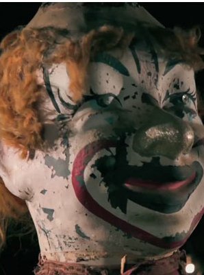

Has anyone watched the opening to American Horror Story: Freakshow? There is a clown head that looks a lot like the Pee-Wee clown. It looks like they may have smoothed over the brow and added ears.
Yeah, I had to hit rewind and pause when I first watched it, it does look very similar, especially the cheeks, mouth and nose, but the eyes and the top of the head and ears threw me off, I didn't think that much about, I guess they could've doctored it up.
