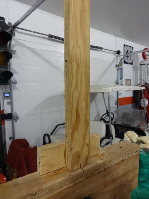

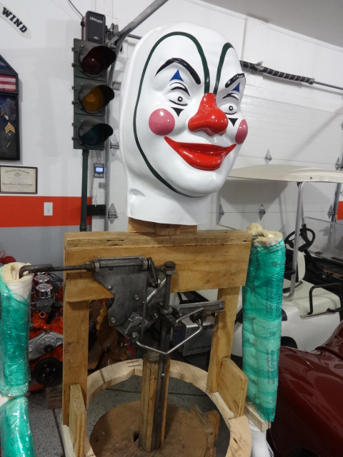

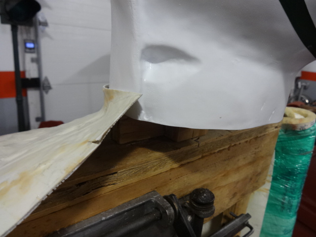

Does anyone have any pictures of the upper wood structure of their clowns without the head off? I was going over on Thursday to use my dad's tablesaw to cutout a couple structures. I would like to see if they are all made like my first one. I am most interested in knowing how the head is attached.
The bottom of the neck was stapled to the inverted "T" head support, which was glued and stapled on one of our robots and glued and bolted to the other:

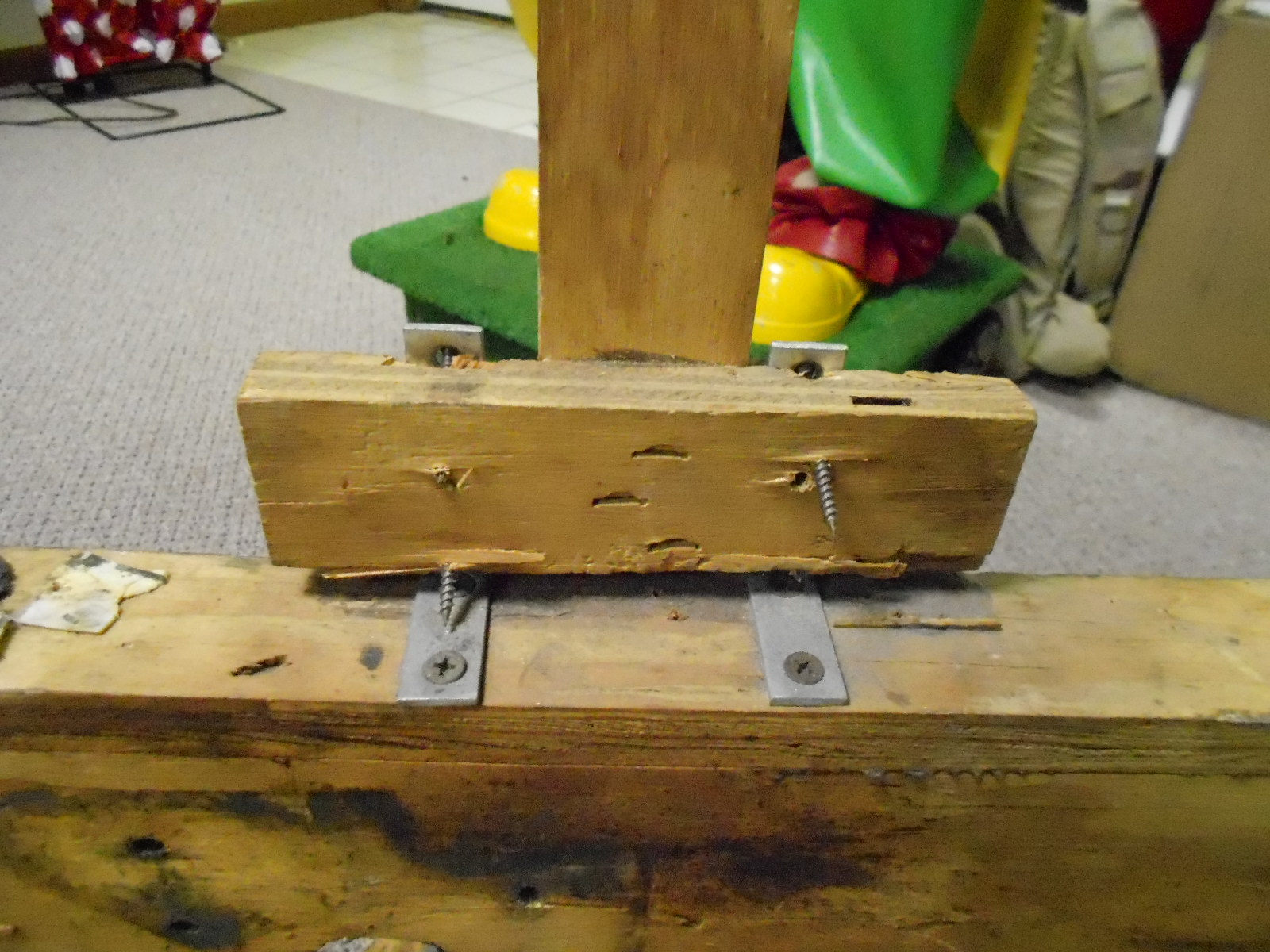

Mine is similar. It was definitely a repair job though. It has two 90-degree brackets supporting the inverted-T. I can see where it was originally glued. They should have flipped the T around though - it's backwards! I have to say, I do like the idea of the 90-degree brackets - seems better than just glue. I may just keep those.
BTW - I still haven't gotten over how freakin' awesome your scary clown head looks.
I don't see anything wrong with that, I'd keep 'em too.
