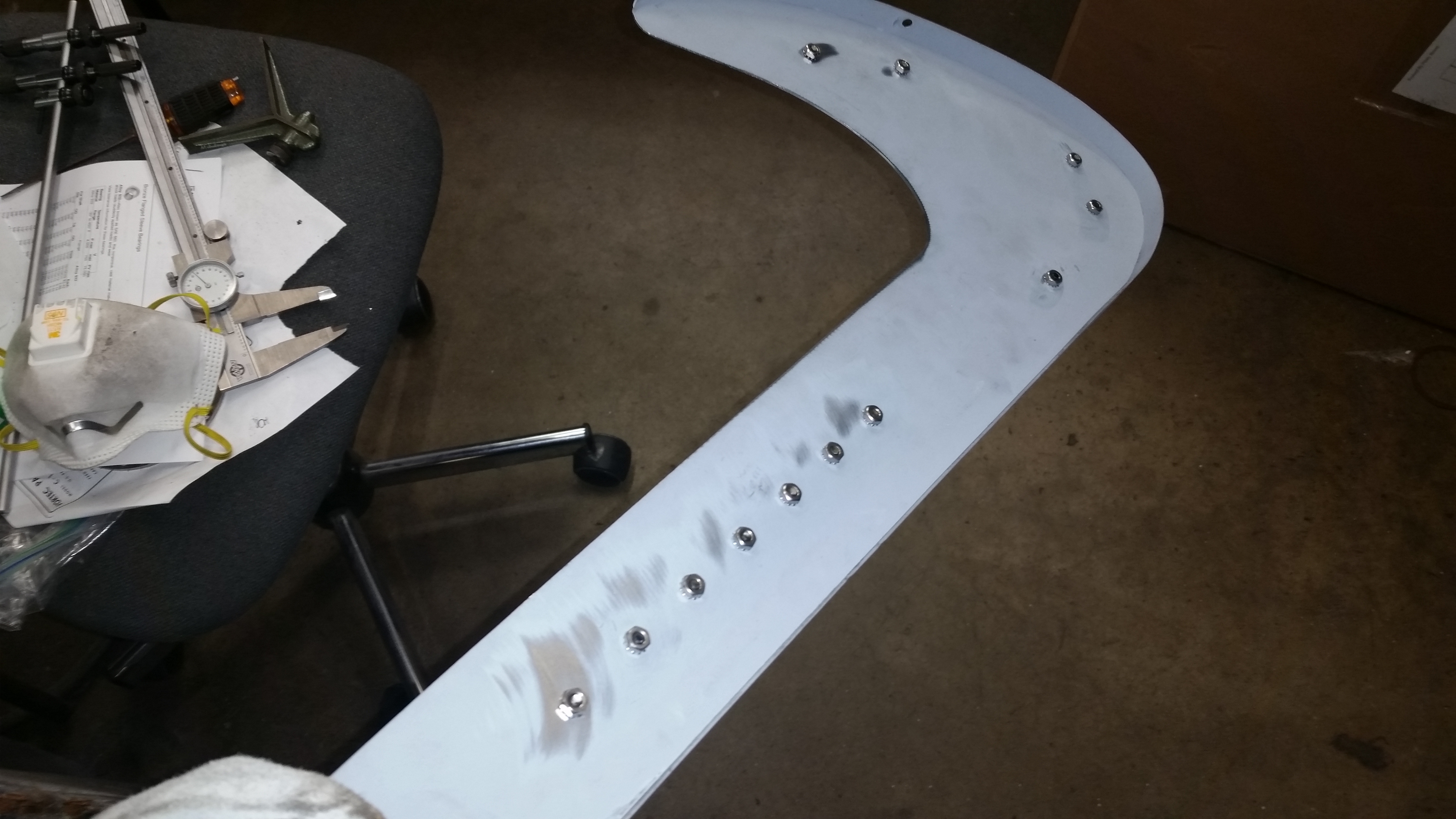

Last I took Abes advice to weld little screws to the chain guard pieces so I can just bolt them on after paint.20140923_091449.jpg
I drilled a hole in the center of the popsicle pieces, welded a 6-32 bolt and then drilled a hole through the surfboard looking piece and the guard. The popsicle pieces act like a bolt going through all the pieces holding them on place with tiny nuts on the back side of the guard
Yessir, I had an extra guard so I wanted to try it. Works great!

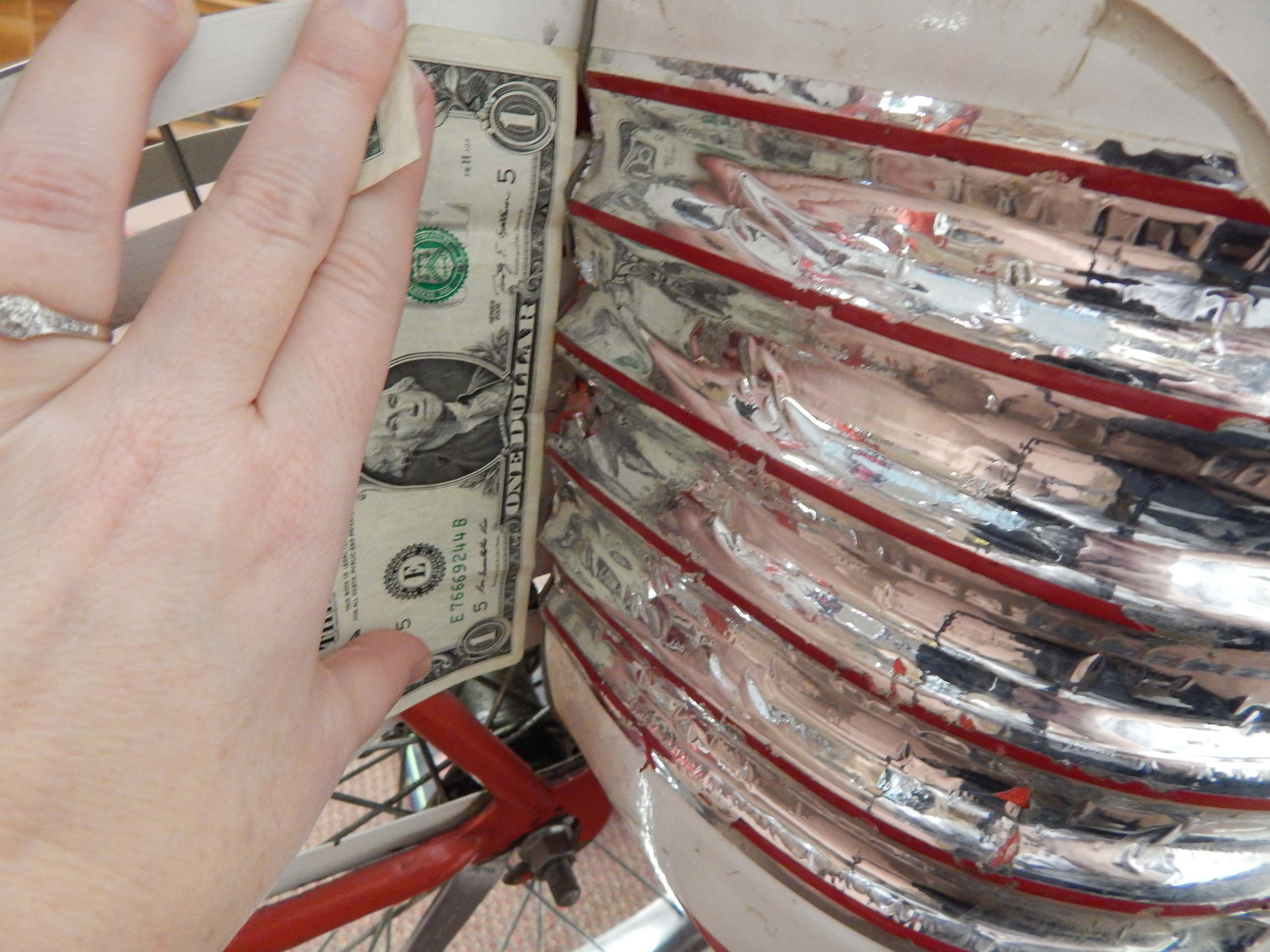

Droidboy How did you do the chrome on your saddle bags? I cut 2mm strips and it took forever and now they are all coming off. Your bike looks GREAT!! Nice job. That tiger siren mount looks top notch as well.
Joe
2mm strips might be a little thinner than necessary, but that's up to you. Because of the curves you probably want to use some extra adhesive on it. 3M Super 77 spray adhesive is a good choice.
I had mine chrome plated with Spectrachrome. I'll see if I have some nice close ups of the real bags and how they did it.
Here are a couple pics of a screen used bike. I'm pretty sure when they put the tape on they used the entire width of the tape.
