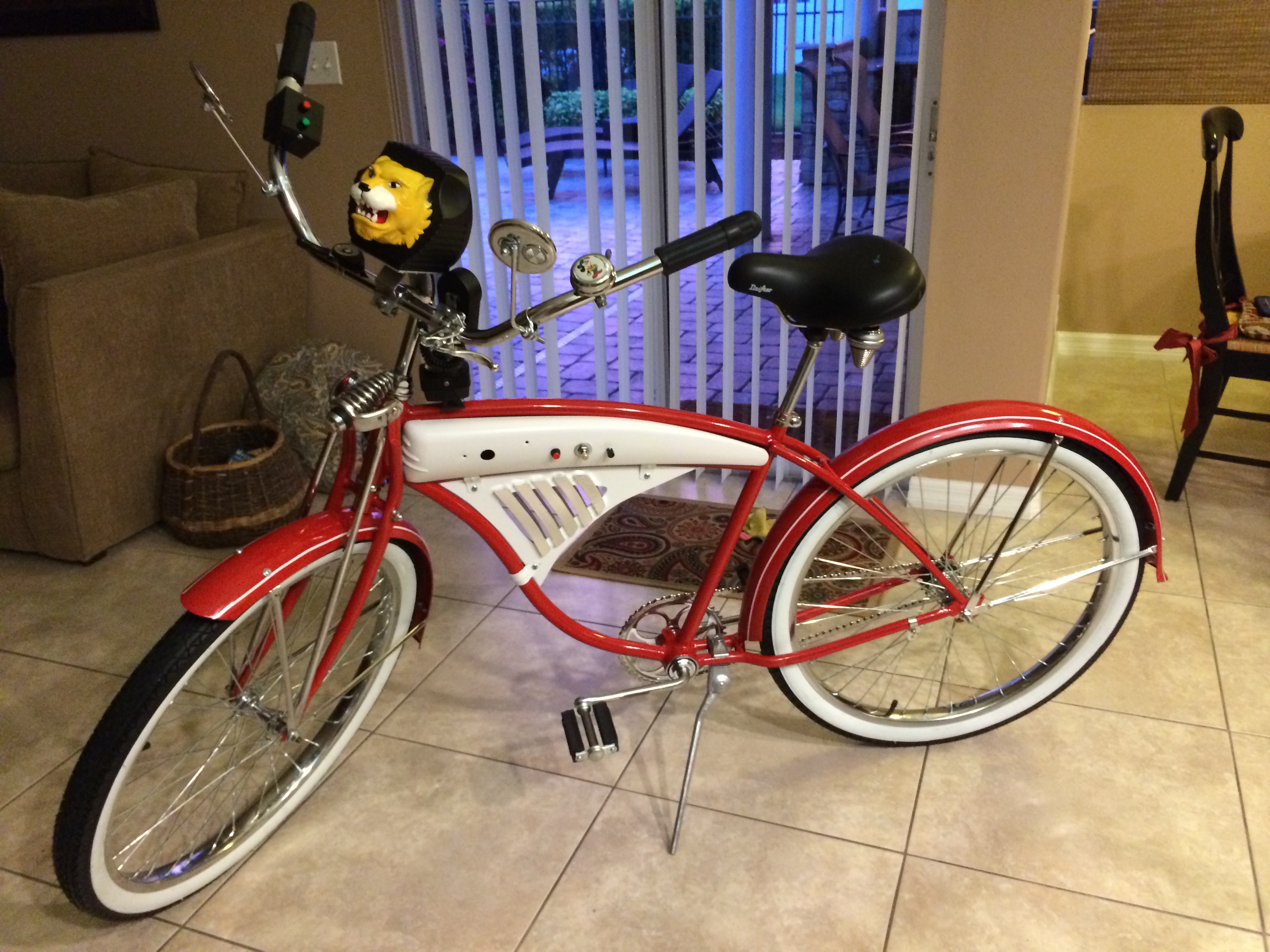

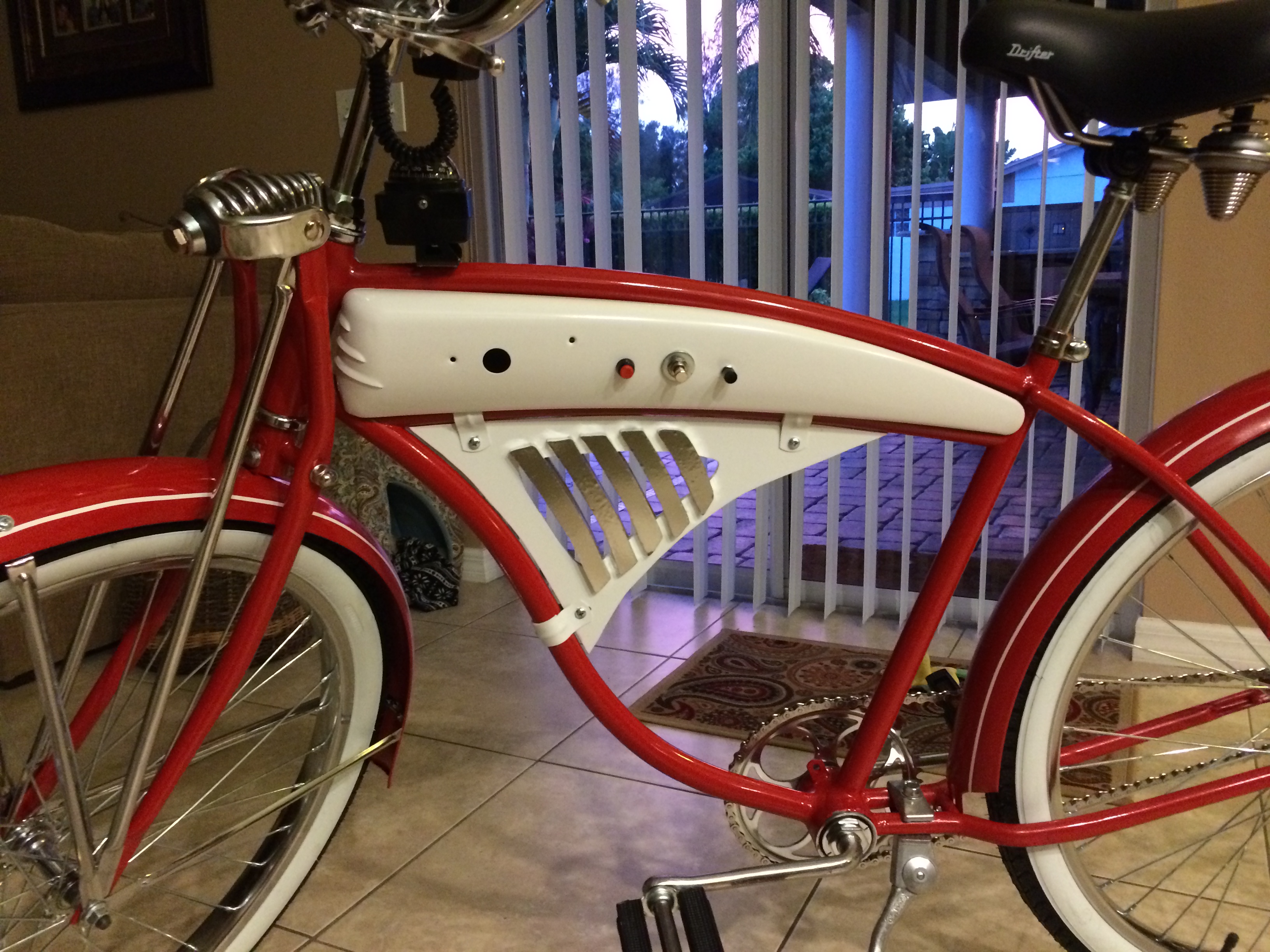

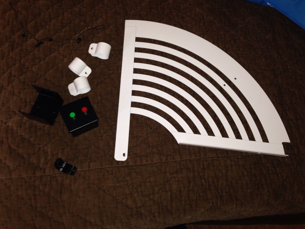

Finished my center skirt. I think it came out alright considering this was my first fabricating piece ever. Just a quick tip for anyone new doing this. If you decide to use pipe straps instead of brass strip (which I did), do not drill the holes until you are ready to mount. I measured and drilled prior to painting and the bottom strap did not fit right when I went to screw it together. Anyway, on to the next project :)

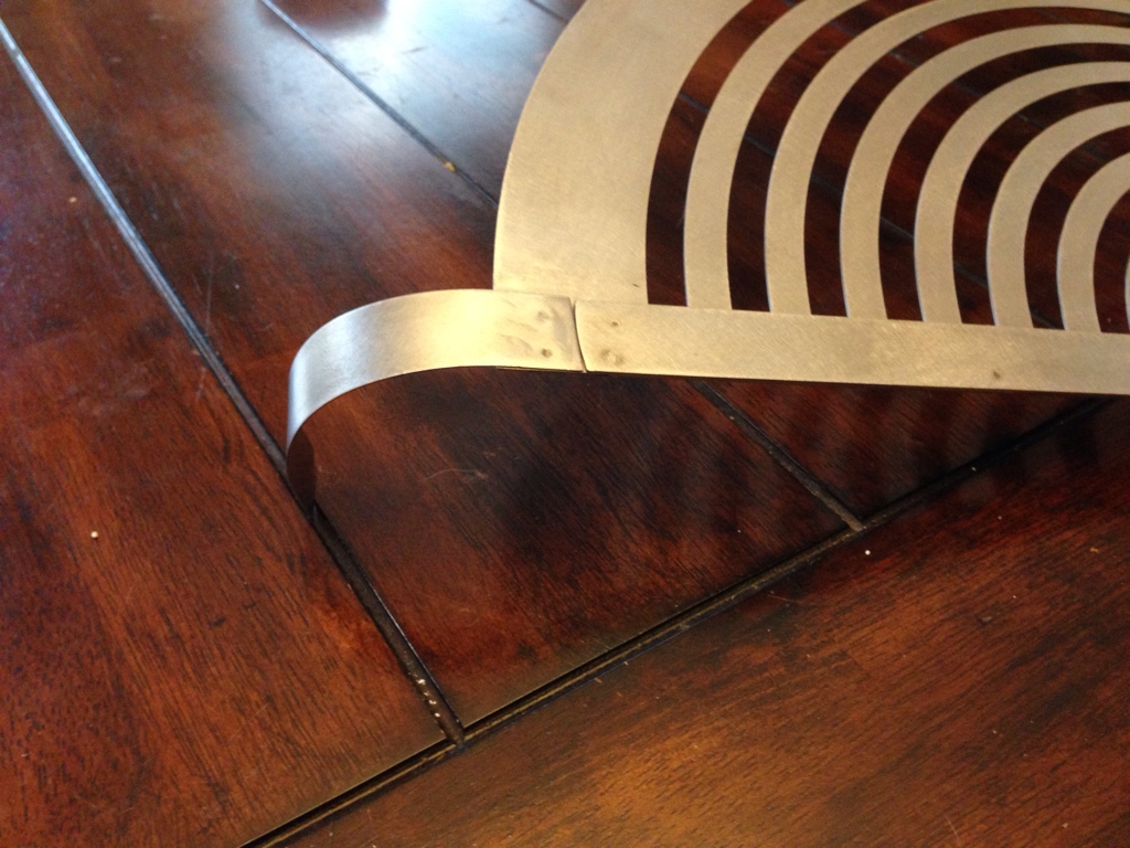

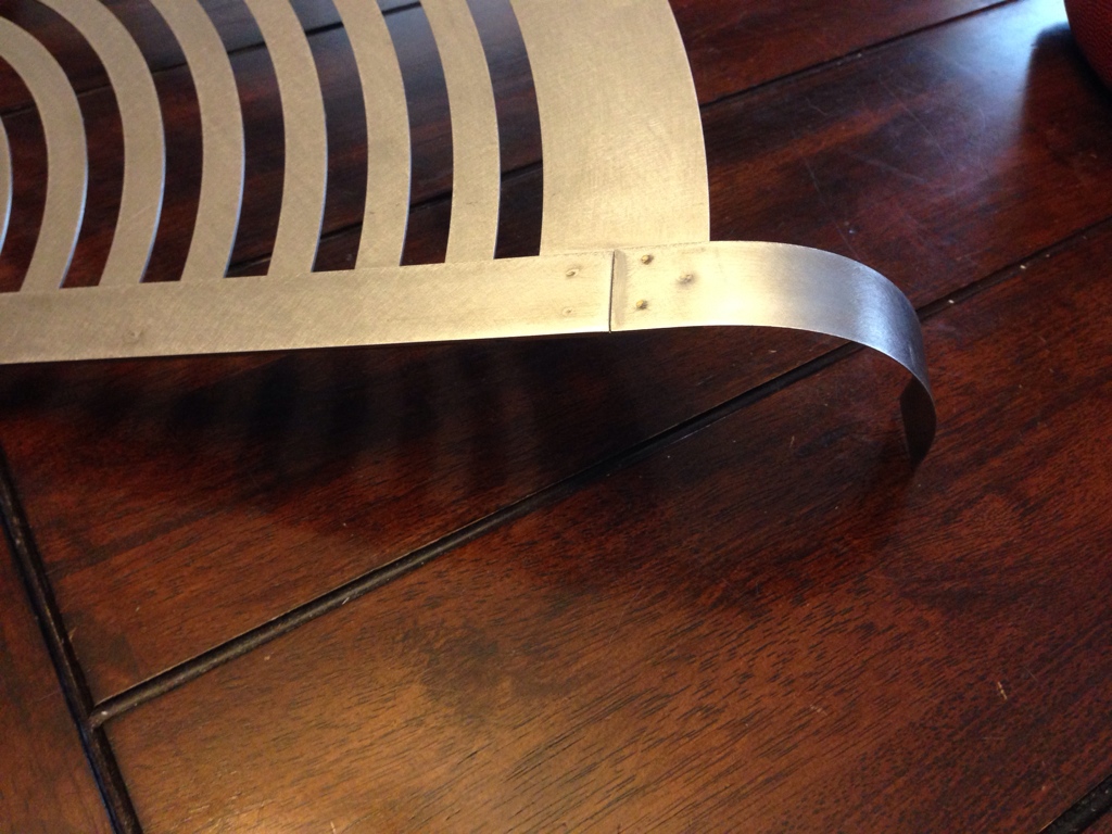

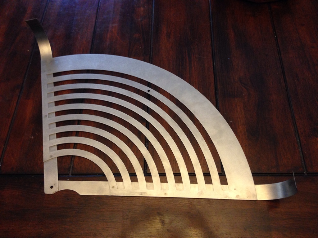

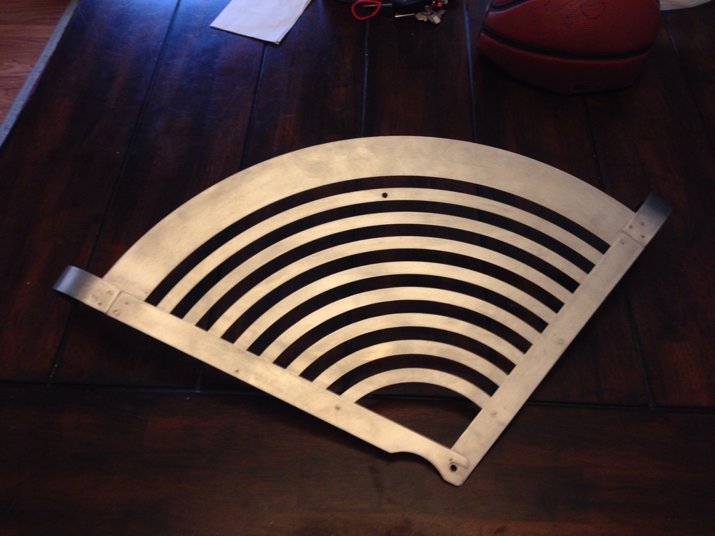

Another small update. I finally got the left side skirt back from the machine shop. I had my shop make these like the screen used ones were made.
The right side skirt has an L brace welded to it to mount it to the chain guard. This side has two braces added to the top to attach it to the fender. This allows it to connect at four points....at the corner with brace, on one of the ribs and at the two fender straps.
