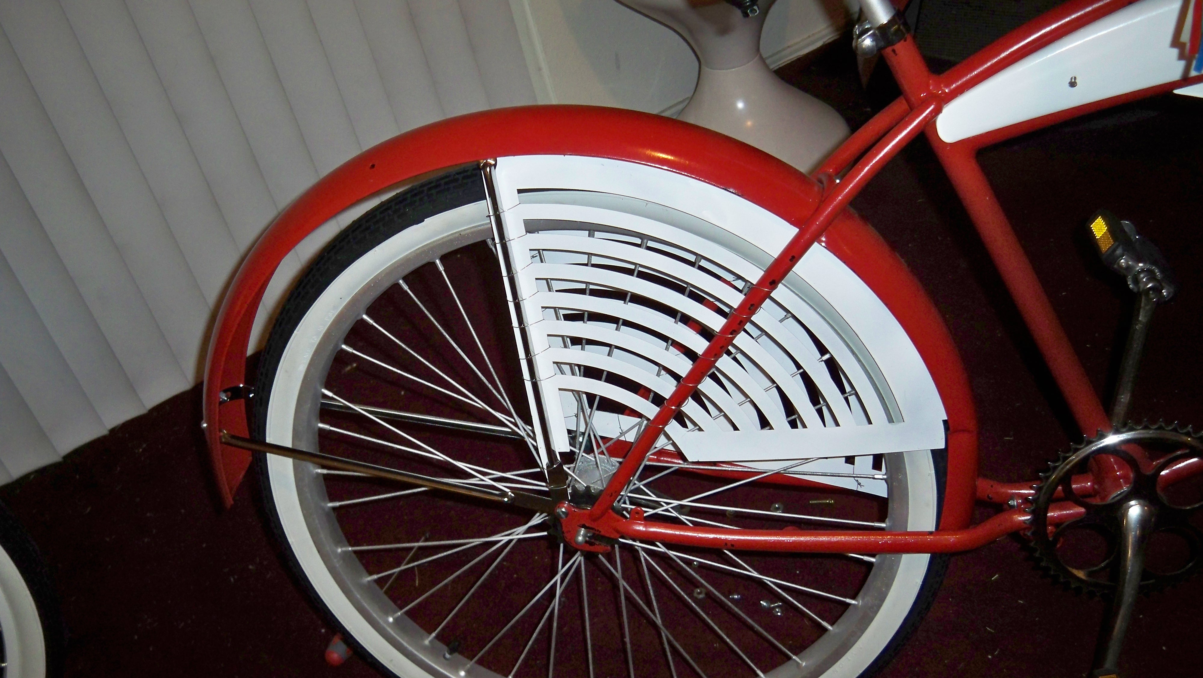

Been a busy weekend. Hope to post a bunch of pics soon. Been tinkering a lot with the fender skirts in particular. After getting them mounted, I put the tires back in & realized that I had lifted my fenders significantly in order to mount the truss rods in their proper location. Doh!
I'll have to drill new holes in the bottom of the truss rods so I can lower the fenders back like they should be. Before I re-do them, does anyone have suggestions on the best way to make sure the skirts stay put, without having to drill a ton of holes into them? How did you all get yours to stay in place? Did you actually attach the skirts permanently to the fenders via welding, rivets, etc, or are they just mounted to the truss rods? Right now I just have a ton of wire holding them in place on the frame, but that doesn't seem like a terribly permanent solution.
Here is the trick, basically you build a new fender brace but one that is flat bar, about 1/2" wide flat bar looped around like the original, you use that instead of the original rear brace. The skirt will then sit flat against that. I drilled two small holes on either ends of where the skirts touch and added wire and twisted it, you also bolt it in but the wire is less noticeable
Ahh, makes sense. Now I understand. What I assumed was just for reinforcement on your skirts was actually the truss rod essentially. Next time I hit the hardware store I'll look for a 1/2" bar for that.

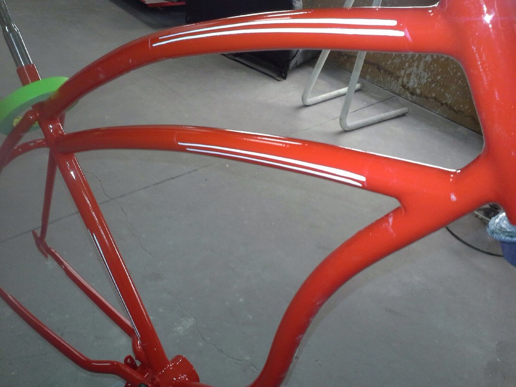

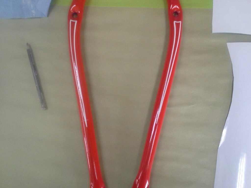

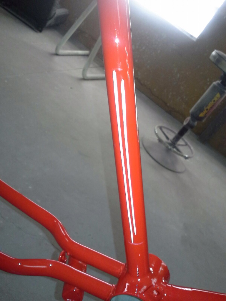

Small update. My bike is at the pin striper. I think the guy thought I was crazy making him go through hundreds of pictures of screen used bikes to decide how mine should look. Luckily he's a good egg and stayed awake.
