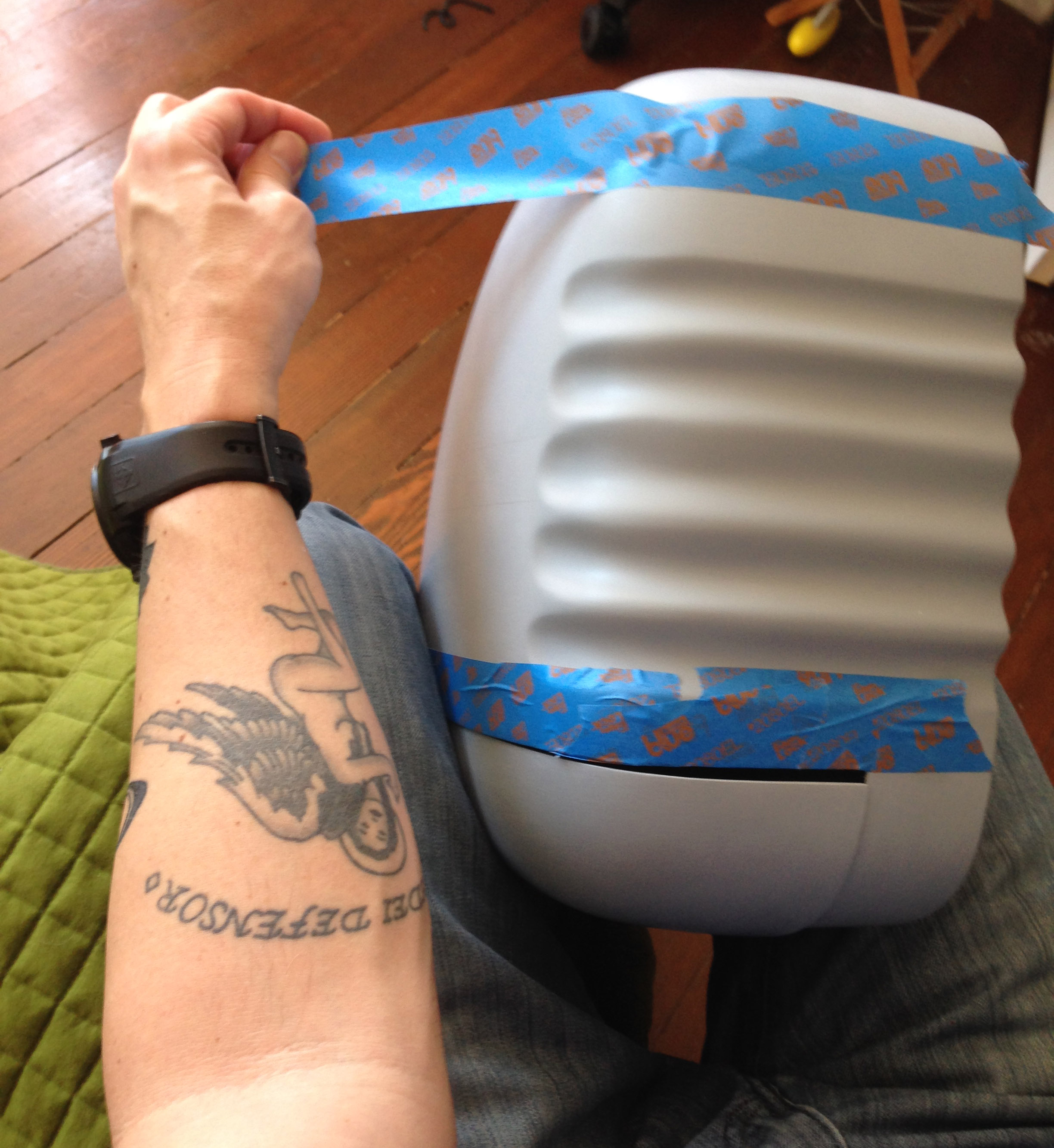

2mm strips. Ok this is interesting. Thanks for sharing your tip! I am gambling that most paints will suck even with a glass like perfection free surface to paint on. I ran across some foil called Flite-Metal that looks interesting. Has anybody tried this on your saddle bags? Any other tips on doing the chrome on the bags. For reference my bags look like this photo attached. masking the bags.jpg

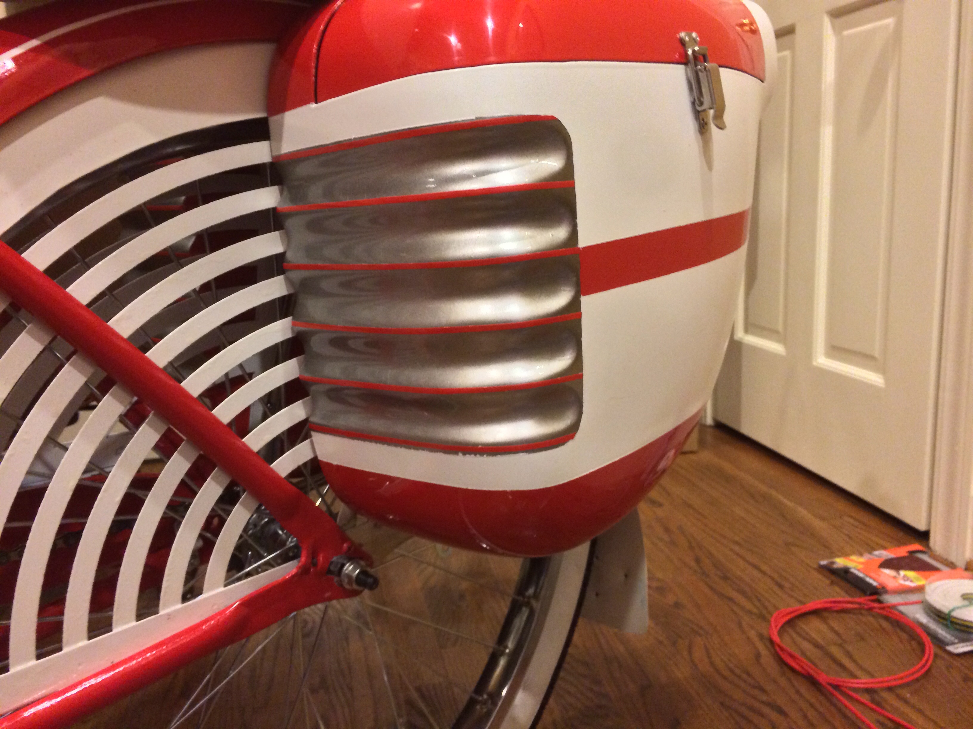

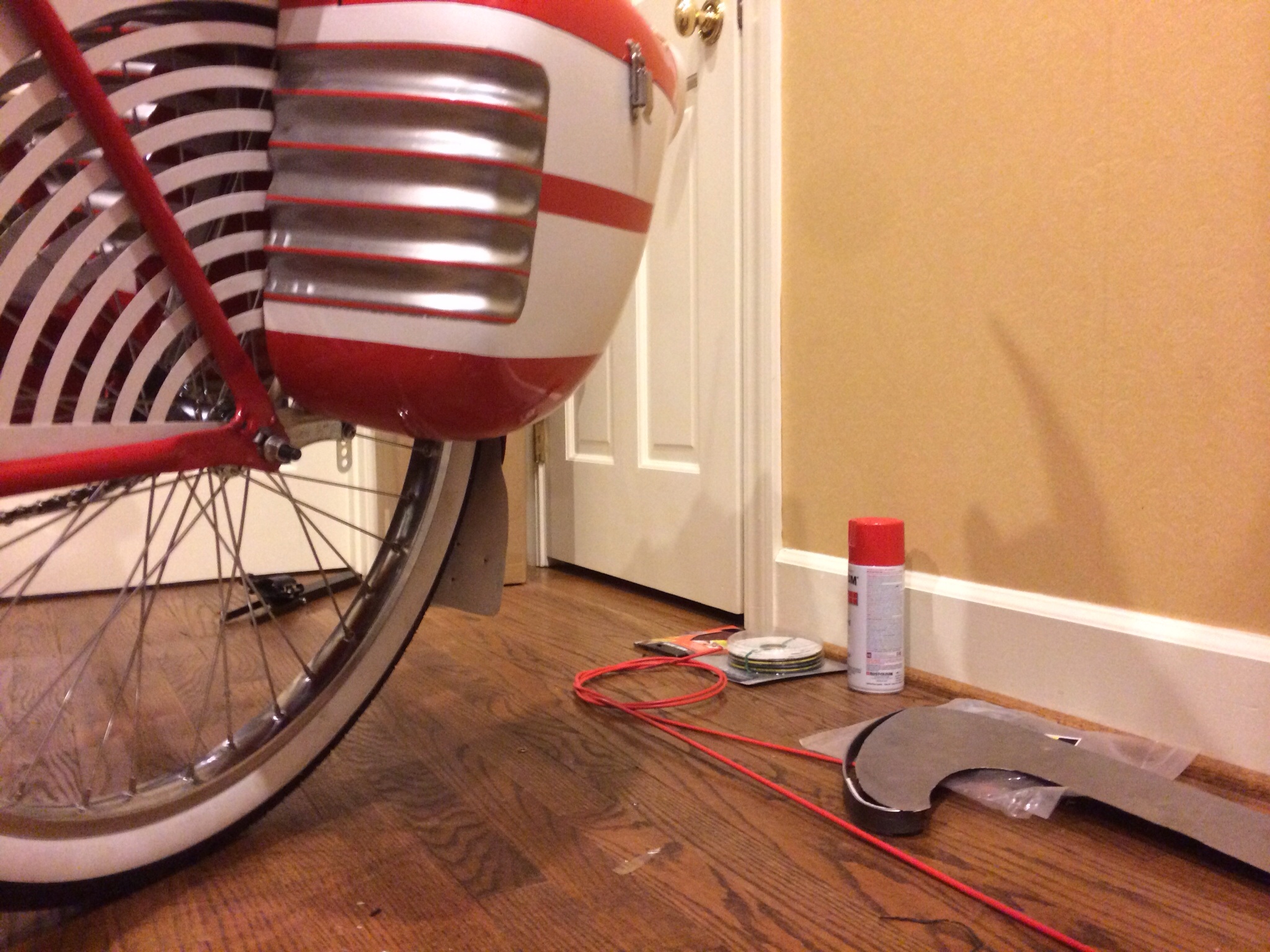

I bought a set of his bags , before I used chrome tape I tried killer chrome from alas corp. thus is what is looked like
