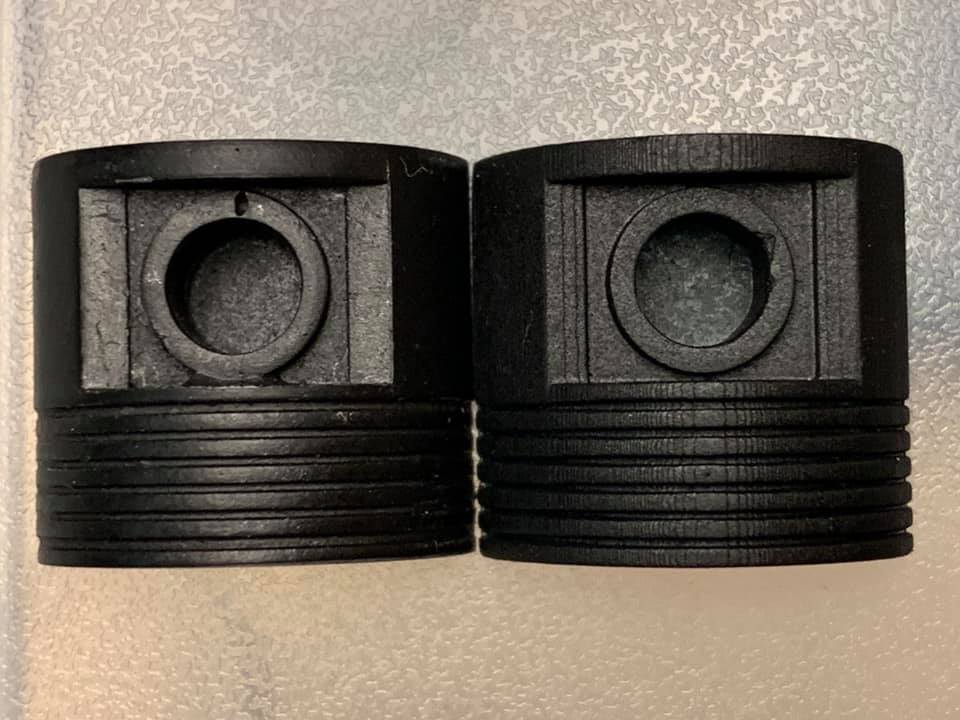

Needed some more V8 pistons for the Dagobah blaster. I have 2 of the Visible V8 kits and somehow never noticed that you have to fill in the back of these! Well that, coupled with me being a hoarder, prompted me to 3d model some accurate pistons and print in resin. Infinite greeblies!!! Resin cast from a real part on the left, 3d print on the right. The print lines will sand right off, but I'm not sure I'll bother. I think I'm .05mm off in a couple spots...

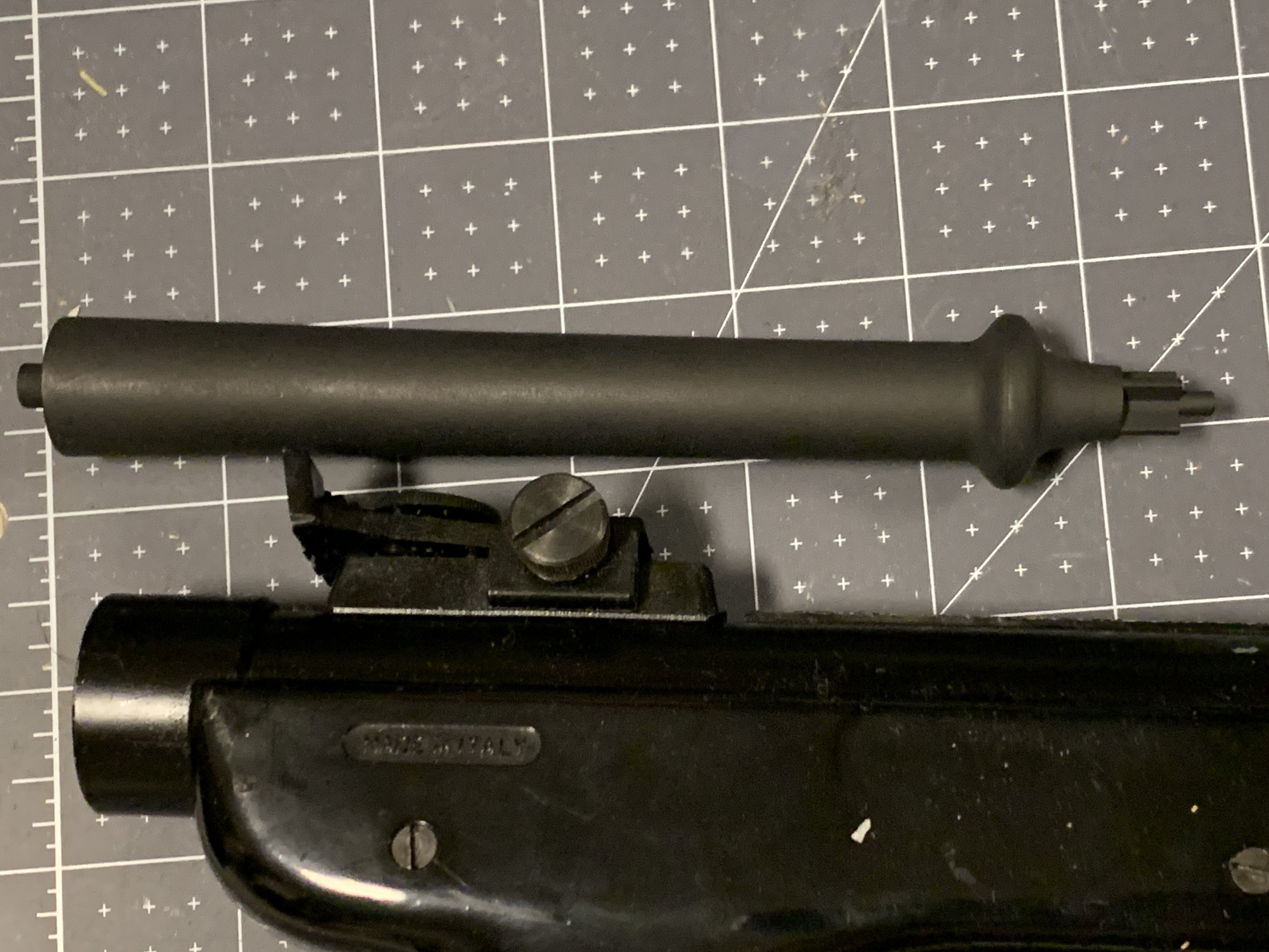

I started a new 3d project while waiting for a shipment of resin so I can finish up my DG-29 prints. Anyone care to guess what this will be? Grasp with hand or flipper, your choice! Also handy in the snow...but I need to come up with a real mortar fin (or two).

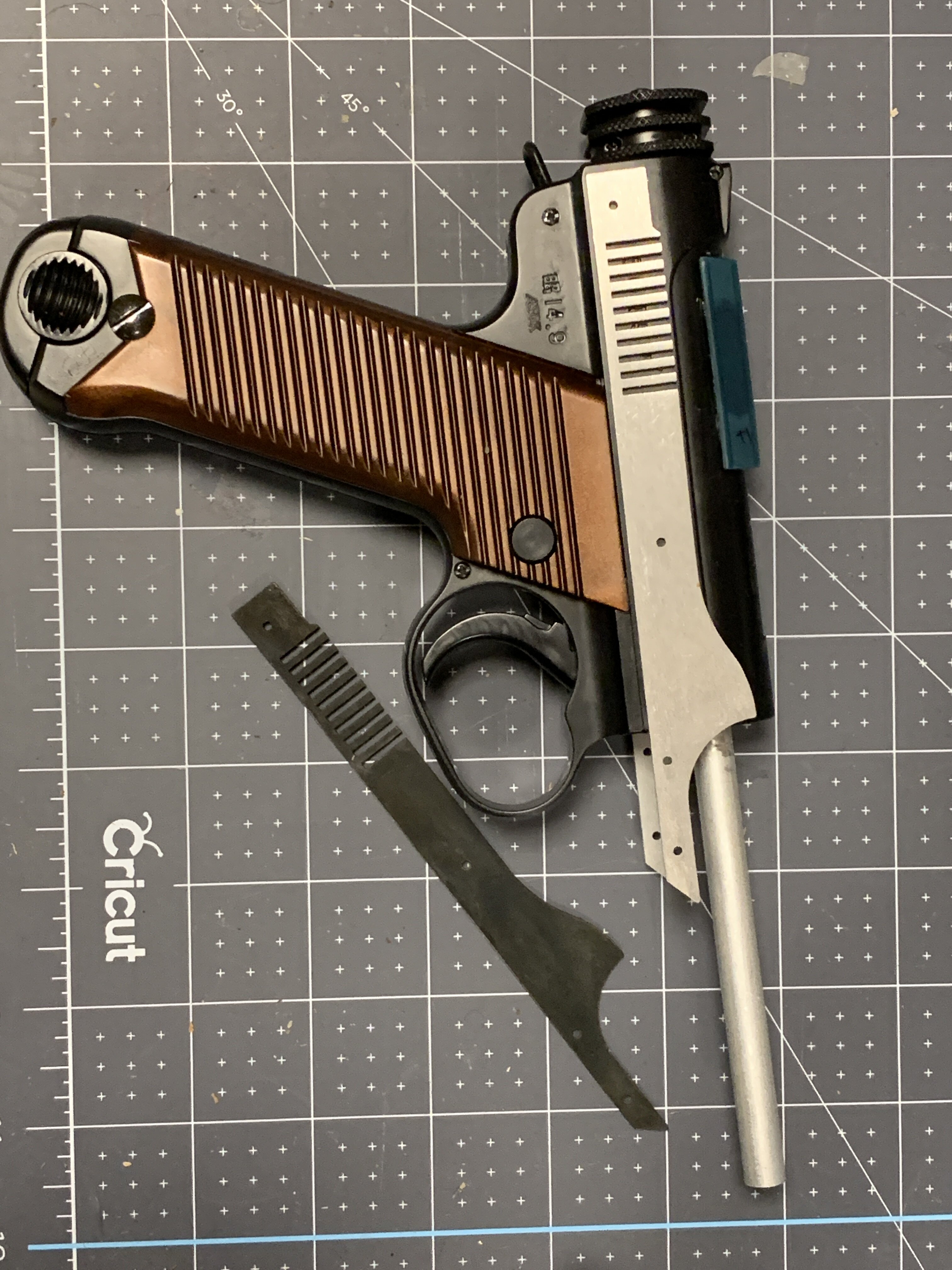

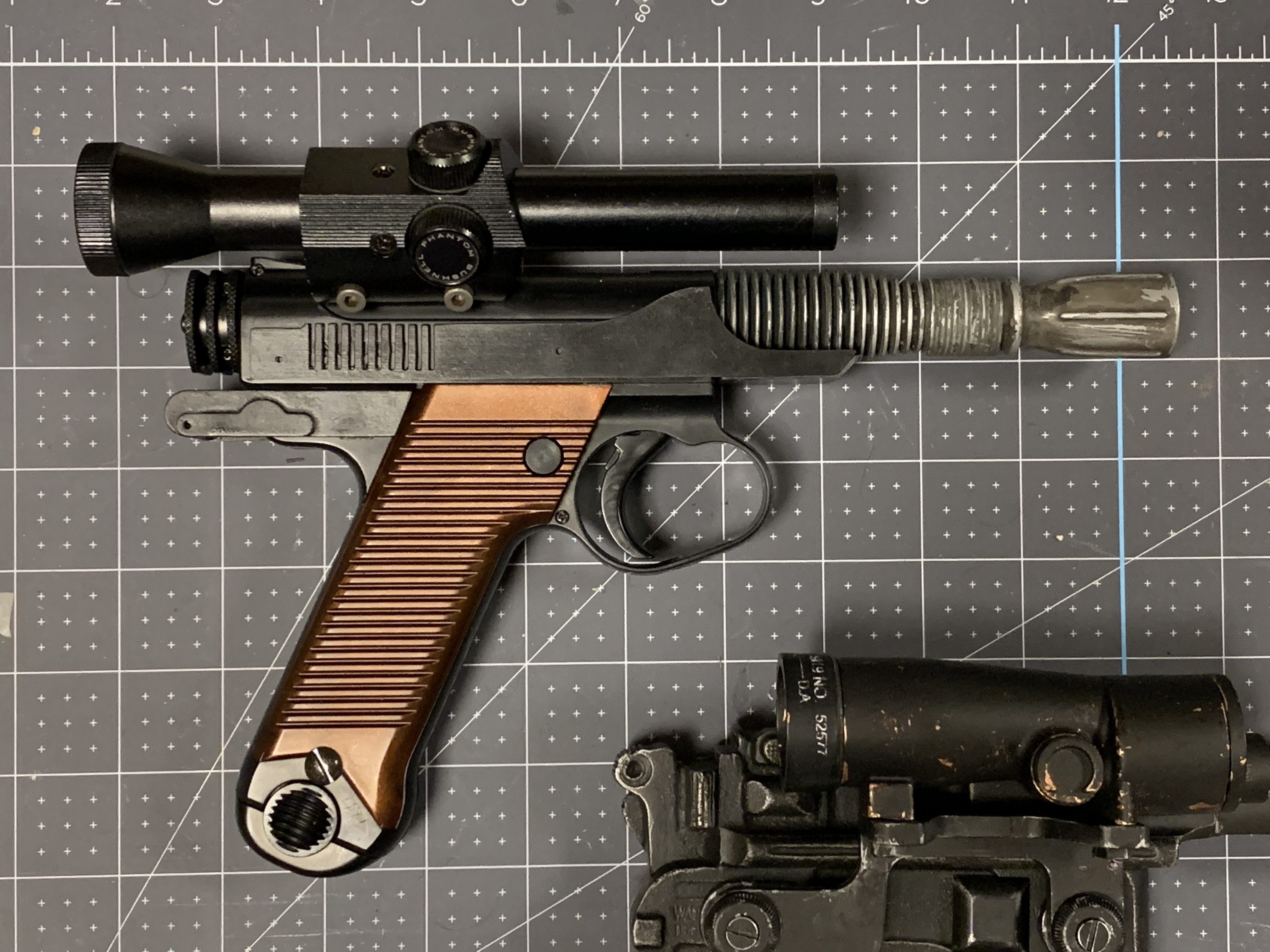

I’m on a blaster roll here! This one has been stewing in my brain for a while, Cara Dune’s blaster pistol from The Mandalorian. There are some decent 3d prints around, but none I’ve seen are accurate. I scoured screen caps and costume display photos to get this as close as I can to the real deal. It’s actually a fairly simple conversion for the most part. I’ll try to find some time to post my research info, but for now, here’s my prototype build.
This is built on a Tokyo Marui Nambu 14, but I believe that the hero prop was a Hudson PFC model.The add-ons are resin printed, but I’ll be replacing the side panels with laser cut aluminum. Here’s a fit test - perfect!
The barrel is a stand in, will replace with a repaint that’s more accurate.

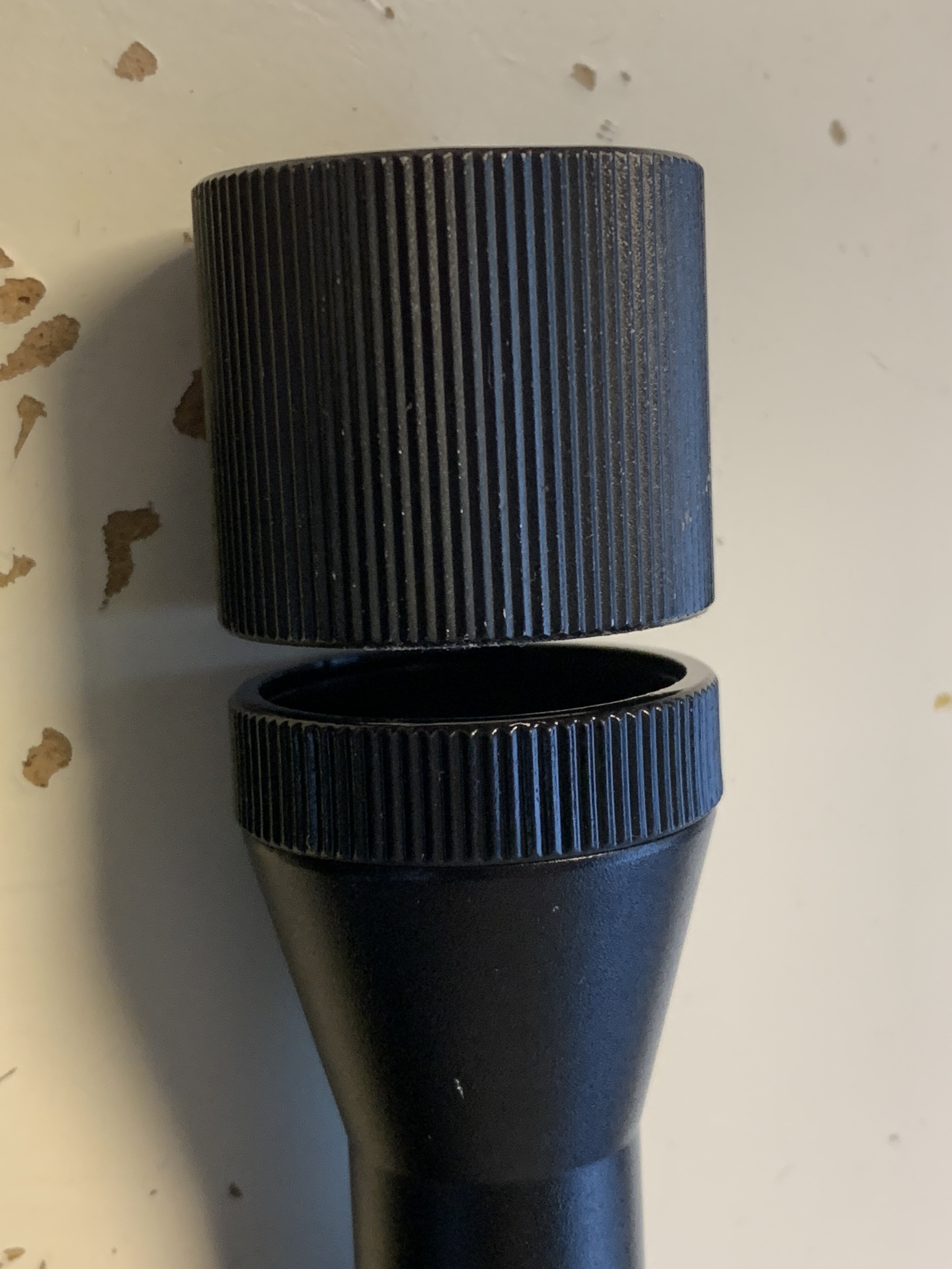

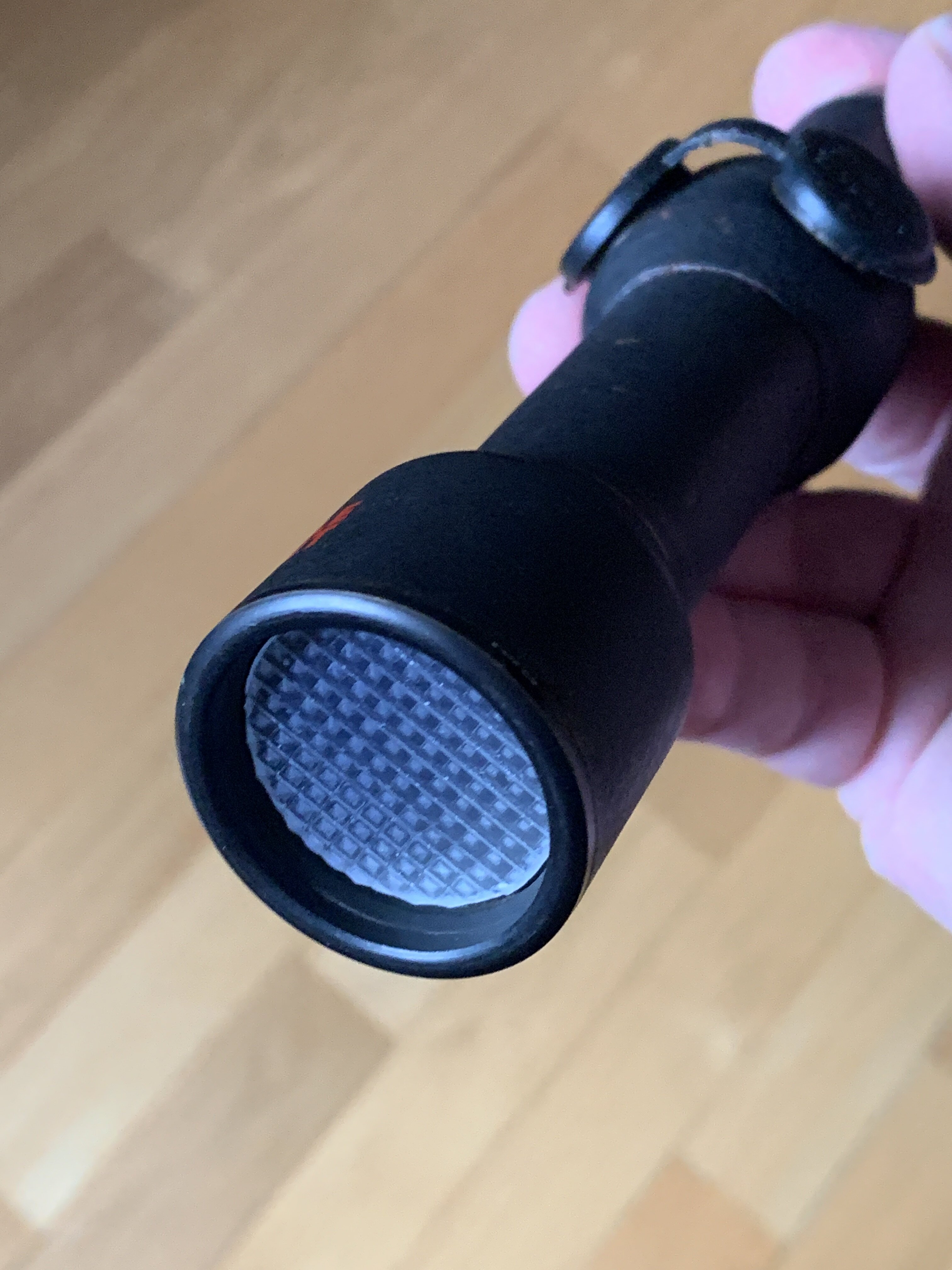

The scope is a real Bushnell Phantom, I replaced the eyepiece with a 3d printed part. Took me 3 tries to get the knurl right but I think I nailed it.

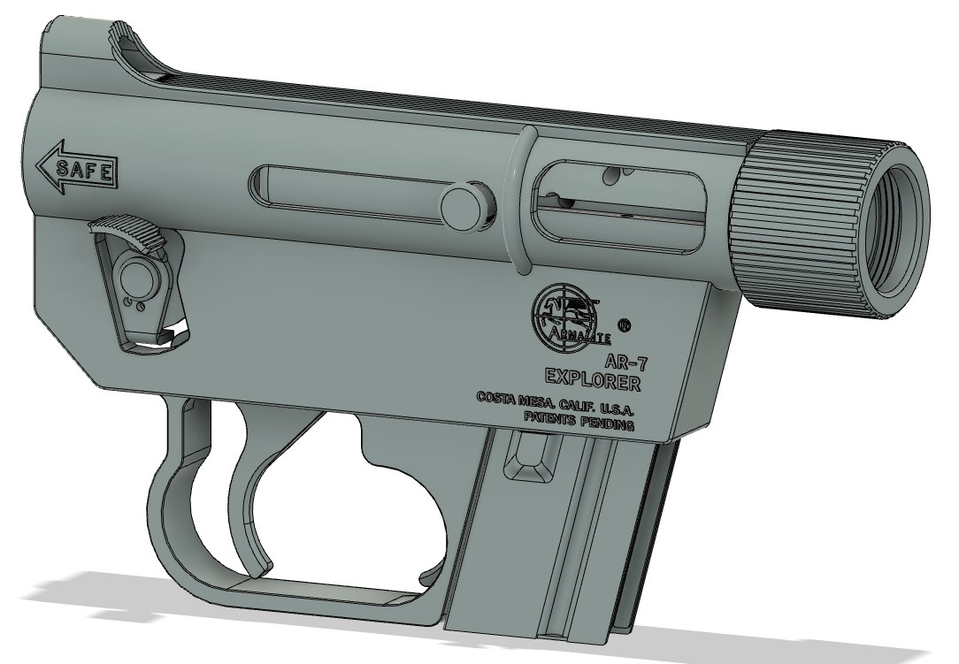

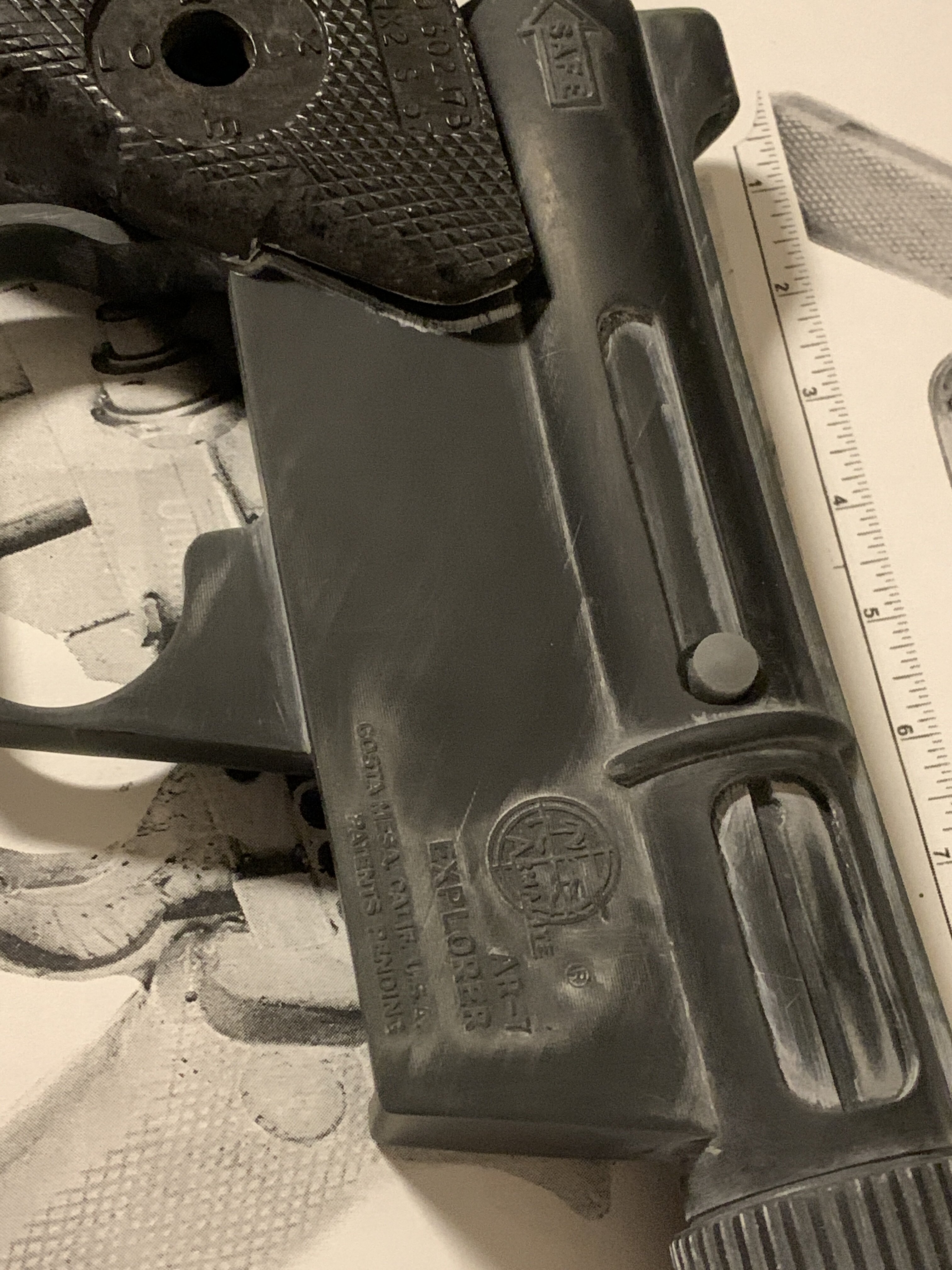

ed-209 - I didn't make this model from scratch, so I cannot sell copies. I'm pondering re-building it though, the majority gets tossed for this build, and what's left is probably only a few hours of modeling work with a good scale drawing to work from. If there's interest I'll give it a shot.
ed-209
OH! I was under the impression you 3D printed the AR7 Receiver. Did you obtain it from someone else? If so, can you tell me where I can go to get one? --Ed
Pedro
I did print it, but using a free model I found at GrabCad (with a bunch of modifications). You're not the first person to ask though, so there's a good chance I'll build (3d model) my own soon and print some more... This started on a whim when a guy asked me about modeling a Ponda Baba grip. Needed to scale to the weapon, so..."Hmm, I wonder if I can find an AR-7?"
But it's gradually turning into a pet project, as they all tend to do, so don't give up hope... ;) Also, there's a guy on Etsy (Blaster Master maybe?) who apparently sells resin casts of a Charter Arms AR-7 (so a bit different from the correct Armalite I'm making here).

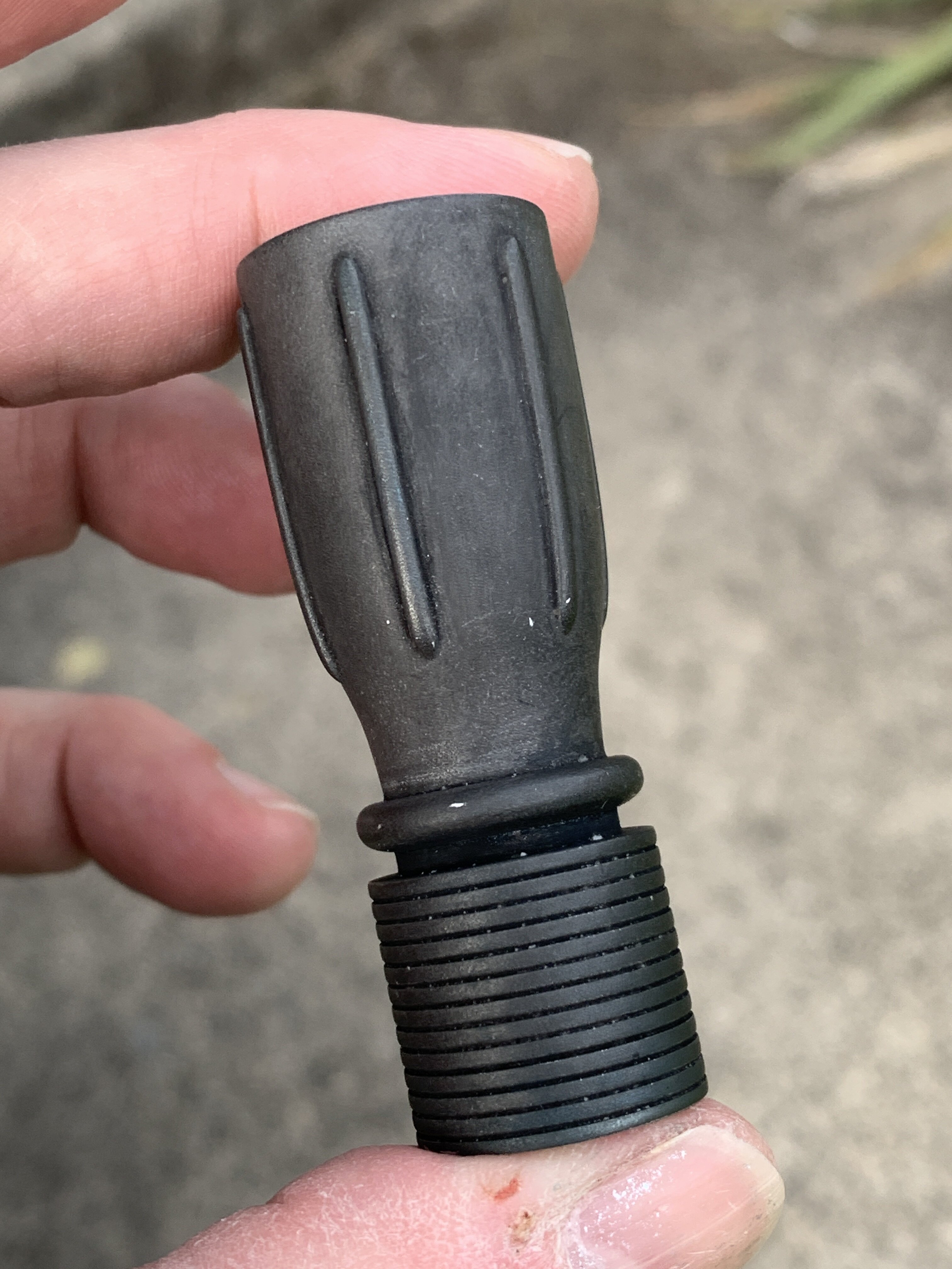

The flash hider and a LOT of other stuff I've been making is painted with my super secret recipe - galvanizing spray paint, blackened with Aluminum Black. :D I've been meaning to post a thread about this, it's amazing stuff. It blackens very much like aluminum (maybe a little lighter in color), great for those times when you need to fill a hole or something in a metal gun too. Just paint over the filler and blacken it, blends right in. If you let it cure long enough it's pretty tough too, but a bit fragile for a couple weeks.
The flash hider on this one was first painted silver (heavy coats so I don't wear through). Next I applied clear Kiwi shoe polish, polished it up, then sprayed a couple coats of the galvanizing paint and dunked it in AB. Then I went at it with 0000 steel wool to wear off most of the blackened paint. The wax underneath provides a bit of a barrier and is a "scratching promoter", gives a bit more control over pulling off the top layers. Then it's waxed again and polished to what you see here. Probably clear coat would work fine, but I kind of like working with the wax, and it "feels" nice to the touch. It's fun using crazy techniques and chemicals instead of plain ol' paint, makes me feel like a mad scientist!

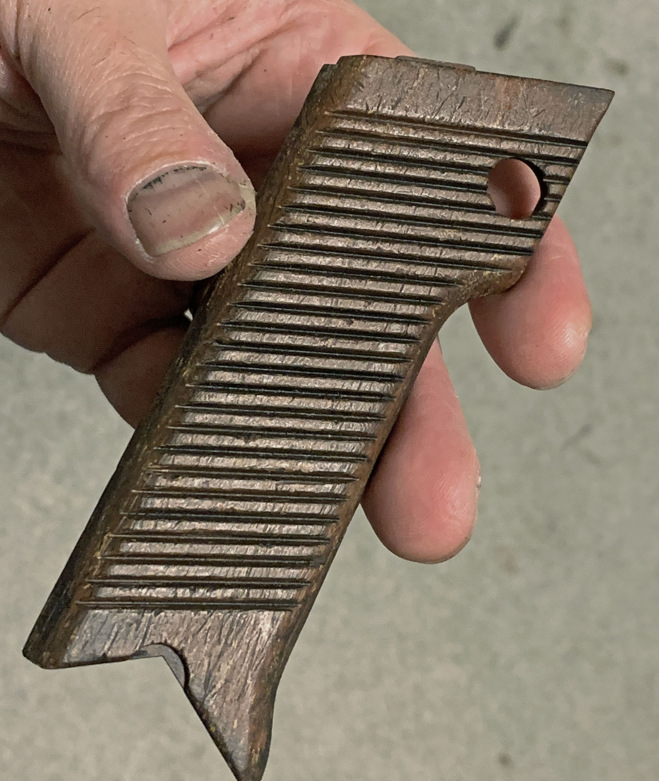

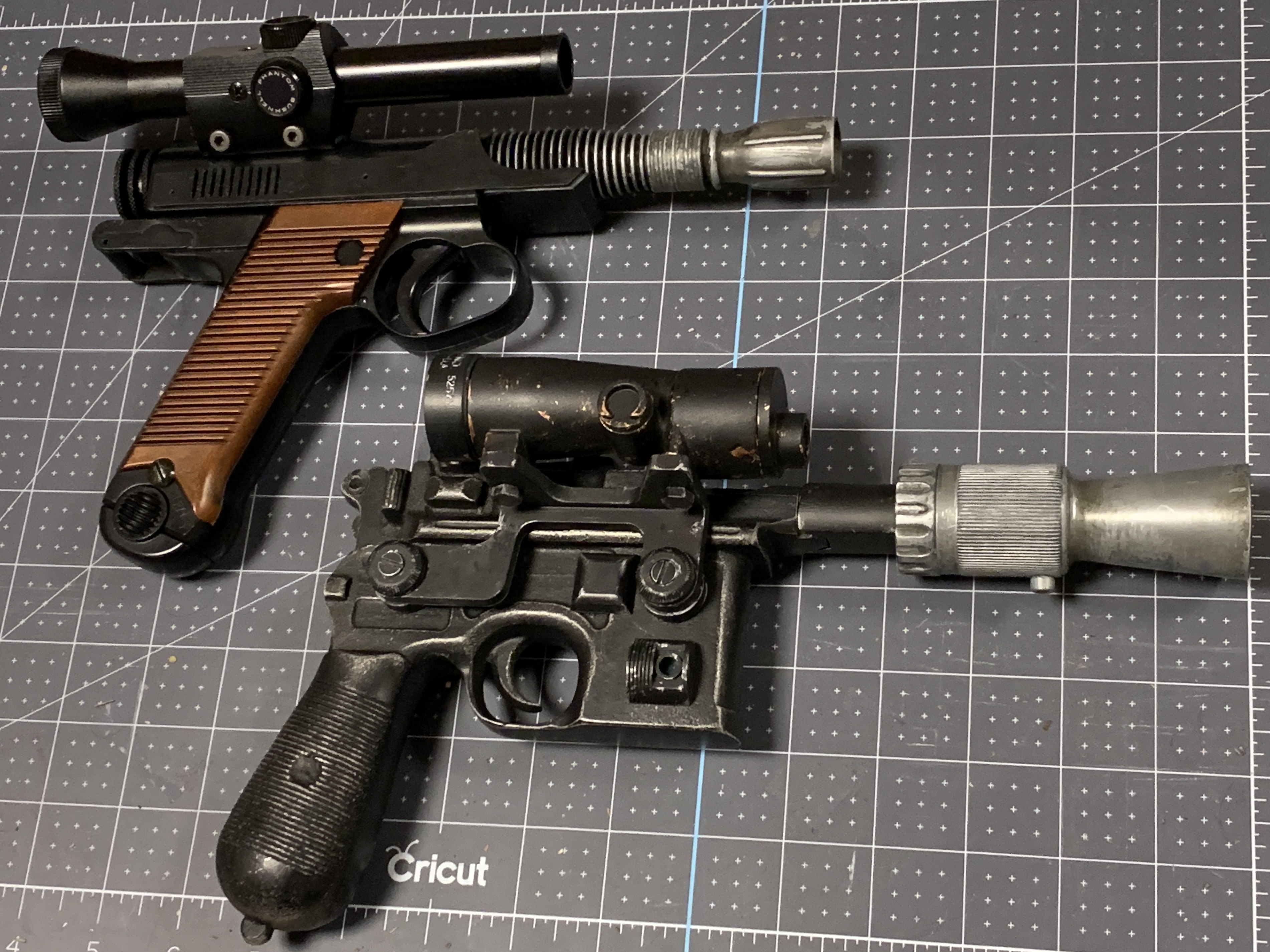

Time for a little update - I'm chewing up the plastic grips on my Nambu, having decided that making my own from wood is too much trouble. I scratched the heck out of them and painted with various shades of brown, shoe polish, etc. They were smooth to start, and I'm really pleased with how my first attempt at faking wood came out!
Pedro
Thanks! I spent a good amount of time studying other wood grips I have and photos of real gun to get it right. You can't see it in the photo, but the various polish applications add some sheen variation too, it really catches the light like old wood.

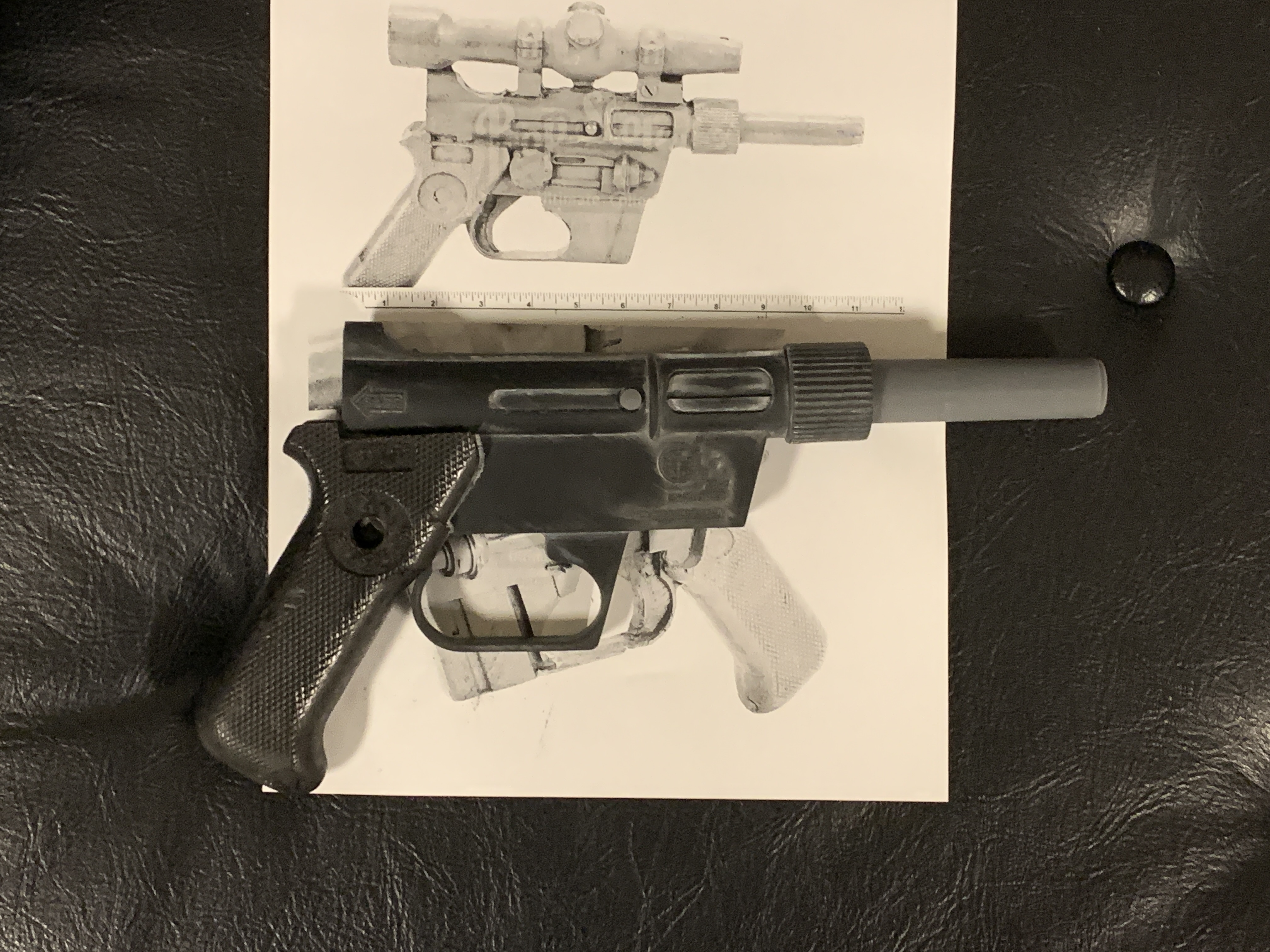

DL-18 Jabba’s guard blaster
This one is my dream blaster, for some reason I really fell in love with this when when I was a kid, probably thanks to the Jedi Luke figure.

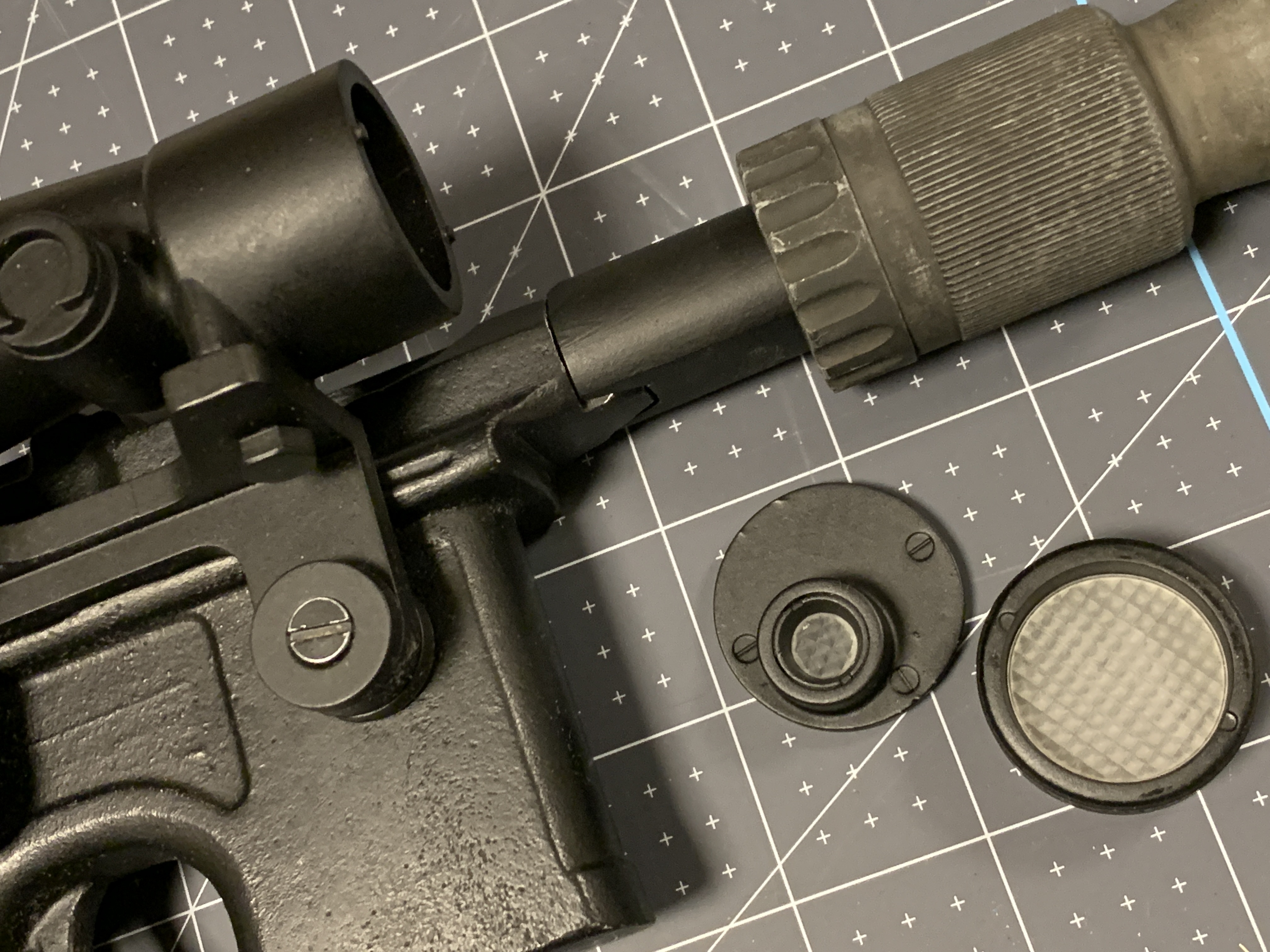

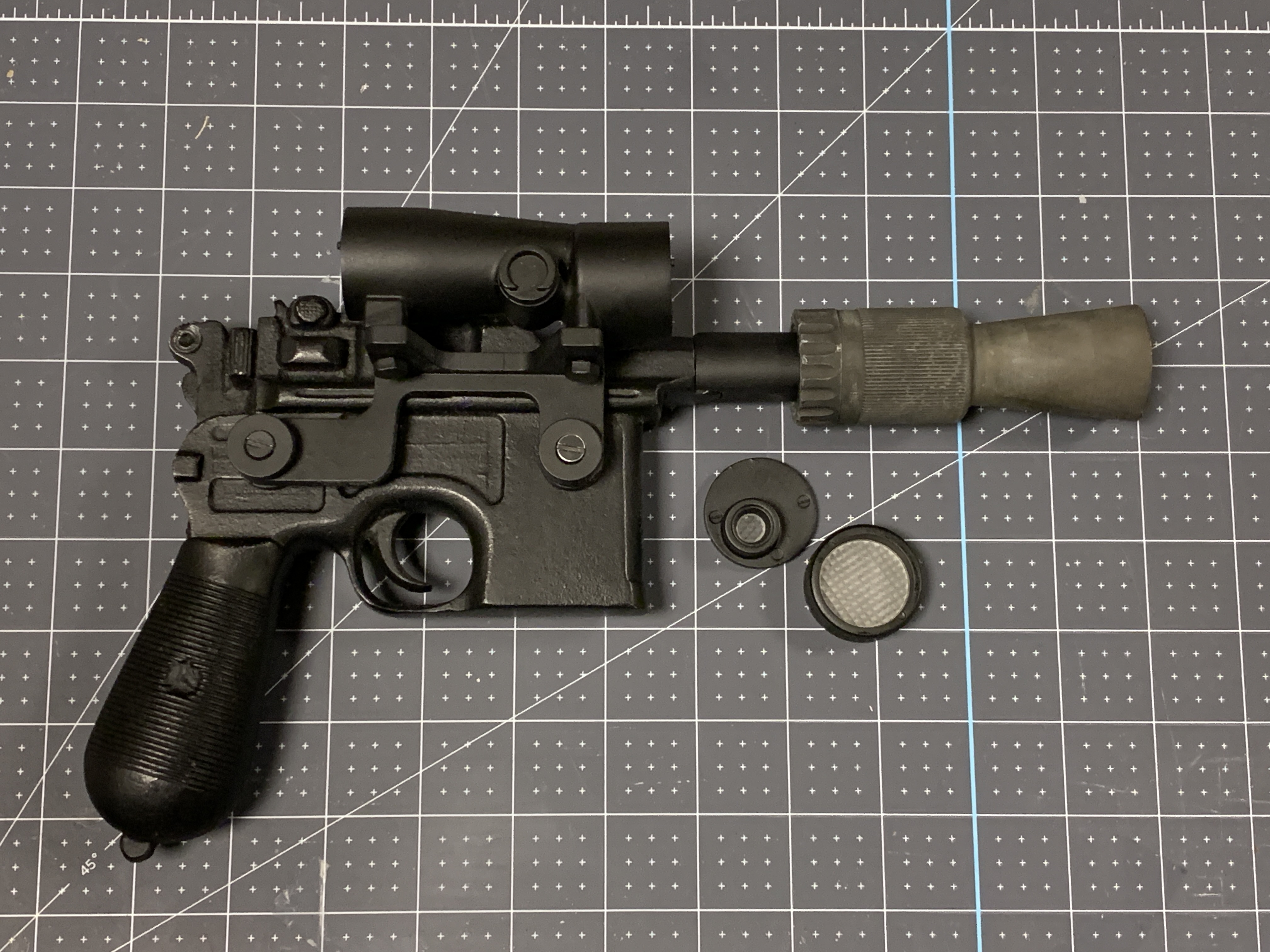

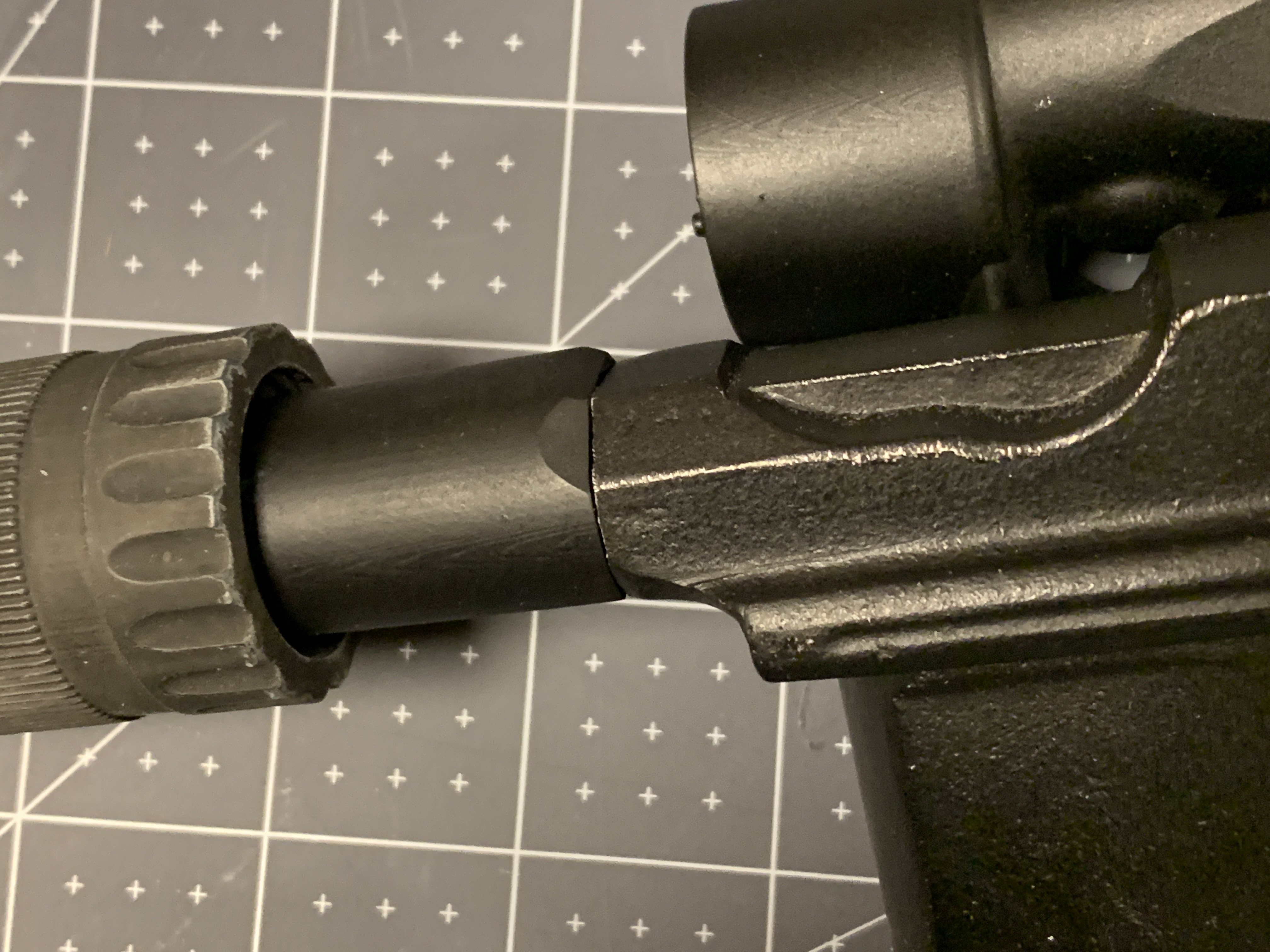

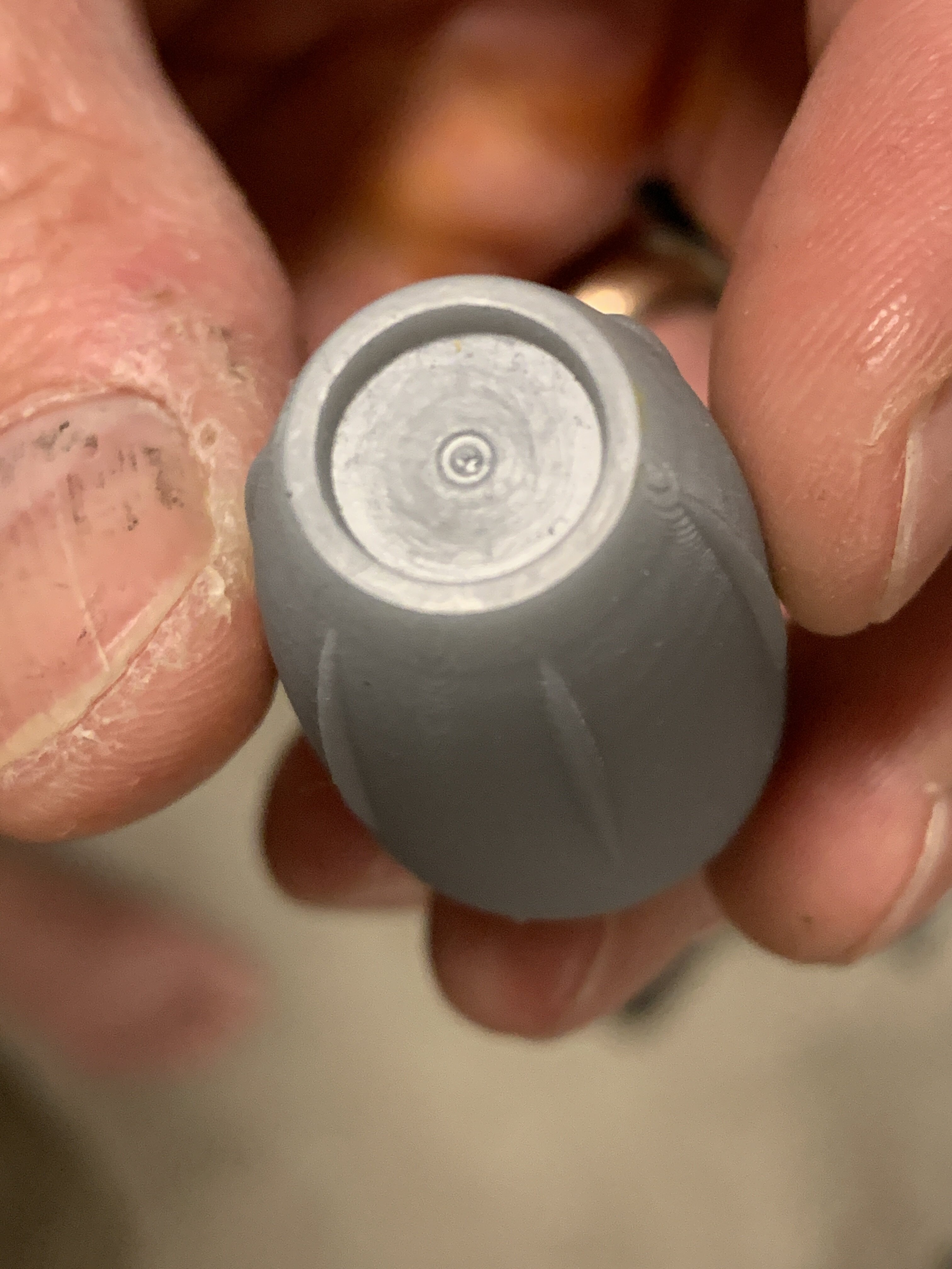

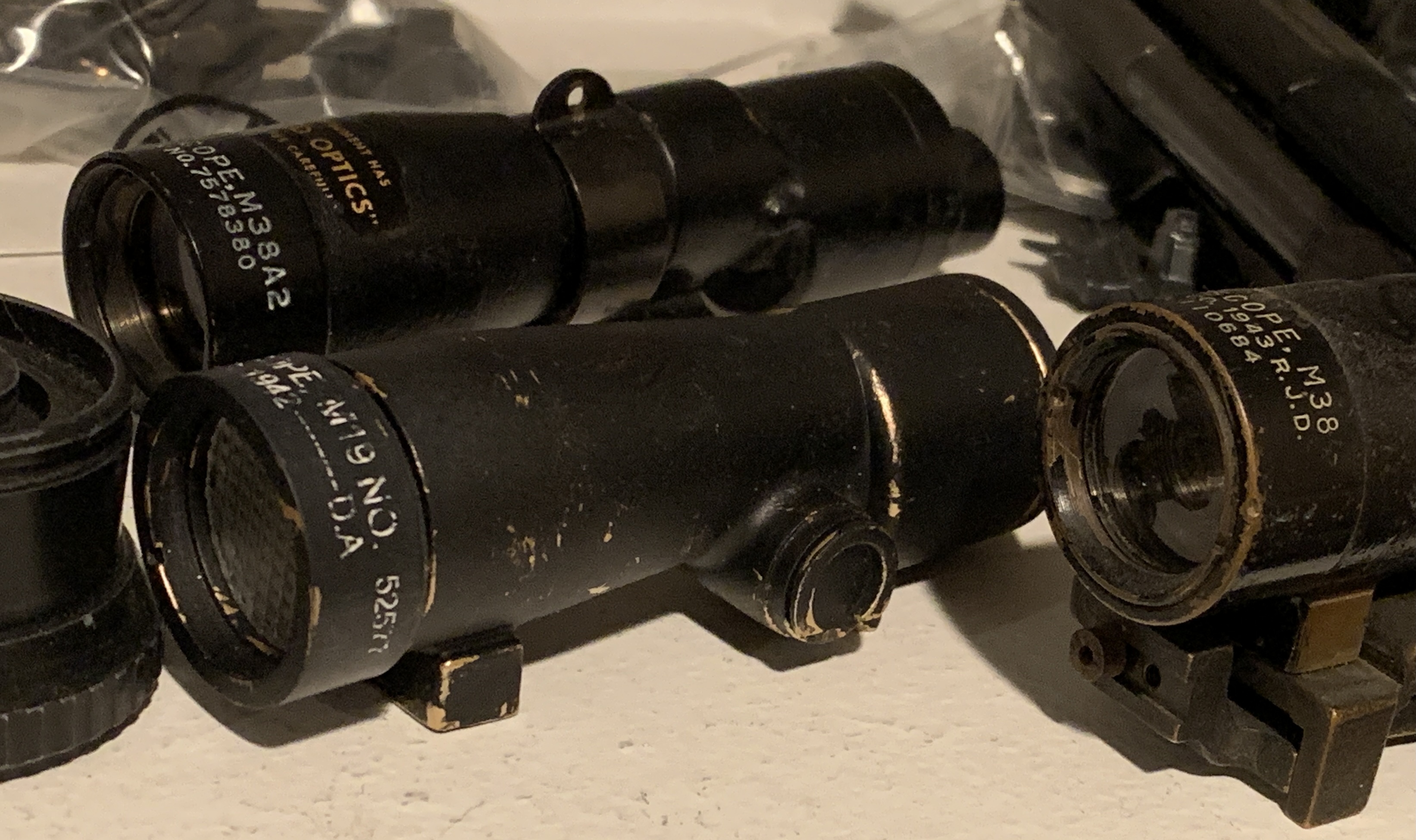

I purchased an RO-72 from OdiWan72 some years ago (this is , and he was generous enough to add some resin cast greeblies. I have side aluminum plates from Corellian Exports as well. I decided to print new Phantom bombs and “what IS that circular greeblie??” to go with CE’s plates, and of course there’s the mysterious “marker cap”. This was the grail for this build, but having looked at hundreds I got nuthin’. So 3D it is...I have added the injection molding flaw I assume would be there IF it were a cap or wire nut, best I can do! ;) This matches exactly with what little photo references we have.

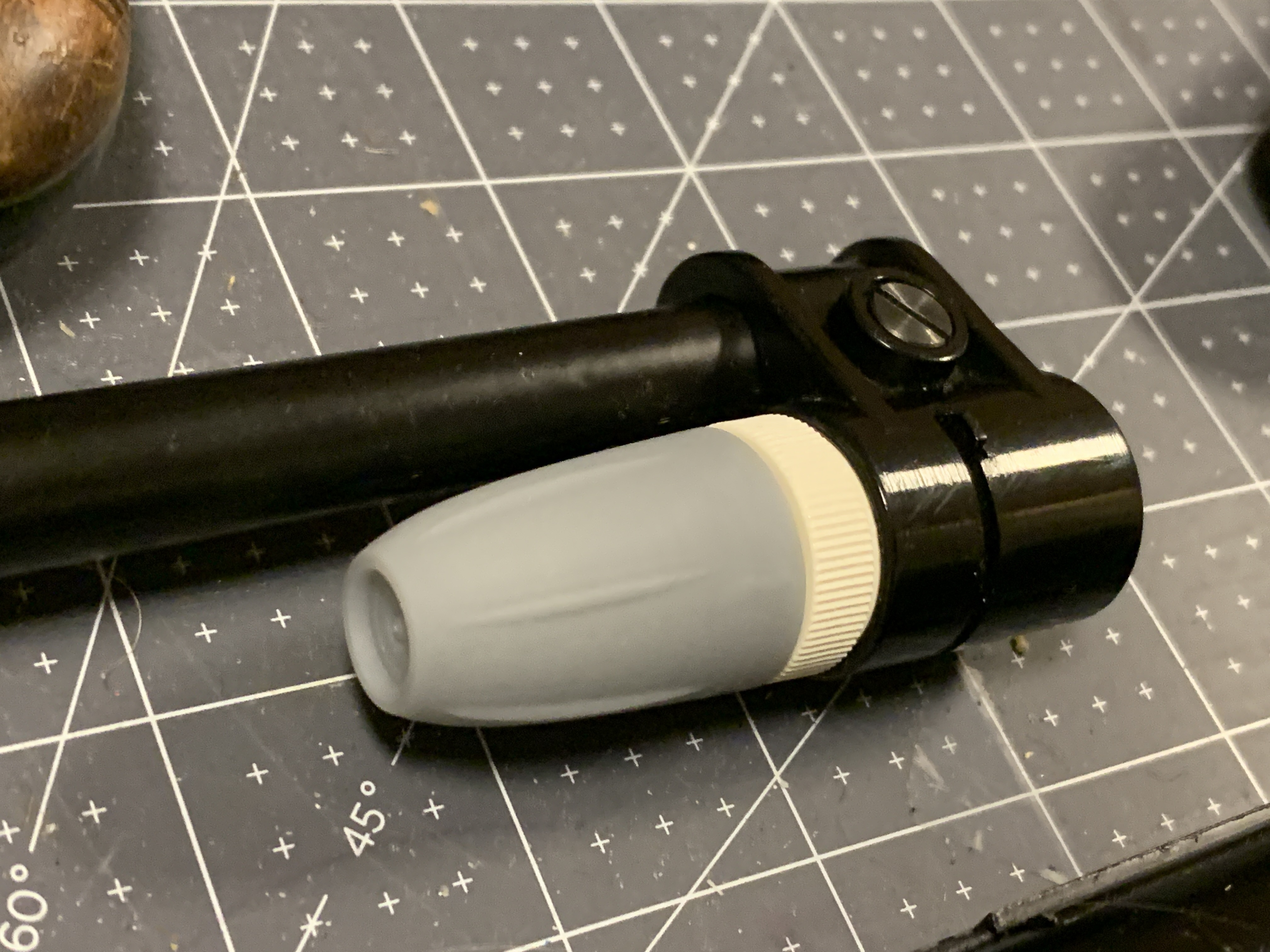

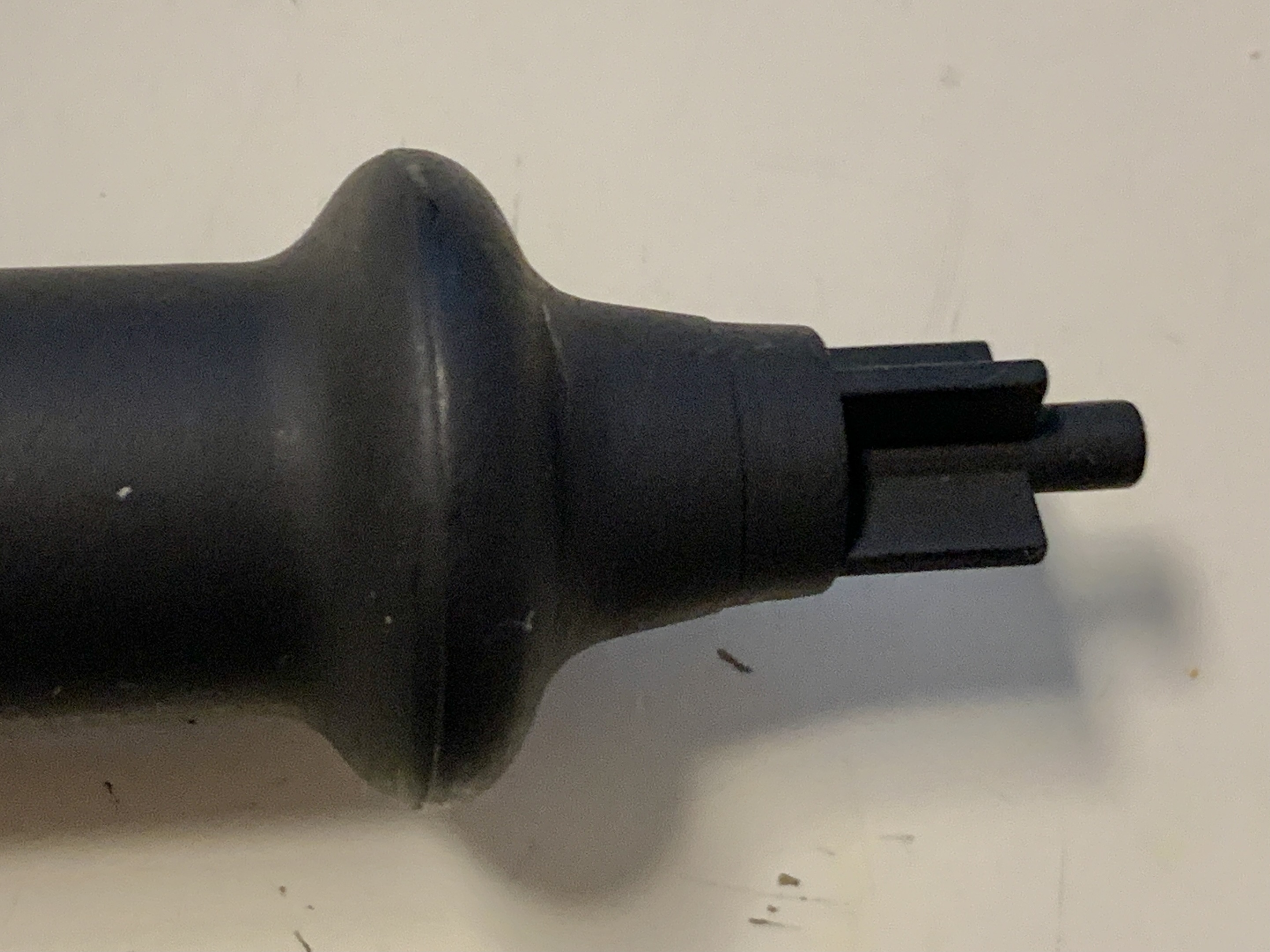

The scope...it HAS to be some sort of probe! I’m going for subtle details on these, since “accuracy” is a bit up in the air. I think I see two small ridges on the top, as well as a slight texture difference demarcated by the “lip” on the ridged part. Rubberized coating maybe? I modeled the lip and will use paint sheen to replicate the textures.
