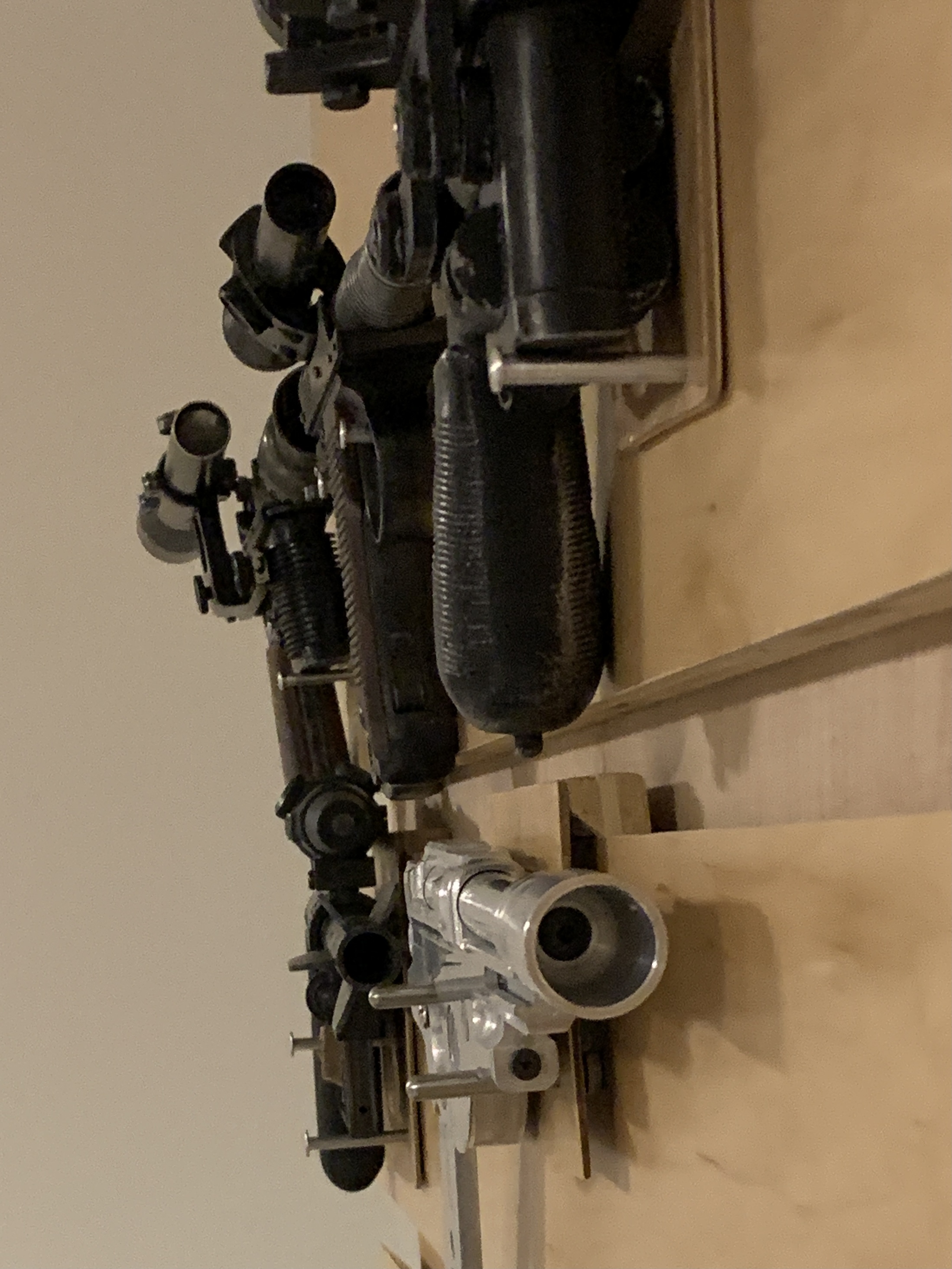

Oh, and I’m building this...as George Carlin said, I need a place for my stuff!

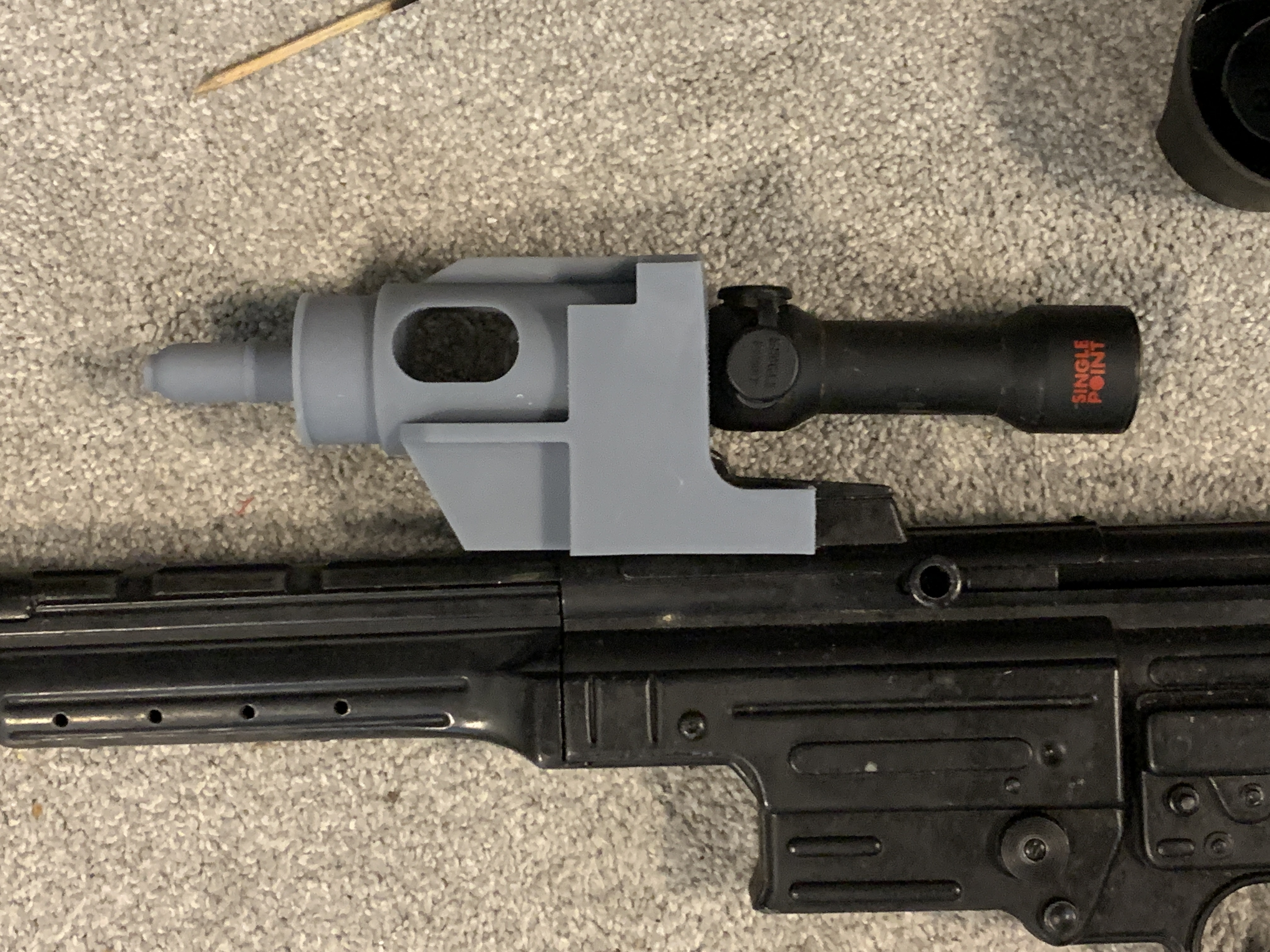

So this guy came off of the printer last night...just ordered accurate(?) scope rings for the Singlepoint. Now how the heck am I going to make the wood forend??

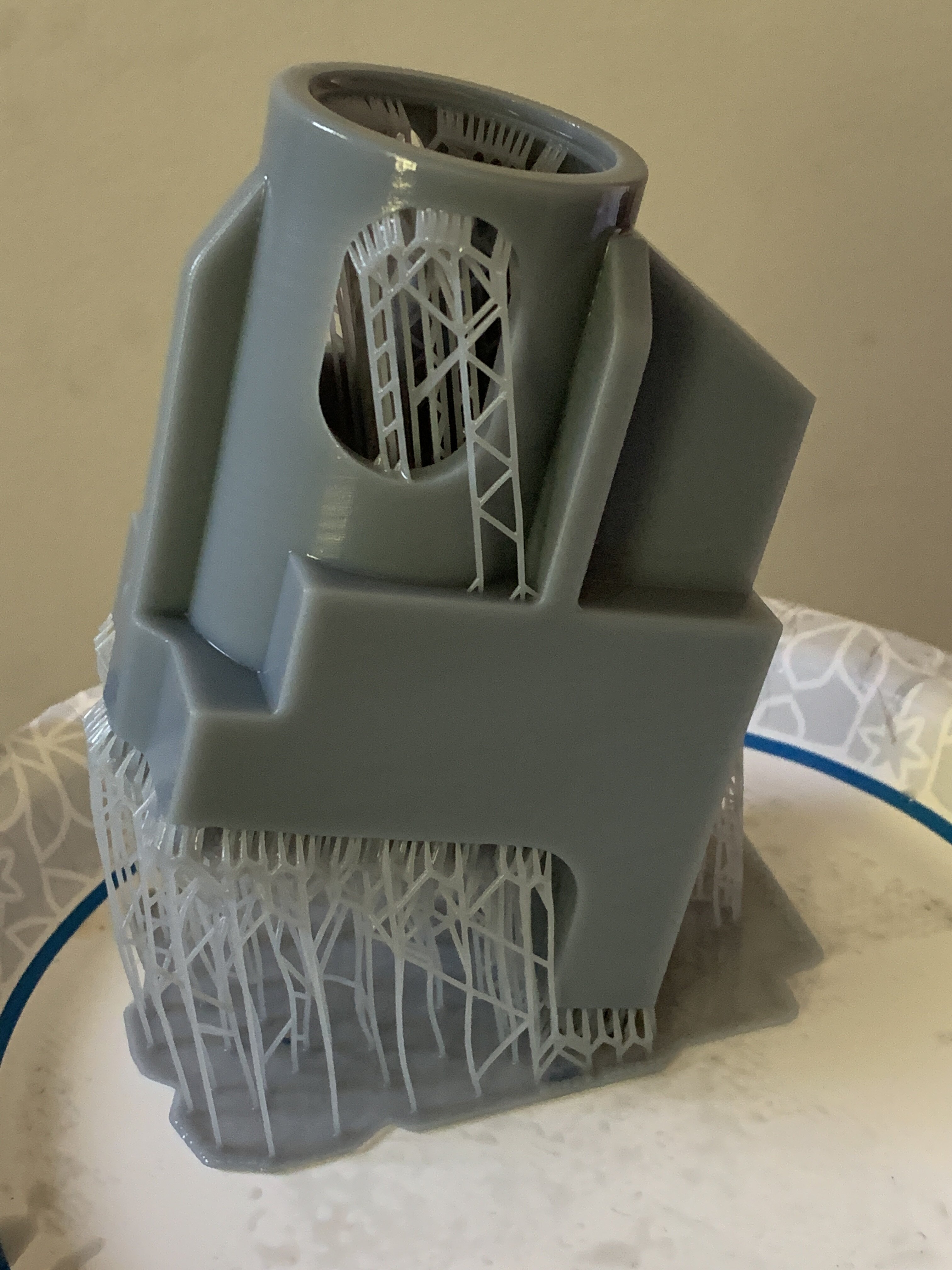

Yeah, I can share the file with you OdiWan72. I'm not sure it's ready for prime time yet though, I still have some tweaks to do and detail to add. You have a Mars, right? This barely fit, would definitely print better on a larger bed since this is a less than ideal orientation (notice the curve on the back where the Singlepoint goes in...should be straight). Anyway, Markus - just PM or email me, I'll set you up... :)

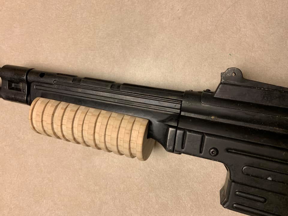

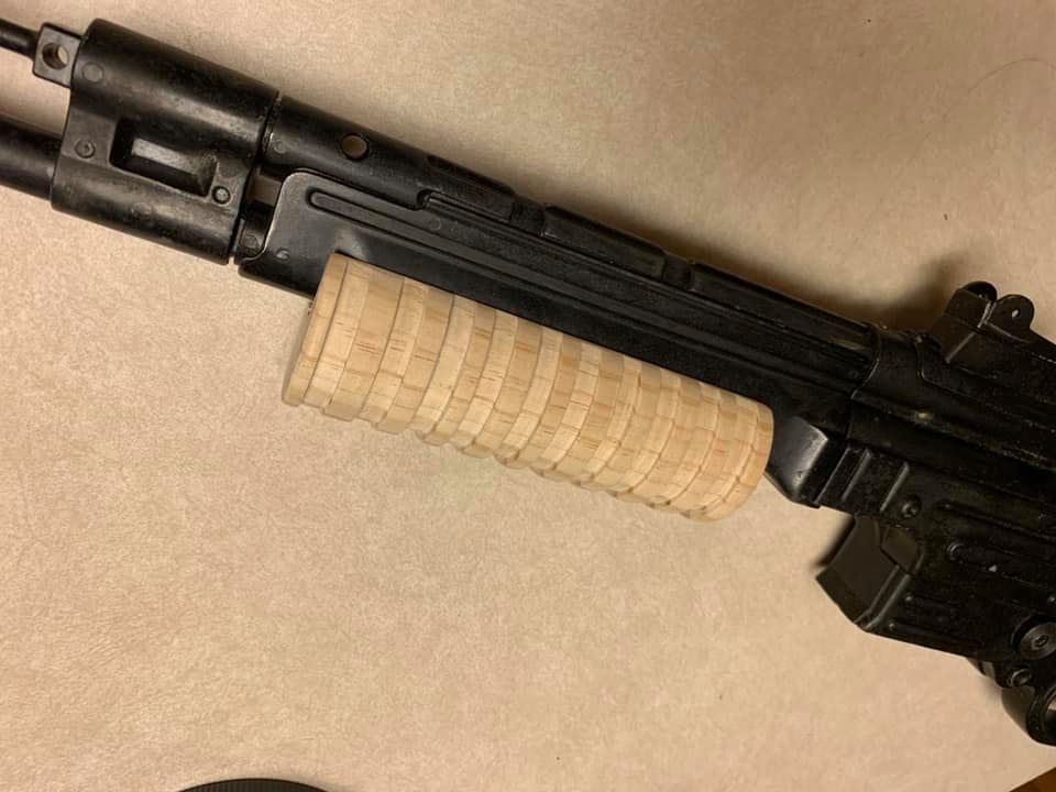

Speaking of which, I was able to knock out this foregrip on my tiny lathe over the weekend. I lathed this from a 2” pole and cut the notch with a table saw. It’s sloppy as hell (very little experience with the lathe), but so is the original. ;) This is intended to replicate the Prop Store gun that was auctioned off a while back (hence the uneven ridges, like a lightsaber!). After studying the available references and screenshots, I believe that these were individually lathed for each prop. Most seem to have 12 ridges, this one has 10, and at least one had 13. Pretty happy with how this came out. If anyone has any good references of this prop I'd be grateful if you shared!

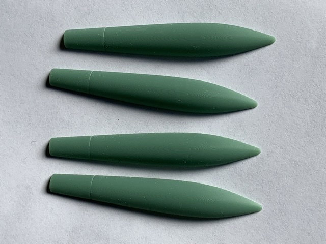

I keep updating the title, then moving on to some other blaster hah! Anyway, inspired by a request for some bomb halves for the DL-18 I decided to try mixing up some green resin to print them. This way no green base coat is needed for that chipped black paint look on the real prop. Here’s what I came up with...could be a little more “olive” I guess (though they’re less pastel color in person), but cool regardless.

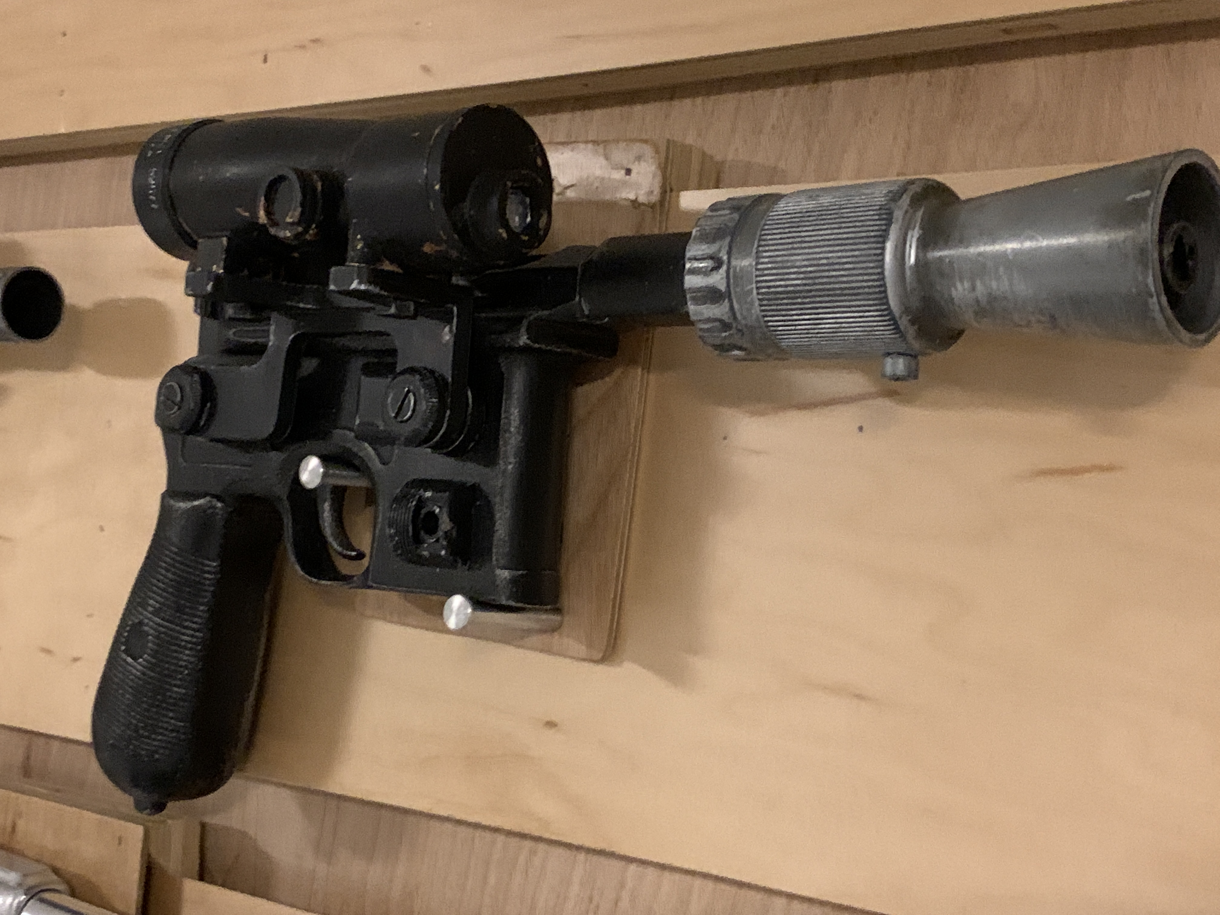

just went through all your updates...what a journey. GREAT WORK and great attention to detail!
Love your paintwork, especially the "metal" flashhider and mortar fin and the wood effekt. How did you archieve these?
Pedro
OdiWan72 Thank you! Detail is the whole point, right? ;)

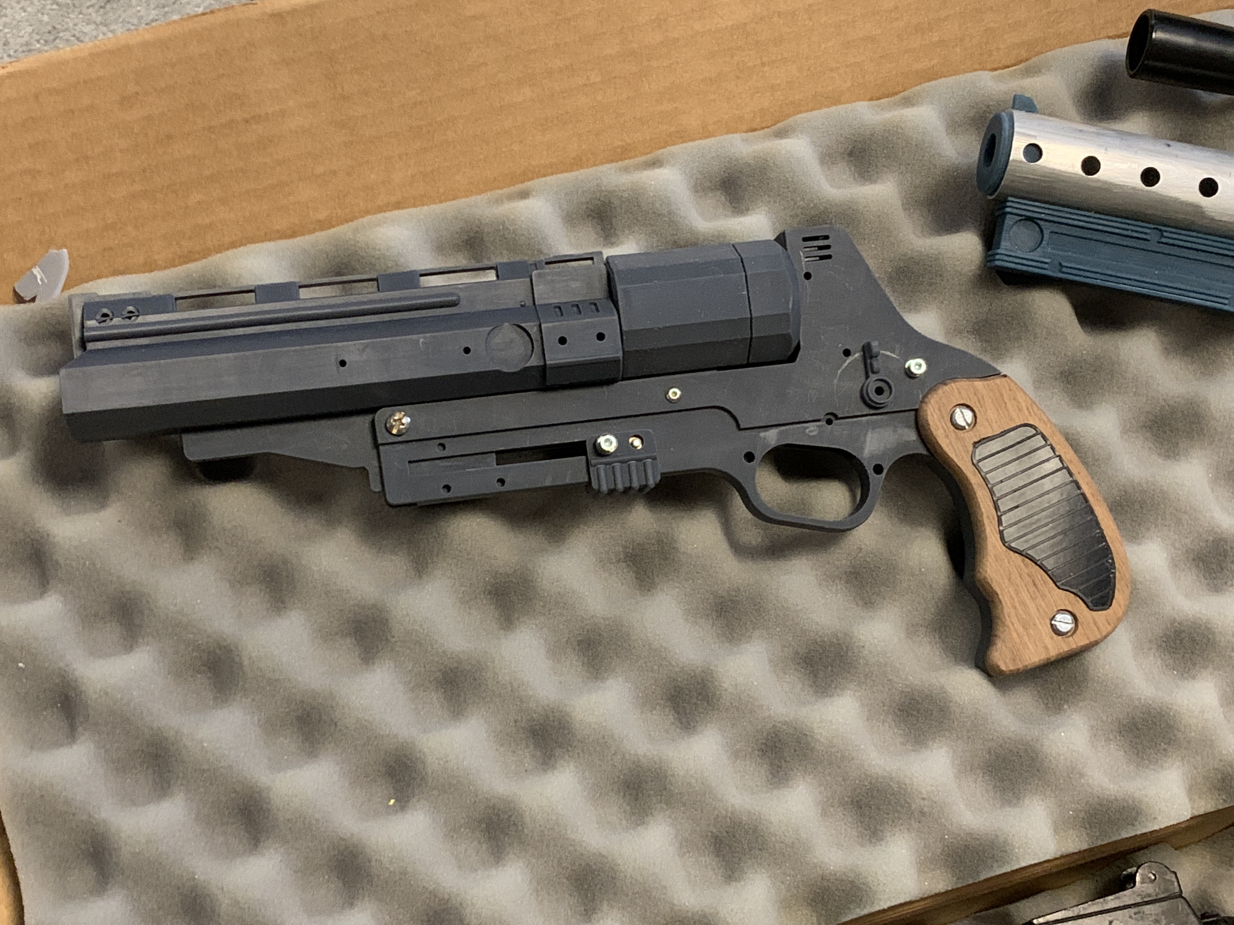

The Nambu grips were the first time I've really tried "wood". It was not that hard actually...I basically scratched the heck out of it to create some "grain" using scriber/knife/steel brush, etc. I sprayed it brown (rust actually, it was on hand), then added layers of some other brown streaks with cheapo craft paint I stole from the kids. I also used both black and brown shoe polish to build up some layers, scratching and messing it up along the way. I didn't expect it to be so successful honestly. I'm getting better at real wood, so probably won't practice this much. :D

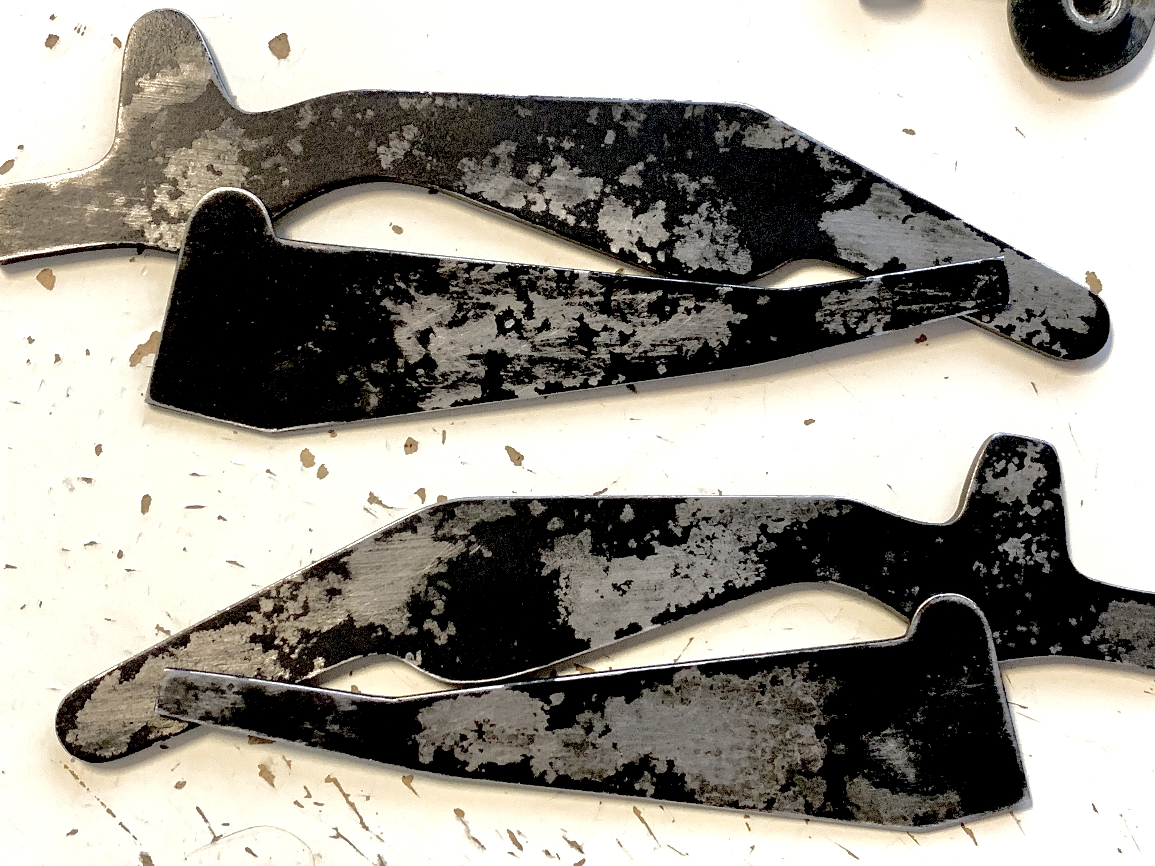

The metal on the mortar fin, flash hiders, and some other stuff is my super top secret. In digging for ways to paint over patches in Denix/metal parts I came across "cold galvanizing" spray paint. Depending on the brand, it's up to 90% zinc. Well zinc blackens with Aluminum Black (AB) etc, so...yeah it works! In short, I prime with CRC cold galvanizing spray bomb and dunk it in Birchwood Casey (there are some other brands of this type of paint of course). It's SO COOL to watch plastic parts suddenly take on this black patina! I use this on almost every project - The Cara Dune blaster is all paint using this method.
I've played with this a lot, and found a lot of different effects you can get. First of all, the paint is a trip - it's a bit soft at first, but hardens up and adheres well. I like to bake it at 200F for 15-20 minutes if the parts can take it, it seems to harden it up, or at least speed the cure. Looks like grey primer, but if you polish it up well with a paper towel it starts to turn silver! You can polish before or after blackening.
Since it has such a high metal content, you can just dunk parts in Aluminum Black, or apply with cotton balls, q-tips, brushes, whatever. Take care with little creases, surface tension tends to keep the fluid out of them. I also decanted some into a bottle so I can do brush touch ups, or other weathering fiddles. You can add paint, blacken again, etc to get various looks. You can also dilute and/or re-use the blackening solution for subtler/slower blackening.
Layering is the key for me. I somehow decided that a layer of clear shoe polish would be good for building up layered paint, protecting the base coats, which turned out to be correct. That helps me get to the base coat color (usually silver/something) without going all the way to the plastic.
If I remember correctly , the Muppet DL-44 flash hider was done like this:
  • - Spray bomb "alumunim" (several coats). I wanted this heavy so I wouldn't polish all the way through when messing with the zinc paint.
  • - Kiwi wax, applied per directions
  • - CRC Zinc-it (several coats)
  • -Polish with paper towels
  • -Birchwood Casey Aluminum black dunk
  • -More paper towel polish, and #0000 steel wood. I hold the flash hider with the wool and rotate it carefully. This reveals some paint underneath and creates the "lathe marks". You could do brushed metal etc with steel wool.
  • -More AB to darken a bit more if I remember, then more "polishing"
  • -Final coat of Kiwi wax
If you look closely on the bottom you can see sort of a darker scar/thingie. That's the dark resin showing through, went a little far with the steel wool, but I liked the overall look and nervous to try to touch up that spot!
The mortar fin on the DL-21 was different - Here it was almost all layering of zinc paint and blackening solutions. I dunked, polished, scratched, streaked/dabbed/flicked with various blackening fluids and a brush or q-tip, brushed on splotches of zinc paint, etc. I just kept fiddling with it and looking at references until I thought it looked authentic. Oh, and this one has some graphite and "chrome" fingernail powder rubbed on as well. Sometimes they act as kind of a resist to the blackening fluids, which gets interesting.
Cara Dune's blaster is mostly straight up CRC dunked in AB. The flash hider was done pretty much like the DL-44, paying attention to keep a lot of the black in the creases/corners.
I dunno, I just fiddle a lot with materials, the parts make themselves I think. :) I hope some of this is helpful to you folks!
