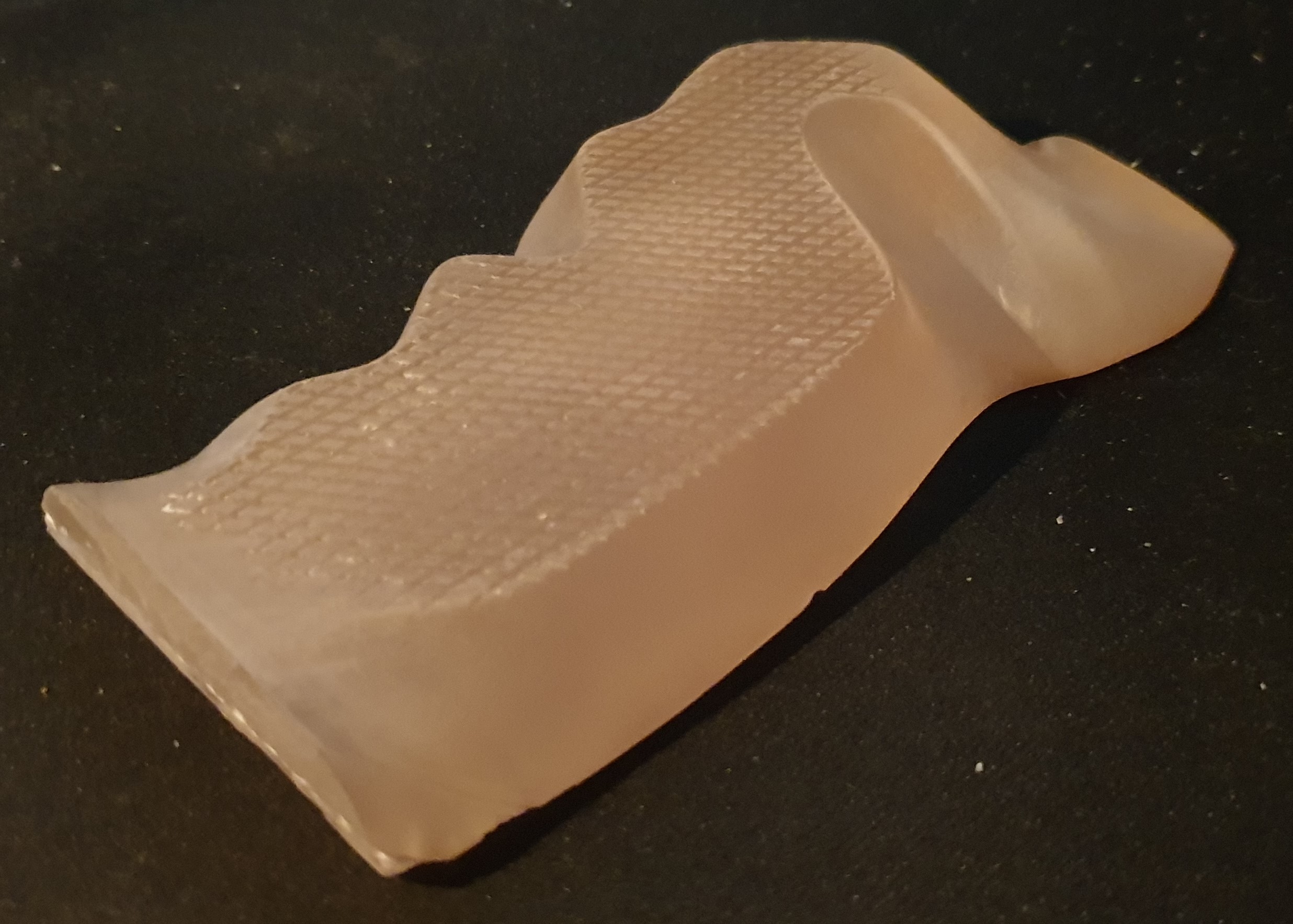

Nice work, a tip for the grips. I found if i want to FDM print near clear stuff. PETG transparent filaments. and you print SLOW and HOT...
So 5-10mms speed no faster youll have to experiment. And 250-260c
I print in resin for that stuff now. But i had some some what okay results.
Doing it this way helps eliminate trapped bubbles. But it wont ever be crystal clear. And you might get the occasional trapped burnt plastic too.
But sand and polish and use a hot iron and some kind of metal relief pattern to do the grip texture.
Or alternatively, get a resin printer buy some transparent orange resin. Or even transparent and mix some amber resin dye into it and print that.
Thats what im going to do when i do my blaster.

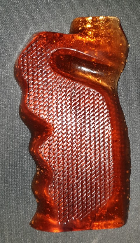

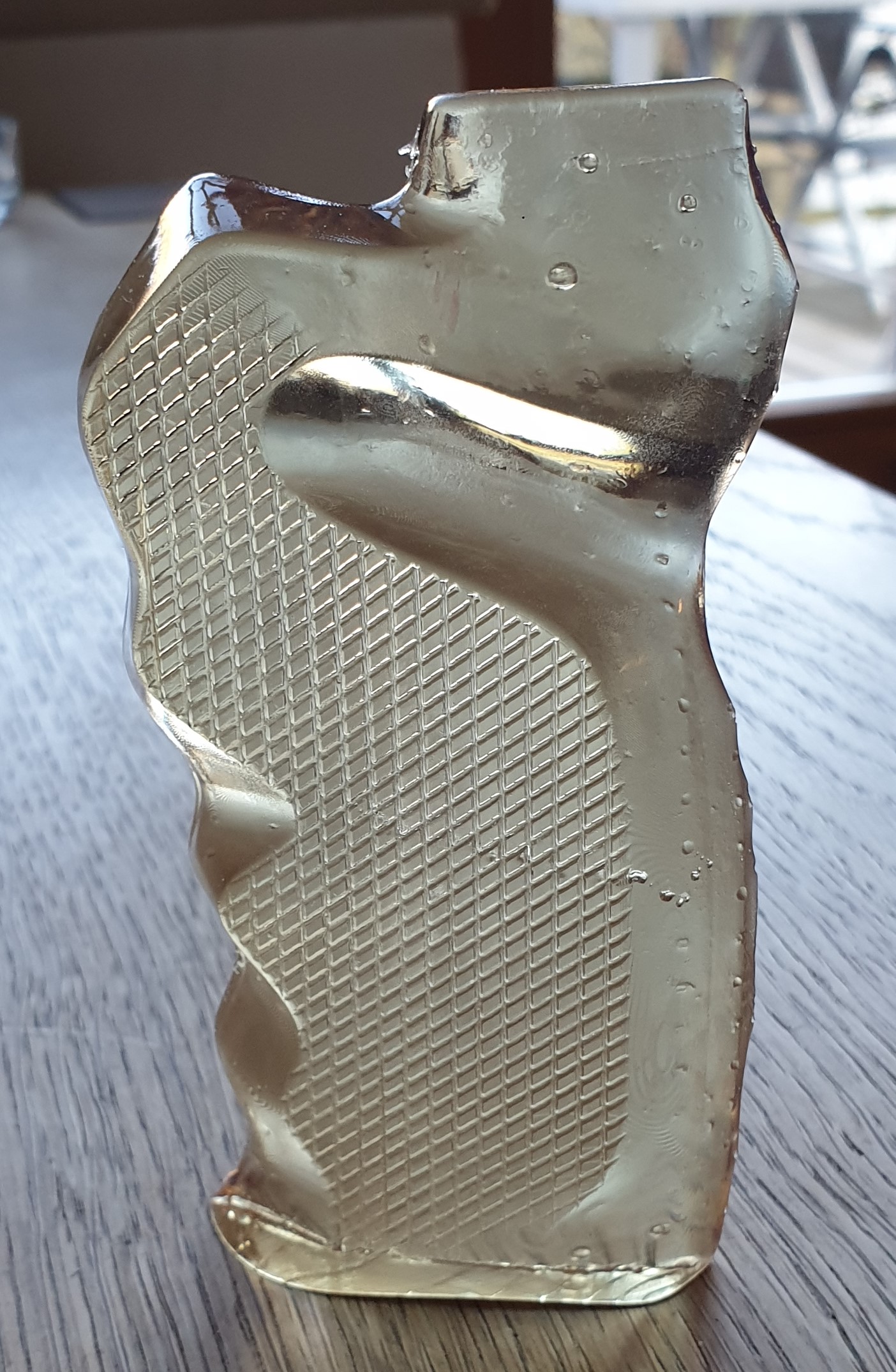

A sign of life after a few weeks silence. Got my resin printer and played with different settings to properly print the grip as it is the heaviest and the only transparent part. The first image is how it came out of the printer, the second is after dipping it in clear resin. The bubbles are my fault as I dropped the part when taking it out of the resin vat :D
Will now continue with the covers and the greeblies.

Rear side still needs to be ground and polished to remove the marks from the supports, but other than that I call it ok for glueing together the first prototype during the Easter break.

Great work. What did you add to color the resin? Also, a pic of your render has made it to one of my HDR50 Facebook groups, so you may soon have a LOT more people hounding you for this. Would you like me to share with them the proper link? Or keep it a secret until you are finished and ready to sell/share?
W1nn13
The resin was colored with cheap alcohol based translucent resin dyes from a set I bought at Amazon for 15 Euros or so. A mix of "tangerine", "coffee" and "black currant" :)
