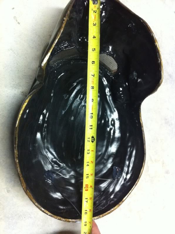

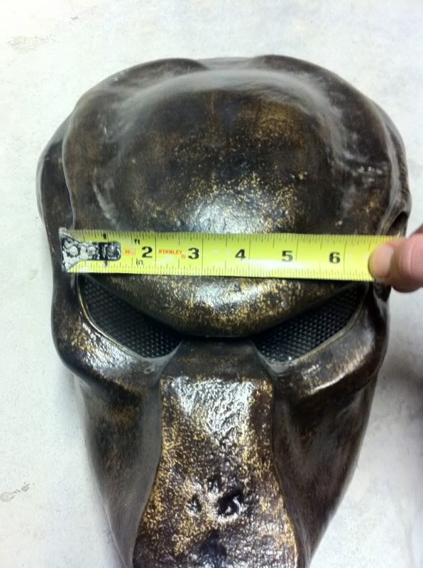

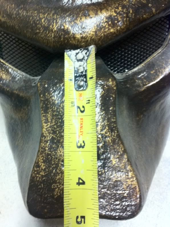

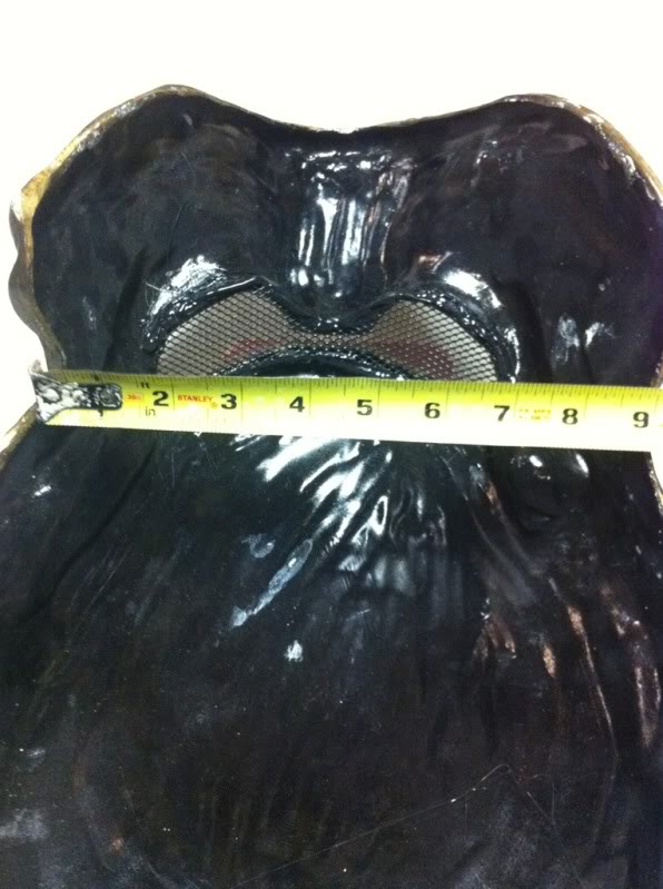

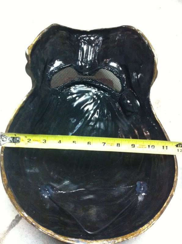

Gene,
Thankyou VERY much for taking the time to meassure the bio. Here is my issue with what you guys are saying about the size of the bio, and apparent dimensions of the head.
The bio is 12 inches wide x 20 ish inches long, and 7 inches at the eye width.
YET my P2 open mouth is approx 11.5 inches wide x 21 inches long and 7 inches at the eye width.
IF i make the closed mouth 12 inches wide x 20 inches long, his face will look squashed, the several pictures i have seen of the hero head , make the forehead look long and i am pretty sure with KPH being 7'2 ( probably closer to 8ft when suited up ) the photos we have seen of him, make the head and bio ALOT LOT bigger.

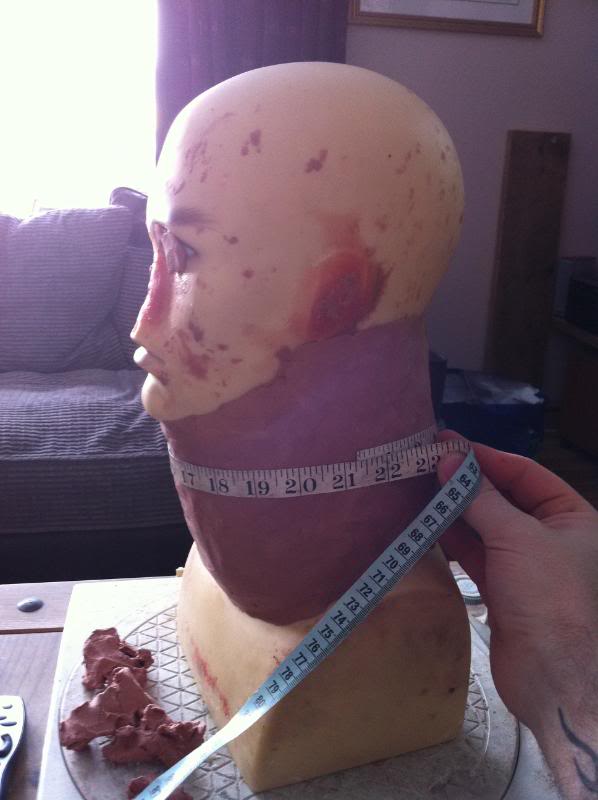

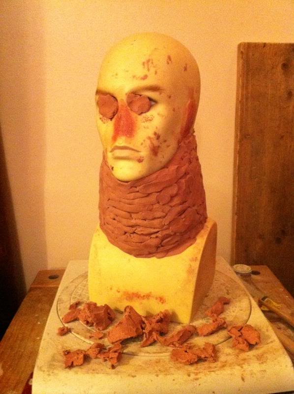

I decided this time to start with the neck when blocking out, ( i usually start at the top and work down ) i have done this for a couple of reasons.
1, It gives a idea of the size the sculpt will be. ( for anyone interested )
2, I normally make the neck too thin to start and have to go back and thicken everything up after, so i am thinking ahead for a change.
1st pic, i just grabbed some biggish flat chunks of clay and laid them around the neck, then i get hand fulls of the smaller chunks and work them into holding it all together, you can see the kind of chunks i mean in the 1st picture.
the neck is fleshed out to just over 20 inches around.
then i took the rest of the lumps of clay you see above, and filled the bigger gaps, then smoothing the neck so it is FAIRLY smooth, i am not too botherd as the neck will be amended and have alittle shape put into it at a later date, you can see from the photo the neck now measures 21.25 inches around, this will be reduced with shaping and detailing later.
also you can see i added more clay at the sides and front of the neck, this is because my last P2 sculpt was VERY rear heavy, and it nearly toppled over a couple of times, so i am trying to keep it balanced alittle.
oh and i put clay on the eyes, as it weirds me out when i look up and hes staring back at me.

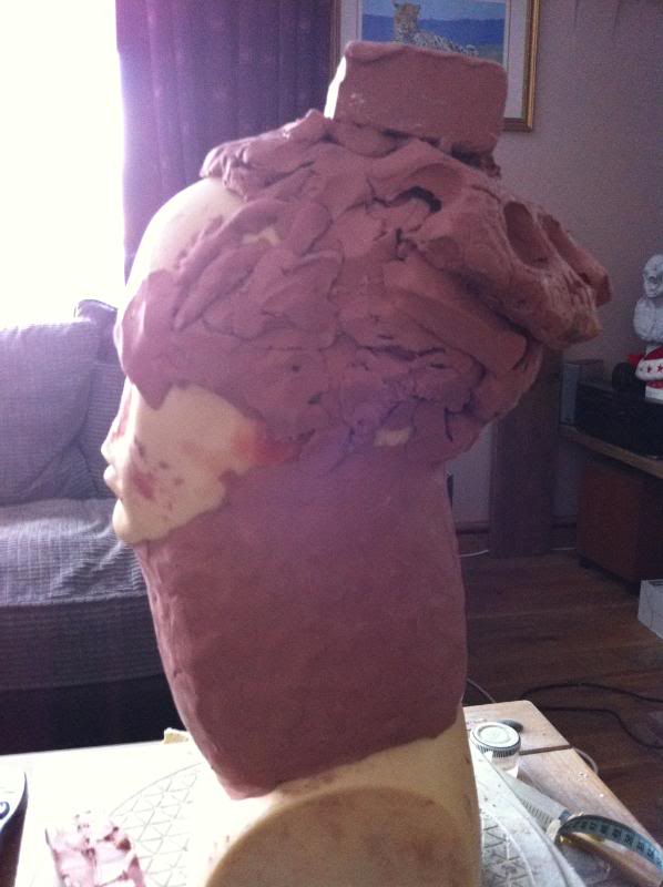

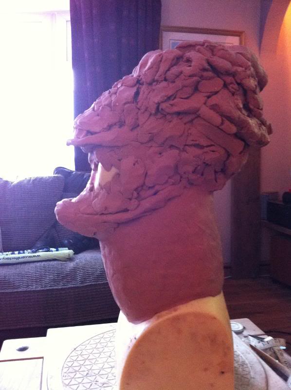

Here is where i am upto, just throwing big lumps of clay on the armature for now, as you can see it looks reeeeeeeeeeally ******. hopefully that will improve as i go. ( theres even 3/4 of 1 of the whole 2lb blocks just plonked there )
I am done for the day now, as the bloody dishwasher just decided to spring a leak, so i guess thats my afternoon taken up now
hopefully get some more done tomorrow but i cant promise anything. oh and so far this is ALL done with fingers, no solvents or heat was used to soften the clay or smooth it.
And photos are all taken with iphone, i will start using a better camera when i get something that remotely looks like a pred.

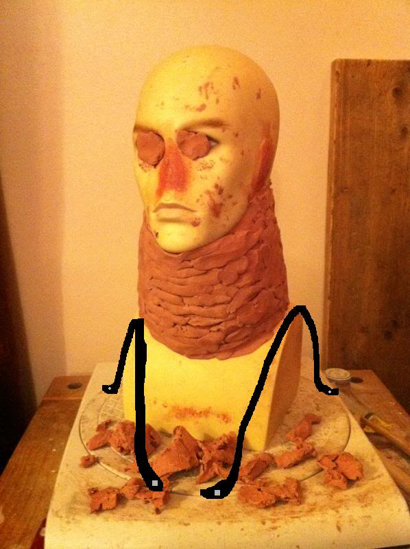

Do this to your sculpt and it will never fall or tip.
I did this to my current head sculpt. Works real nice. I used some old straps from a Suit case with some screws and washers.
