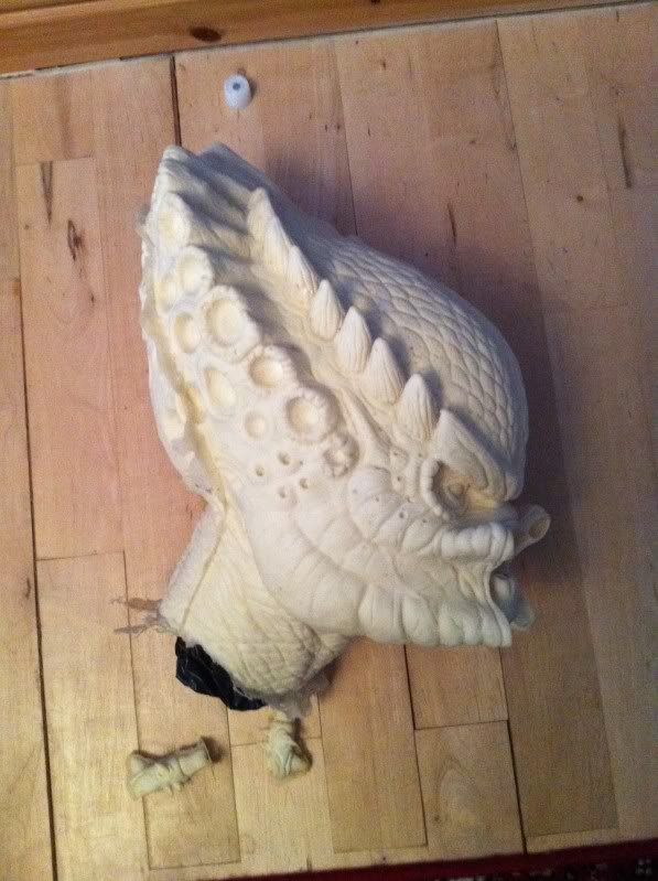

Lee the mask looks great. Despite the fact it did not turn out the way you wanted it to. This silicone stuff is just too cool! Its got me so excited to experiment.
Of course mistakes teach us valuable lessons, glad you posted it here for people to remember. Mechanical lock is a bitch. I am guessing the white colored silicone lends itself well to being painted a flesh tone?

Yeah i am not really botherd about it at all Gene, as i said i may not even get time to paint this anyway, which kinda begs the question, 'why go to the trouble ' lol.
As for dreads i would have done the same as the P1, just cut out the silicone skin in the dread hole, then superglue the dread to the foam underneath, those suckers on my p1 are not coming off easy.

the latex has already been poured, but i am keeping the 1st latex pull , which i may make a resin mould off in the future.

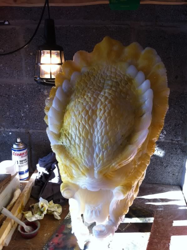

Just did alittle white and yellow test. just to see how the coverage and colours were.

Silicone masks, needs silicone based paints, no prosaide or inks will work sadly.
all the base was done with a old stubby brush, and me stippling it on, then alittle finger spreading around lol. i was like a kid in preschool.
Looks like the paint covered that black foam no problem! That's awesome.
You said you're doing your own paints with caulking and thinner, right? What are you using as a thinner? I've used toluene before to thin caulking for a mold, but wasn't very happy with it. Not to mention it's nasty **** to play around with!
And Acrylic paint mixed in?
no i have a product for thinning here from mouldlife , it was recommended to me when i used the FUSEFX on my p1, its called " SUPER CITRI SCENT 11 " ( i think )
I am using thinned gel00 with silcpig pigments, they are NOWHERE near as good as FUSEFX, but the trial pack colours were the price of 1 FUSEFX colour , so will suffice for the p2.
