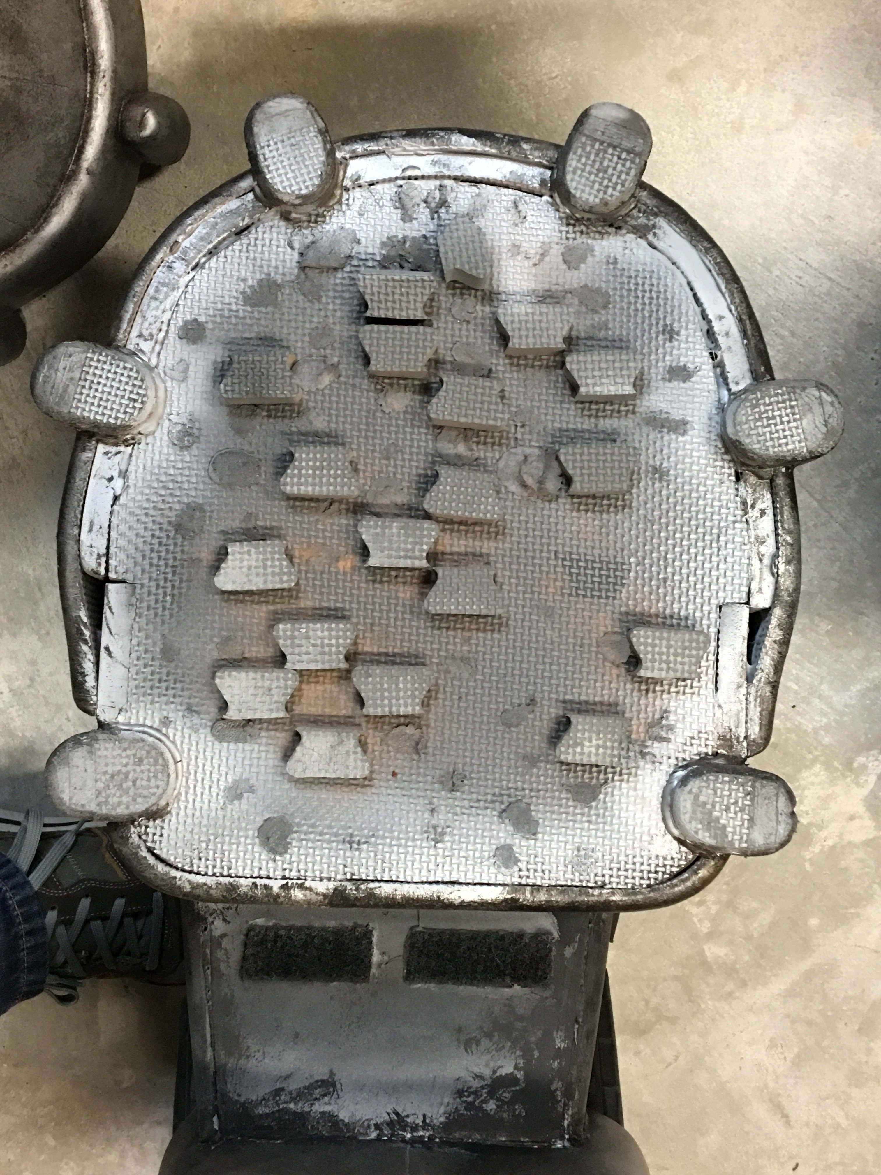

As you will see in the below picture my toes sheared off at the hinge.
The wood was not as thick here as the foot rest but it was not super thin either. I also did not feel that this was going to be the weak point. As long as my strides were straight up, step, land then there should have been no real stress on the toes.
Anyway, i suited up in the carpark and even though it was close, 800m, my toes were gone before i hit the con.
I think because the carpark was rough and grabby on the eva on my soles that it just gripped too much causing extra stress and they just popped off.
So, i assume you were clever and suited up at the con and not risk rough surfaces. A smooth con floor wouldnt have ripped my toes off i dont think. Or, did you use something different on your soles than eva?
When i repair i will use thicker wood, more hinges and then finally not suit up till i hit the con floor. Despite the win the whole day was a learning experience including falling down the stairs at the end. Id practised stairs but the stage stairs were even smaller. I managed an entire staircase up and down at home lol.

Yikes that doesn't look good... Hope you didn't get hurt! Just looking at the photos am I right that you used MDF? Sounds like you're on the right track for fixing the problem tho. Definitely go thicker, more hinges or at least a wider one, and stay away from MDF wood when it comes to structural pieces. It works well for solid shapes like speaker boxes but doesn't hold up when it's subjected to constant movement. Stick to plywood or hard woods.
I built mine with 3/4" plywood and used a "piano" hinge that spanned the entire width of the foot. I padded the bottom with one layer of foam then added a bunch of the puzzle piece edges to the bottom to soften the step and maybe increase traction. I stumbled a bit on the ramp up to the stage, but I couldn't even dream of taking stairs so you're already one-up on me there! My big downfall was all the layers of foam I added around the toe which pretty much rendered the hinged section useless and pretty much solid. There's no flex left at all so it's very stiff to walk around in.

Thanks so much for the detailed reply. Yeah, it was a mdf style of wood so i thijk replacing that and using that hinge plus 2 gate style hinges either side should solve it. I wasnt able to find piano hinges the right size and i was worried cutting them to size would wreck them. I think ill use ply, steel strapping on the edge ang gate hinges. Having the toe move was great.

Cheers. Ive been to the hardware and got all the required items for feet v2. To be honest the feet, shins and knees were my first parts and there was always a lot that i felt i could design better. So this Is just perfect to com be back and do them properly. For example the second id finished the feet i thought that it would have been so easy to make that ankle disc turn with the ankle movement even though theyre not connected. So serendipity

Design is an iterative process, the second time around is pretty much always better. I personally enjoy refining costumes and props more then the initial creation, as there is usually something that obviously needs fixing after the first full day wear. After some post-con TLC, armor costumes are so much easier to wear a second time, especially with large builds like yours. Luckily with a weathering job as heavy as yours, an untrained eye won't even be able to tell what's intentional and what's just wear from use, so you should get a bit more life out of it then other foam costumes.
I'd recommend looking into HDPE sheet plastic (which is what kitchen cutting boards are made from) for the feet as it's cheap, light, waterproof, and very stable. A 1/2" thick sheet would be suitable, and will keep the weight down a lot compared to plywood. Just my two cents.
Cheers man, thanks for the link too..that is awesome. I've got the ply already but wood can be used for any future project. I'll check some HDPE near me, nice solution. In fact a couple of cheap cutting boards may even do the trick :)
