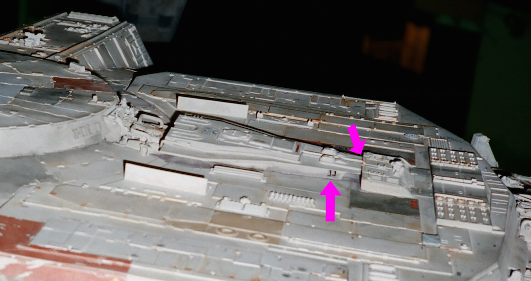

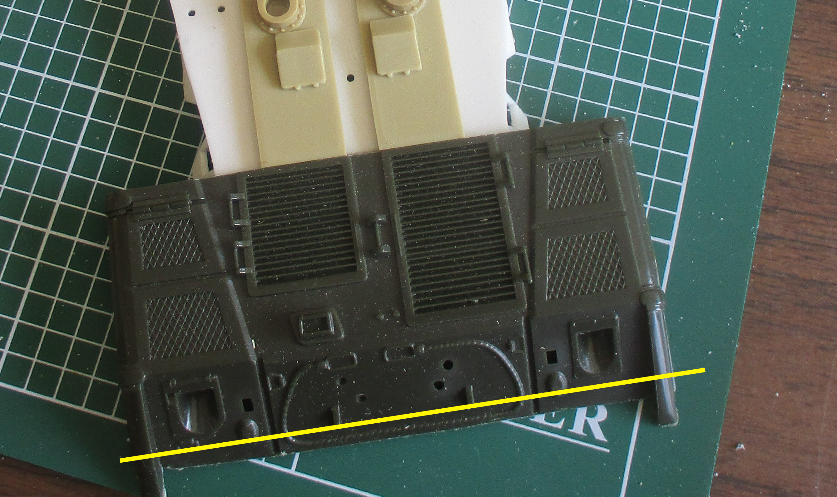

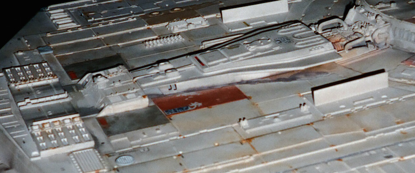

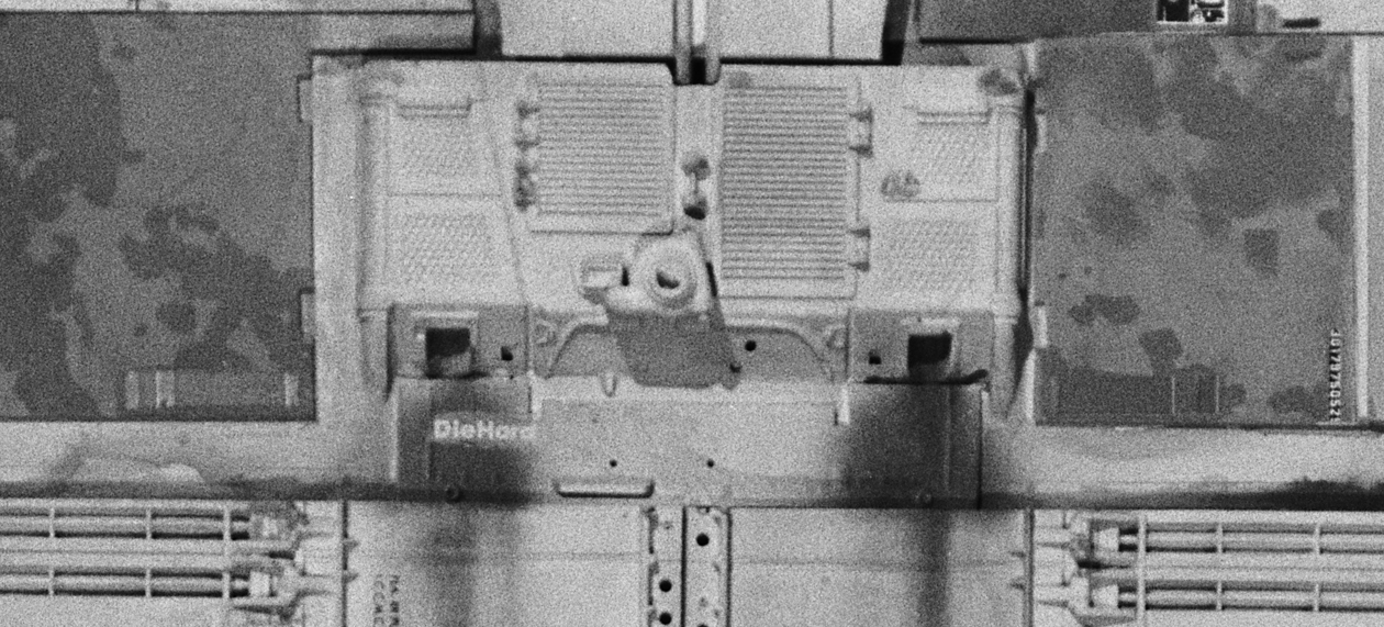

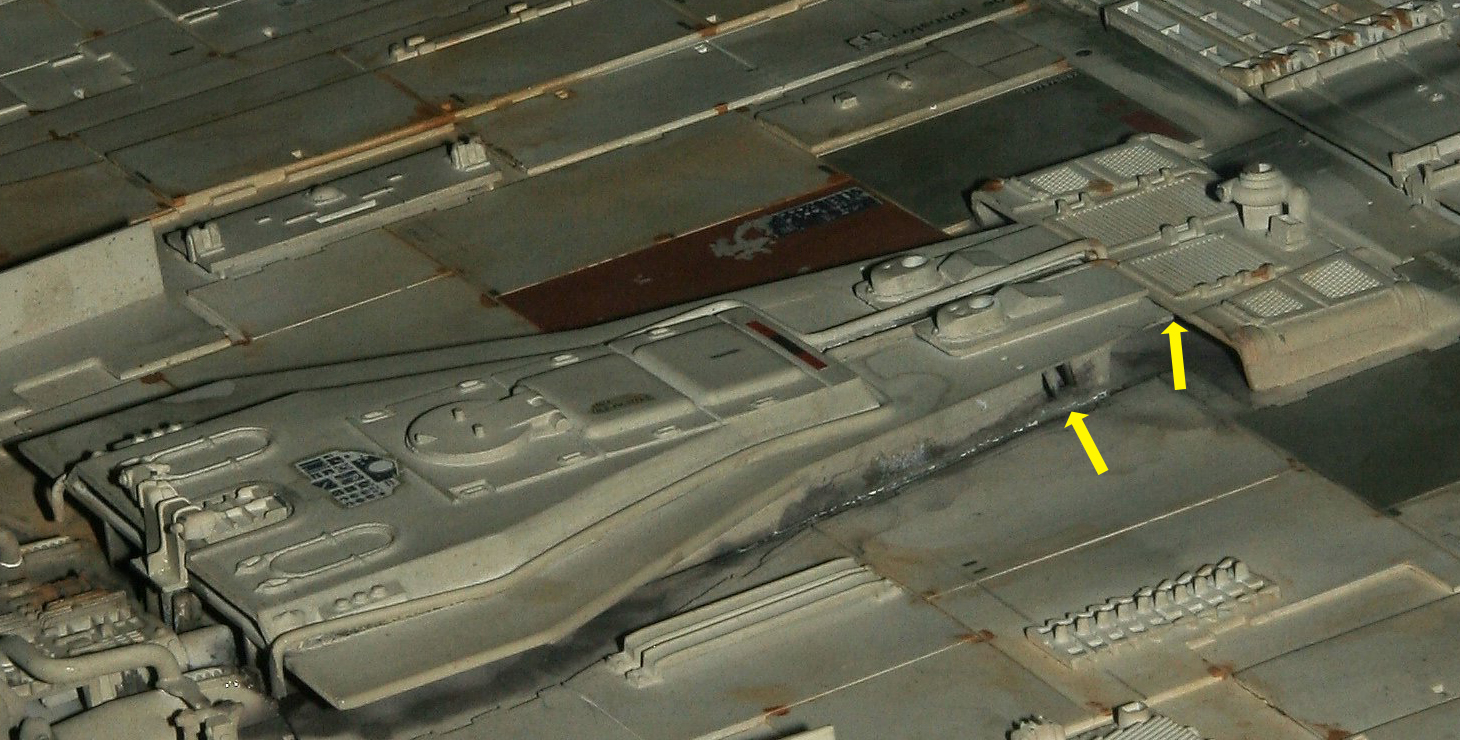

SK - Yes, you are pretty spot on - the problem I see you are having is your Sheridan is also cut too high.
The arrows give you a good indication in relation to those 2 hole 'openings', and the relationship of height of the Yardley to Sheridan.
You should cut your Sheridan at the yellow line.
These should explain it all....
The Black and white you can see where the Tiger 1 part bumps up to the Sheridan, that part is not too thick, but you get a good idea of where the Sheridan gets cut.
