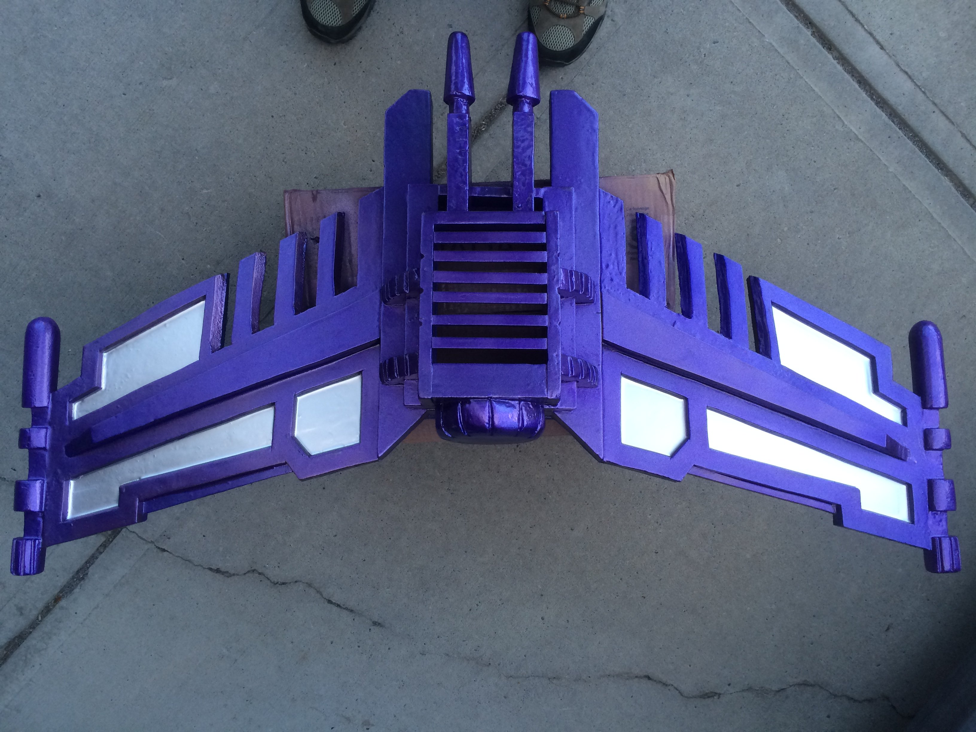

How about I start with a progress shot? =) Here's the chest wing upgraded awaiting painting: http://i1276.photobucket.com/albums...4-7FD5-42F5-9CEF-ECF1E0840986_zps26y0cxs1.jpg. Will be spray-painted purple metallic. The 3 enclosed shapes per side will be painted chrome silver, and hopefully I can hand-paint some original sticker detail in acrylic.

I will add more detail to the forearms to match the toy, which will bulk up some and closer to the joint.
For the width of the body, I'll add as much as an inch to each side with add-on side detail panels. I don't want to add more than that though, as it could make things bump when my arms are down.
