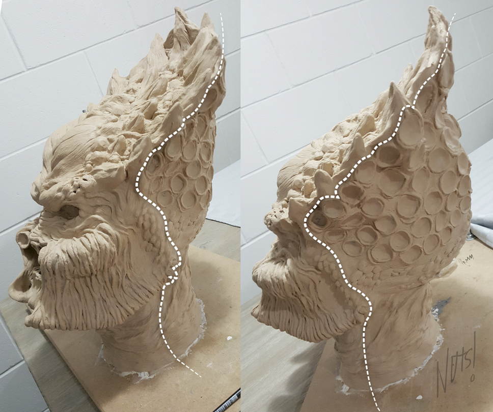

Below is an image of how I'll make the 2 parts of the cast..
Because of the intricacy of the crown that I felt it should be divied up this way, with the shims running along that line.. I'll be using shims alone and no clay wall, because 1) The prima Plastilina I used isn't as hard as the Chavant, I will most likely deform the clay. It's soft..way softer than Chavant soft. Like if I drop a small coin on that forehead from a distance of a feet, that coin will make a deep mark. 2) it's friggin soft. In hindsight, should have used Chavant med all the way, but, I used that money to, umm, feed the kids?
If anyone has a better idea, or can guide me through this process, please, please let me know..do you think 3 parts are better? Seprating the crown, whole face and then the back of the head and neck?

Ahahahahahaaaaa you have now reached the dread stage I have reached when I finished Behemoths head in January!
But yes that would be the best way of separating the mold. As far as I understand predator head molds are usually two piece mold like that.

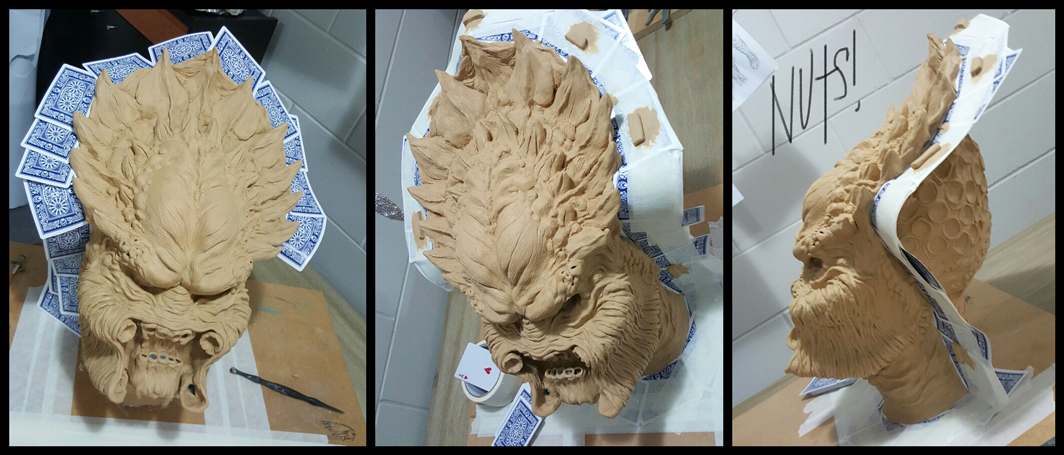

First off, the card wall...pretty much followed the line I planned earlier..

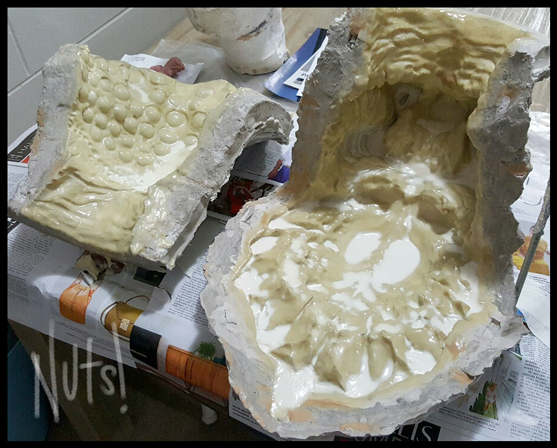

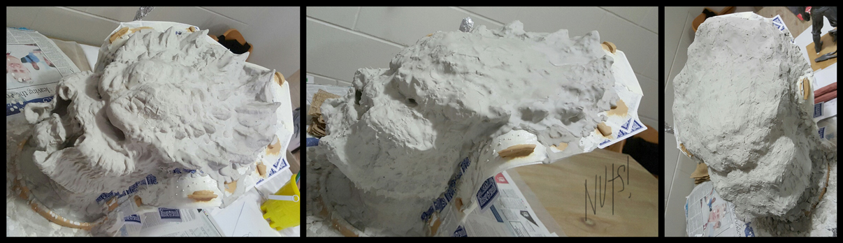

One of the scariest things I had to ever do so far with this project..putting on the 1st coat of ultracal...success or not, pretty much bye bye to the sculpt..at 5 coats, 10 coats and 14 coats..What?! 14 coats?! Let me explain..the way I did it was after the 1st beauty coat, every time I refilled to mix ultracal, that was pretty much a coat. it's always a cup and half of ultracal every coat. With each 'refill' I try to cover almost everything..but using a drip-brush method. I know, pretty noob-y..First time working with ultracal, before this was only using run-of-the-mill plaster. ;P Anyway, the last pic above, was basically content with the overall structure and stopped there and let it dry.

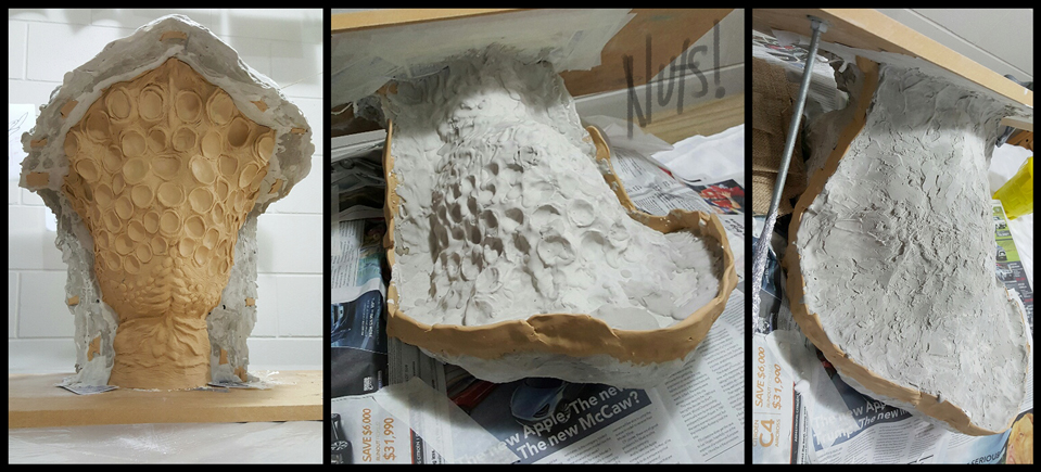

Took out the cards! Looks like crap, but happy so far..think it will work alright :p Now for the back!!! Did better with the coats this time, 2nd pic above with only 2 coats, and in the end, did only 10 coats with the back, LOL! Now for the wait...will the mould come out good? or Broken? ;D
Cheers for the support Nic :D But hope I can be forgiven, Have been taking photos and just posting now..

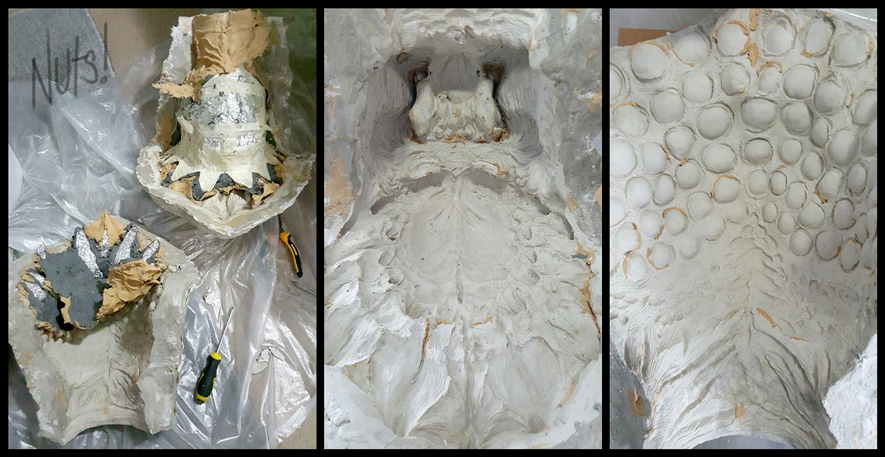

After what seemed like an eternity, trying to pry the 2 halves apart (was really scared I didn't put enough coats and would end up breaking the front half).. Success!!! Buh-bye sculpt, as expected.. :(
Now for the clean up!

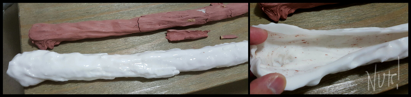

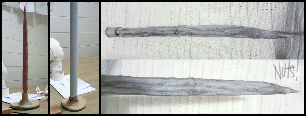

So..while I was waiting for the layers of latex (esp. the pooled) couldn't sit still, so started casting the dreads...it was literally my first foray into Silicone, and with only knowledge from the internet/videos and tips I got from SPGFX..dove into it and came out with this:
outside really looks like crap, but it's the inside what counts! LOL..
Funny story..see that crack in the first pic? There was another like that further down and those cracks happened mid cast. There was actually already silicone over those parts. I had the dread standing straight on it's base, with a BBQ stick, about 10 inches long through it to help support the weight...Thing is, the base where the bbq stick was also skewered through wasn't deep enough. As I was pouring the silicone (started from the tip and let it drip down), didn't factor in the silicone becoming heavy at the top, and that just brought whole thing down. Mid cast. **** me. Our house is small, and where I was working, at the edge of the dining table, I had paper/plastic to cover the table, but not the carpet below that. Didn't really think I would need to, until I was seeing this sculpted dread, all covered in wet Silicone, heading for the carpeted floor, in slo-mo. Wife is gonna kill me. little bits of my life flashed before my eyes...Instinct kicked in and I grabbed it. The force of it cracked it in 2 places as I struggled to get it back upright again whilst trying to catch bits of silicone glop touching the floor. Anyone that's worked with silicone prolly knows how uncomfortable it is to the naked touch. (Sorry, didn't have gloves >.< again, didn't think that would happen.) I'm not just gonna give up and chuck all that hardwork because of 1 single mistake. I was going to try and salvage what I can of the situation, my hands were all covered in goop anyway. So I stood there, holding the damn thing for about an hour and a half, waiting for the silicone to dry enough that I can place it somewhere without the goop transferring to anything else, and peeled of the silicone off my hands. Yep, silicone dried on my hands..(this was already 3am, mind you, and my mind wasn't really working 100%)
Anyway, wrapping up, 'dripped' a 2nd coat on it and that's what you see above.

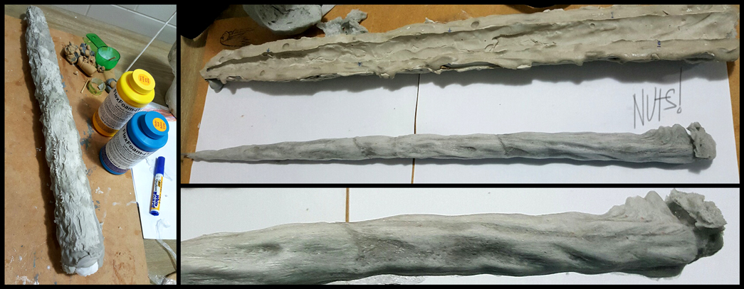

Drying pooled latex is really long...so I moulded the shortest/smallest dreads..

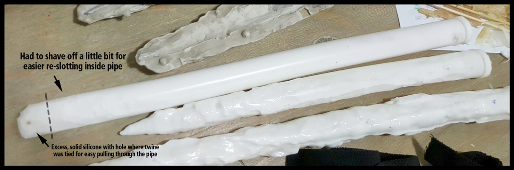

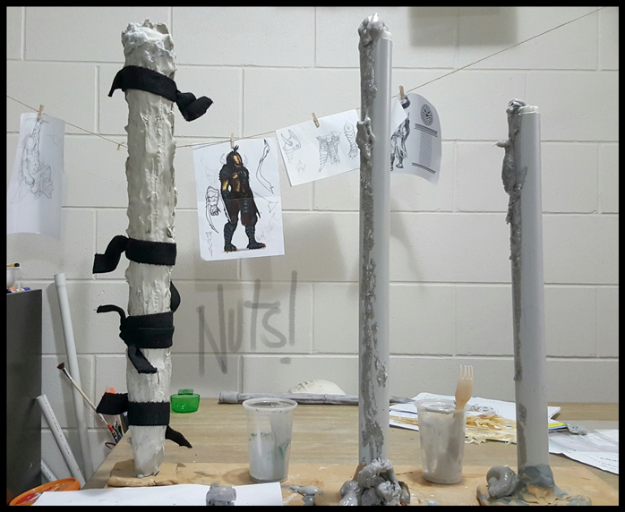

But this time, I had the idea, what if I used a PVC pipe wider in diameter, put the dread in the middle and pour silicone into it? (I honestly didn't know some peeps did this before Wreav told me). I hate making ultracal for backing. And when you're putting the silicone mould back into the ultracal backing, it has to be precise too..etc..there must be an alternative..So I tried it.
And it worked great!!! :D no extra process of ultracal backing, no strapping the 2 halves tight, etc..light as..definitely gonna do it again for the 3rd dread!!!
The only hard thing about it was pulling the silicone mould the first time out of the tube since it's perfectly the same diameter as the tube itself, and suction, etc... Once that's done, the other hurdle was trying to put the empty silicone mould back. Found a way..not sure if you're able to or it helps wiping vaseline on the inner part of the pipe, but what did it for me was Cling Wrap. Just wrap it with 1 layer of cling wrap (this seals the seams too!!!) and put it back. Haven't tried putting cling wrap on the inside of the tube before pouring silicone, but def works when putting it back. If you're still having a hard time, if you have some excess at the most bottom part of the sil mould, tie the end and 'pull' the whole mould through the other end. With the cling wrap, it should pull easily!!!
Just wanted to show the 3 silicone moulds, where the 3rd one was a culmination of what I've learned as it went along ;P
