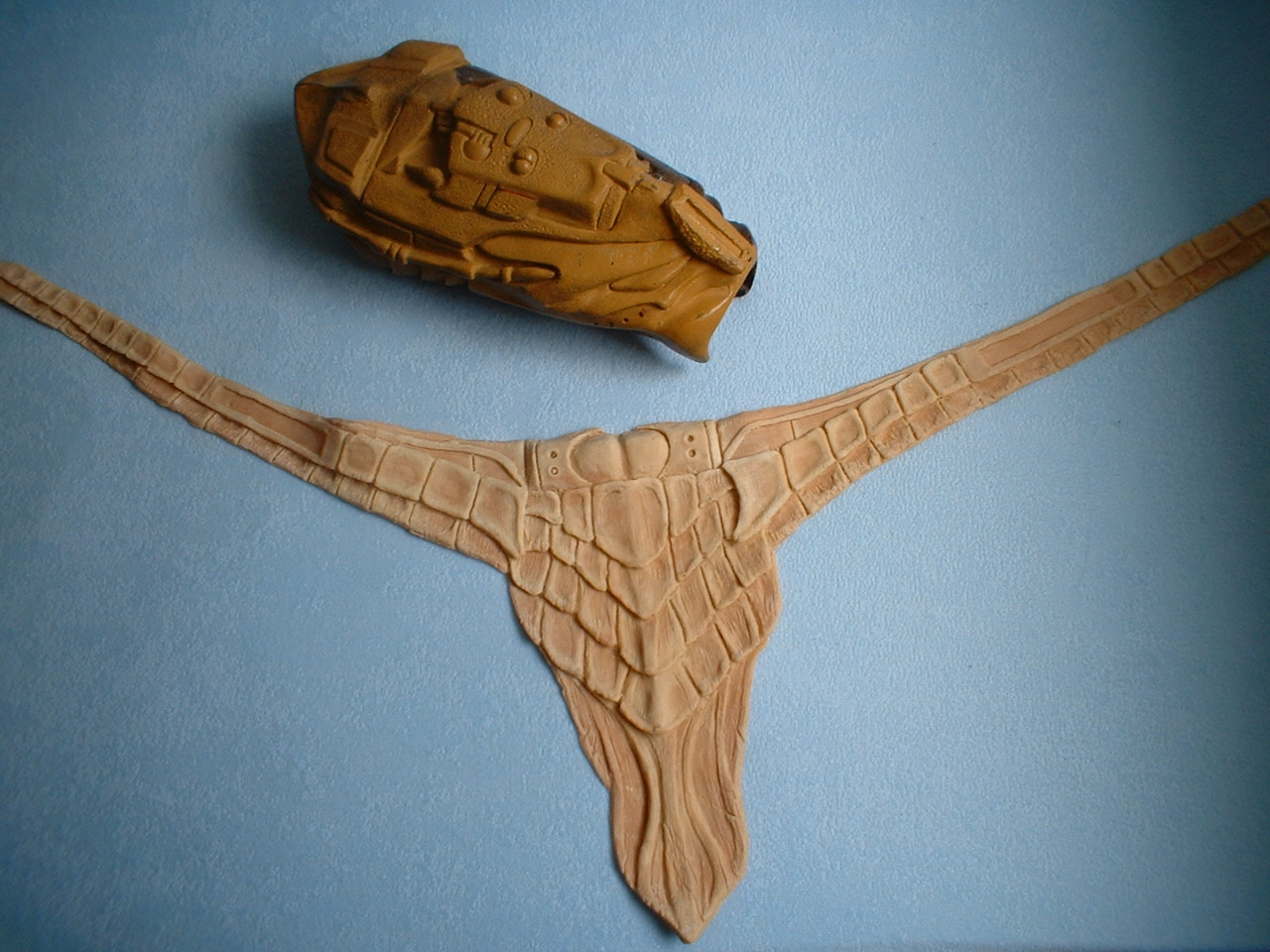

I Love it dom, always have! But, for my one, I'm going for the single row down in the middle, like my concept art..I wasn't able to include it there, but I wanted it to have tassles at the end, for both front and back flaps, pretty much like Dachande's one below :)
Ha, I have the same image saved in my references folder! :D And I was looking at it just the other day and getting ideas :D Love the berserk/falconer loin cloth, most likely my one will be combination of that plus an outer row of amor going down..

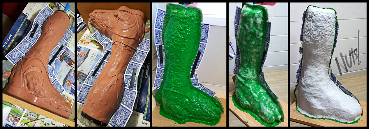

This was around the 2nd week of June, after reviewing the steps posted by alphatech on how he did his most awesome feet and gathering all the materials, I took a dive in, left feet first ;P 1st and 2nd pic shows the feet all 'lathered' up in PVA before I put on the 'SMELLY'. Couldn't get me Epoxacoat Red from my supplier here as they ran out (and much more expensive) but he recommended this stuff. Polyurethane Tooling Gel. Similar to the epoxacoat in terms of consistency and all that, but **** me, it stank to high hell. Disclaimer: I'm a complete noob, and most if not all of these materials, I'm working with for the first time, so I did a 1st coat, inside the house, with windows closed. What an idiot, right??!?! In my defense, it was 1am, and it's winter here(2 degrees celsius outside) and I don't have a garage. Yep. I didn't think it would stink that bad, and I did open the windows when I did realise, but it was too late, the smell woke my wife up and world war 3 ensued.
Well, more like the Blitzkrieg. 4th pic is one side with the fibreglass/resin layer after 3 layers of the stink (yep, had to stink up the place 3 times, but don’t worry, after the 1st one, I learned to do it all outside, and during day time.) After 3 layers of resin, I put about atleast 2-3mm thick freeform air putty just to strengthen the mould. Let it cure for 24hours, then put the last 2-3 layers of resin and you’re done! Now, repeat 3 more times for all side, both feet. >.<

  1. SSSSSSLLLOOOOWWWW as working time – You need to wait for each layer to dry properly before putting on the next. The tool get that I got, on normal conditions at about 20-25 degrees(celsius!), dries to the touch in 5-6 hours…if that’s all you did, sure, you could finish all 3 coats (suggested minimum) in a day, but realistically, 2 days. Then you put on the resin, about 2-3 layers. Which is about another full day. Then you put on the freeform air putty, which requires 24 hours to cure, so that’s another day gone. And lastly, 2-3 layers again of resin, another day! That’s a total of about 5-6 days, one side! If you didn’t have work, and that’s all you did, you could probably do it, what, 3 days? And a mould has 2 sides. Fun.
  2. The smell, holy heck…
For the strength and how it grabs the detail of the sculpt, I rate them equally, with the PTG probably more susceptible to cracks on the edges. But then again it could be I didn’t reinforce it enough, but in saying so, if your Ultracal mould gets cracks, there’s almost no way of repairing it, other than pray and and hope it will last you a few more pulls. With the Resin/FBG mould, those cracks are much easier to repair. Have to be careful when putting on your layers after the PTG. If there are air bubbles in between the PTG and the resin, those parts can be brittle as I’ve learned the hard way. Nothing major, but let’s just say I’ve ‘punched’ through the mould a couple of times trying to get clay out. ;P All in all, I'm still glad I went the PTG route, atleast for now.. Cheers all!
