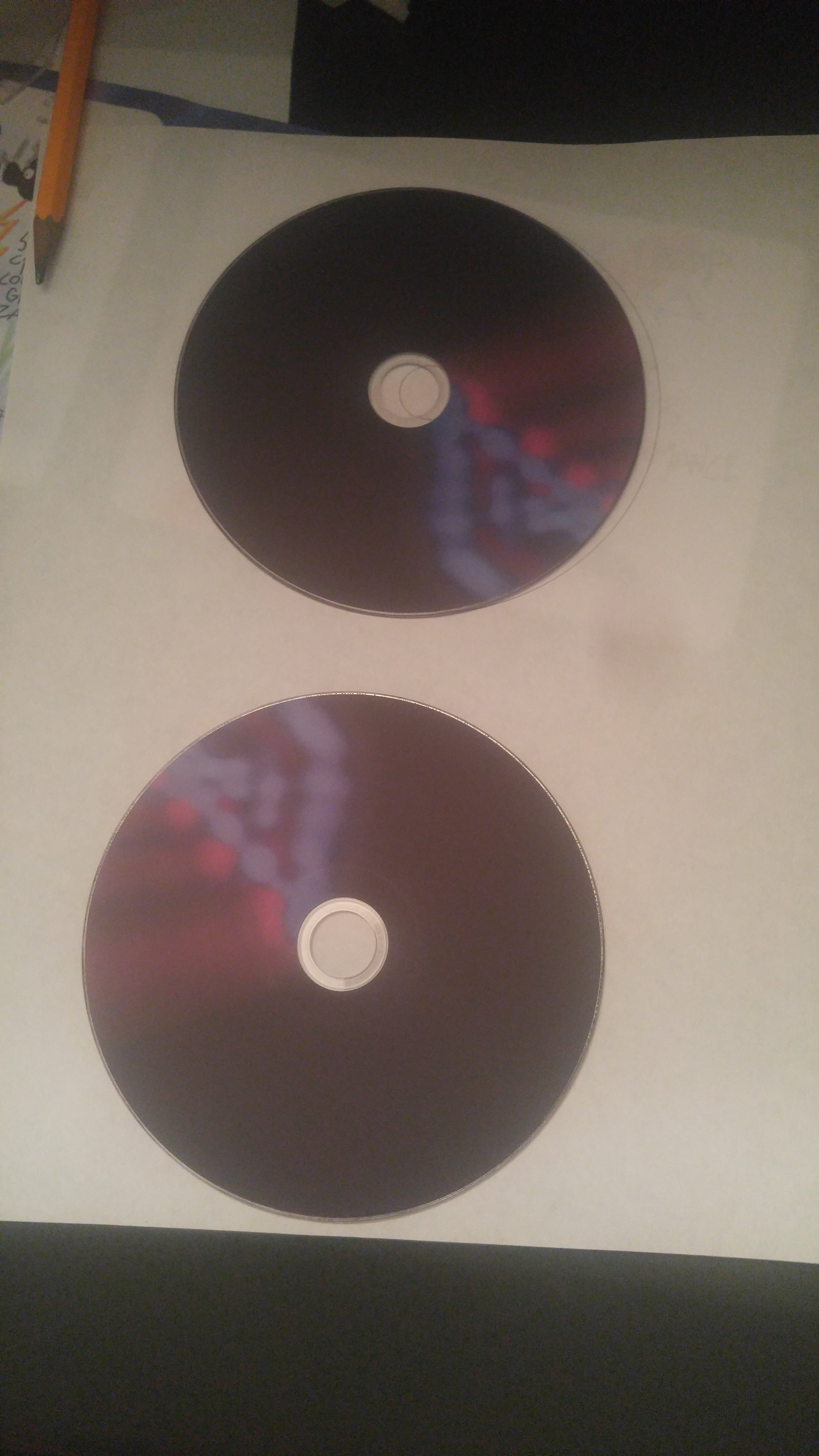

Ta da! cavx your DVD is ready to go!

cavx little bit of a hickup. The ink on the test DVD hasn't dried yet, meaning the slightest touch will smear it. I'm gonna give it a couple of days to see if it dries or not

@cavx little bit of a hickup. The ink on the test DVD hasn't dried yet, meaning the slightest touch will smear it. I'm gonna give it a couple of days to see if it dries or not
All good. When you can.
