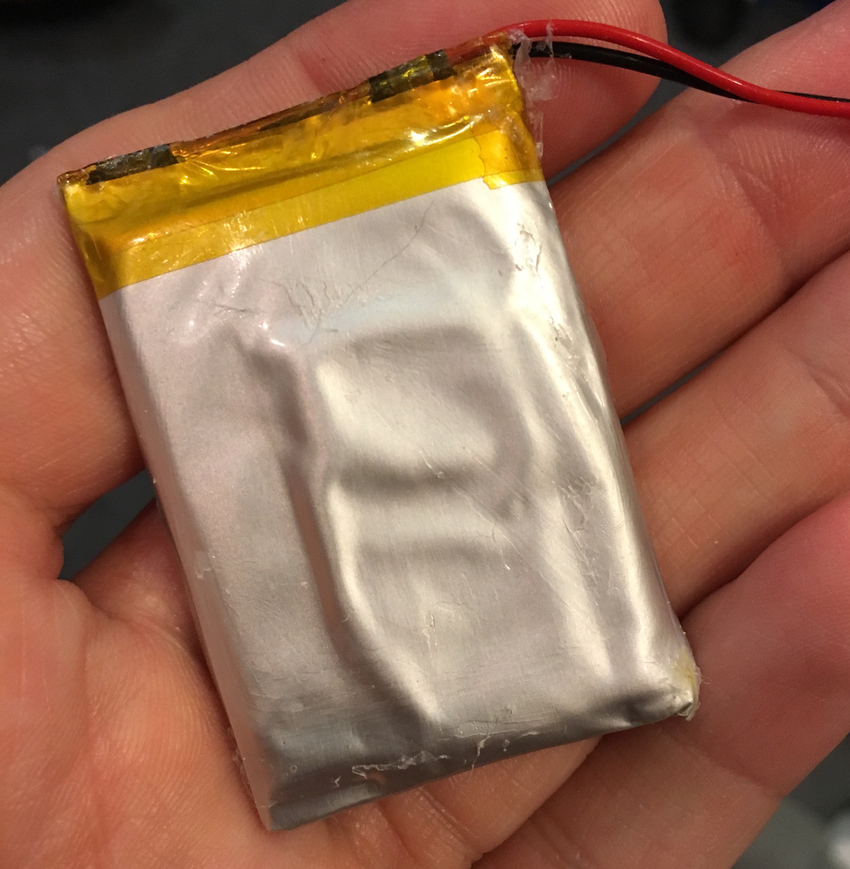

How do I post a video from my phone? I want you guys to see something and give me your opinion? Or would someone be kind enough for me to text you the video and you post it for me? If so then please PM me your number. Thanks. I thought my battery was bad but I'm not so sure now.
I just post it to YouTube as unlisted and post the link

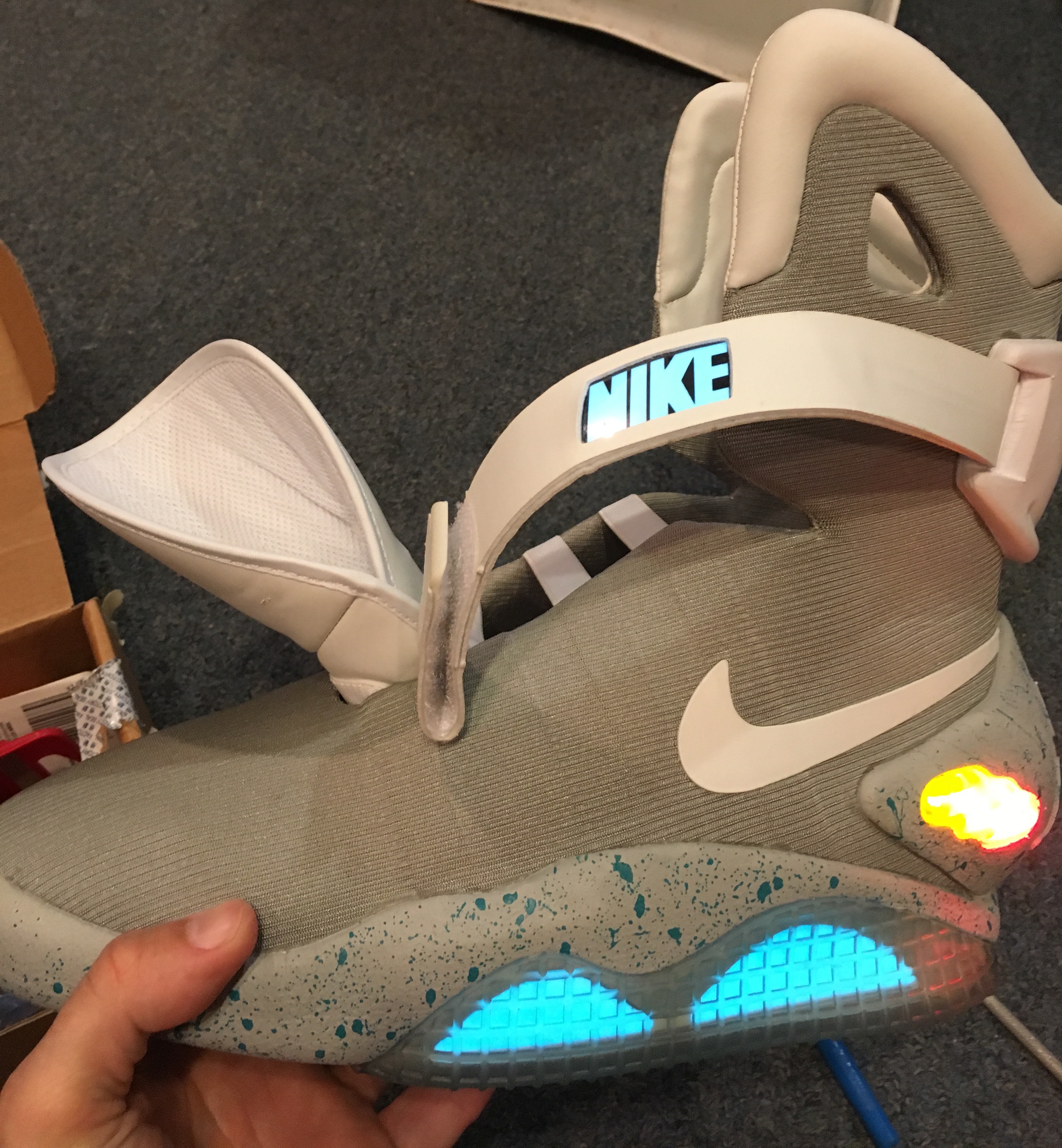

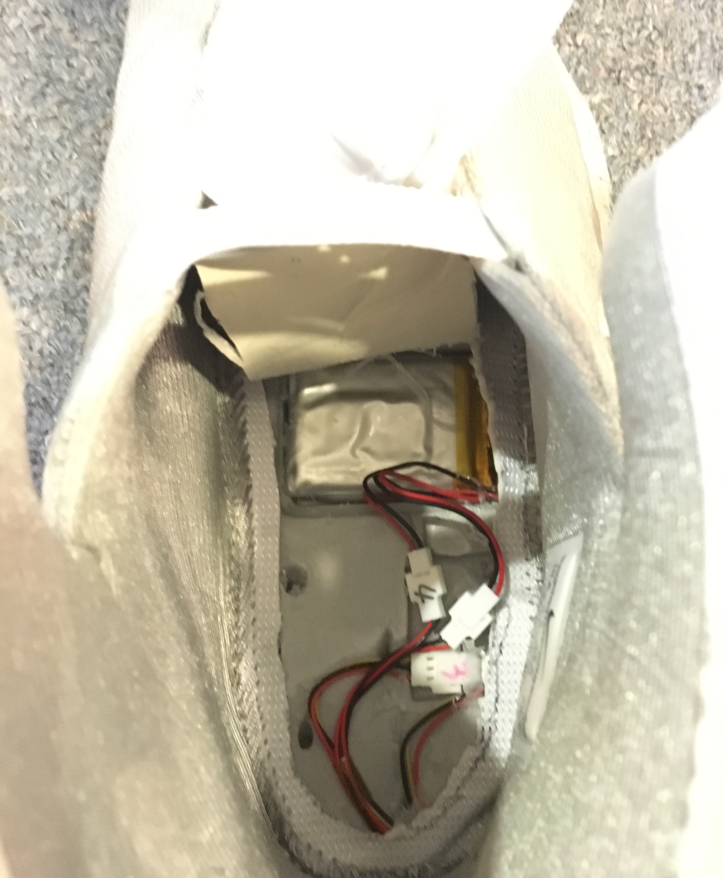

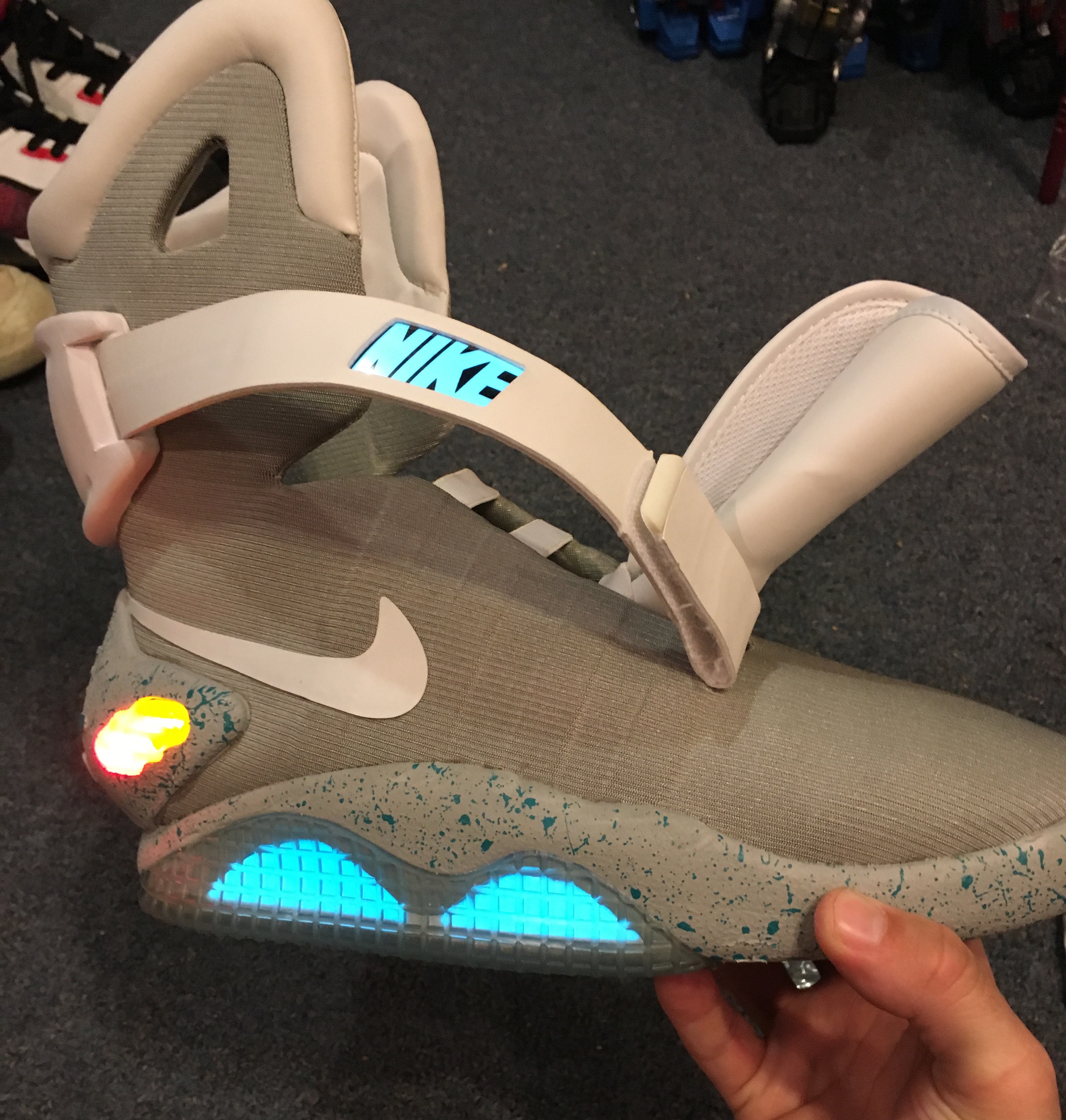

The dreaded flashing EL. This is a short somewhere and because the wires are so thin and run through parts of the shoe, chances of finding it are slim.
In my case, it was the wires where they pass through the mid-sole to the EL that had been worn through to bear copper. One had actually broke and the other was making the strap do what your side panel is doing.

Nowis the most important question, do I wear them again or do I not?
Well done on getting them to work again. You probably can wear them so long as you don't break a wire or EL Panel.
