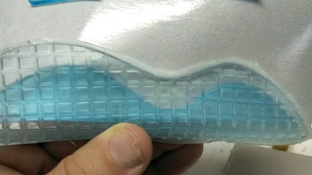

The pair I molded was from a size 10 or 11 I believe...but I modded a size 13 and they fit. So I haven't really felt the need to make anymore sizes. Yea, the stuff I use is "water clear" it's completely clear. I think mold release and mold finish affect the transparency the most. Even humidity can affect clarity.
This stuff is hydroscopic meaning it attracts water which then clouds it. So don't mix and pour on cold or rainy days. Lucky right now, it is dry and hot.

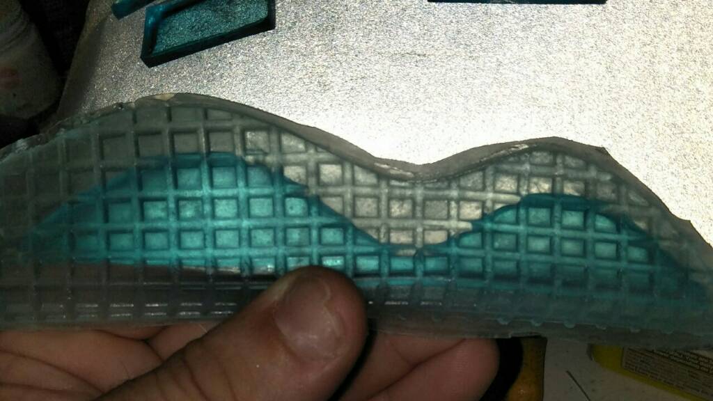

What I intend to do soon is to make a hard cast of each part of the molds and sand the inside parts to at least 400 grit, then make a new silicone mold from that. i ended up polishing the inside half of the molds I made (I used A40 shore silicone and have since found an A60 shore) with a ceramic bit. It took the rough surface where the silicone molded the glue marks off the original parts and gave them a more uniform look.

I did something similar I think, I made my molds from a hard tooling resin. So I polished the window where the EL panel would be behind so it would be crystal clear. The rest I left rough and textured so it would adhere well. I also use a high gloss mold spray mold release which helps the transparency as well.

The silicone I have used does not need a release agent. Parts just pull out. The A40 silicone is hard enough to be self supporting and soft enough to bend enough to release parts, even thin parts like the wings without stretching or tearing.

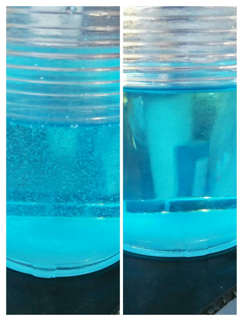

What I have discovered (actually back in V2 days) was that if I mix my batch of rubber, pour some into the mold, tipping it around so it coats the surface of the waffle detail, then degass both the pot and the molds, this will eliminate any air bubbles from occuring during the pour. Even though the rubber is degassed, sometimes it wants to fold over itself due to the surface tension. Spray releases will help here, but I just prefer not to use them if I don't have to. So, if there is already product in place, it just pours like it should because the surface is now coated. Because my molds were also degassed, there is no change of bubble ruptures there either.
