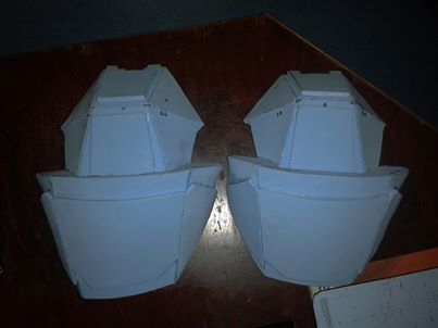

I decided to start my adventure with something that looked simple to do. First lesson, this is far from simple!
I'm pretty sure i'm using the wrong kind of foam, which is effecting how it turns out. I bought some 7mm camping rolls, the same type used for yoga. The reason for this is that it was only £2.50 a roll. If I had gone for the flooring mats that join together in a jigsaw, the same area of foam would of cost me 5 times as much! That said, this stuff is very squishy, and doesnt hold its shape as well as the mats appear to.
I'm going to continue using the mats for now, and maybe redo the armor again with stiffer foam once i've got some practice under my belt.
The next thing i've found is that I hate hot glue with a passion! I'm getting it all over the front of the armour, its squeezing through the joins, ruining my nice straight edges and i seem to get more glue on my fingers than the foam!
Does anyone have some advise for how to clean up the joins once the glue has dried? I've thought about using a dremel to sand the blobbly glue bits, but am worried i'll just make it worse. Worst case scenario, i'll just leave it and disguise it as built up dirt when I come to paint it.
Here's a photo of the finished shoulders. What do you think? I'm quite happy with them as the first thing i've ever built, but they are slightly mis-shapen. I'm hoping this will solve itself once on my body!

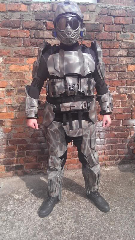

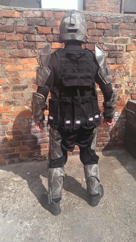

I've hit the home straight now so thought i'd upload the last WIP shots before finishing it off.
The thighs need cutting down a bit, but apart from that everything seems to fit right.
I lost the chin guard off the helmet. I was worried that if a paintball or tree branch etc lifted the helmet, the mask may of gotten caught and lifted up with it. Now its completely free and won't effect the mask, safety first :D
I may add some parts to the back, but I don't want anything getting in the way of the tank pouch or pods, making them hard to get to.
Finally, i'm going to need to paint some scratches and stuff onto it to give it a more used appearance. I'll also be adding some blue patterns and my team logo to it.
