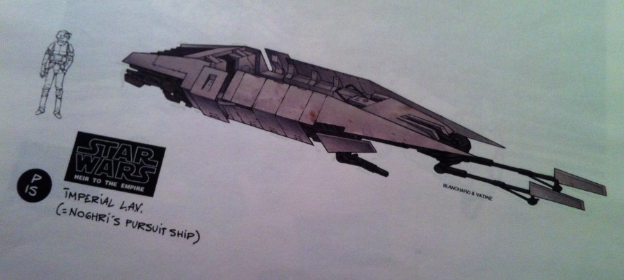

BTW I found another imperial vehicle especially designed for that miniseries in my files this afternoon...
This one was based on a speeder bike...
It was supposed to be larger than a regular bike and able to transport 4 to 6 troopers + the pilot.
The main inspiration for this was the WW2 german SdKfz 2, but adapted to the SW universe...
As you can see it has "arms" on the bow that are close to the ones seen on the Imperial Thuna ship...
Fred
Hey, Fred, that large speeder is definitely on my to-do list... I plan to make it a convenient size for use with 30mm RPG figures...
