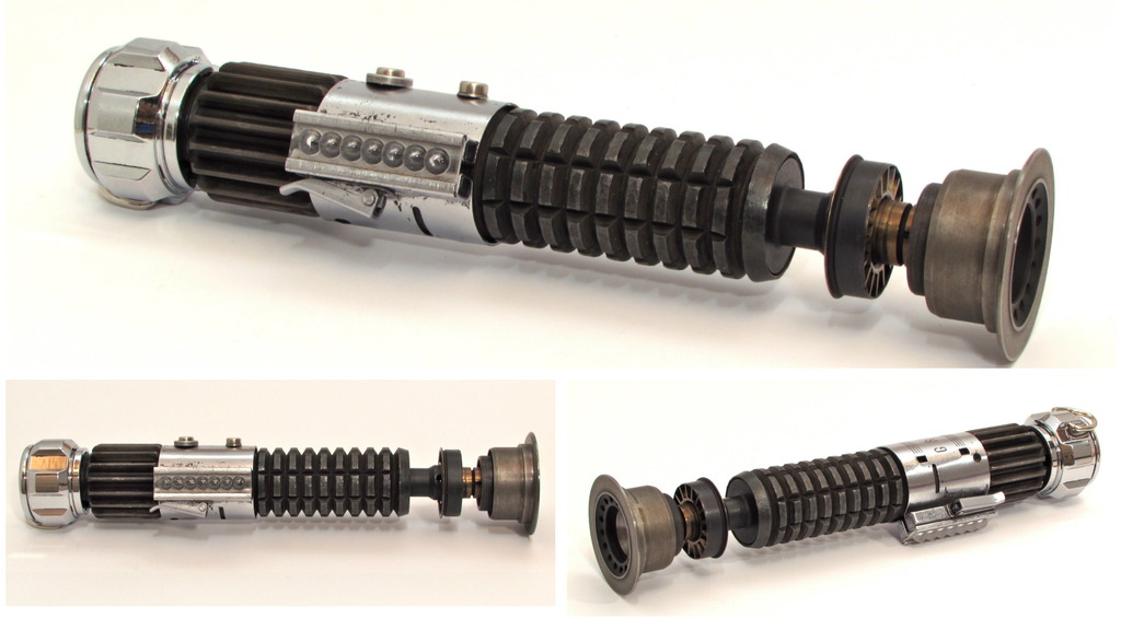

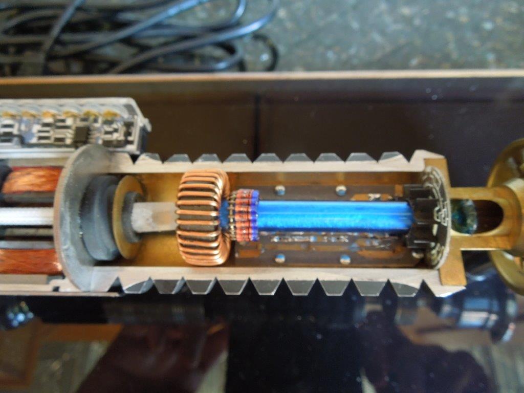

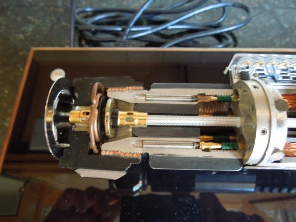

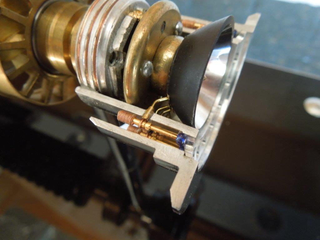

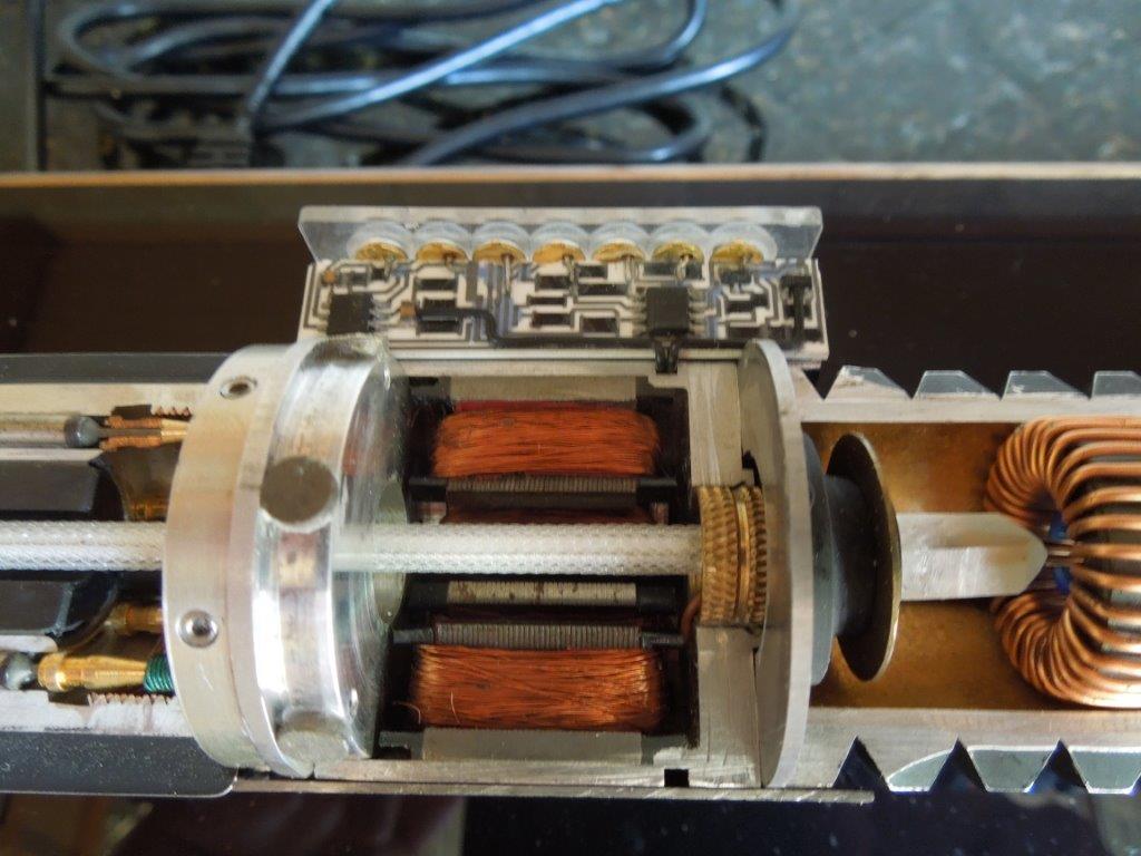

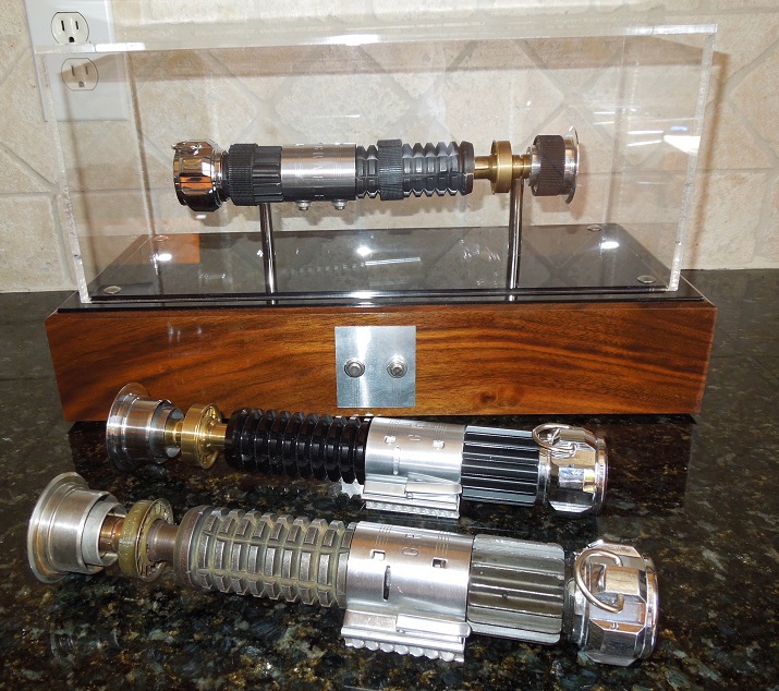

For the newer members who may not have seen my ANH Obi Sabers:
All three:

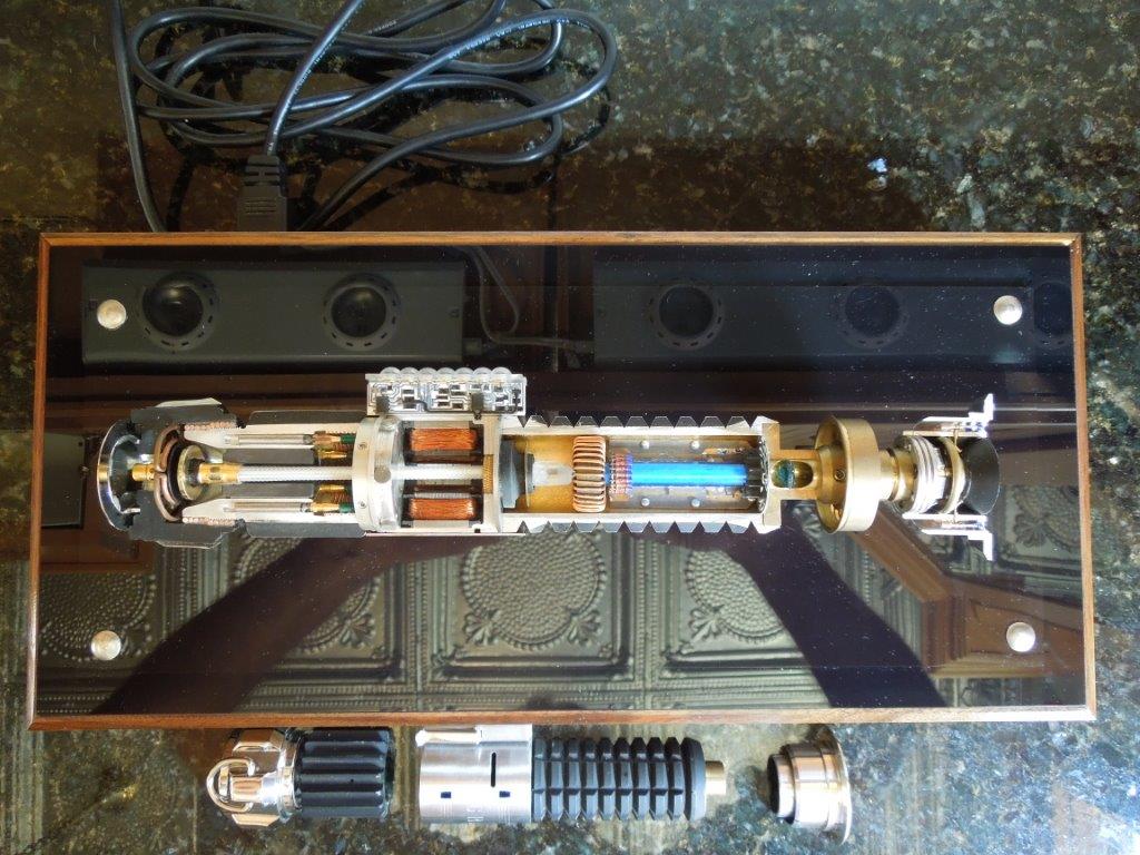

Front-to-back 1) All original parts 2) Roman's Empire parts 3) Cut-away

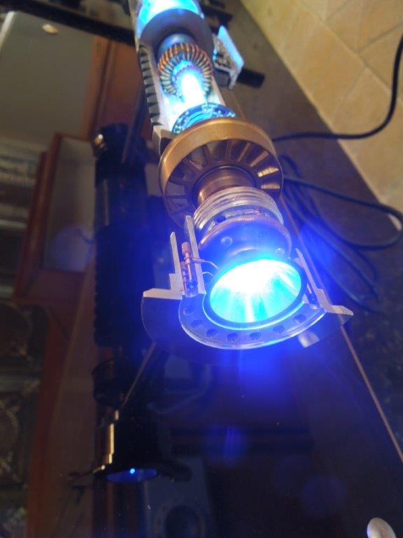

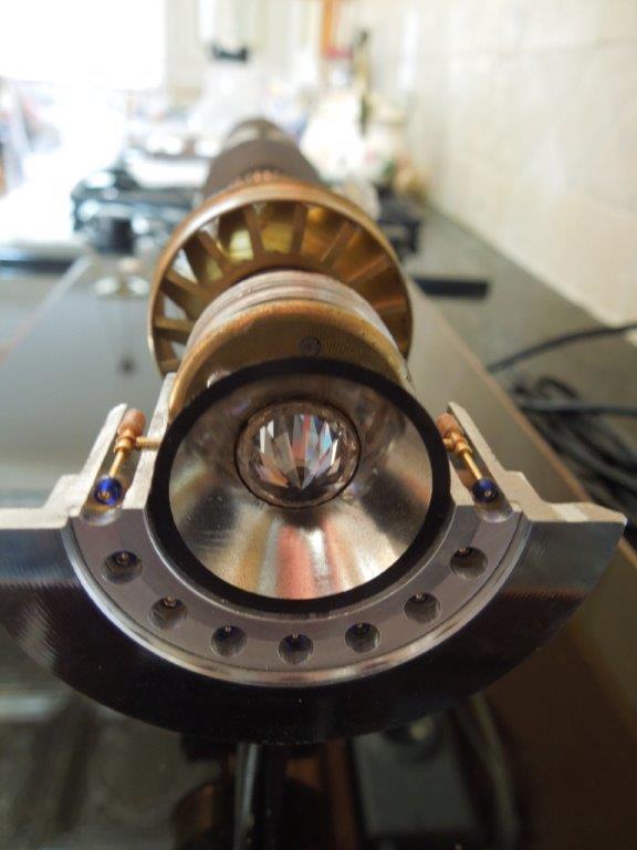

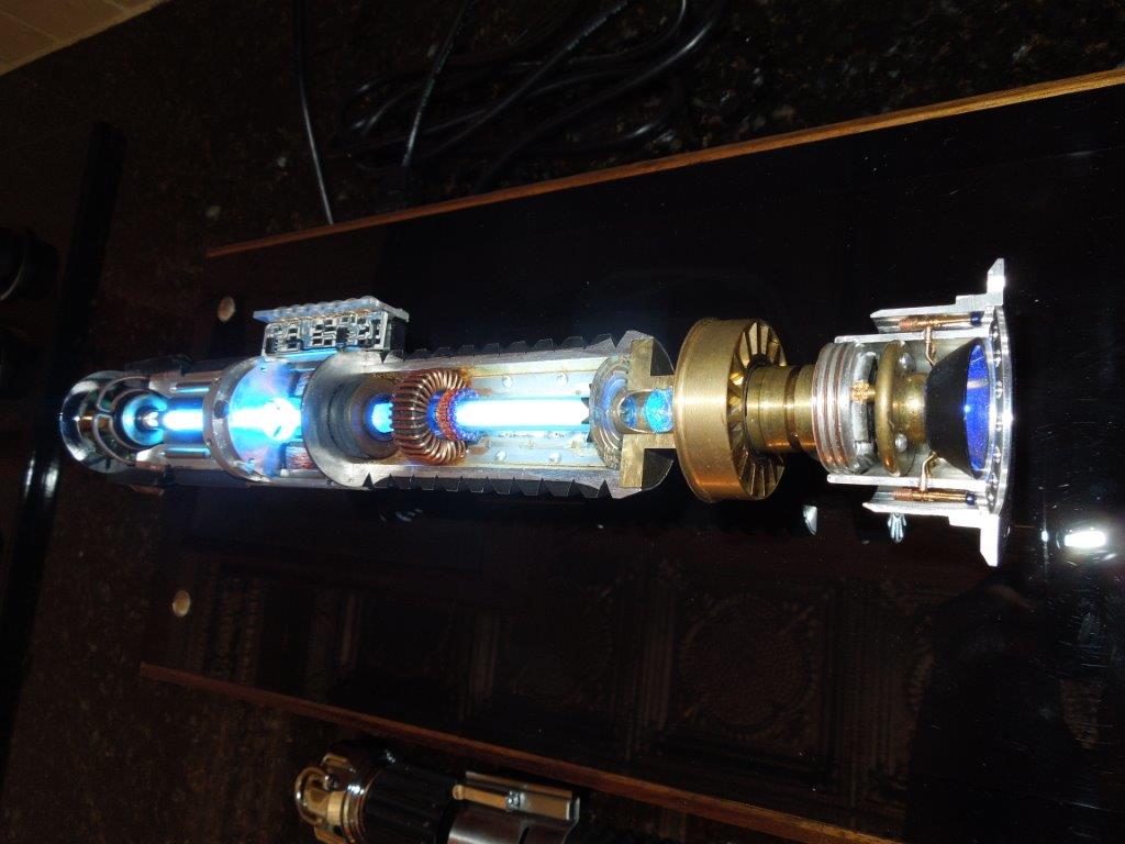

ATL Kenobi

Roman's is more accurate in almost all ways. The only thing that is on equal footing is the grenade.
The Parks pommel is one piece and based on the modern handwheel, so it's too big. Roman's is based on the correct one, but it should be noted that it's full metal instead of metal and plastic, plus the cap doesn't come off his new ones.
The Parks booster is completely wrong in shape and design and is basically just a pipe with three sections of grooves.
In regards to the crimping of the balance pipe, I don't think that's ever been confirmed that it was crimped and could just be glue or another trick of the camera. Speaking from experience with my real balance pipe, it would take quite a bit of pressure to crimp real inconel because it's a pretty strong material.
Since this thread has been revived, I don't feel bad bumping it up by saying ATL Kenobi, that is the coolest looking cutaway I've seen! I'm very jealous!
Yes I especially like the blue things that would go in the Balance pipe holes/ring!

What an incredible display stand as well. Can you tell us who made it?
Thanks Remote People!
The acrylic display case itself came from J Display Case. I don't recall the exact size but it's something like 6" x 6" x 14". The wood box sides were made from 1/4" x 3" walnut (I love walnut) similar to this from Rockler. This wood was mitered to fit the base of the display case. It was polished, lightly stained with walnut stain, and finished with 3 coats of high gloss polyurethane spray - sanding lightly between each coat. The base of the box is hard board and it holds the 2 amp power supply for the 5 watt LED, and the high voltage supply for the luminescent tubes. The display case is held to the wood box with SST carriage bolts.

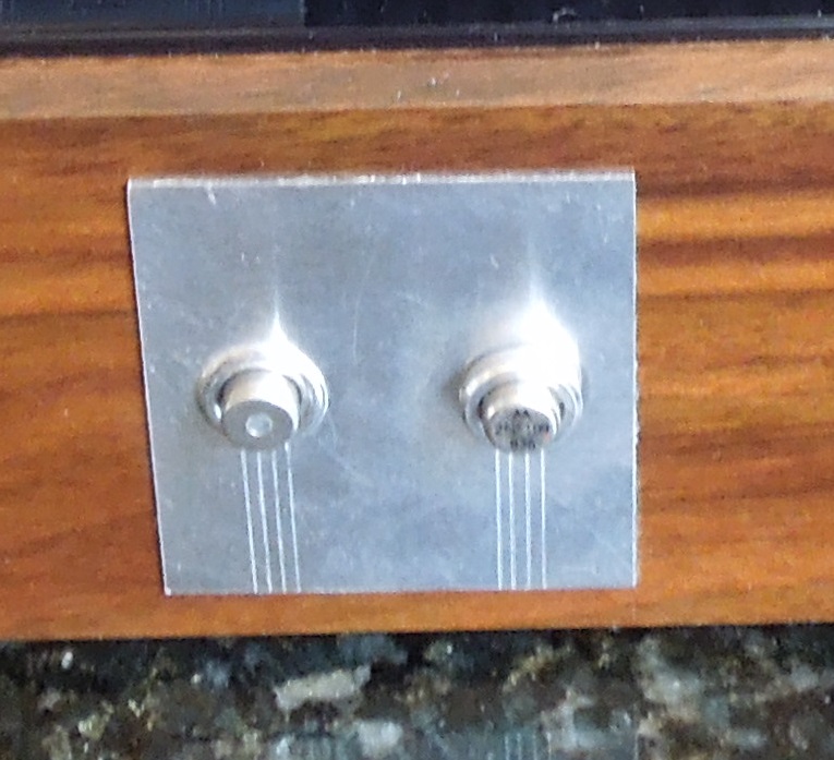

There are 2 switches on the side of the case.
attachment.php
The one on the left turns the thing on and off. The one on the right is a 4 postion rotary switch which turns on the different lighting in succession. The knobs for the switches were made from TO5 transistors. The aluminum plate behind the swiches was scribed to simulate the markings on the graflex clamp.
