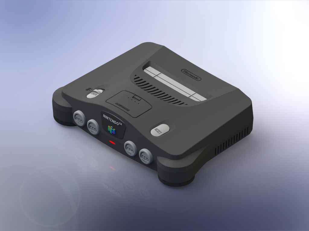

And here's the newest model (took a bit longer than the others), N64!
This one was challenging, with all it's angles, slopes and curves - but that's what I liked about it, the challege. I do CAD modelling for my job and I learned a new program earlier this year so I'm perfecting my chops so the job will be easier and projects will get done sooner, so I'll have more time for this stuff! It's a give-a-little, get-a-little scenario.
Once again, details (including text) are raised for painting ease. But aside from those differences, the model is perfectly accurate and to scale within 1/20 of a mm (1/2mm on the actual sized system).
And yeah, I'm banging out the Nintendo systems first, then I'll get to the others, don't worry!
I'll have to see what the price difference is like between the 1:5 and 1:6 scale models to see if it's worth it, price-wise.

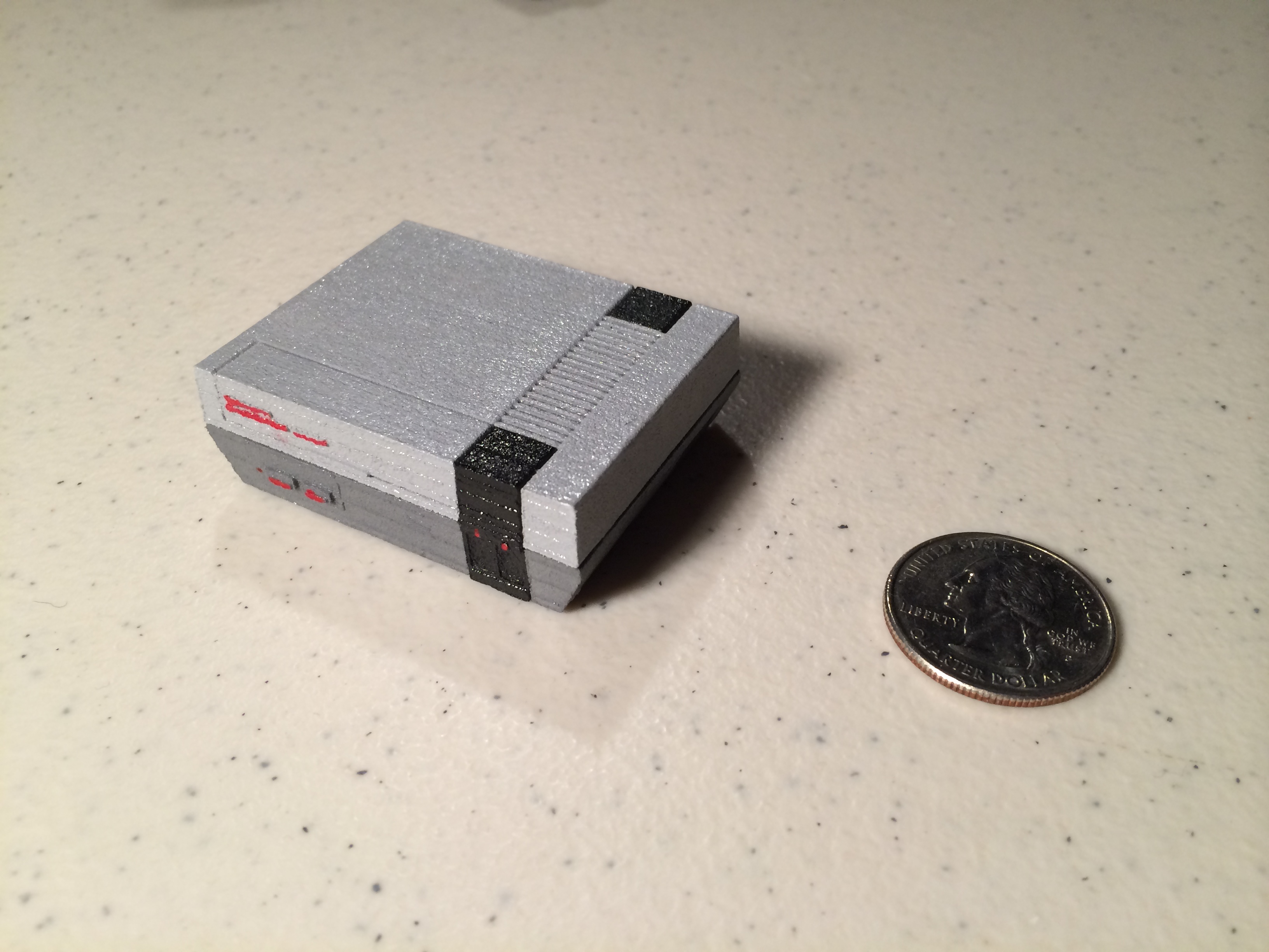

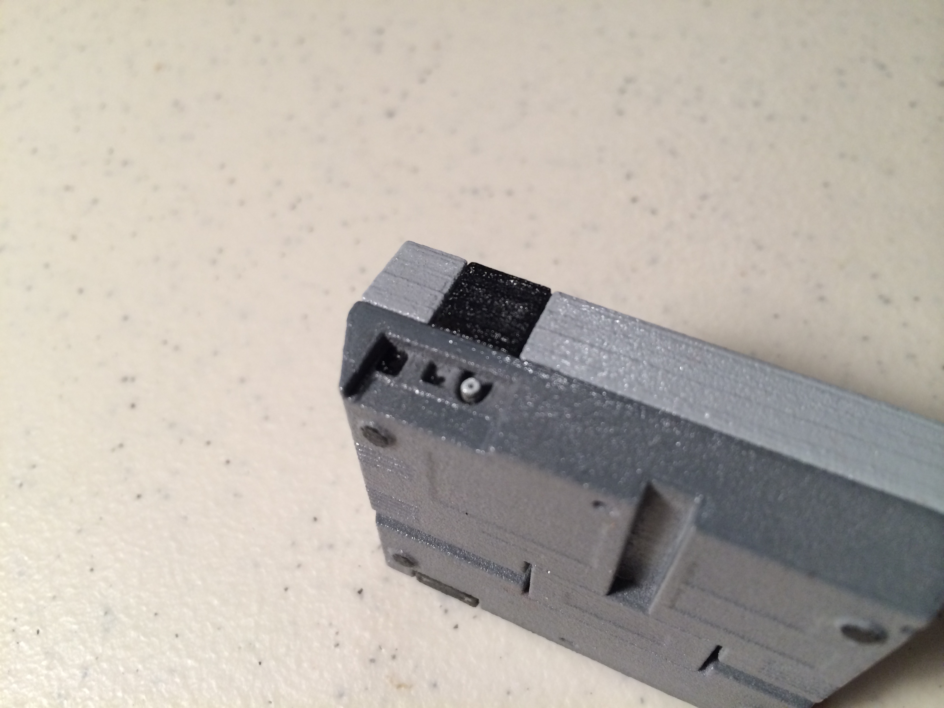

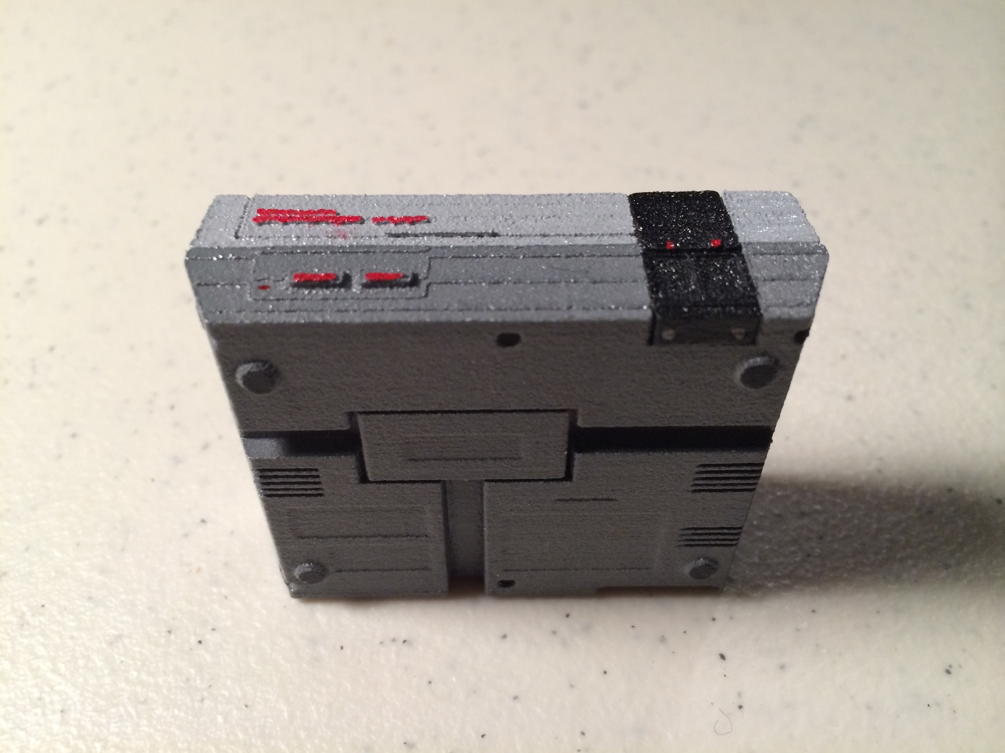

Exciting news! I received the 3d print for the NES yesterday, painted, assembled and varnished it. I think it turned out fantastic! I'm going to order the rest of the Nintendo consoles I modeled and finish them the same way I did with this one. I'm also almost done modeling the Atari 2600.
What are your thoughts?
Looks amazing. Way better than the little japanese systems i've been buying and I don't think anyone's made minis of the US NES or SNES so you're in new territory.

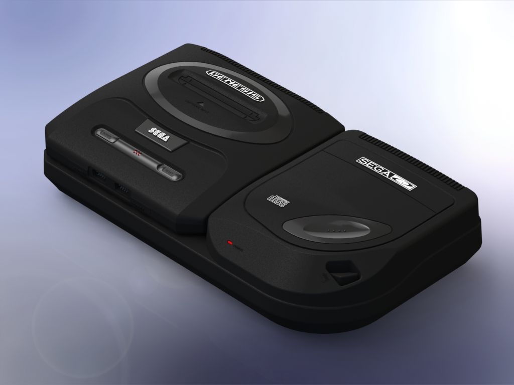

Sega Genesis is finished. I finished the Sega CD as well but I'm waiting until I'm done the Sega Genesis Model 02 before I post pics so you can see them together, as they should be!
Looking amazing. Are you going to do both models of the sega CD? You're making me wish these were in my collection (mind you i own nearly all the real life ones) lol. I was mounting my japanese mini consoles onto displays and realized that they even had labels on the bottoms like the real thing. They're 1/6 supposedly, i can get pics of them next to quarters for reff if you are interested.
No plans for both models of Sega CD yet. I may do it down the line but I'm sticking with Model 02 for now. I didn't think ahead to making the Genesis 01 compatible with a future CD 01 so I'd have to make a new version of the Genesis 01 for that to work with it. I'm sure I'll come back to it eventually.
However, I did do the Genesis Model 02, with removable cover, so it can go with the CD Model 02. Here's a render of each and a render of them together. They fit perfectly!
The only thing I left out of either model is the metal plate that attaches to the underside of the Genesis to secure it to the CD.
And here's them together.
I'll probably do the Saturn next but I'm entertaining the idea of doing a 32X with a modified "cart insert" that can fit nicely on top of either Genesis Model. I'd love to see the three of them all together haha.
