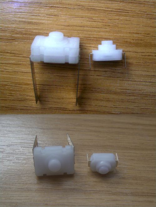

I found these on ebay while searching for the torch switches Taff linked. I looked at the dimensions and they're smaller too. Would these work?
5 Pcs AC 250V 1.5A Vertical 2 Pin Flashlight Torch Push Button Switch
They're also from the same seller.
Re: Nike Mag V2 mod discussion and builds
They would work, when considering dimensions for the switches you are really only concerned about the height of them, the length and breadth isn't really a big thing.
If you can link these Mitas that would be great and I will compare the dims of both types.
i already got these, along with the ones taff83 recommended, i ordered them at the same time to see if they were any good, and they seem too brittle and weak.
they still stick out of the cuff when pushed fully inside even though they are small. How are you guys fitting a judco switch and the other bigger switch in the cuff? they are much bigger than the smaller one i ordered alongside that one, and that one just barely fits in!
I put some hot glue around the ends to make it stronger and so when you push it in with a screw driver it doesnt damage it.

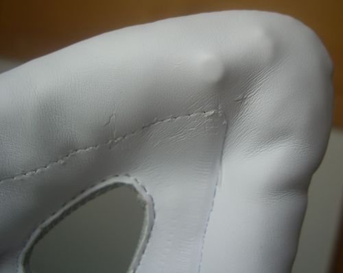

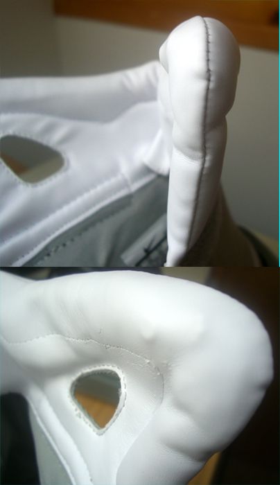

i'm not sure how you guys are managing to push the switches in, im finding it quite difficult to be honest. do you guys have some close up pics of your switches inside the cuffs?
here's that tiny switch on the right hand side inside the cuff. you can see it still sticks out, not sure if its more or less than what you guys have managed to do?
