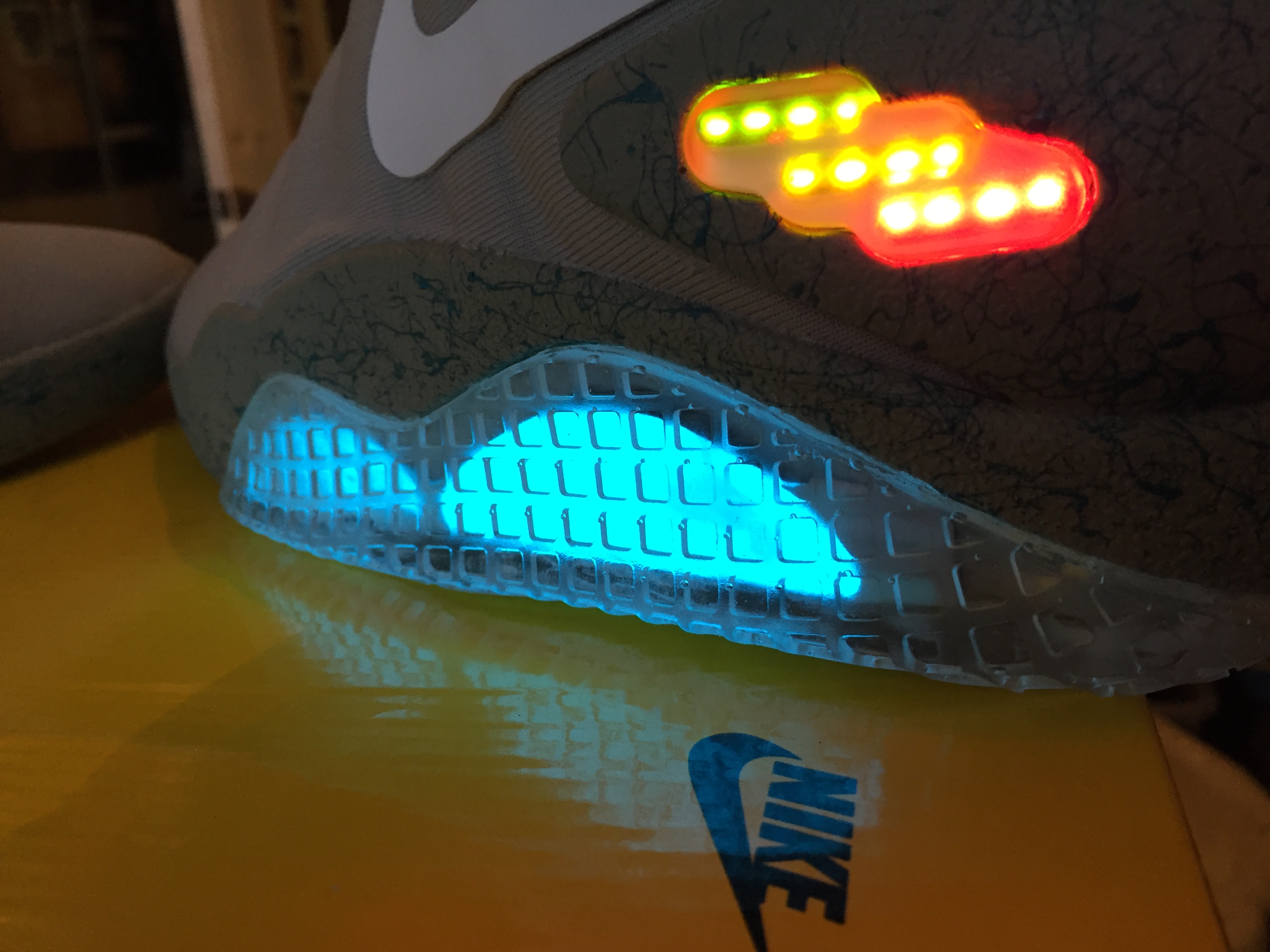

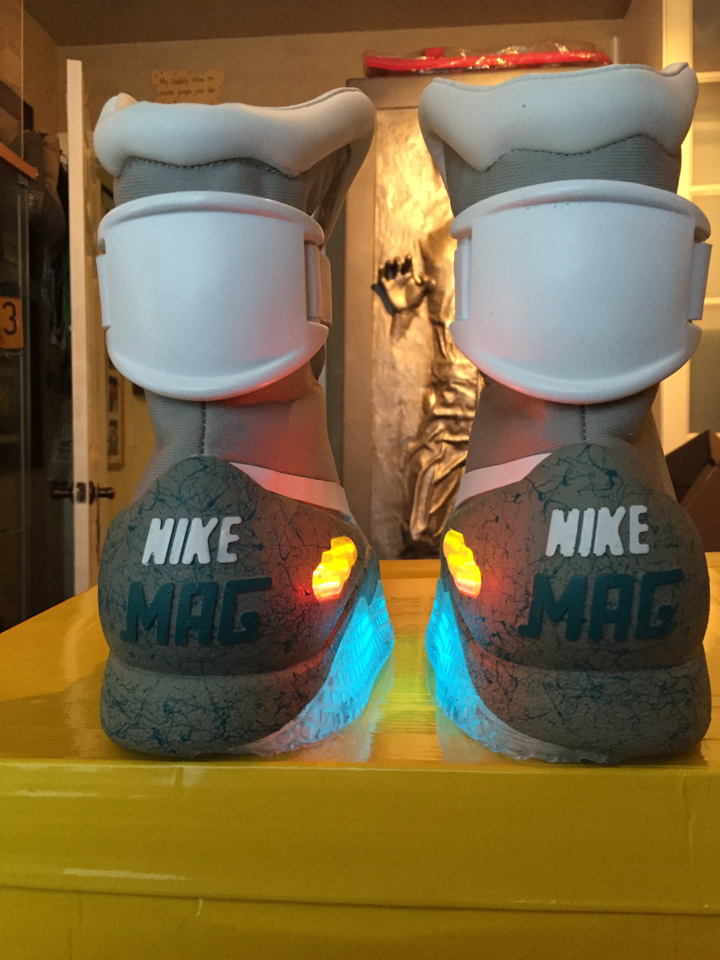

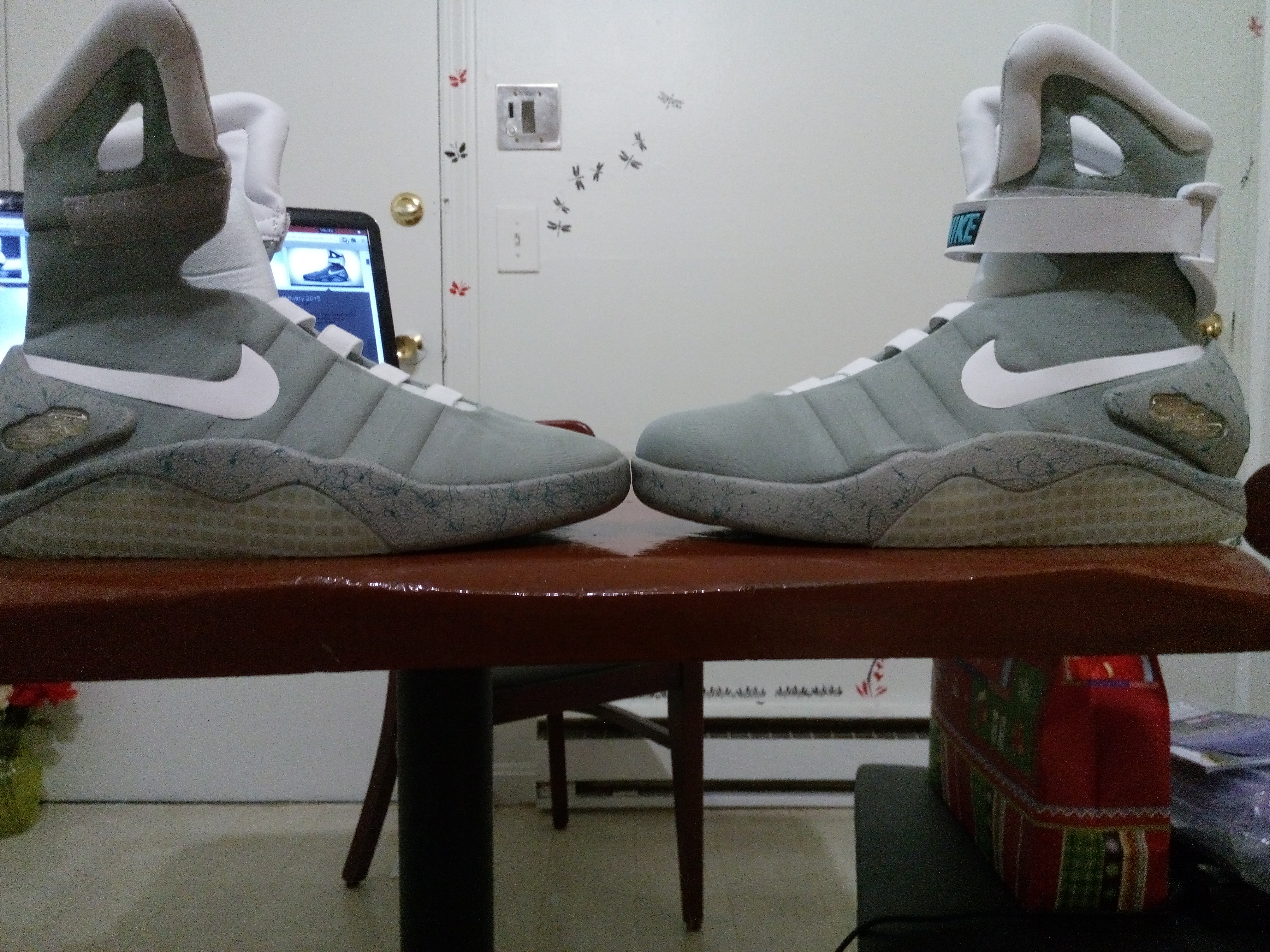

Finally finished installing a pair of Cavx's soles on this pair.
Looks awesome dude! Have you already repainted the midsole on those? It looks like the original to me. I found it easier repainting the midsole while the clears were off.
Gotta get a set of cavx's second release of clear soles to put on my next V2s.

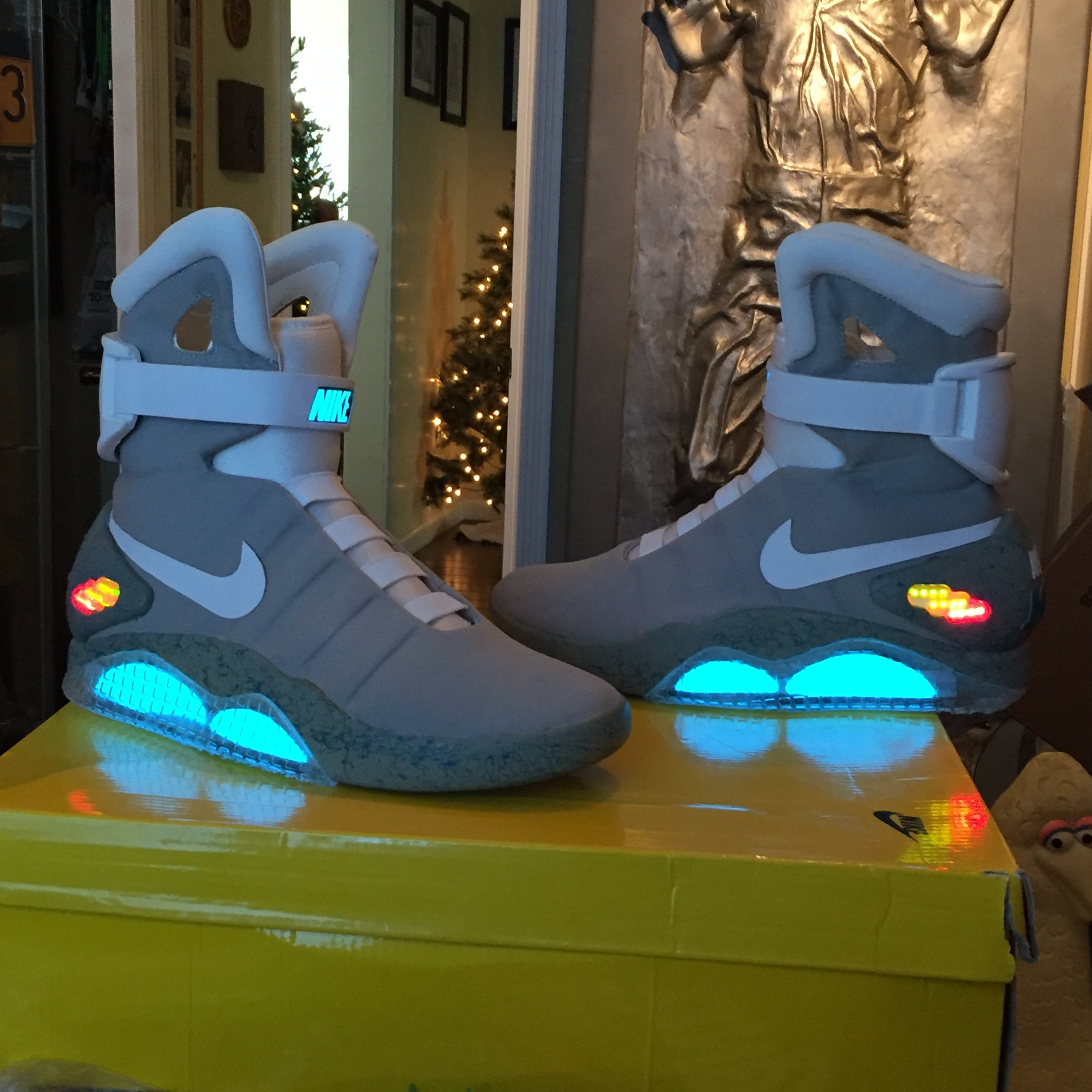

These look real good Brad. Taking your advice, I am currently installing my cavx soles. Pictures soon. Not sure my install looks as clean as yours though.

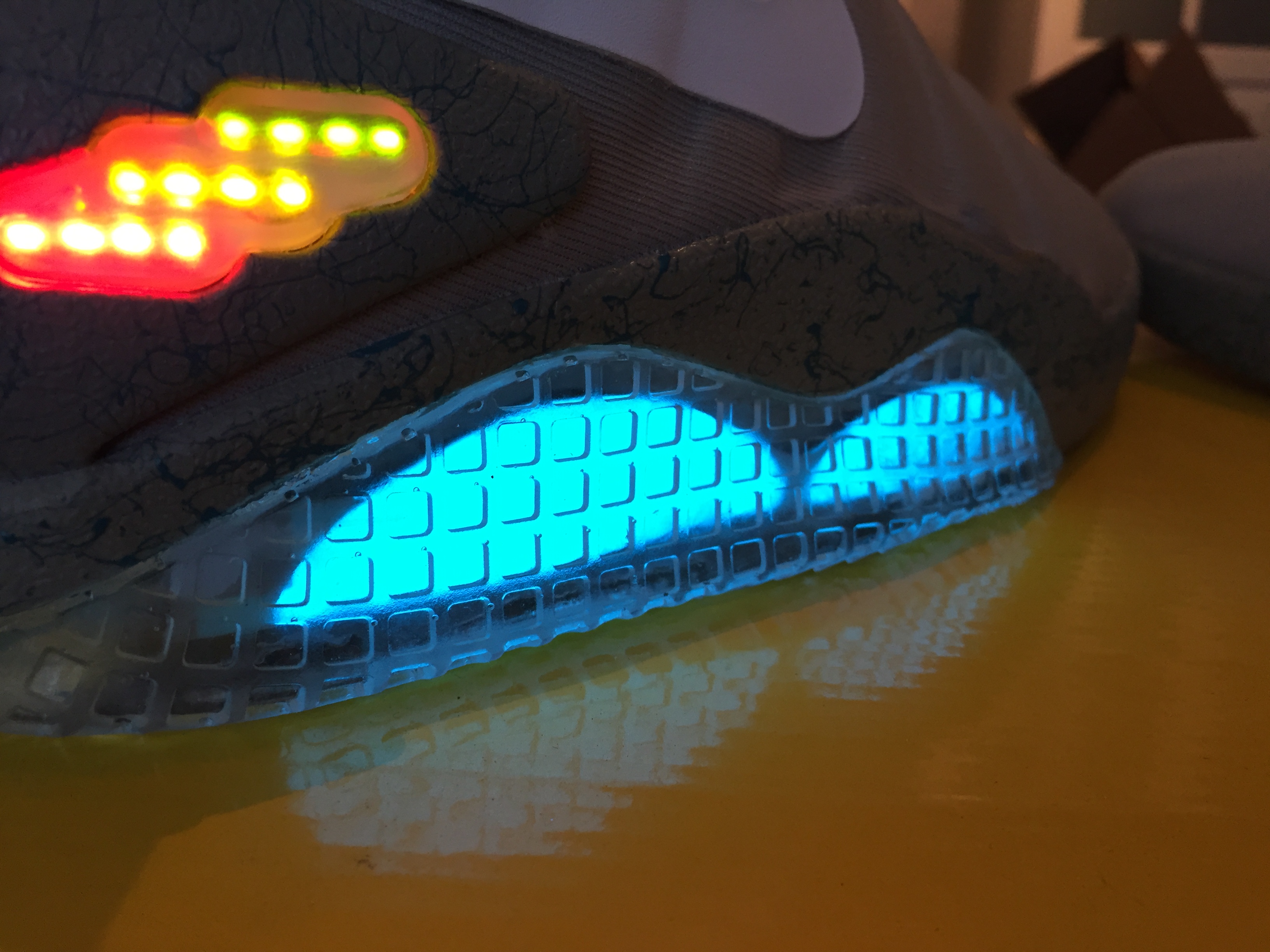

Your EL panel looks really aqua on pictures where did you get it from please?
Mine looks more cyan than aqua...
When it come to light driven to 100%, equal amounts of green and blue make cyan. Aqua is both a colour or light and a pigment, though darker than cyan. Aqua might be best to describe the MAG and splatters. The problem with some of this EL is that there is more blue than green, , so the light looks blue/green, not cyan. I actually measured my EL with my colorimeter and ideally we would want to see R0 G100 B100. What I saw was a massive push towards B by at least 50%.

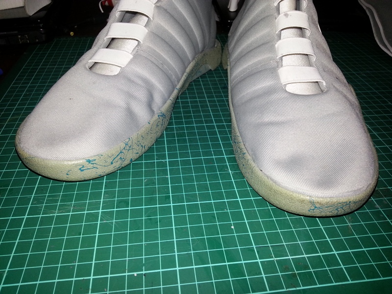

Sneek peek
Looks great bro.
They look perfect Brad, as usual!
trade secret. Lol. Nah, email me. Jedifyfe@hotmail.com

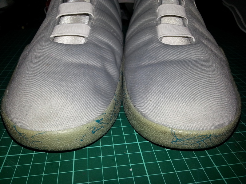

Hey all. Mag mod noob here. Really thankful for all the contributions you all have made to this thread. Picked up a set of v2's last week, and really excited to start the mod process.
After taking a week to read all 300+ pages, I felt I was ready.
First order of business: Toe Mod
I'm a size 12, and after trying the steam method, there was way too much muffin top. Decided to try removing the toe box.
Big shout out to cavx for the vids and information he's provided on it.

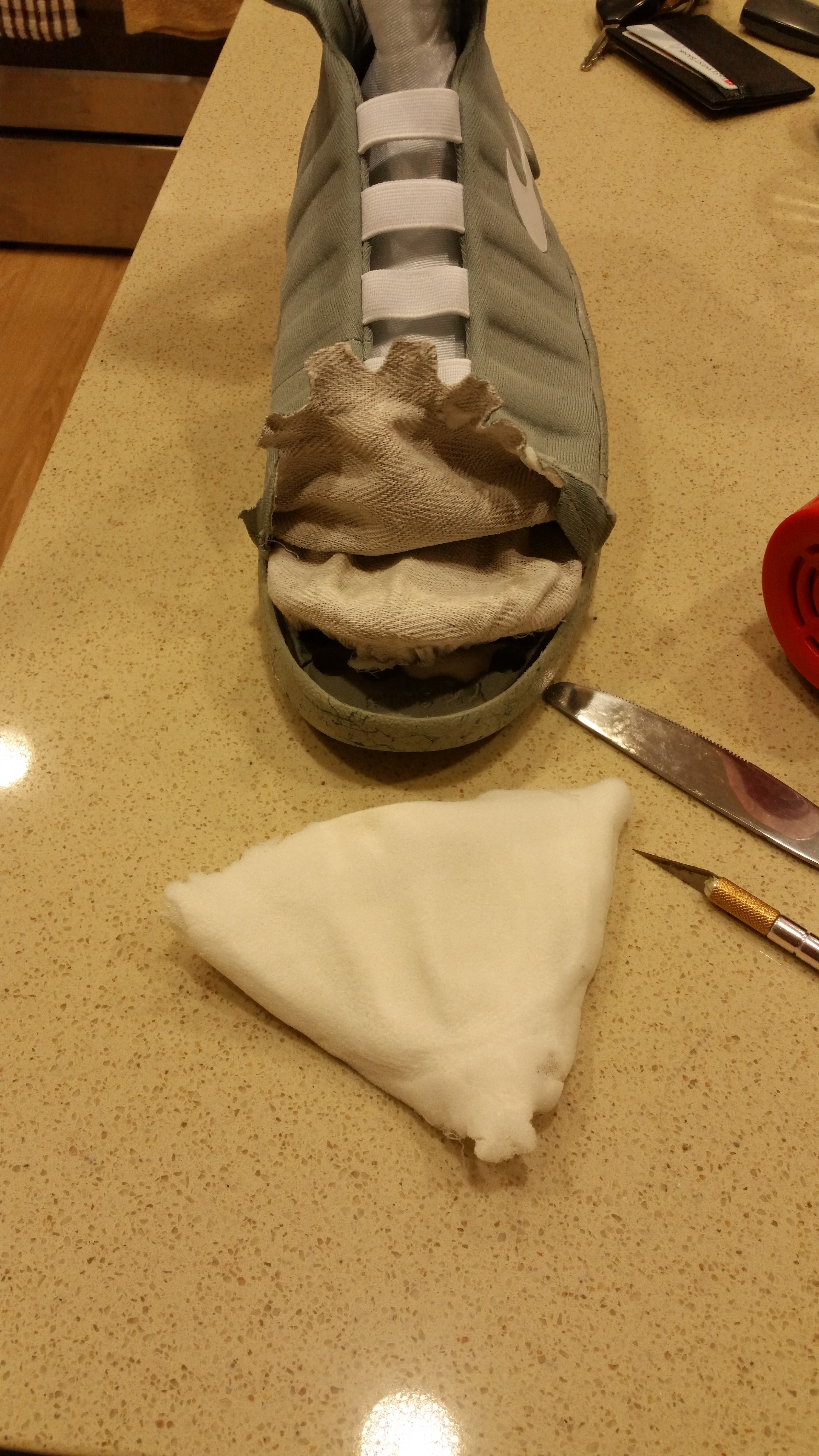

Here's the result on my first shoe (took me 2 hours to try and remove the front part of the sole. SO MUCH GLUE).
The infamous Toe Box
Do you guys have any tips in regards to gluing it back?
Should I fold everything in first and glue it down? Start with edges or front of toe first?
My concern is that once I try to glue it to the sole, that it might be uneven (because of the bulk of fabric on the fold).
Cheers everyone!
So BEFORE you glue or cut anything, you need to fold the cloth back over the way it was before your removed the toe box and just note the way it sits.
If you are satisfied and are ready to glue, run a big bead around the base (essentially under where the sock liner sits and press the cloth back down. If your dry test run was good, the glue process should work as it should go back to the same shape as it did with no glue.

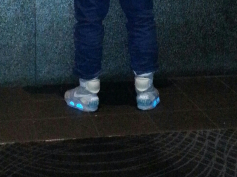

So I ran more "battery life" tests on my all EL system and I got over 24 hours from the pair of cheap Aldi 9V batteries.
attachment.php
Pretty crappy snap. They went from this level of brightness to almost non-visible over the run, yet the batteries still measured 6.3V this morning.

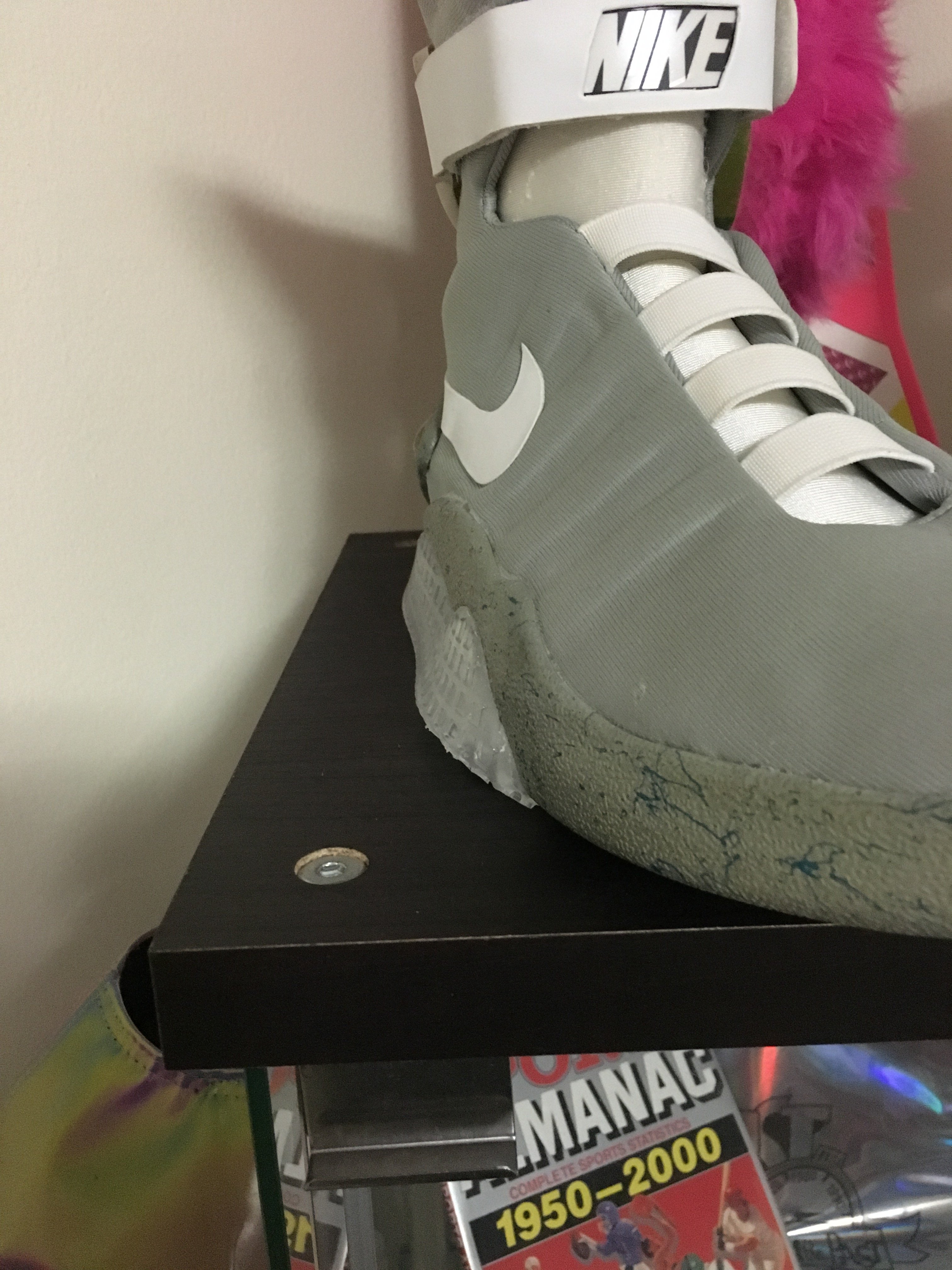

@Vdirty is the guy that made that awesome looking cloth over foam MAG. I wonder if there has been any updates?
Sorry guys work has been taking over my life, especially around the xmas period. But dont worry as i have not lost any interest in the project. Still super keen to get this done! I will see if i can manage some time over the holidays so stay tuned :)

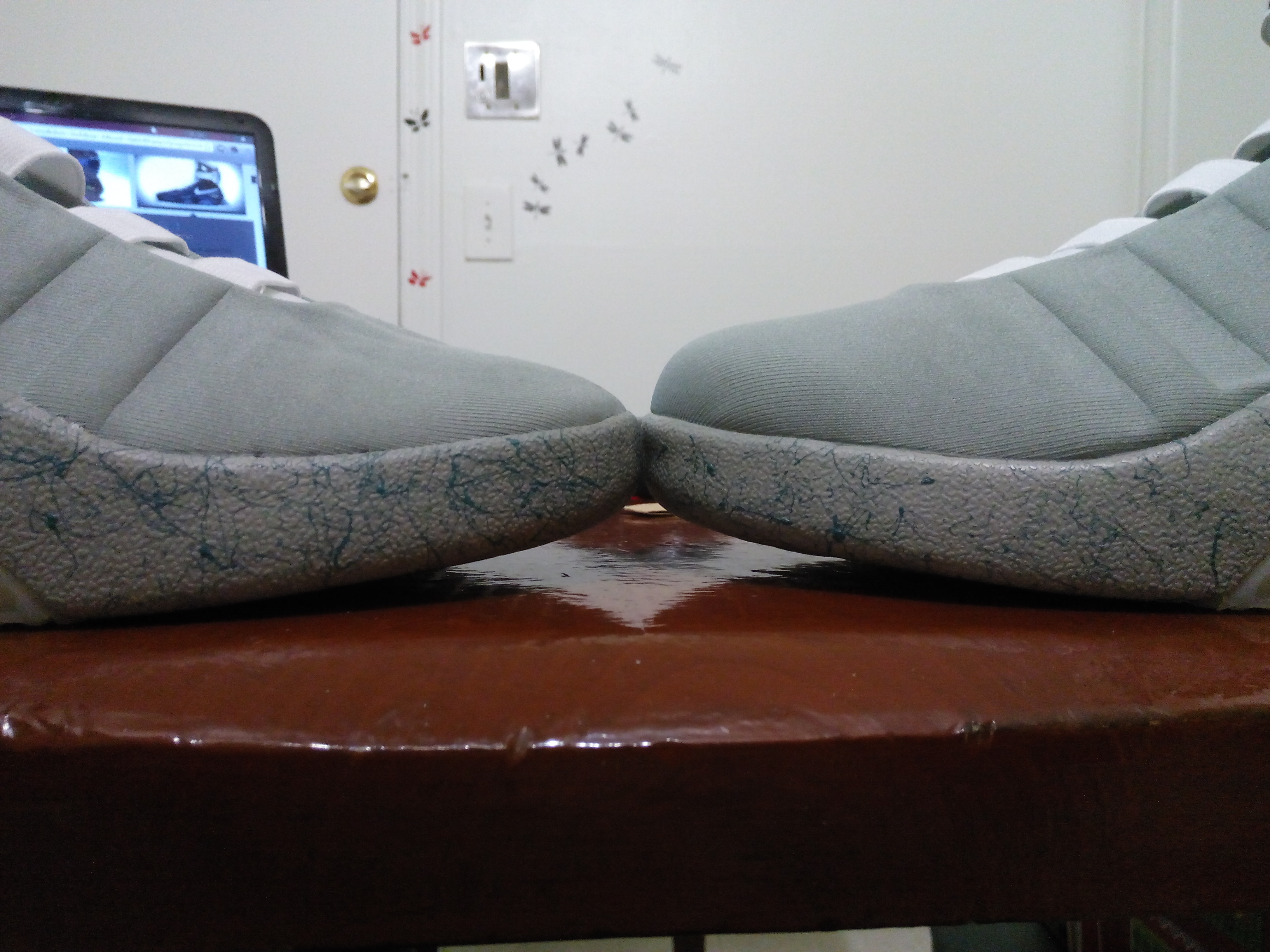

Hello guys, I made the change to the first shoe, I would say that the result was excellent. how about? I deleted the edges of the card pink and excess fabric, then glued it all!
