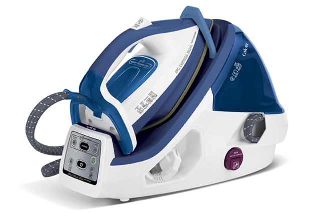

I used this iron to do the mod
and i was steaming non stop doing the mod, BUT ! You take the risk to make the midsole's paint stick a bit to the napkin, i found out that without REAL heat the laces didn't flat enough and i didn't care if the paint was being removed because i'm going to dye midsoles.

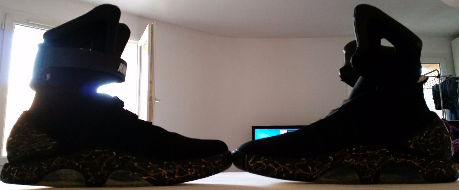

Here are my V2s, i should receive angelus paints next week (crossing fingers)
20150904_093725_resized_1.jpg20150904_093733_resized_1.jpg20150904_093748_resized_1.jpg

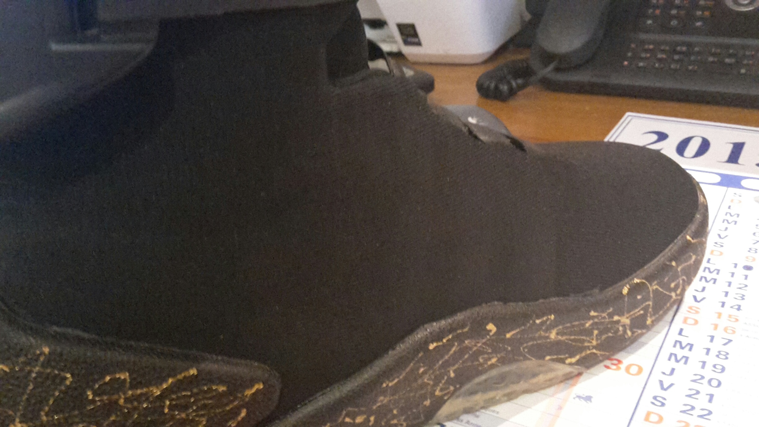

You can barely see it on the pictures but i did emmet's steam method and it's the bomb ! no wrinkles as you can see, when i had some i could remove them when the sock toe was hot with my fingers inside the shoes and tadaaaaaa ! (always fill the inside of the shoe with a t-shirt when you're heating the toe box !)

I didn't make the toe too "flat" because i wanted to be able to wear those without feeling the toe box so they're probably not as flat as RDs or Jedifyfe's, and i if i would have gone farther in the toe mod, wrinkles would be instantly seen and i wouldn't have been able to hide them.
