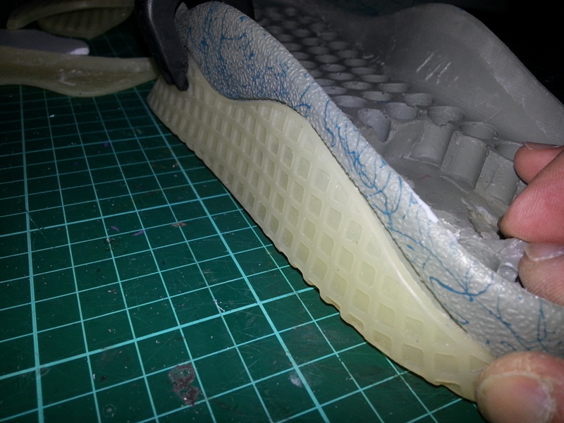

3. I also decided to have another go at the rear mid-sole mod where the V2s are too high.
attachment.php
Both are done BTW. This shot is just to show the difference before and after and I will clean up the old glue line with some acetone. There is a slight gap whilst it just sits, but once glued down, it looks pretty good.
So what I have done different here is not to pull the cup over the ridge at the top of the mid-sole like I did last time (because that deformed the shape and I then had to build it back up), rather work out the cut line and grind it off. I ground it down flush with the inside the mid-sole.

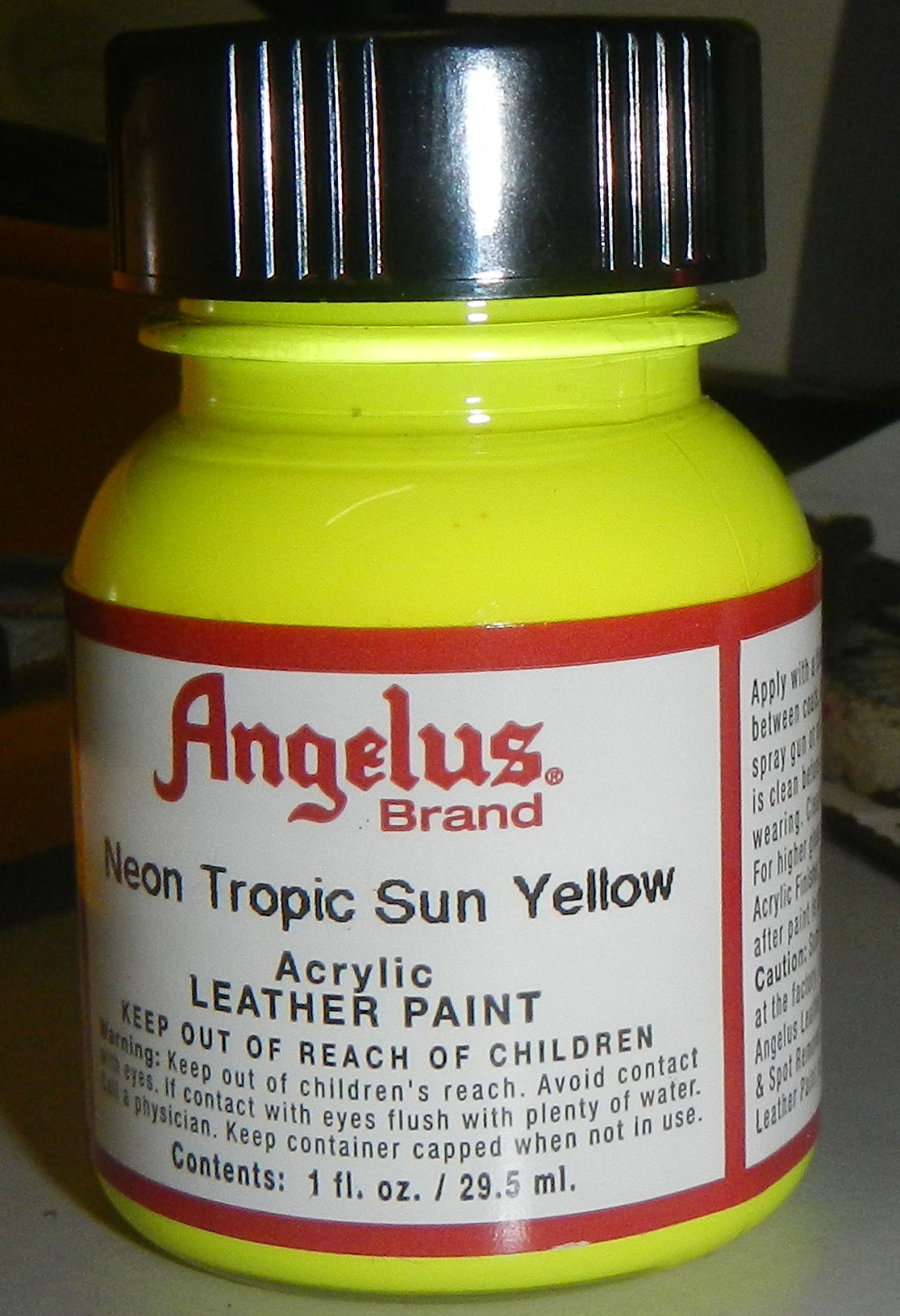

Does anyone know a good paint (neon yellow) i could use for the Mag logos on the heelcups ? I was thinking about the Angelus Tropic Sun Yellow Paint
that looks like to be a good color match but will certainly crack with time due do the fact it's leather paint, but for the small amount to paint ... Cracking or not it isn't a big deal to repaint.

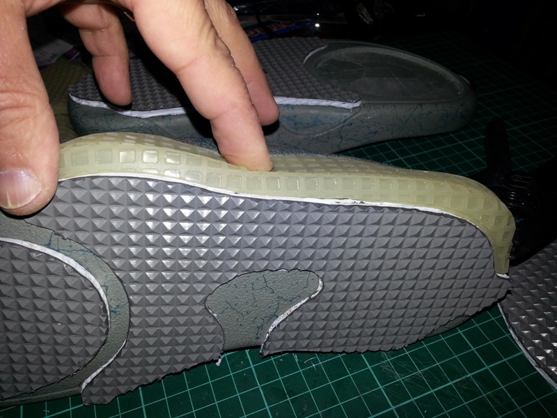

I am currently making US8 and US9.5 that will both feature the outrigger style with waffle on the sides and pyramid tread on the base. I have re-worked my design to give a much cleaner seam between the side and base. I am even going so far as to correct the leaning waffle on the front inner wing.
