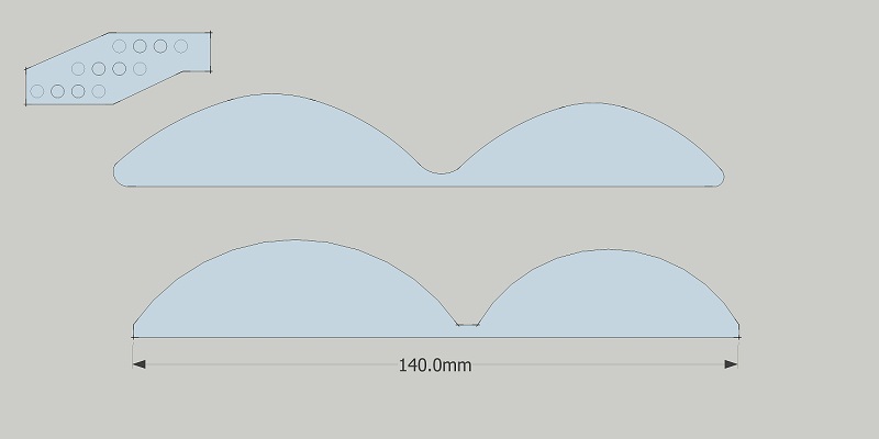

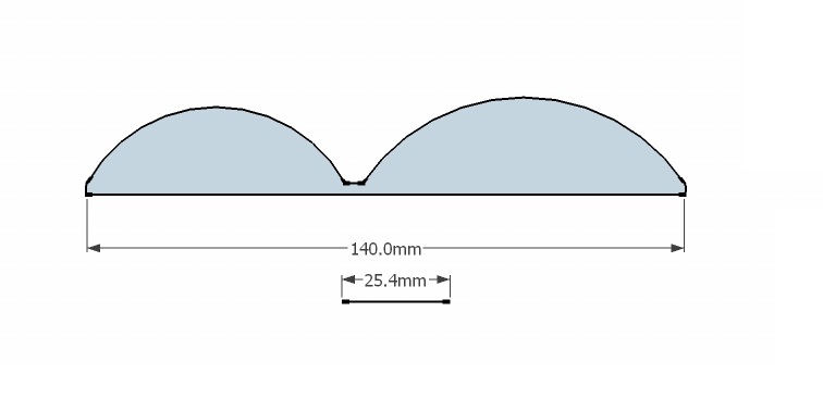

Last week I volunteered to do the scaleable pattern for the EL and LEDs based on a PDF pattern by another member. So here it is.
His original work at 100% in the PDF
http://www.therpf.com/attachment.php?attachmentid=155694&stc=1&d=1365935705
I made a small change here by reversing the two humps as the original had the taller one at the front.
And my work in SU (so we can scale this to any size) and screen captured as a JPEG.
http://www.therpf.com/attachment.php?attachmentid=155693&stc=1&d=1365935705
I have not shared this yet, but can if that is the wish of the forum. At the size it is now, this would probably be for a size US13. I can scale and post JPEGs of all sizes if I know what they need to be. Either way, let me know.
PS, I have just removed the lines between the EL.

It looks like I have to re-draw this all over again because 252mm is NOT RIGHT!

This is the one I used the for the pair I have been working on.
attachment.php
I have not done a scaled version yet. That graphic was for the pair I was working on which are US13, not US9.5. Print it about 90% and see how it looks because at 100%, the front arc is too large and you would have no space to glue the sole back down.
What I found was the smaller shoes not only need smaller arches, they also need a greater space in between front and back parts.

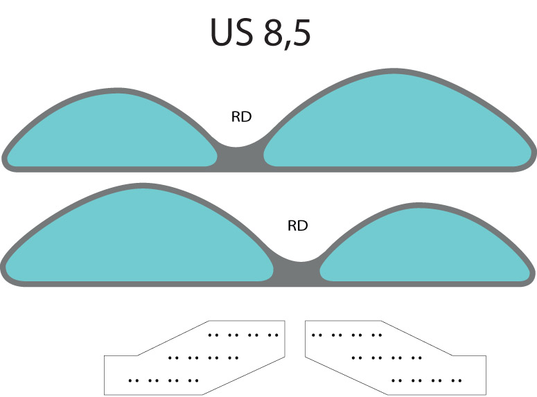

Vormz that is a nice clean conversion. Well done. Hopefully I will get either a pair of the US8 soles sent to be or least a really good image taken with a rule and I make up some outriggers in this size.

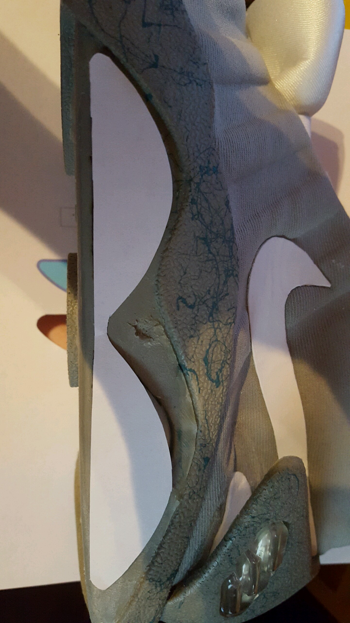

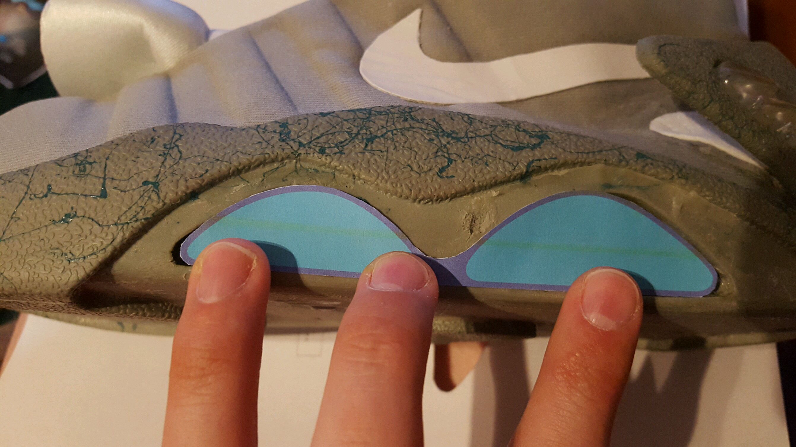

Great thank you both very much....I printed both out. Cavx your template still doesnt look quite right. Im not sure I could be wrong. What do you think is the better option of the two
Cavx
Vormz

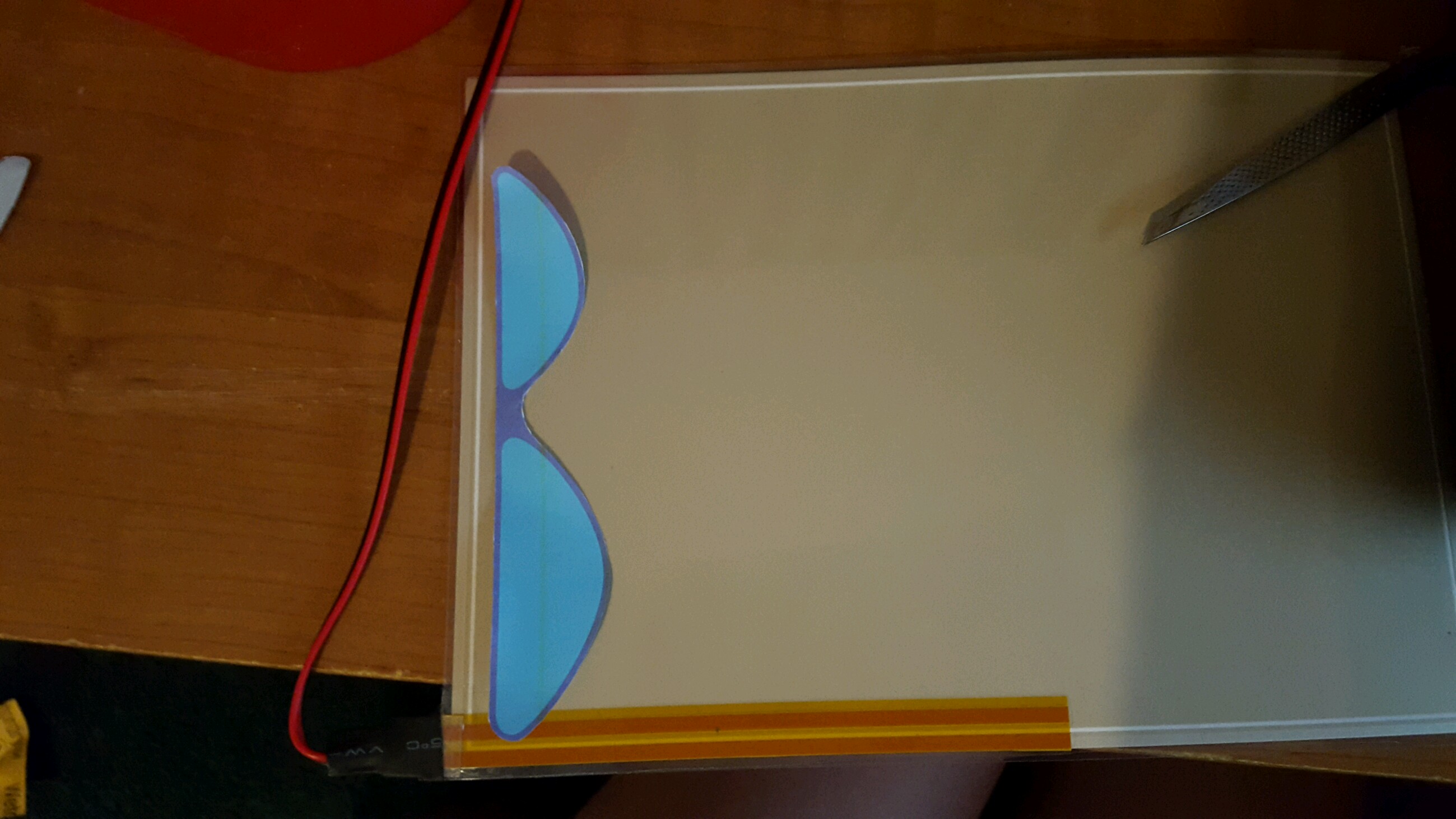

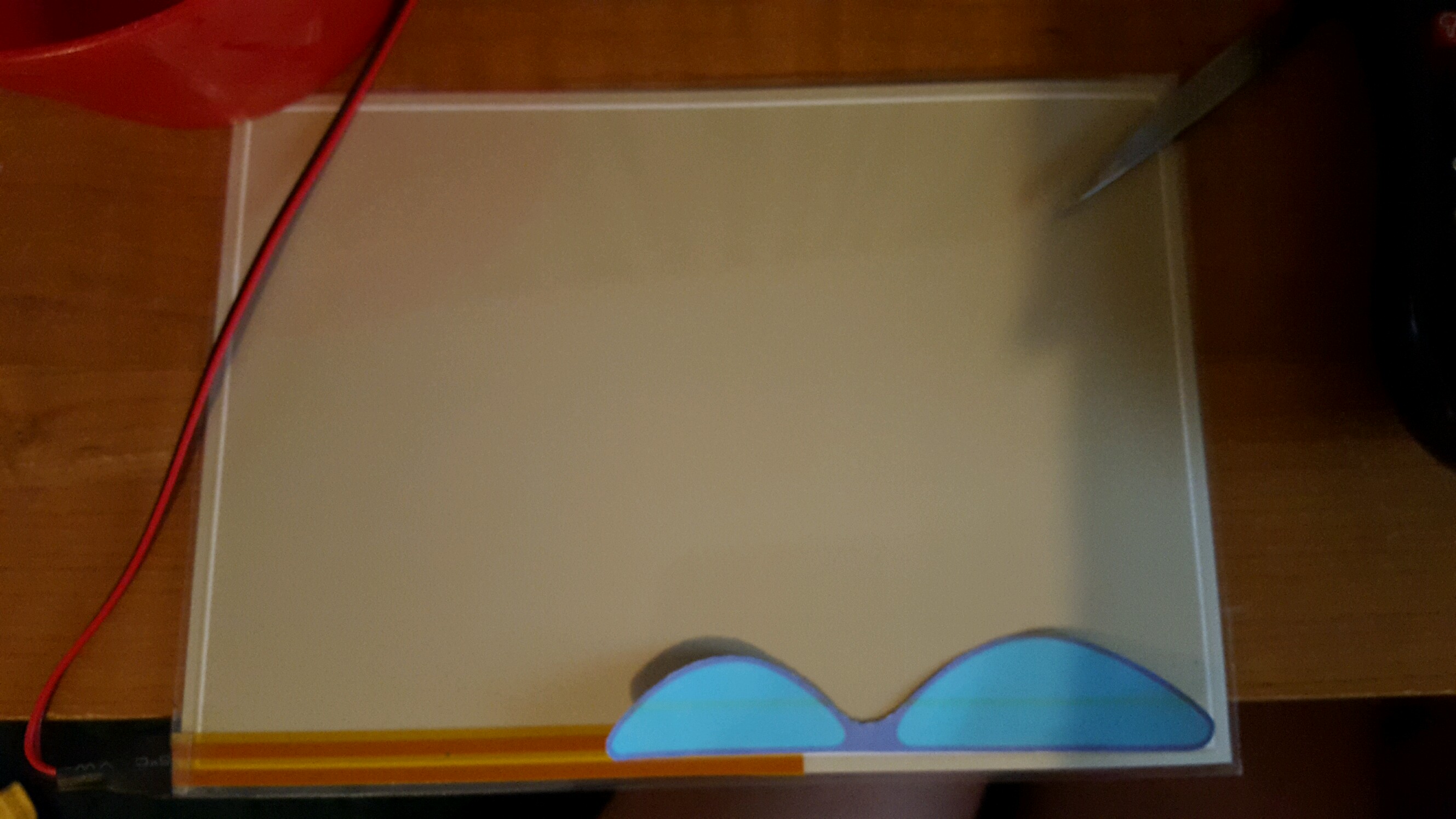

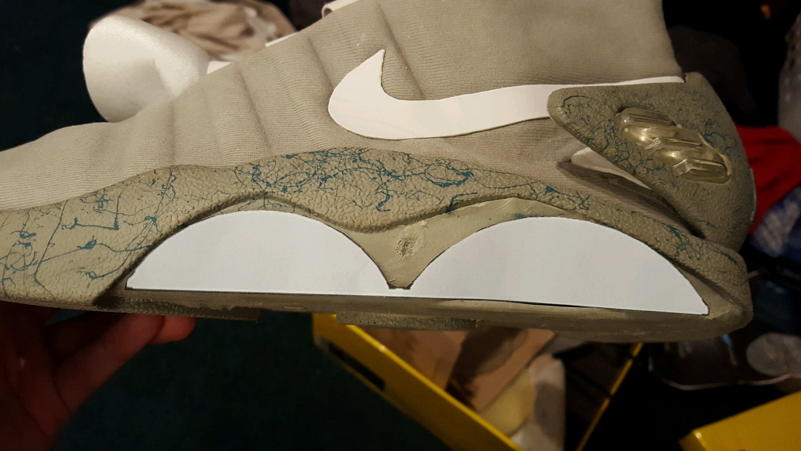

Maybe scale Vormz template by 10% since my shoe is a 9.5 ? What do you think ? Also getting ready to cut the EL (never done this before....Which would be the correct orientation I should cut the template.
Option 1
Option 2
Thanks again for the help sorry for all the questions lol
Vormz's template looks good. Mine looks like it needs to be turned around. I think connect at the bottom is best.
Ok so just to be clear...the first picture you think would be best ? The EL and connector both going horizontal ? Or did you mean the 2nd picture ?
