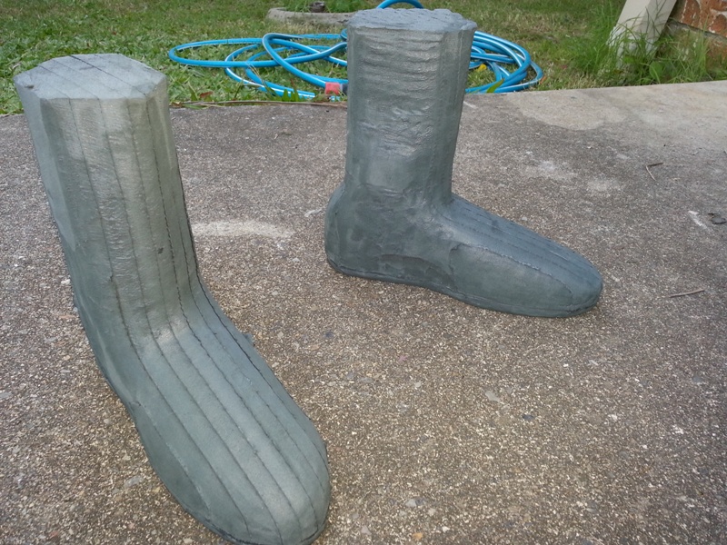

So I decided to make a new start on the lasts because symmetry is a be-otch and I think I might have just got it right.

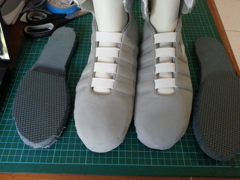

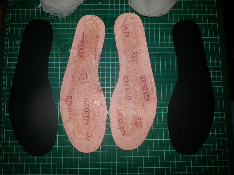

Anyway back onto modding my display pair. The lasts I made are too big for this pair, so I just made a double stack EVA innersole using the original pink cardboard part as a template. Originally I was not going to remove this part, but decided it might as well go and I am currently in the process of gluing in a 1.6mm plastic version.

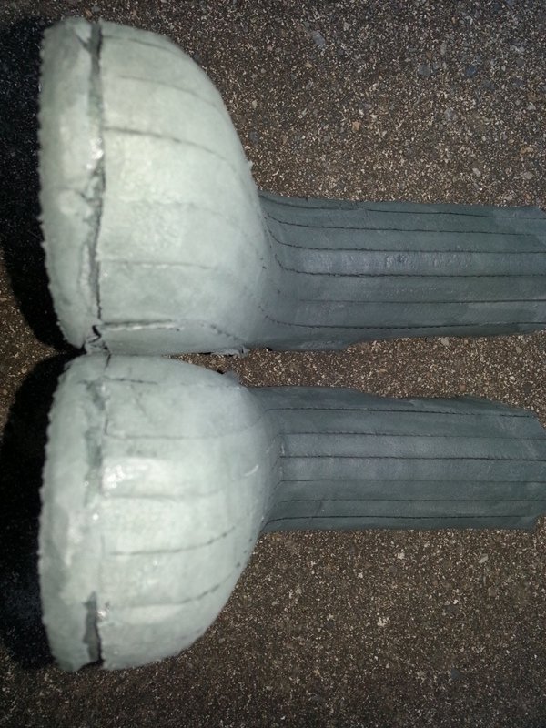

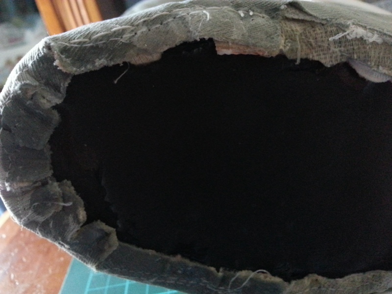

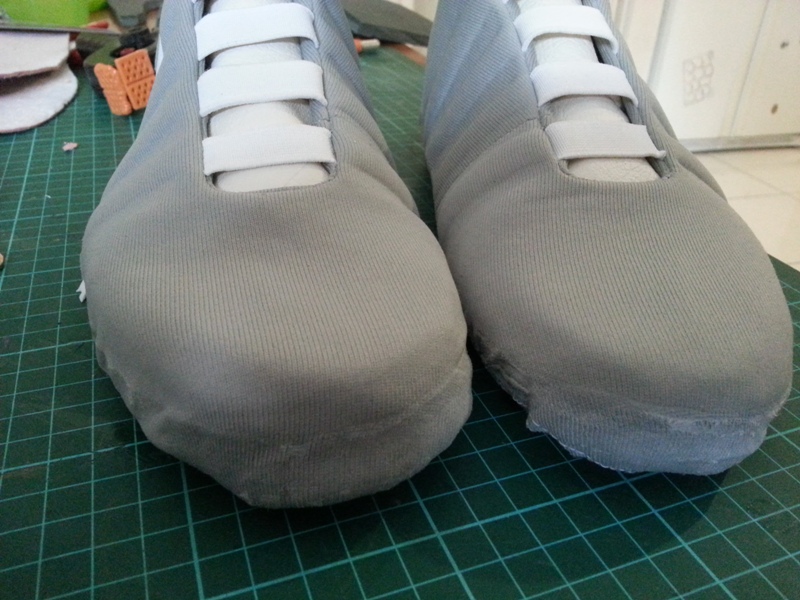

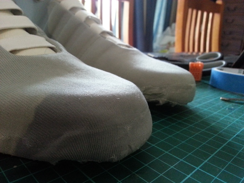

Today I started the reassembly of my shoes. Unlike most toe slims, I am not cutting any material off. I am simply re-building the toe without having the toe box (completely removed) to hold the boot shape. The idea is that the excess material will create the slump that makes the screen used shoe look so cool.
So after removing the cardboard and replacing it with plastic, it was a case of re-gluing the uppers. The process is a bit time consuming as each tab has to be folded and glued back down. I found it best to just glue a tab from one shoe and move to the other whilst that first tab dries.
attachment.php
This is what the toes look like with the lasts in place.
attachment.php
And once removed, the toes have a nice slump or holllow.
attachment.php
The lasts I made for this were simple, just two pieces of 10mm EVA glued together. EVA is rigid enough to hold shape and flexible enough to bend when it is time to take them out so has worked out well for this project.
attachment.php

Thank you :) What I have found is that the super glue is actually better as a stiffening agent rather than an adhesive in this case. The glue soaks into the cloth and holds it in place as a now plasticized material. It is stiff and can not unfold. The actual bond to the sole will be made using Shoe Goo which is strong and flexible. It just takes 24 hours to cure.

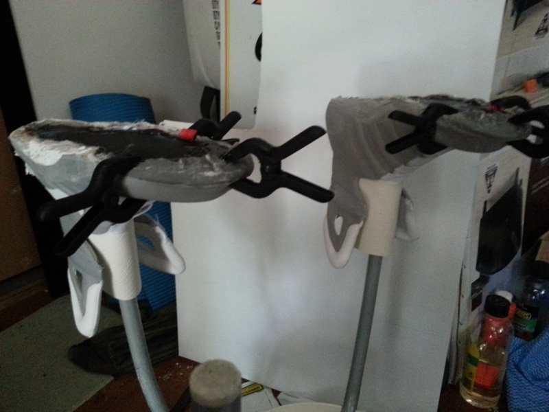

Using Shoe Goo to bond the new plastic innersoles to the uppers. Heels have already been done and I am just letting the toes set up now.
attachment.php
Because it is overcast, this stuff is curing quite quickly.
you said you are replacing the cardboard with plastic, what type? like an EVA foam or something stiffer? Some stiff plastics will crack if bent.
I have used 1.6mm Polypropylene, the same stuff speaker cones are made from. Very strong and very flexible. A total PITA to glue though, and why I am now using the Shoe Goo for this part as well as for the final bond to the mid-sole.

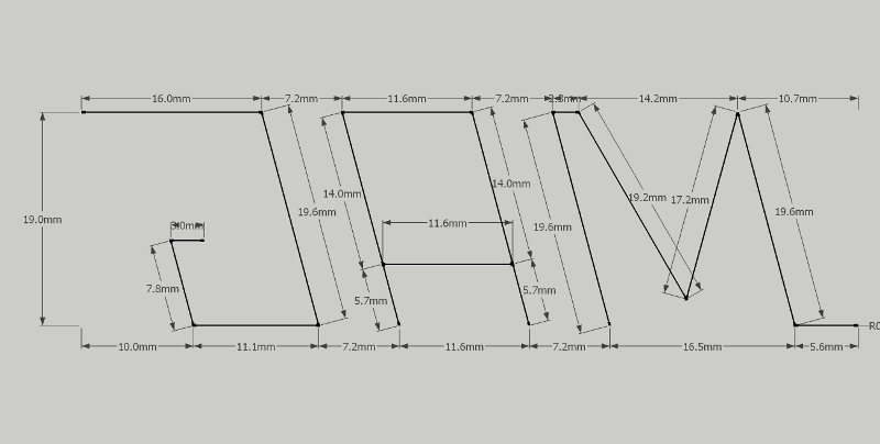

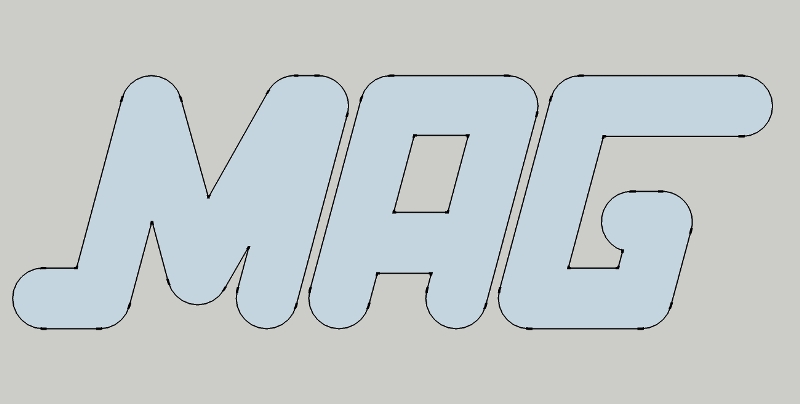

Hopefully next week I can get this off to the machine shop and get them to cut this into a piece of scrap metal or plastic.
So the plan is to have the machine cut the letters into the material backwards.
attachment.php
attachment.php
From there I can flood the cutout with eleastomer, peel it out and it should look like this.
