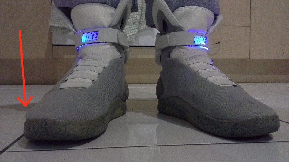

Ah, that explains it. I knew that method isn't an accurate fix.
If it meant not having to cut up the shoe than that methods suits me fine. To be truly 'accurate" means to re-move the toe box altogether as airair did on one of his pairs.
Size of the shoes and how slim you want the toe all have a bearing on the final out come. I have US8s and they came out very close to RD shape because the toe is short.
My US9.5s were probably a bit overdone but I did not like the look when done the same as the US8s due to their slightly longer toe.
I have a pair of US13 here that I am modding and they won't need much at all to get their toe slim due to the ratio of length to bulge.
I simply would not go as heavy handed on the next pair, rather just use enough heat to take the boot look away. I might even be able to change this pair given these have become my experimentation pair anyway.

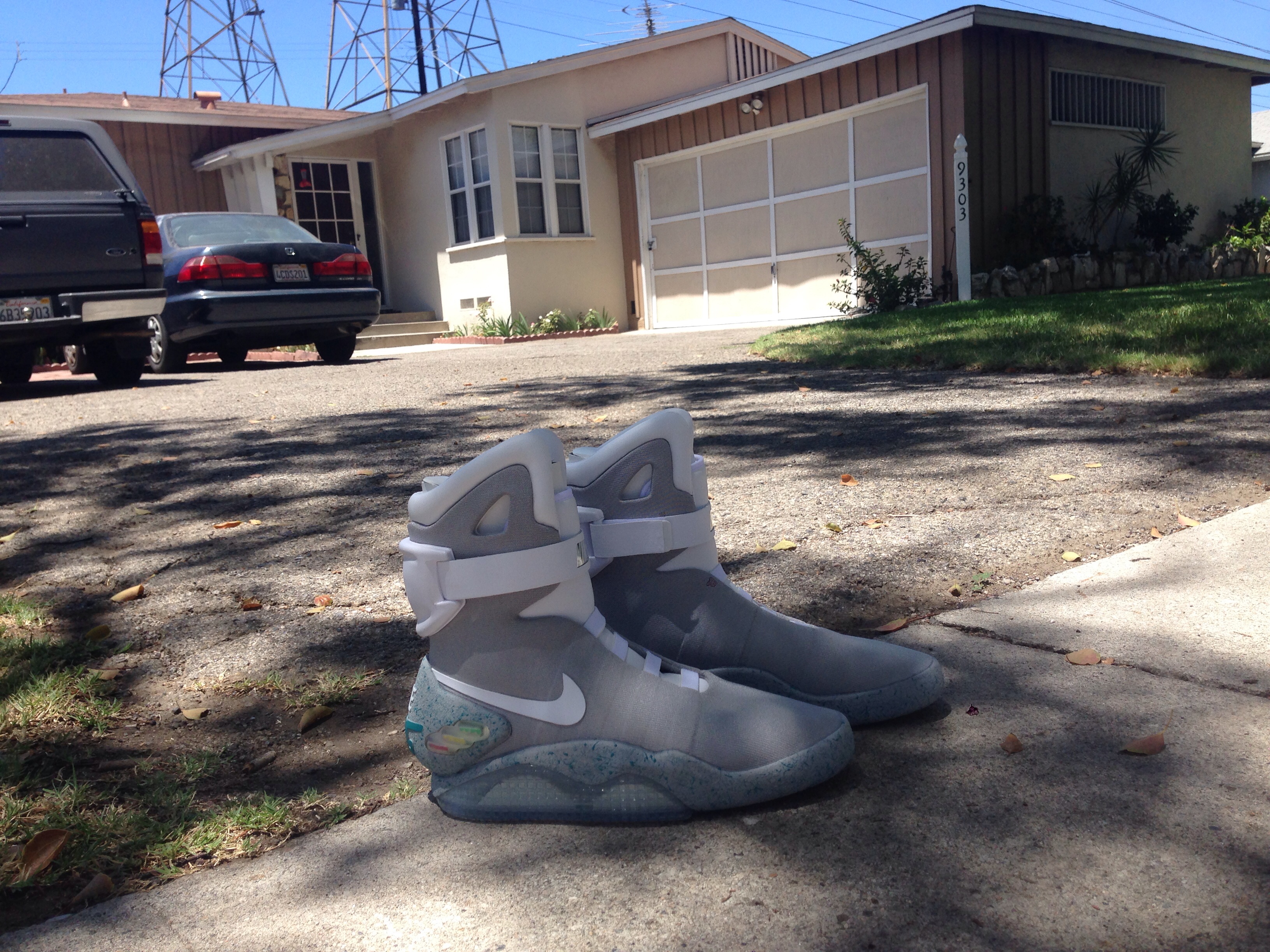

This was my first attempt at the tee with Tulip brand slick paint, I have a hard time trying to figure out how to apply fabric paints to dark fabrics, (this was about 4 layers just to get a hint of the color to show :wacko)
$3 shirt and $3 paint so it wasn't such a loss, plus I can use the paint for other stuff too lol. If I can find the right shade of yellow that can work on dark colored tees then I'll have a better turnout on the next attempt :thumbsup. I do have a screen printer of my own, so I might hit up some screening shops and ask for tips and such, or just some Googling to find some screening forums to find out which paints to use on black tees. btw, awesome McFly house pic!
nike-mag-v2-mod-discussion-page-58-shopping-list-1381662_4909369351667_1665543454_n-jpg-245576d1382479573
Edit: "Please excuse the crudity of this model" This was a template I cut by hand and not screen printed
