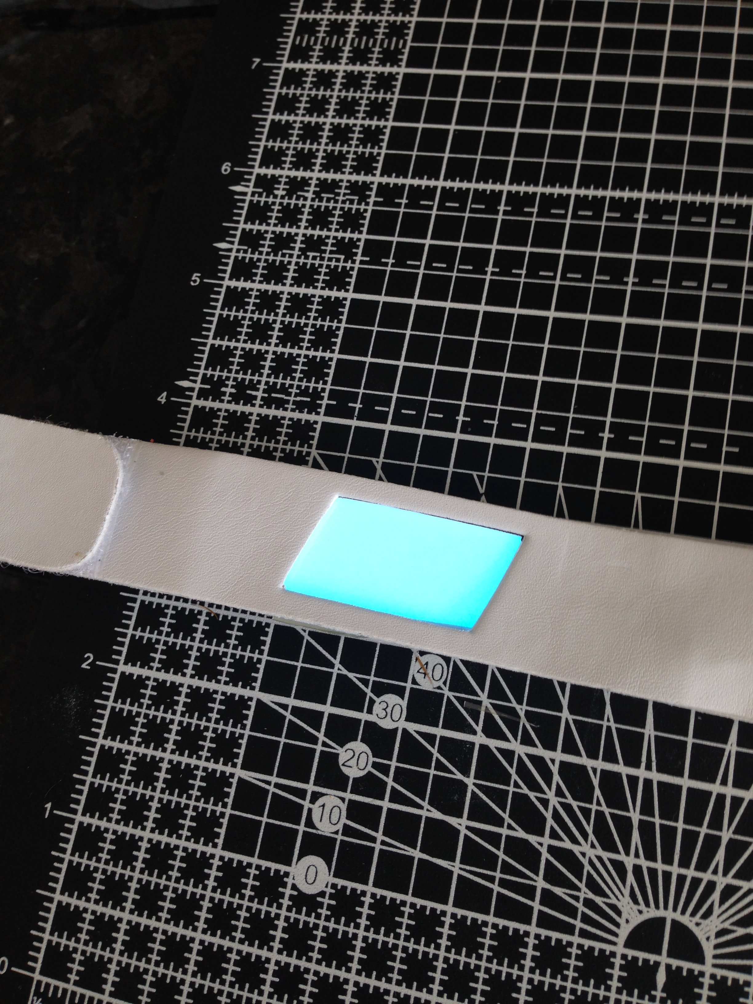

ok i seem to be stuck!,... thought my old man had a lazer printer but he has upgraded to a office style inkjet, and although we had some inkjet transparency film,,, it would not even feed through this machine,... sooooo i rang my closest printing company,,, they apparently dont print transparency?... ( are OHP's a thing of the past now i guess?),... and then i found a specialist printing company that do things like window pos, vinyl etc,.. presentation displays...... their response was, " we are sorry but the inks that we use would be somewhat transparent when lit from behind".....
i didnt think the strap logo would be so much of an issue?!!? HELP!!!!!
seriously though,.. can anyone help me out with this?,.. il pay for your trouble of course!

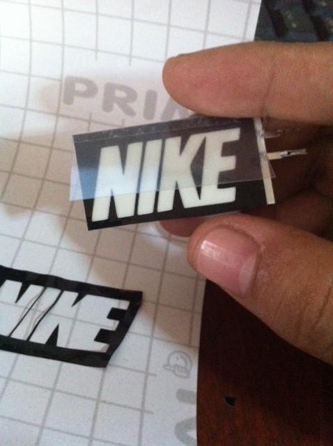

I have tried using printed on clear stickers but it doesnt work for me, here's a suggestion, find a decal maker and have your logo die cut in black vinyl sticker(with the sticker material also black) It helps block out the light and give a finer detail on the logo. Then you can use a clear acetate to protect it without having to use clear sticker, I hope you get what i mean. here's a picture.

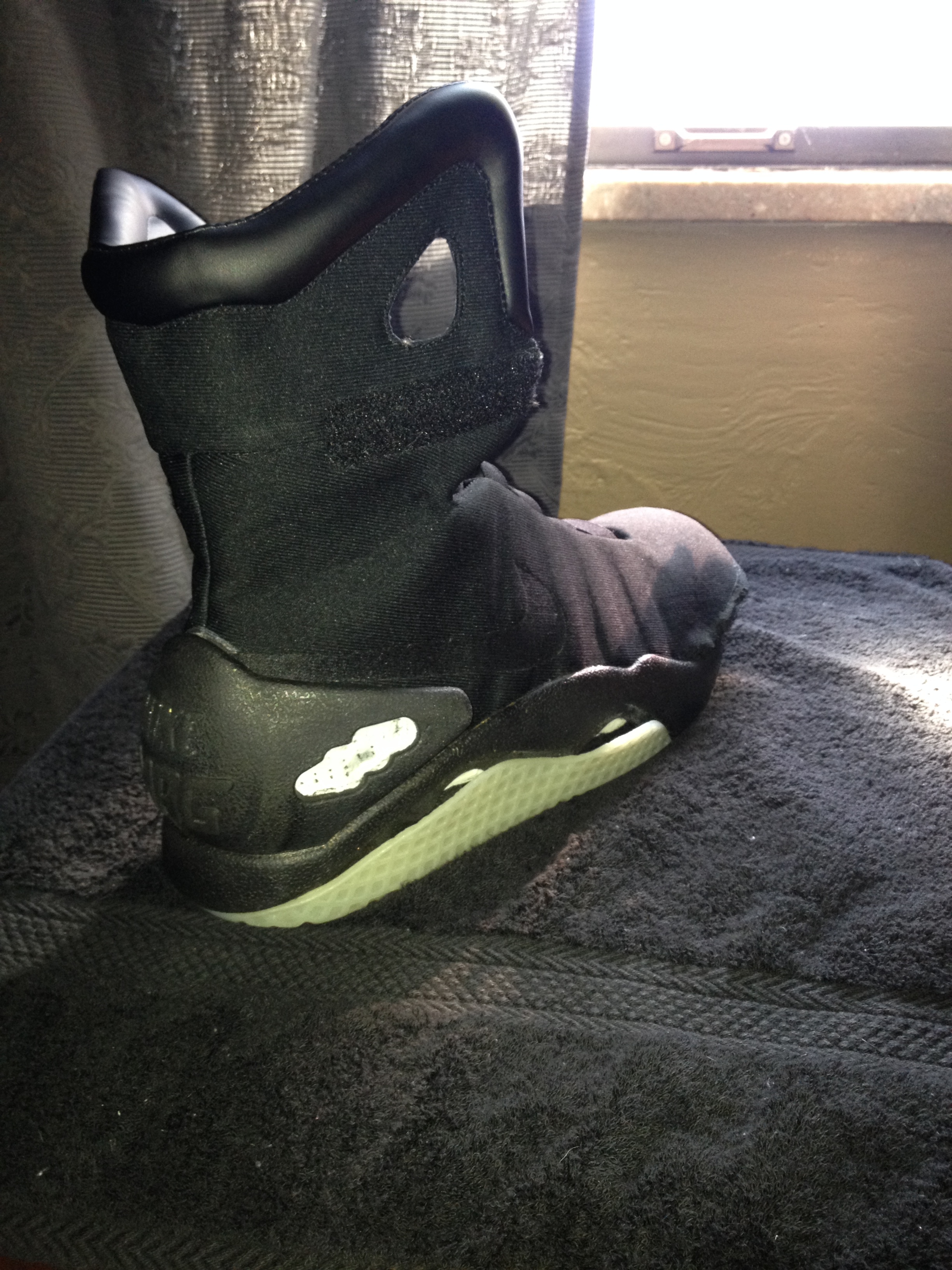

no it dont do any thing to the rubber at all but do a test on bottom of shoe to see for your self it took a long time i went real gental with a tooth brush i only have one pic of it after acetone its not that good and i used no clear coat
the paint they have is engenerd for shoes i cald them and askt if it would work on rubber and they kinda laugh't at me and said yes they normly sell buy the case to a crock moder and he dont have any issues hear are some pics the first one is after acetone IMG_0652.jpgIMG_0728.jpgIMG_0729.jpgIMG_0731.jpgIMG_0726.jpg

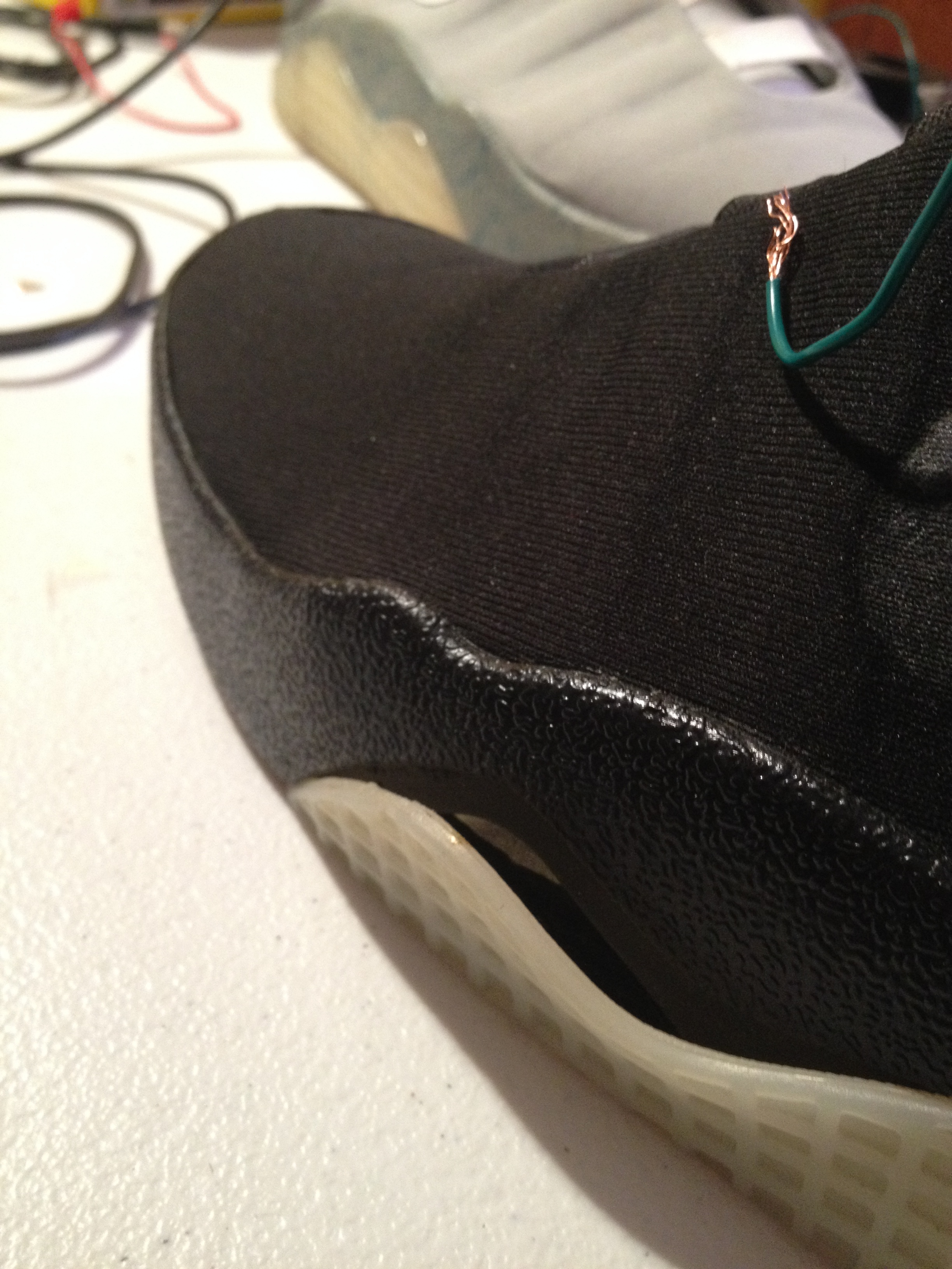

no, i simply sprayed a few coats of the tamiya fine surface primer straight onto the grey soles and the heel.
i let them dry, and a few days later, i used a sharp knife and the paint just peels off. Even if i use my fingers, it will peel off.
The reason I asked is because I've built a few SW guns from PVC pipe. If you paint the clean pipe with a primer without wiping it down with acetone first, the paint does not stick as well and I do think that the rubber of these soles is doing the same. When I repaired the splits in my soles with super glue, I cleaned the surfaces first with metholated spirits and the bond has not broken yet. Actually those outrigger soles I did survived a whole Super Nova Convention over the weekend including running around outside in the heat photographing for the 501st. Food for thought.

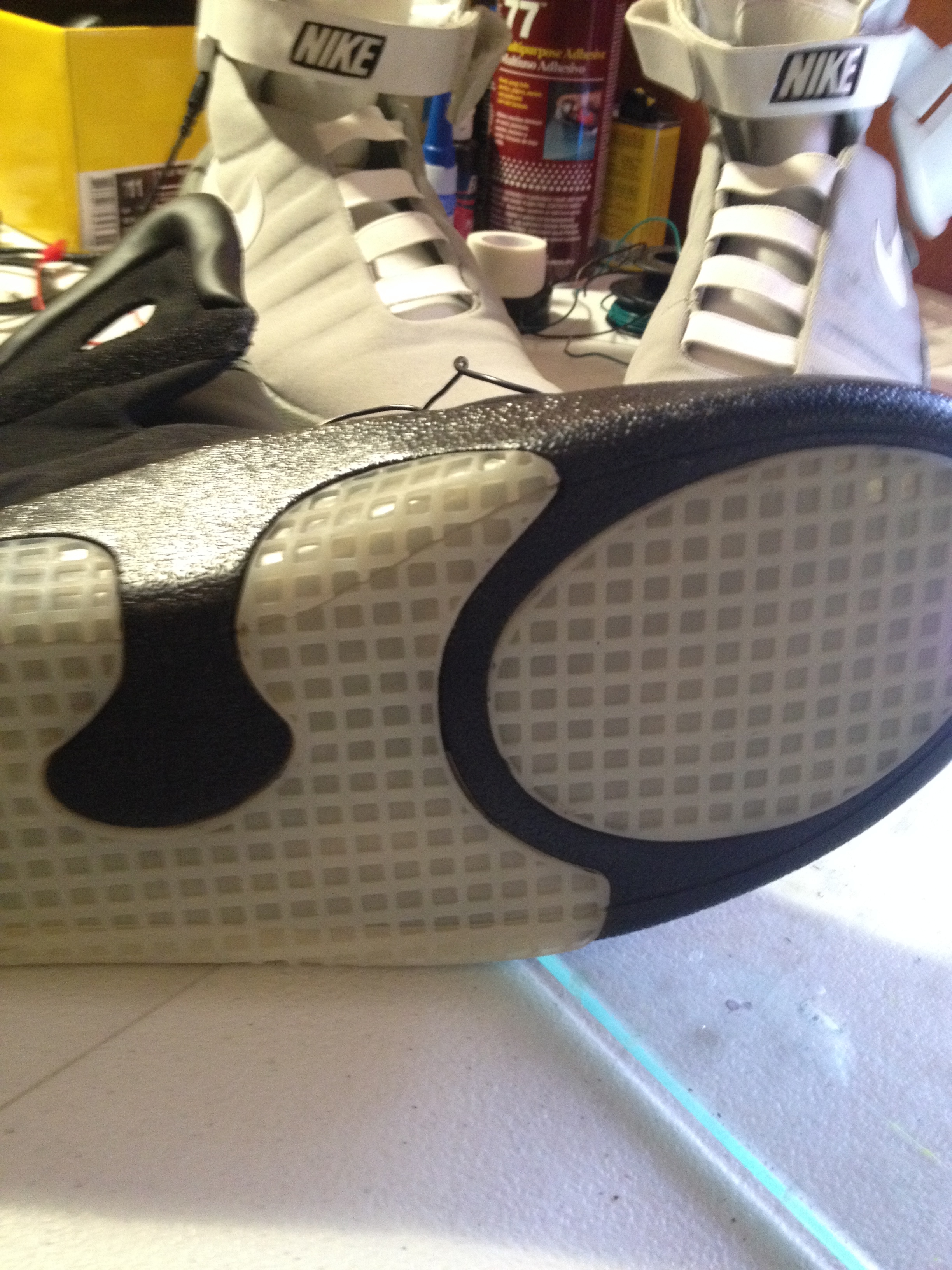

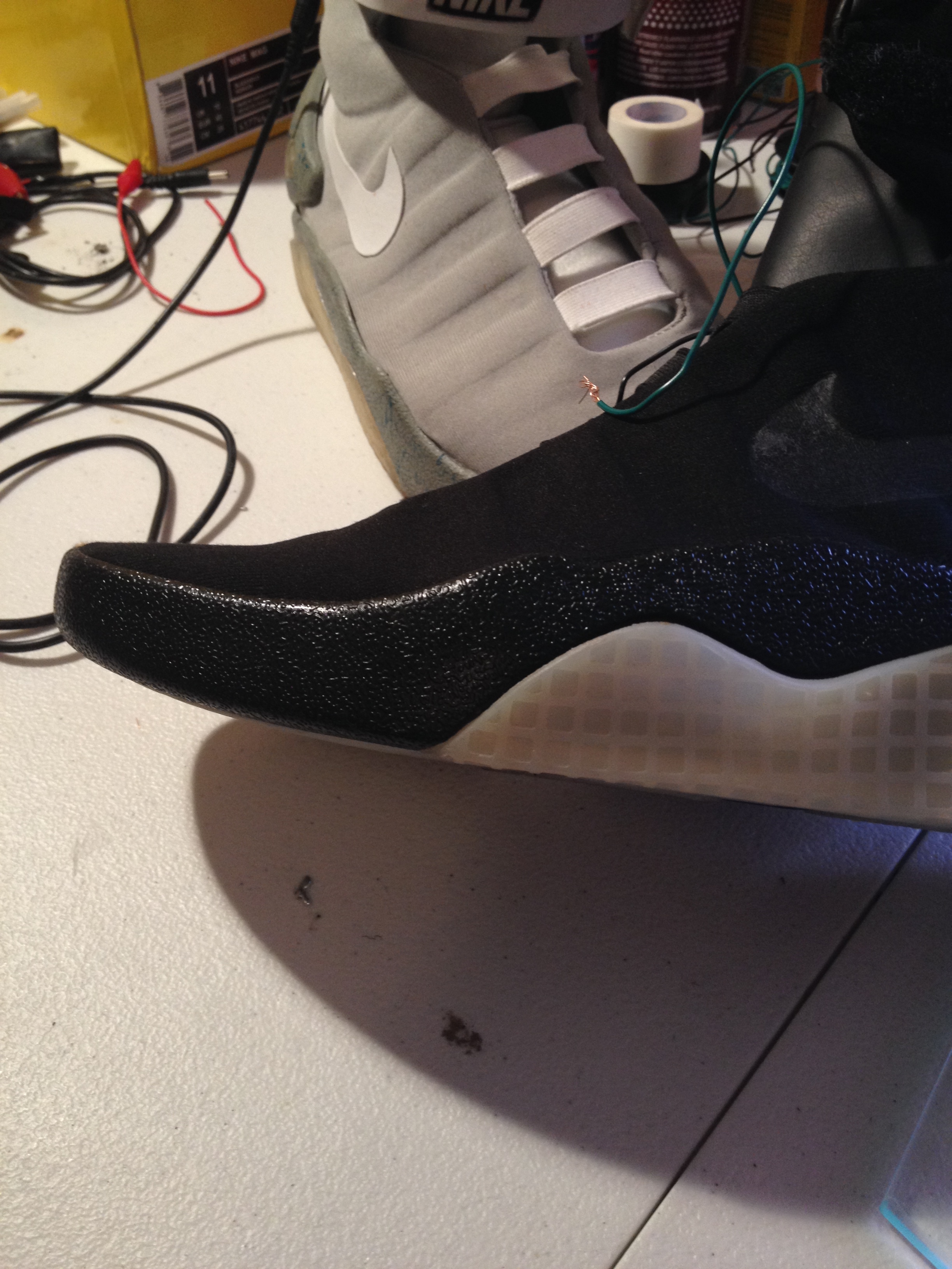

For those that remember my cold cast clear elastomer "clear sole" project, this might be of interest.
Looks like the right stuff to use. Hmm, nice toe slim even if I say so myself :)
For airair, the paint I used on these soles might be what you want. The problem is that the "light grey" is still too dark. If it could be mixed with some white to lighten it, it would be very good. Fast drying and does not easily peel or crack.
https://fbcdn-sphotos-a-a.akamaihd....-9/1000660_10152328289788841_1214483375_n.jpg

nike-mag-knockoffs-vinyl-paint-1.jpg-95355d1337649726
This is the paint ^^ I used comes in this grey and white for about $15/can. The grey on its own is way too dark (very misleading looking at the lid colour) so adding it to white might be the trick. Maybe you could de-pressurize the cans, open them up and then pour the liquid paint into another container for mixing. If you really wanted to spray it, then you would need an air brush but I think you could apply this with a brush as it seems to self level.
