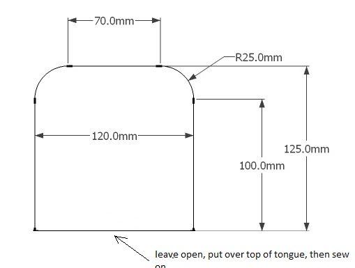

Sounds good, but it might be tricky to stitch something over the existing tongue if you've already glued the toe back down.
The existing tongue is actually glued on both sides of the shoe very well.
I suppose you could slide a new piece of leatherette over the existing tongue and then stitch it a the bottom and sides before glueing the modified toe back down.
Good suggestion, I might attempt this on my next pair whilst I do the toe modification.
I agree though, it should really be leather! I don't know why they have used the shiny spandexy type fabric for the tongue, when they could have used the same material they put on the white collars!
you might be able to just put a 'cover' over the top part of the tongue, like an envelope over a folded letter, and then just sew along the bottom.
That way you wouldn't have to replace the whole tongue. I've been thinking of doing this for a while but havent had time to do it yet, using part of cavx's design shown below.
your right airair but i was thinking on going over the existing tongue kind of like dragongalvy said but diffrent . cutting top of tongue removing foam all togther stuffing
and add all new foam to my shape and liking more movie accurate:) im not doing the sewing my wife is she likes making clothes as a mater a fact the still pick of marty you posted a couple a pages back is what im going for but maybe a bit bigger i have bin wearing shoes with giant tongues for as long as i can remember lol im a turntablist ,,,,, but the whole removing all the foam ill ask my other master LMAO she knows best she,ll probably say leave it and glue to it and just cut the seem with round foame tube out :)
CRAP can't be dun with toe mod dun but when the frount of shoe is opend completely different story thanks so much AIRAIR we will make the dream :)have to wait for my other 3 pair at end of month these are going to be my beaters anyway but still trying to make them as best as posable still learning but I'm kind of crazy matriculate to detail my first toe mod was kickt my butt lol got a spot of glue on side of shoe but i got it out the best i could its my ginny pig par i jump back and forth to each pairs so skill is more fresh rather than finishing whole shoe then go to the other since this is my first pair
