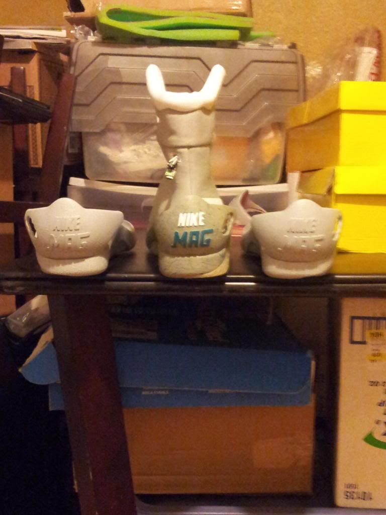

This Nike Mag Mod is taking some time to perfect but it is coming along nicely i have took the V2 out sole/form and made it into RD Mag shape. I shaved the back down/ and added a thicker toe front ,plus now i have the cloneprops heel cups and ankle bubble set every thing will be molded and
re-casted progress pics will be posted shortly once molds are done drying.

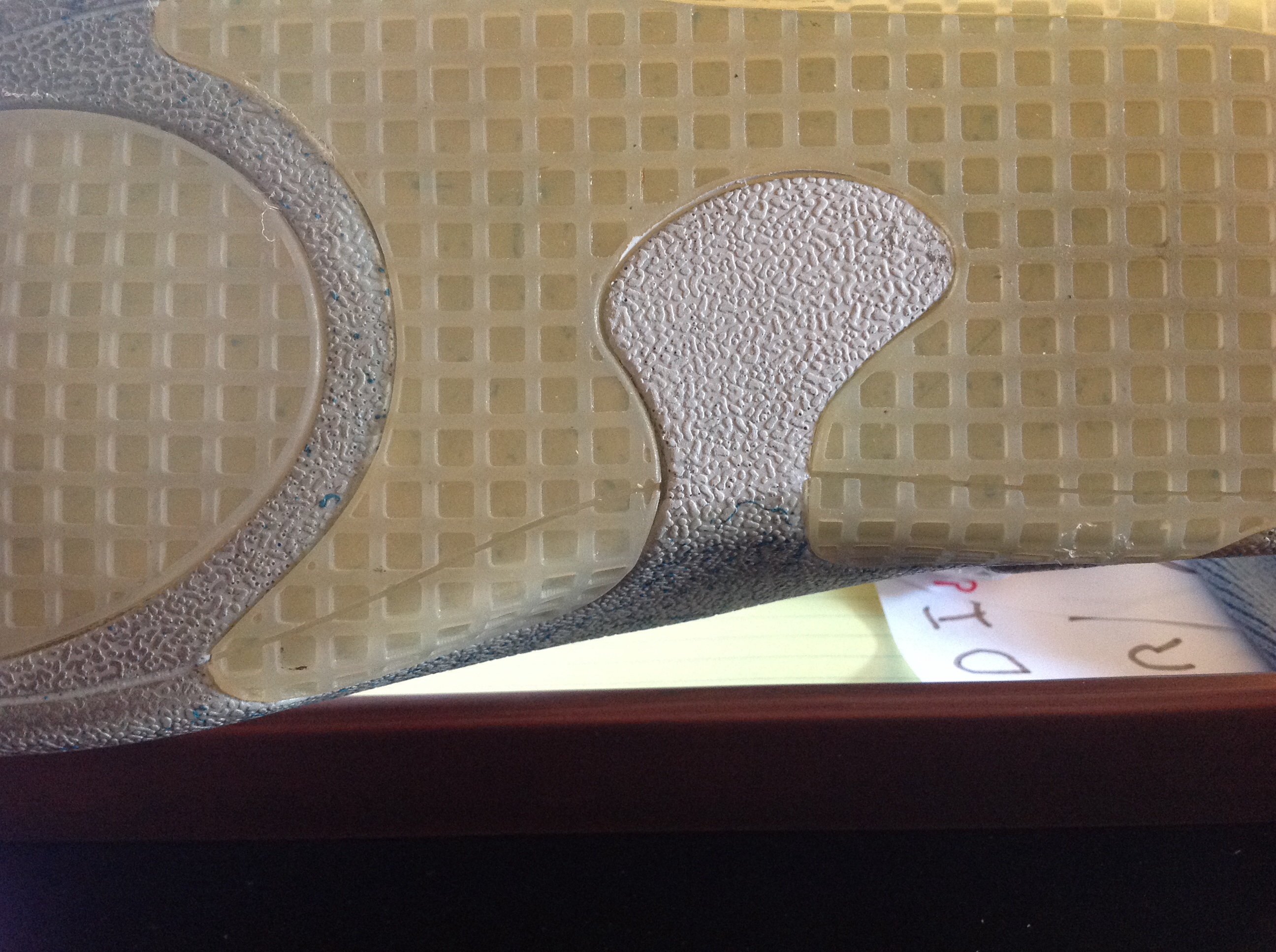

Absolutely. On my first pair, the left shoe was easy to separate the clear sole EL area. The right shoe was significantly harder. On this 2nd pair I'm finishing now, the left one was terrible, and the right one absolutely ridiculous. I wanted to throw it across the room! Most of it just refused to separate, no matter how much blow drying I did to it. I ended up doing some very careful scalpel cutting, and then (also very carefully) dremeling some grey rubber off of the clear. If you must do some cutting and there's no way around it, do it into the grey rubber and NOT the clear. THANK GOD at least the two triangle areas where the EL goes are not glued to the grey sole, but rather just have those loose clear pieces behind.

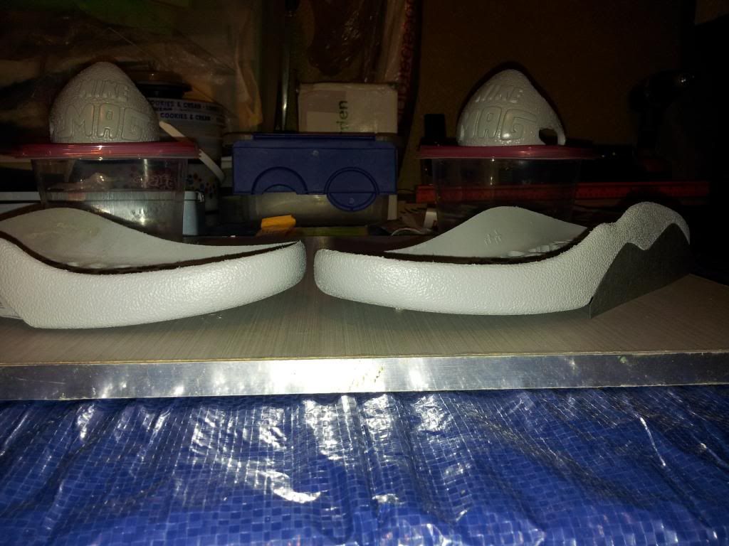

Okay bttf fans i gave my sole a face lift and new clay grey paint job, you like the new look?
http://i1320.photobucket.com/albums/u523/chrispicks/20140126_004557_zps17d4a0a4.jpg
This is my back sole custom trim to fit bubble and give it the RD. Mag look.
http://i1320.photobucket.com/albums/u523/chrispicks/20140126_221639_zps5af2f433.jpg
Your work looks great.
So is that mid-sole the original repainted or your own cast version of it? Wasn't making your own the goal?
Are the Heel Cups cast off the V2 ones or taken from CPs? I would suggest that the RD heel Cups are longer (vertically taller) than the V2 and that trimming the mid-sole without extending the Heel Cup may make it sit too low.
Okay guys here is the trick to spraying your shell with paint and for it not to chip off or crack /1st you spray shell / in a place were the sun will shine directly on it / it will bake the shell plastic witch will make the pours open and stick better > once sprayed/ Mod the speckle splat pattern then spray 2 coats of clear Matt finish spray paint >This will lighten the grey to the true clay color plus it locks in and coats the speckle splat pattern / Let dry in the sun for 30 to 45 min/ final step /Take the the sprayed items and place them somewhere Cold or put a fan directly one it /Let dry for 48hrs /this will complete the paint bonding process to the plastic or rubber sprayed areas. F.Y.I. Spray light and careful coats/ Not to close..
I have the cloneprops heel cup set from what i can see by eye the heel cup is bigger than the V2 heel cup. So the size difference should compensate.

I did a quick test spot with some normal acrylic spray paint and then sealed it with matte spray. I will see if it chips or flakes. Since it's on the bottom of the shoe it will get the most wear.
