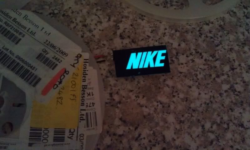

A Few pics for people...What you reckon??
First off size comparison
And working. Excuse poor lighting and remember at the minute this isn't final as I need to tweak some values on the PCB in a little while.
And another one to show proof im using the circuit I made and not cheating! :)

Amazing work don!! When you have that working on the V2s so you can still charge them, you're onto a winner. I would happily pay good money for you to mod mine :thumbsup
