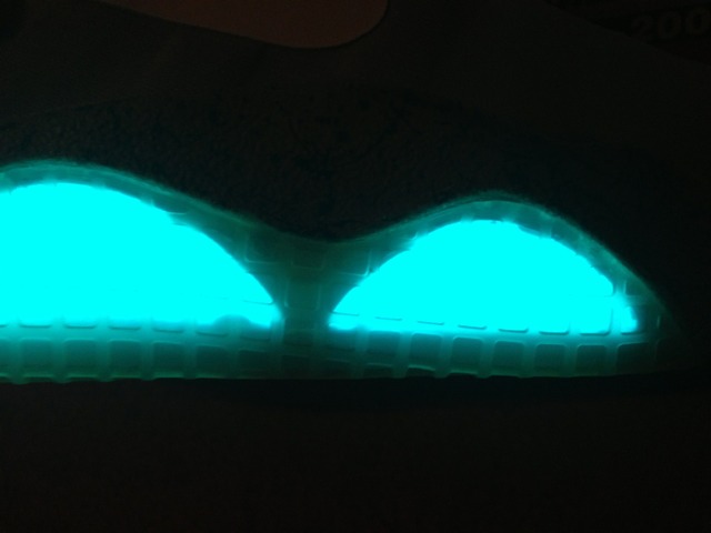

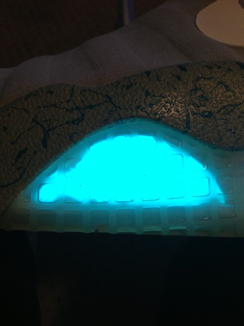

Is there any way to avoid the EL panel separating slightly on the edges in the sole? I have experienced massive spotting while cutting numerous EL panels, and the panels that cut correctly and cleanly with no black spots, I installed in the sole of my V2's but during minimal wear they have spotted in several places.
Any help is appreciated...
Also the eBay hookup wire I bought is flimsily and weak. The wire breaks before the solders even have a chance to move! And I can't replace it because its in places that I don't want to take apart. But this is a problem I can figure out. The EL panel is what gets me. I know everyone else doesn't seem to have this problem though...
You can try brushing super glue around the edge and that will normally keep it from happening. And as for fixing the spots that have already happened ironing them on low will fix the spots a good bit, not perfect but will be a lot better. Just don't iron directly against EL put a sheet of paper between and keep checking to make sure the iron isn't actually melting anything.

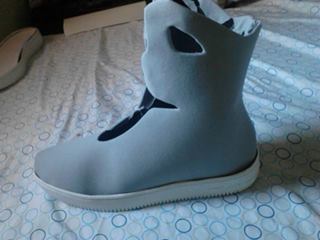

So far I've only got the grey part figured out. The collar still needs sizing, I've got it wrong twice. The first time it was too big, second time it was too small. Its because the seams need some extra room before stitching and its hard finding out just how much they need

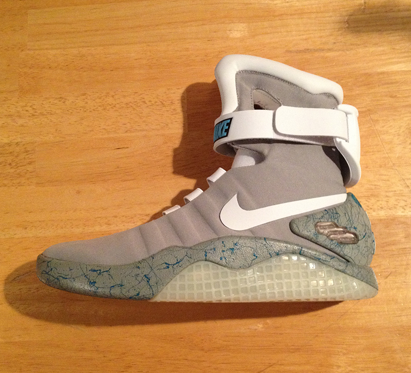

Did the Toe Mod yesterday. Biggest PIA to separate the upper from the midsole. Wasn't able to get it cleanly separated from the midsole. But everything that was ripped got hidden when glued. So worked out in the end.
Heres the final toe.
