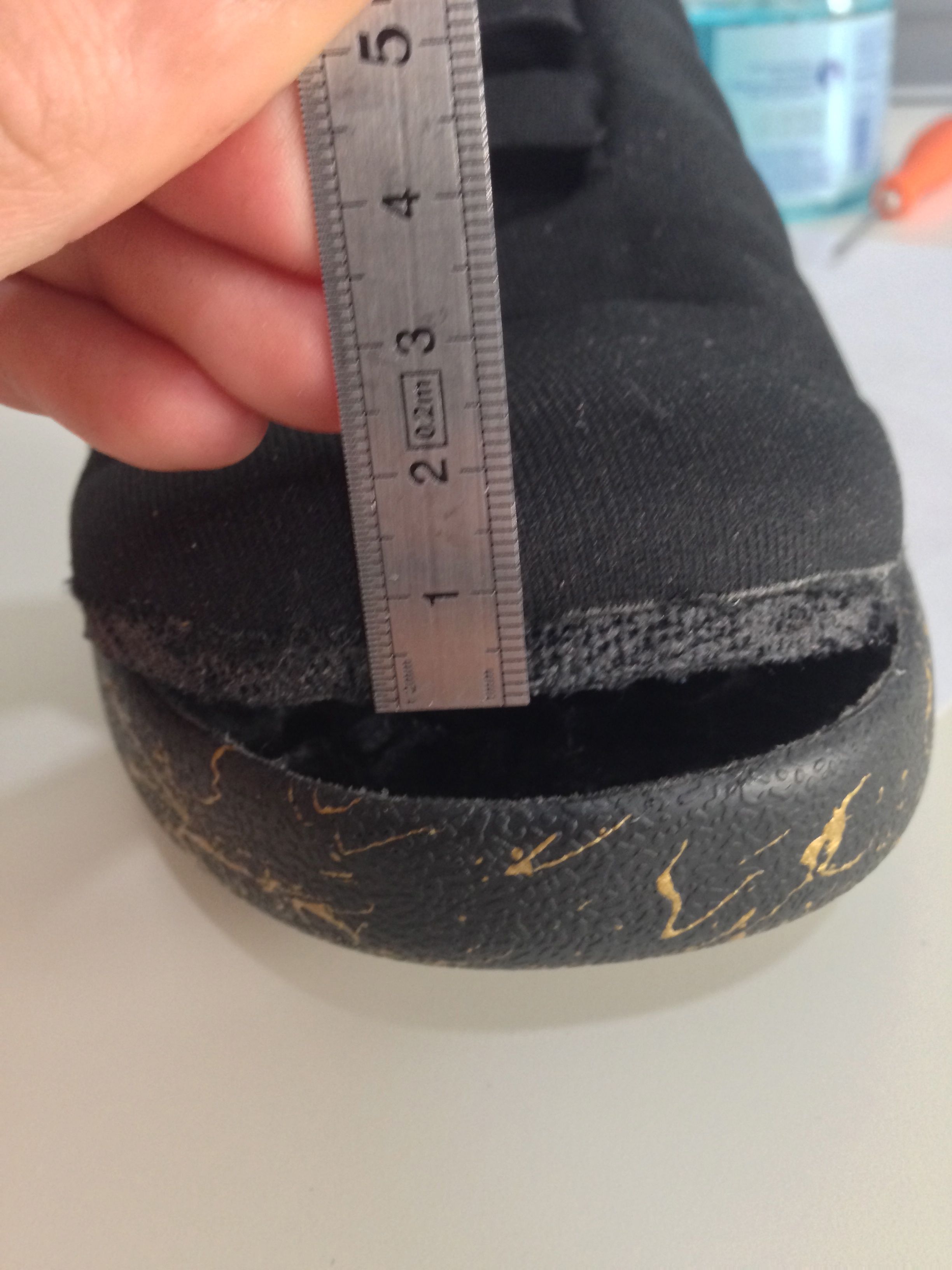

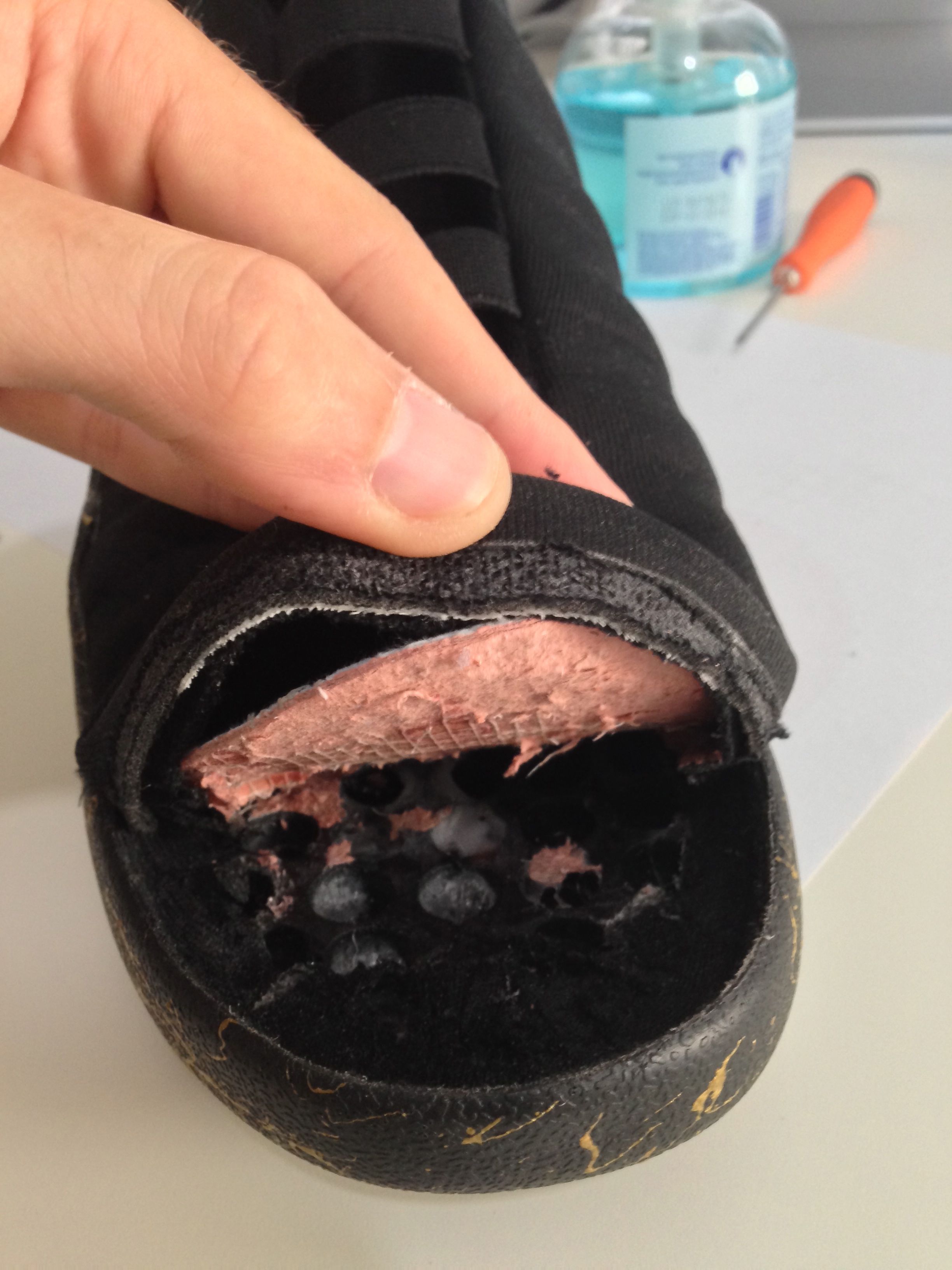

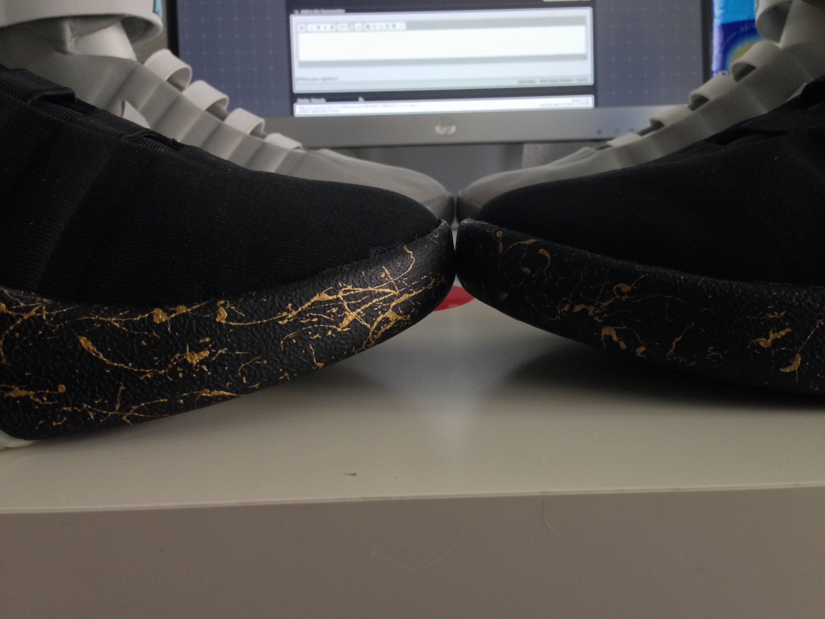

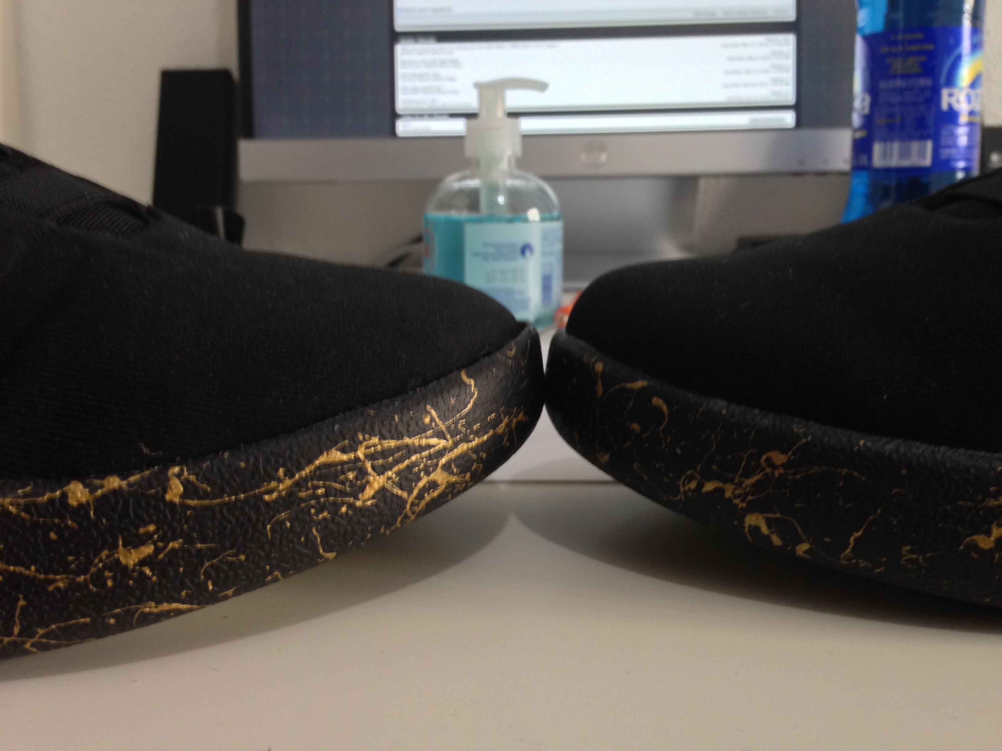

As MitasTouch said, I leave about 6mm of fabric after the glue line, I add here pics to show you the process.

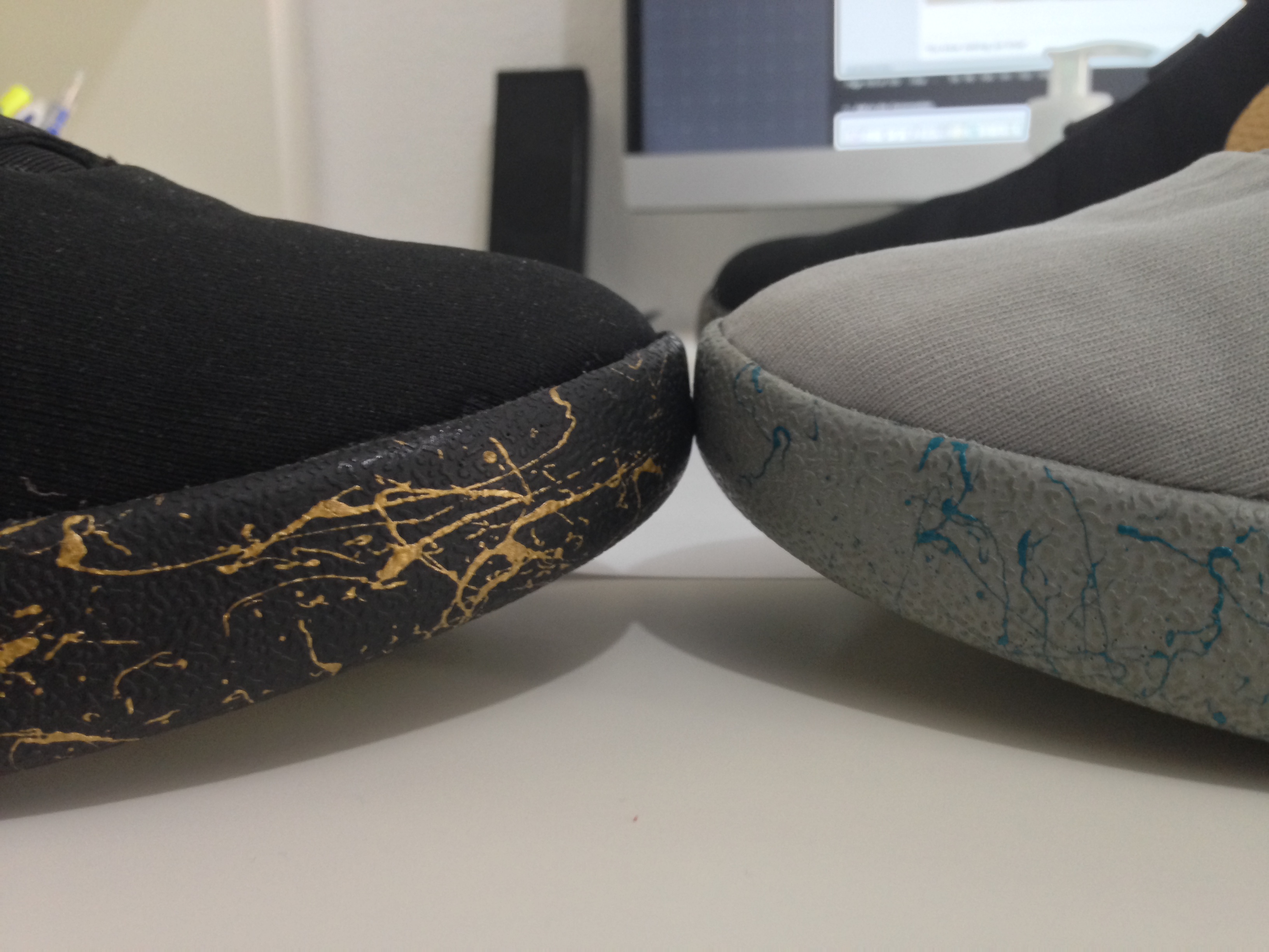

You also have a side by side comparison between a moon boot MAG and a slimmed toe MAG.
About the final glue line, I will try to buy something this afternoon and I will let you know how it goes. Anyway, even with the actual finish it is okay for me, but I saw some very good finish on this topic, so I try to do the same.
Spyhunter2k, thanks dude, but you know when you do it yourself, you can see so much imperfections that I know some guys here managed to do a slim toe just as I did with a much better finition.
The pictures I took are the best ones, on some other pics you can see that it's not perfect, but anyway, thank you again !

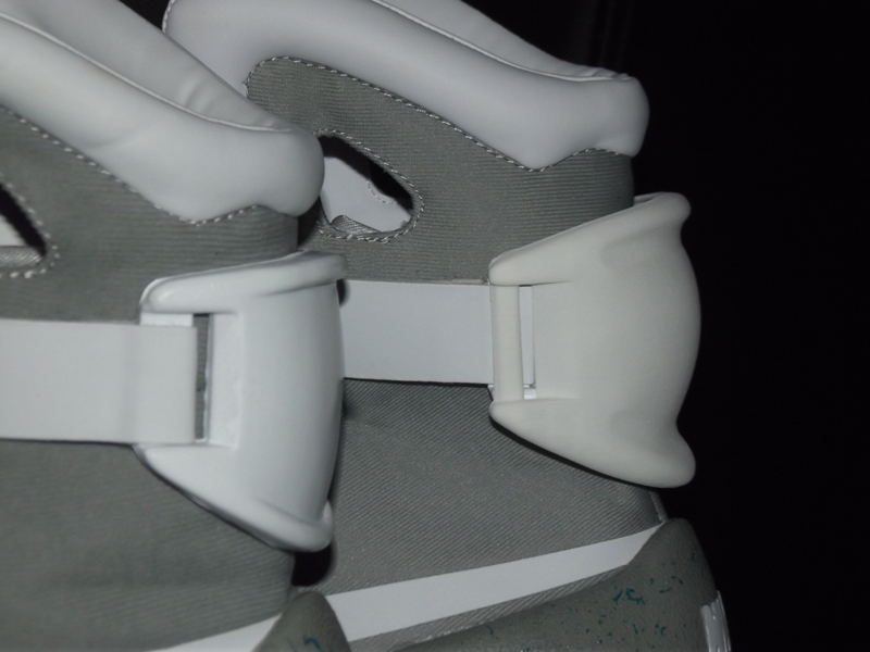

At the other end of the shoe is the ankle buckle and have a look how inaccurate the V2 one is. The ankle buckle on the rear shoe is the 3D print from cloneprops, created by 3D modeling the RD MAG. Even my vac pulled buckles are better than the factory unit.

4 toe slim done, it is long and hard, but totally worth it in my opinion.
I still have to do a "finish glue line" though.

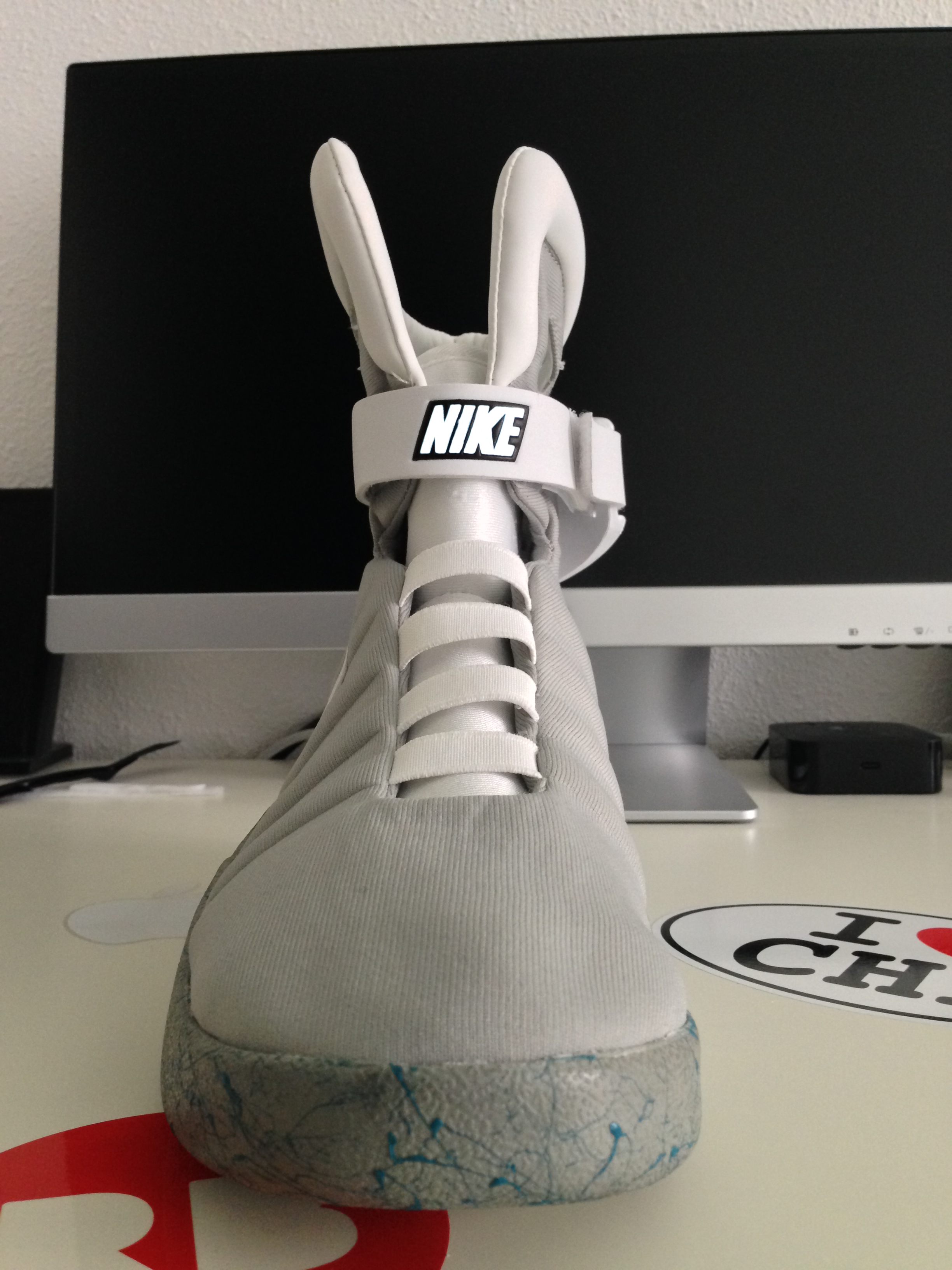

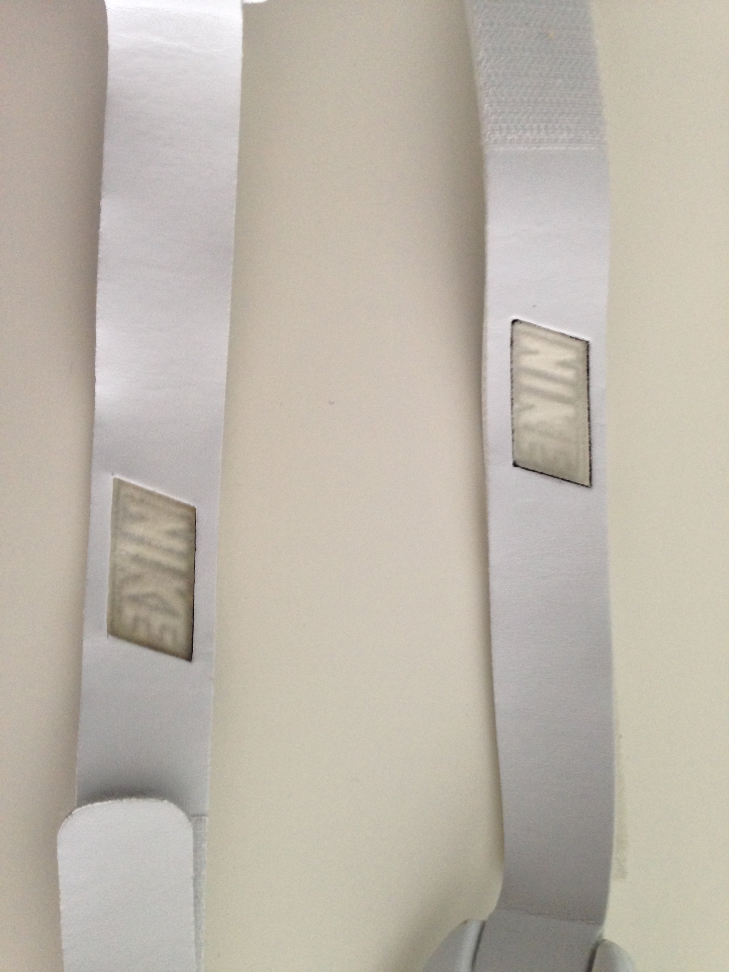

Here is the pic of my 2 straps.
I put a slice of transparent plastic to give a shiny look, just as Bobby Brown did.
My printer is out of ink, so I will print the logos tomorrow.

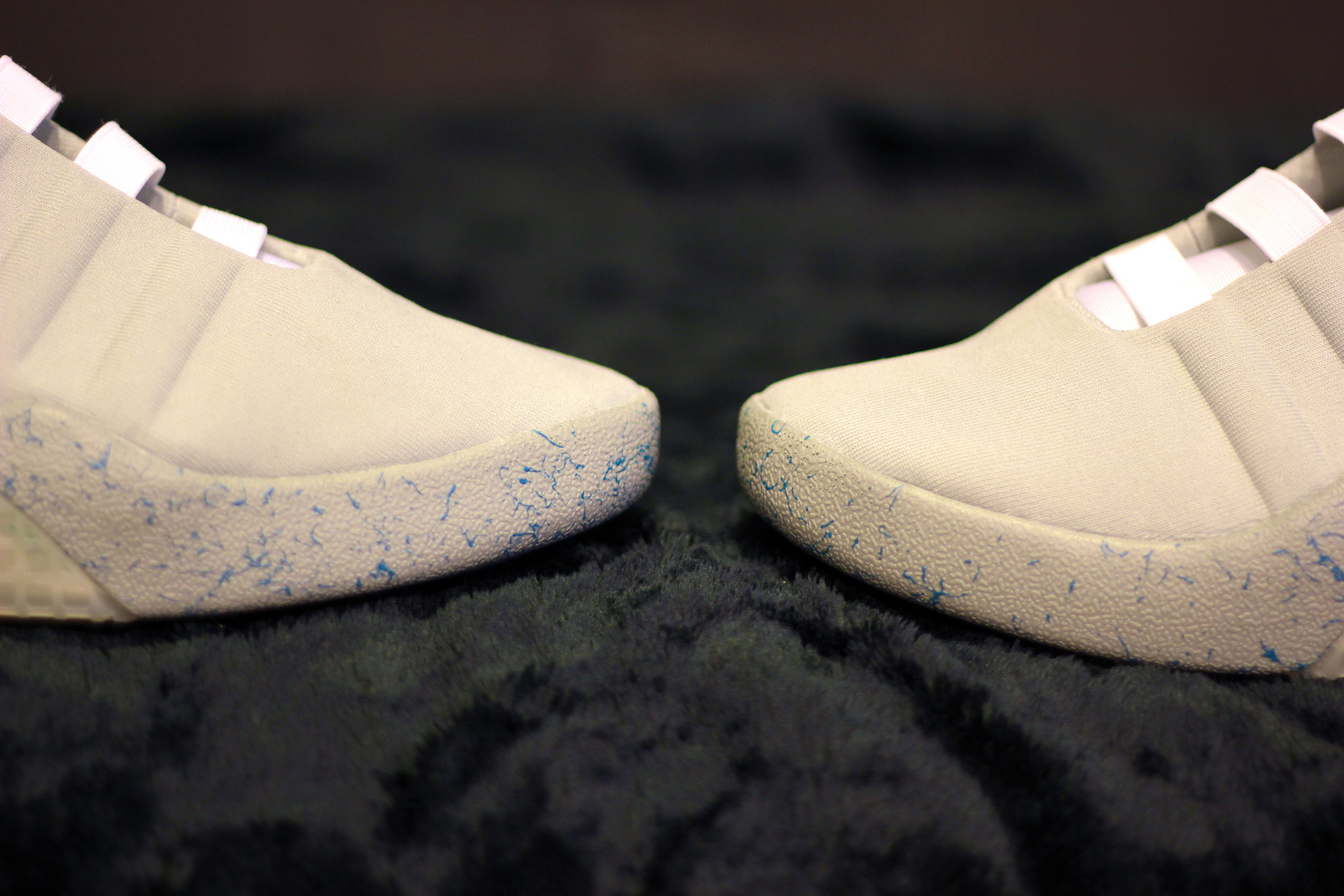

Here are the newest pair I'm currently working on. I wanted to have an extreme flat-toe look. I'm happy with the results.
