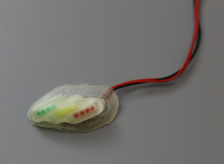

youngking59; you make the LED bubble clearer by painting a clear coat onto it. Lie the shoe down so the lights are facing up. Spray some clear spray paint into a container, then brush it carefully onto the ankle bubble, in a reasonably thick coat so you won't get brush marks. I used a cotton bud to paint it on with. The reason for lying the shoe down is that if you use a little too much paint, you won't get drip marks on the bubble. If you don't want it totally clear, use 'matt' finish. (i can't vouch for matt finish as I used gloss but it should make it less shiny) It helps, but doesn't completely balance the lights. Hence why I'm getting another pair with the updated lights. :D

I did this to both pair and I used clear nail polish ($4.99 at a chemist or what you guys in the US call a drug store) and then gave it quick hit with 800 grit wet and dry sand paper, but only wet the paper. You don't want to wet the shoe. This is just takes the shine off the finish you've just applied without removing that layer.

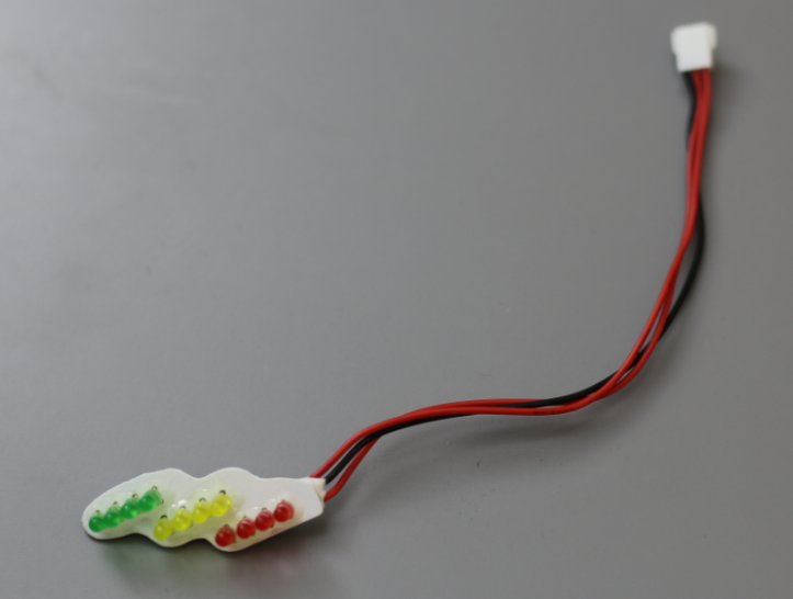

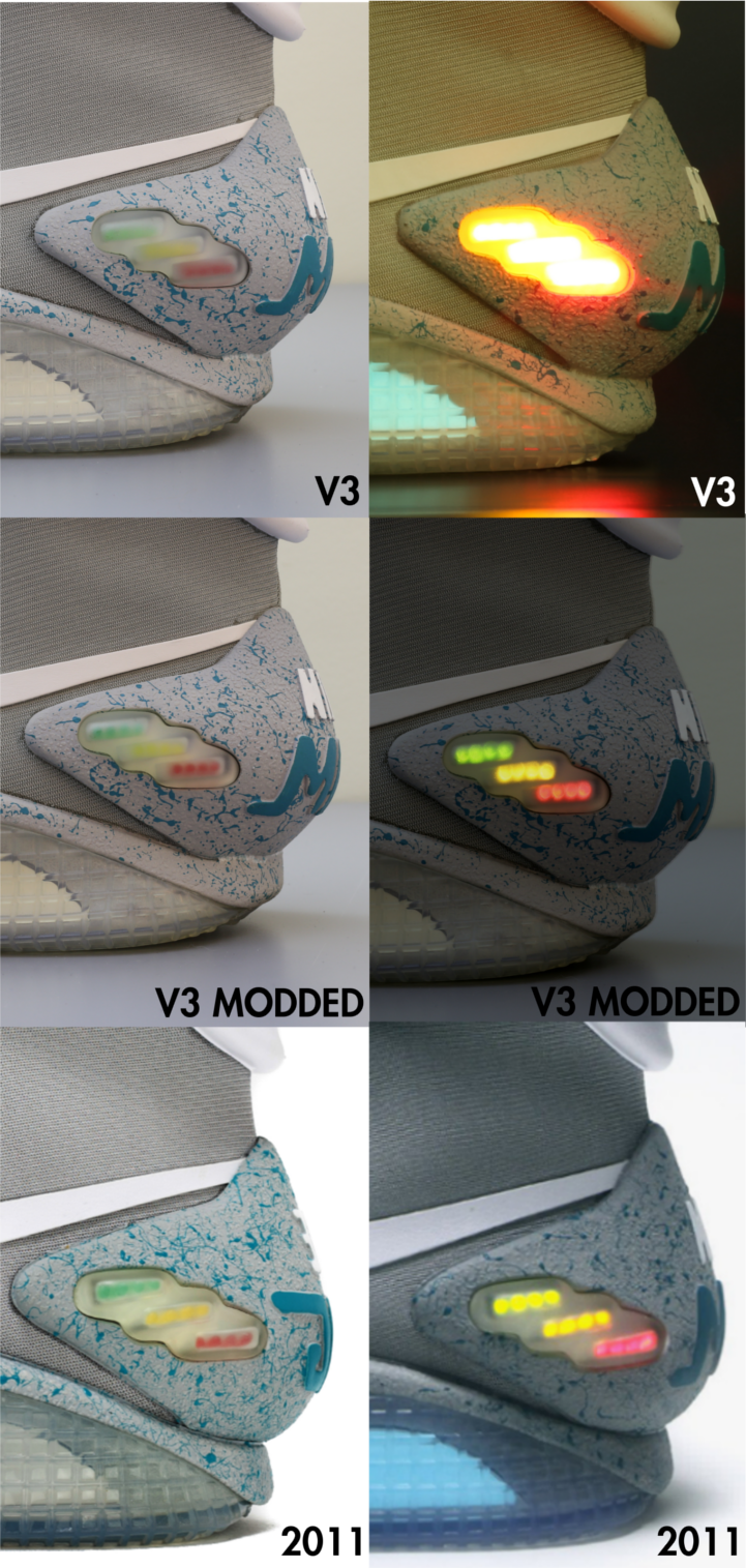

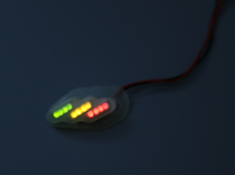

If you are going for the closest to RD, I think its best to leave the bubble foggy and replace the board (or change the resistors yourself) the boards I make have the LEDS moved closer to the bubble which helps you see the LEDS better when the lights are off, that and resistors dimming them are probably the closest to RD. As cavx said though clearing the bubble also works. It makes them look better in person because you can actually see the individual colors when they are turned on (still wont show up correctly on camera though) Here's a comparison photo I did a few pages back to give you an idea of what looks you can achieve.

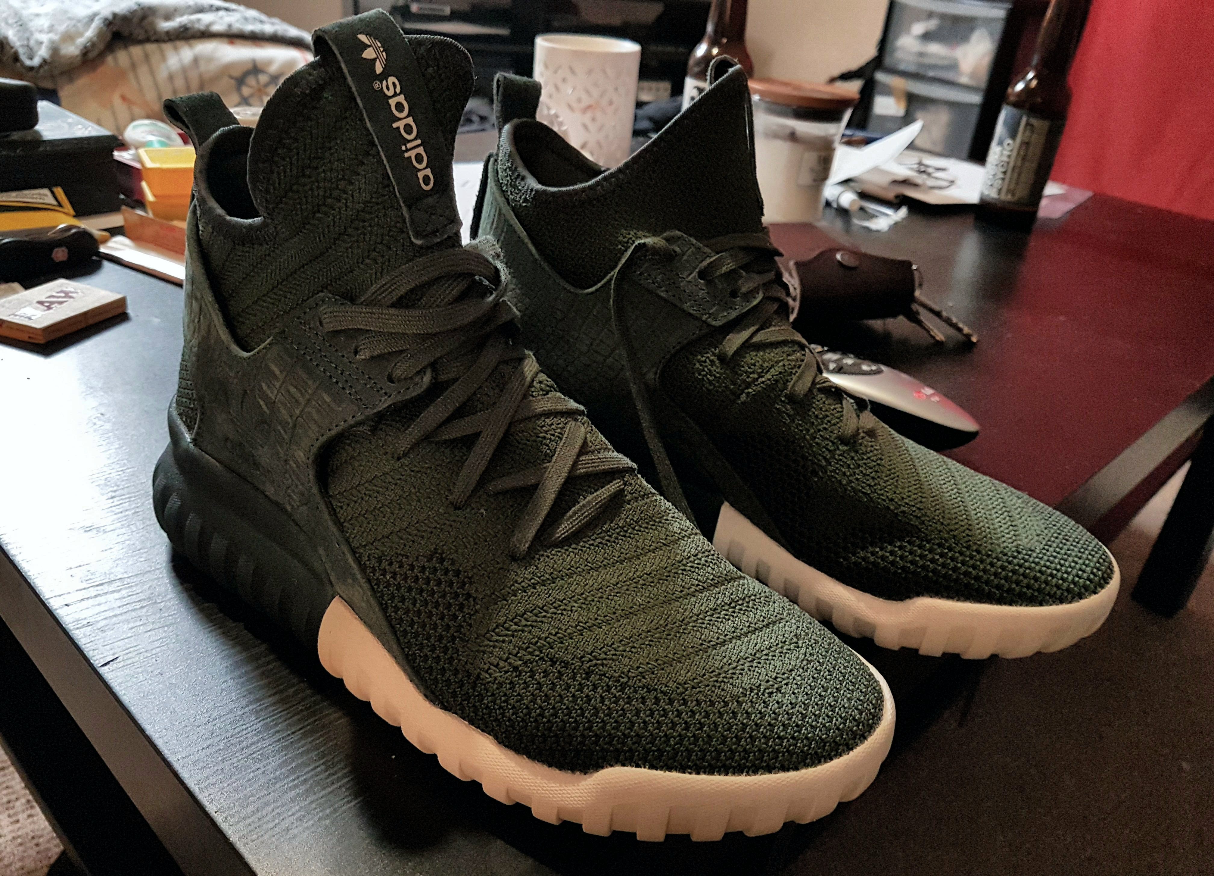

Hey everyone, who'd have thought Adidas would be the one to create something akin to the Mag, that's available to the public. I've just picked up a pair of these and the material they use as well as the bonding process to the rubber, is exactly what I'd expect to see in a public released Mag. Just thought I'd share this with you guys, can provide close ups of wanted
That's kinda cool. Pity they didn't go with something other than laces, but still, not bad. The weave is a bit too coarse for my liking, but maybe that's just me. I did get an Adidas NMD a while back which has a very fine MAG-like weave. Pity they didn't come in a high-top at the time, that Boost stuff is awesome.
If you are going for the closest to RD, I think its best to leave the bubble foggy and replace the board (or change the resistors yourself) the boards I make have the LEDS moved closer to the bubble which helps you see the LEDS better when the lights are off, that and resistors dimming them are probably the closest to RD. As @cavx said though clearing the bubble also works. It makes them look better in person because you can actually see the individual colors when they are turned on (still wont show up correctly on camera though) Here's a comparison photo I did a few pages back to give you an idea of what looks you can achieve.

How are these wired? If all LEDs are wired in parallel, shouldn't there be 4 wires in total? I noticed that there is only 3 when I had my V3s apart.
Sent from my SM-G900I using Tapatalk
They are parallel with each led having its own resistor. 3 wires, but you only really need two since 2 of them are 3.7v and then 1 ground.
