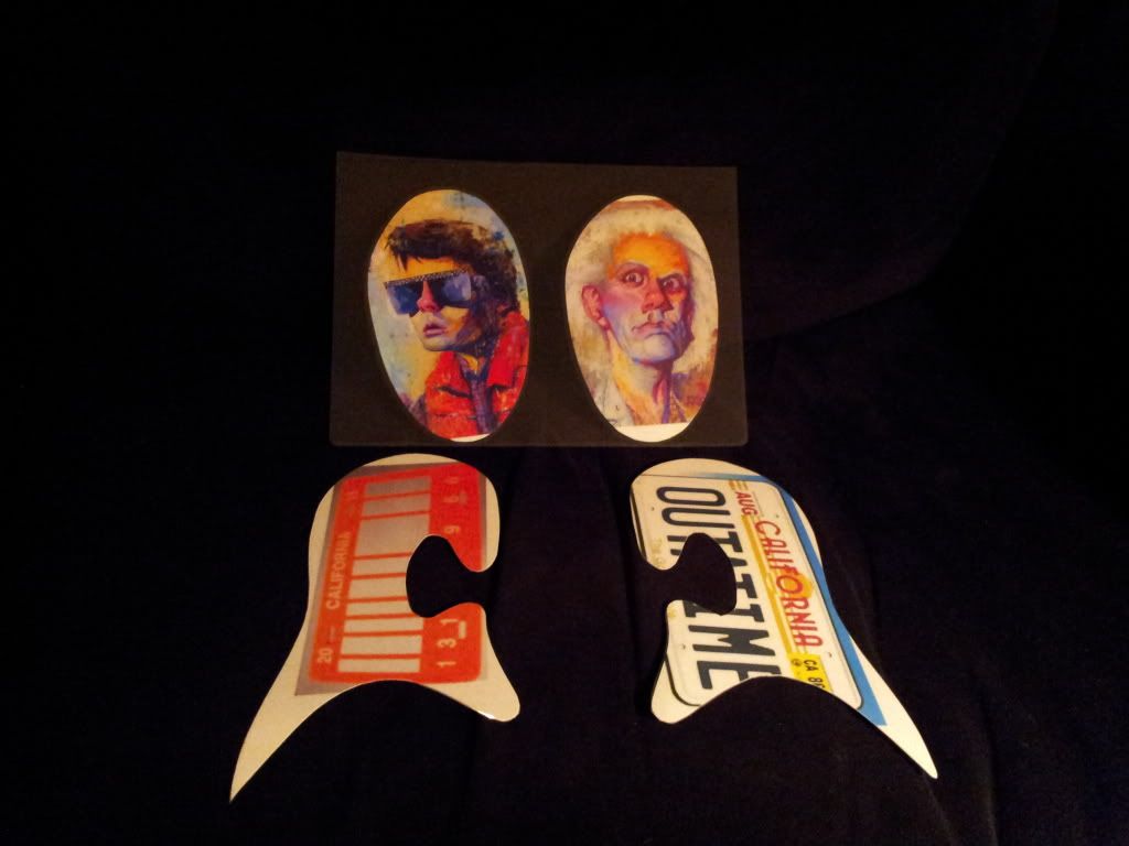

Its time to go Hollywood here is my Custom (L and R) laminated for water proofing /inner images of MJ. Fox and the DOC plus both car plates for my clear soles almost done /next is the L.E.D's for the heel cups then i will mold the heel cup or depending on cost if to much i will buy a pair from Cloneprops but this is ,for sure a timeless project .......

That looks awesome!
Can you shed more light (yes pun intended :) ) on this?
It look like you have used some form of high reflective material to enhance the light output.
I was thinking of adding LEDs to my soles and hoping the 3M reflective tape I used will catch the light.
